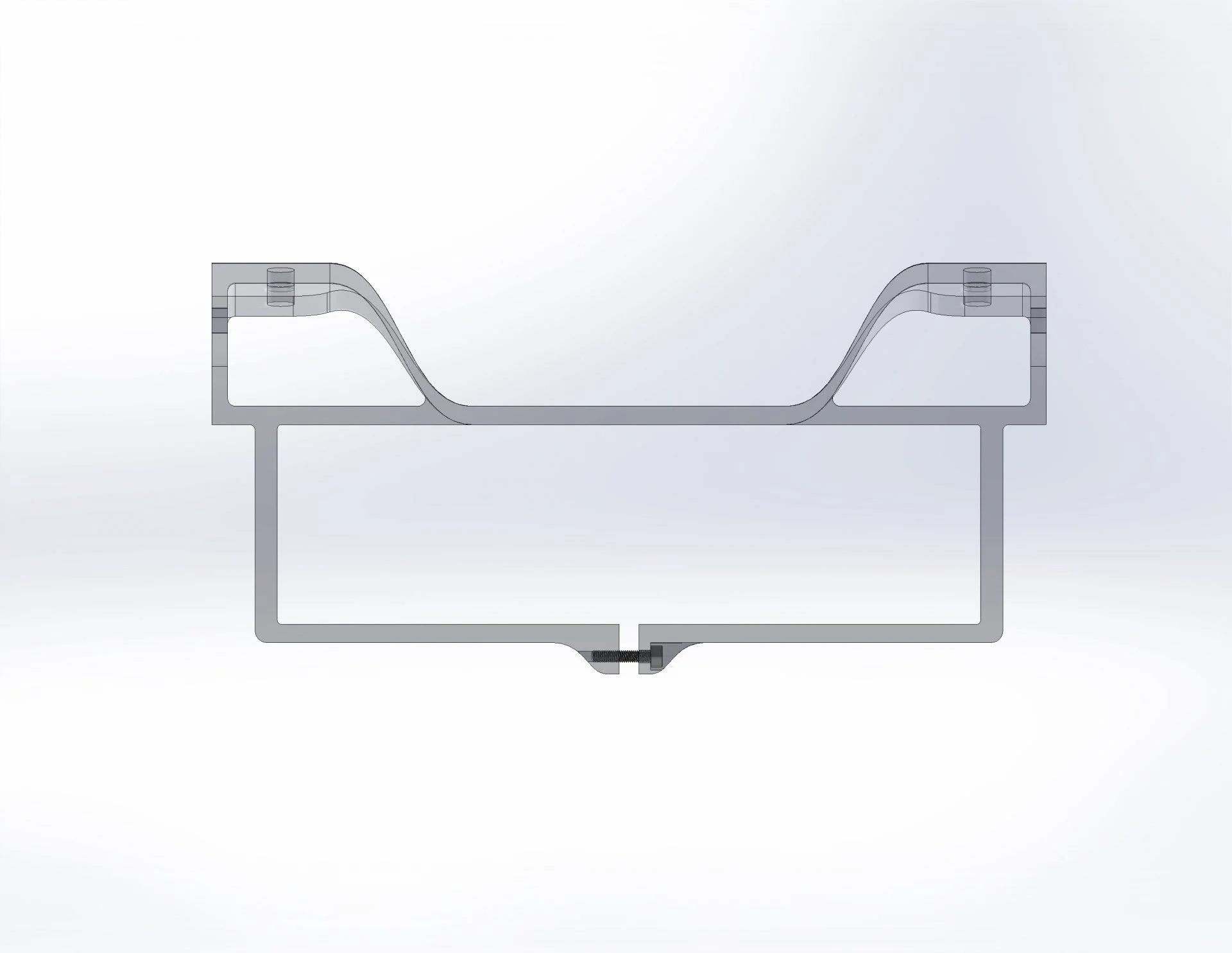

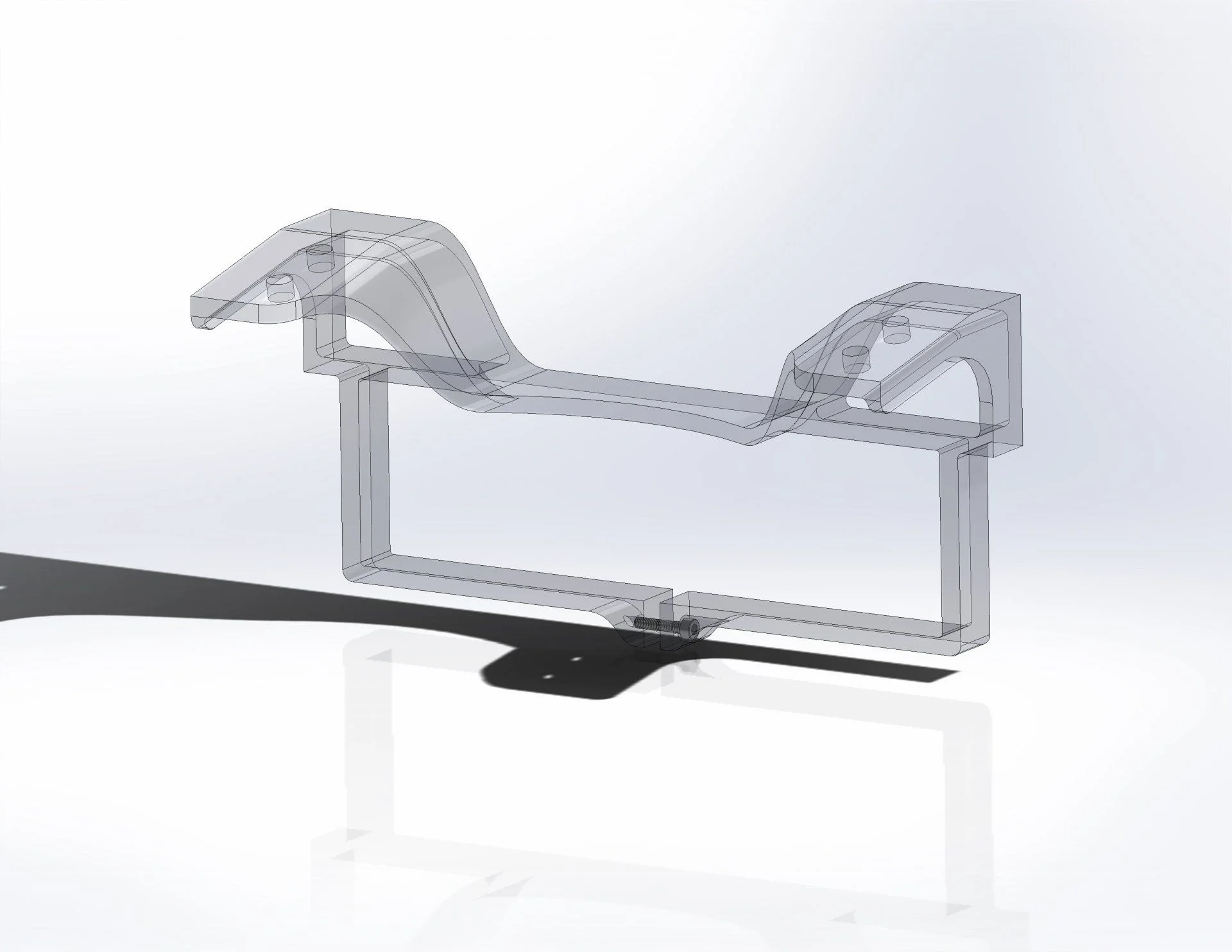

I didn't expect these would actually be used. I'm really glad they are! I organized the files and added some notes HERE.
Cincodemustache please share how your install goes. I'd hate for people to spend $$$ on 3D prints is there are improvements I can make to the files. Just let me know! Also, the stereo is held into the dash by a M3X15 socket head screw that pinches the stereo opening. This screw will self-tap into the other half of the pinch. You can probably make a lot of different screw sizes work, but that's what I used.
A few photos to help clarify what the bracket looks like and how the pinch bolt sits:
