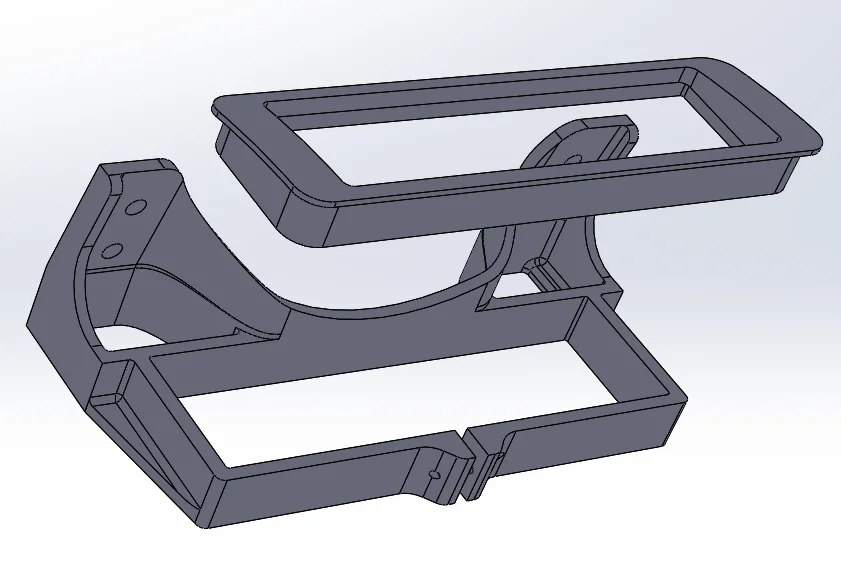

I changed up the bracket just a bit. I'm a mechanical engineer so I can't leave well enough alone.
Added some vertical ribs and changed the strap to 20mm instead of 15mm. Plastic is cheap, why not.

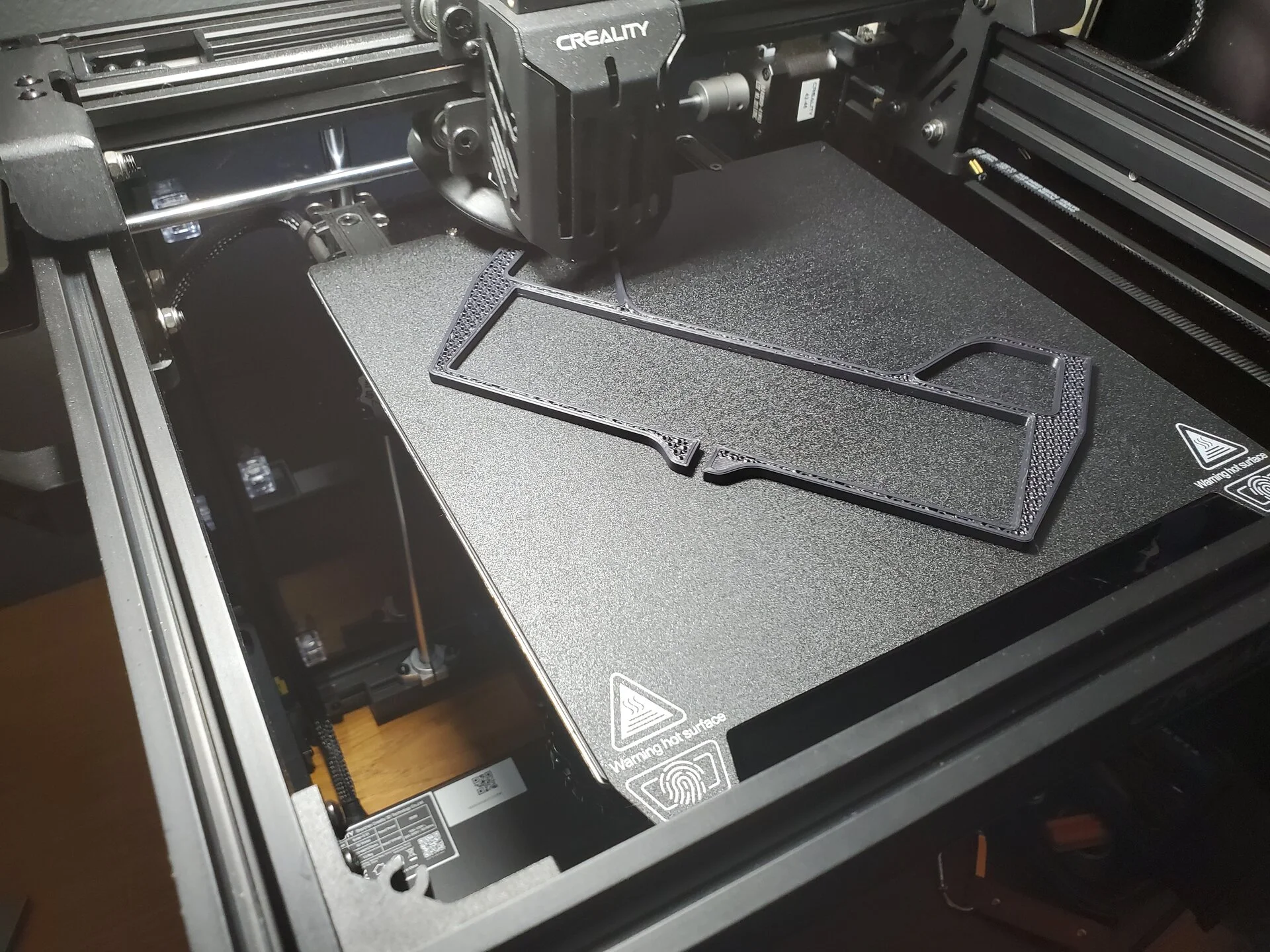

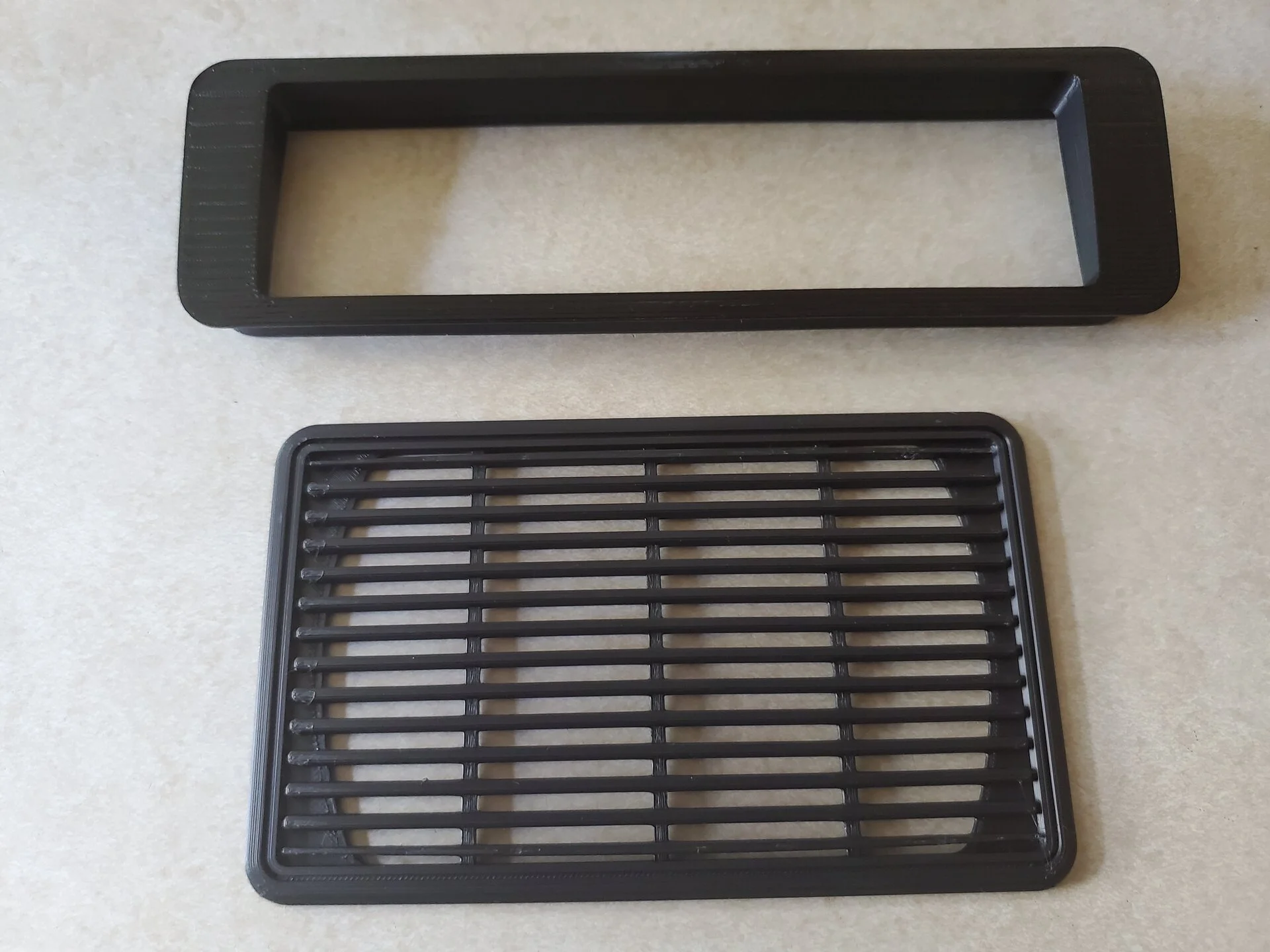

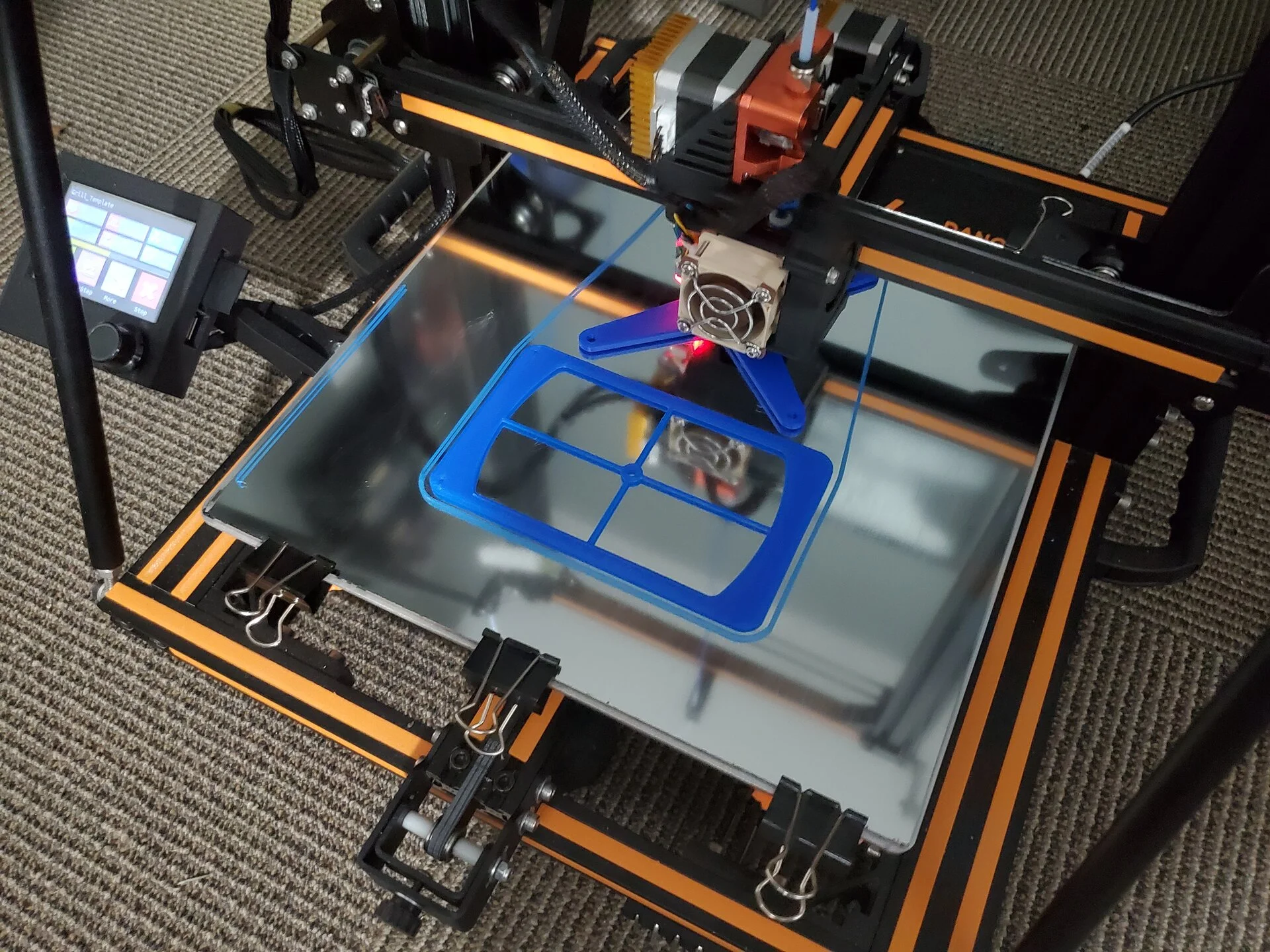

The ASA grilles and faceplate came off my printer last night. The bracket is printing now. The template and sharpie holder are printing on my other printer in PLA. I have a 3rd printer set up for TPU, and I posted a thread with some replacement bumpers that I drew up in SW.
ASA and ABS prints aren't as crisp as PETG, but more than good enough for my basket case on wheels.
If I can find some PETG in my stash, I may reprint the faceplate and grilles to see how they compare.
