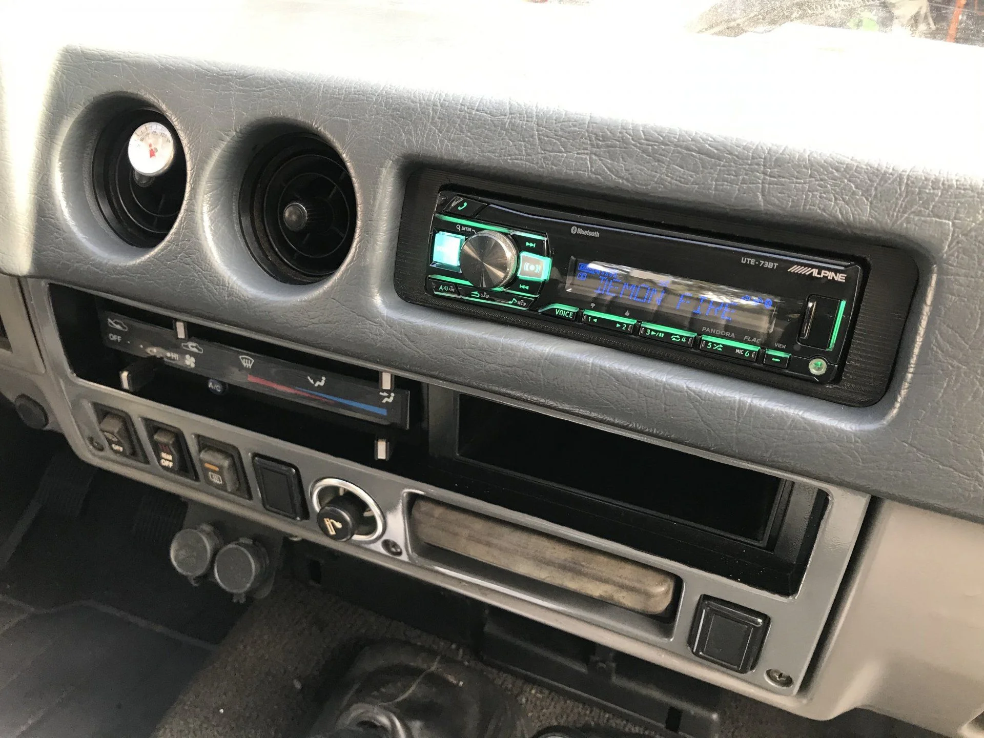

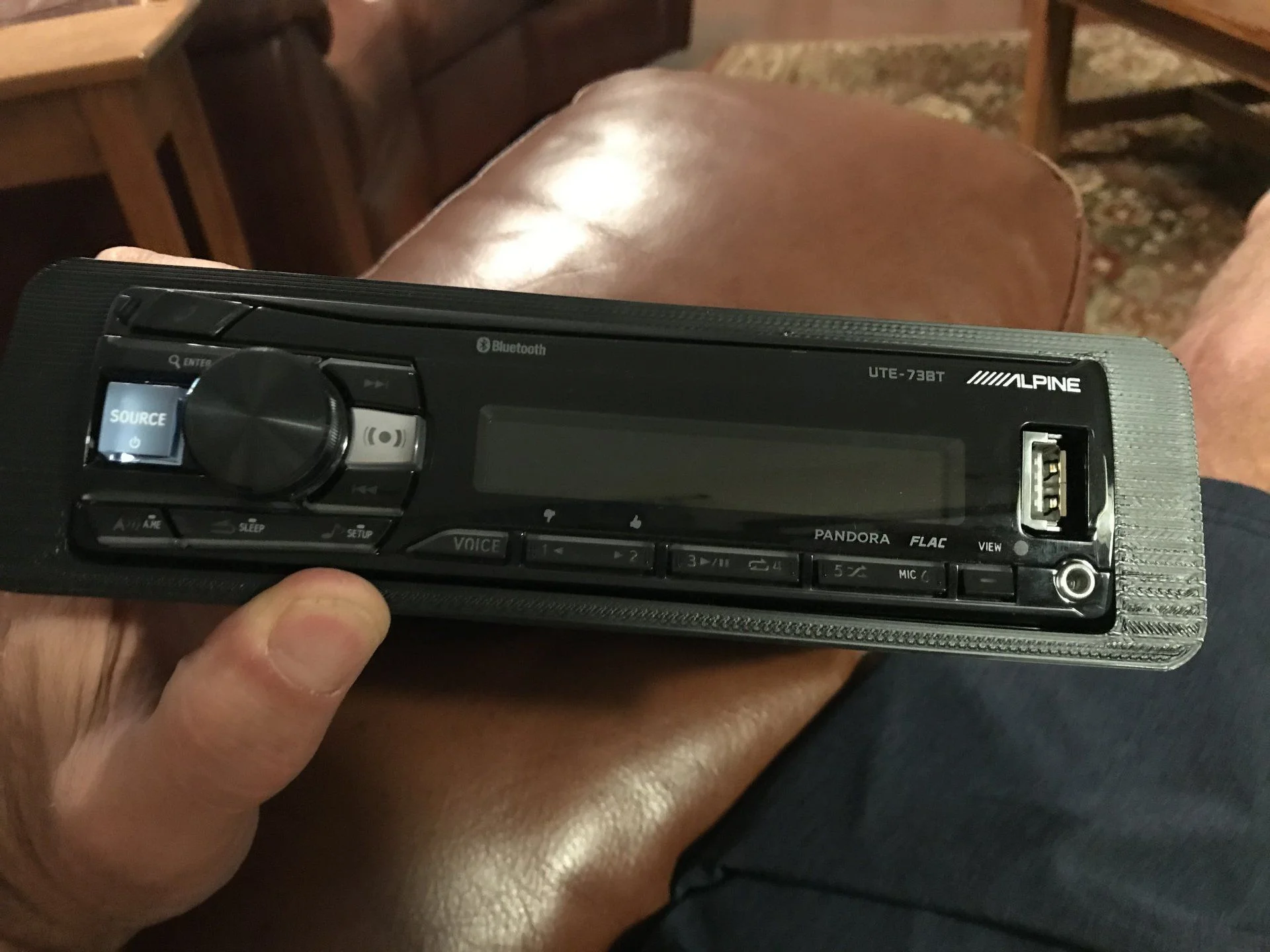

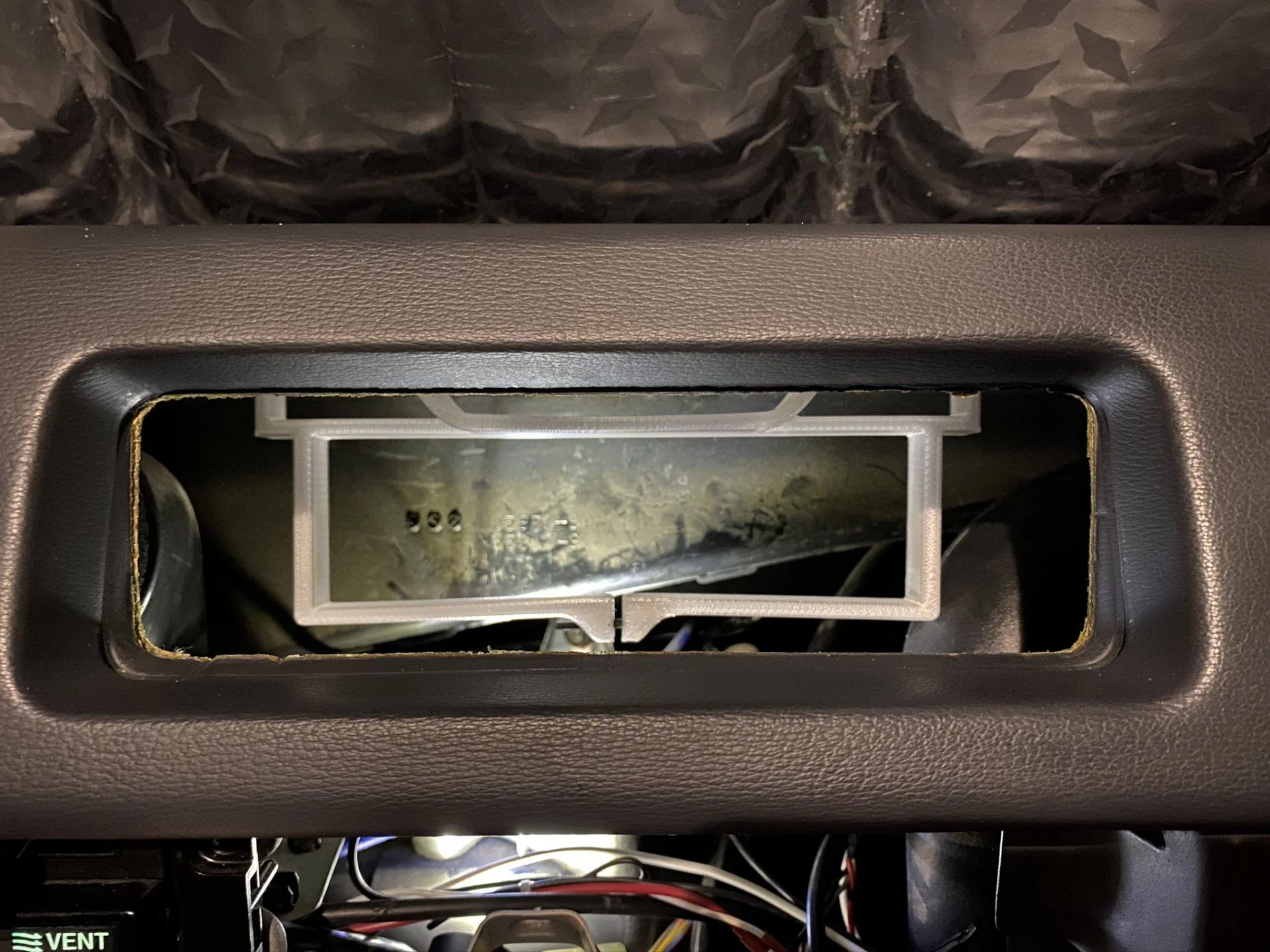

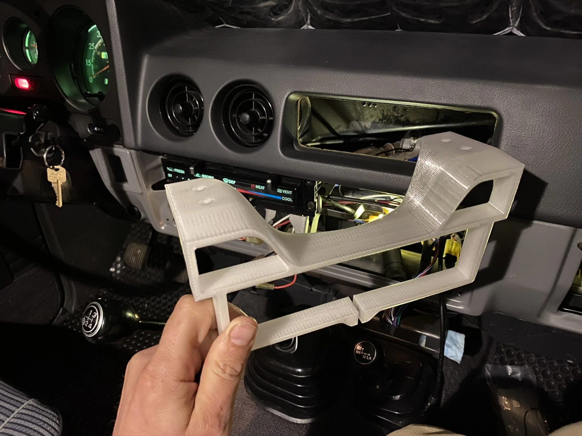

Bracket worked great and I used the larger faceplate for my alpine opening. It was easier to detach the faceplate. I did a little trimming around so the face plate slid over the receiver and then glued it together.

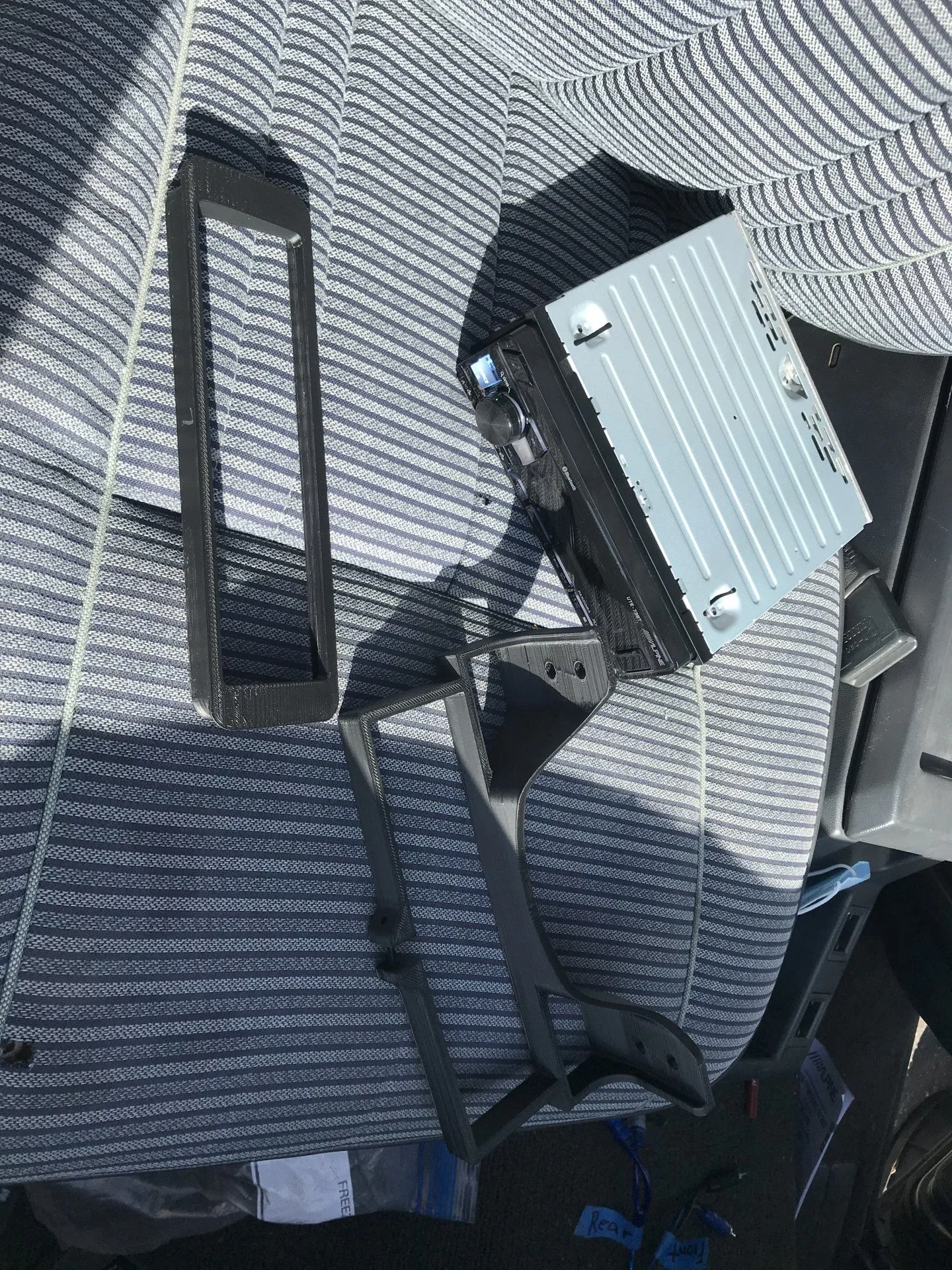

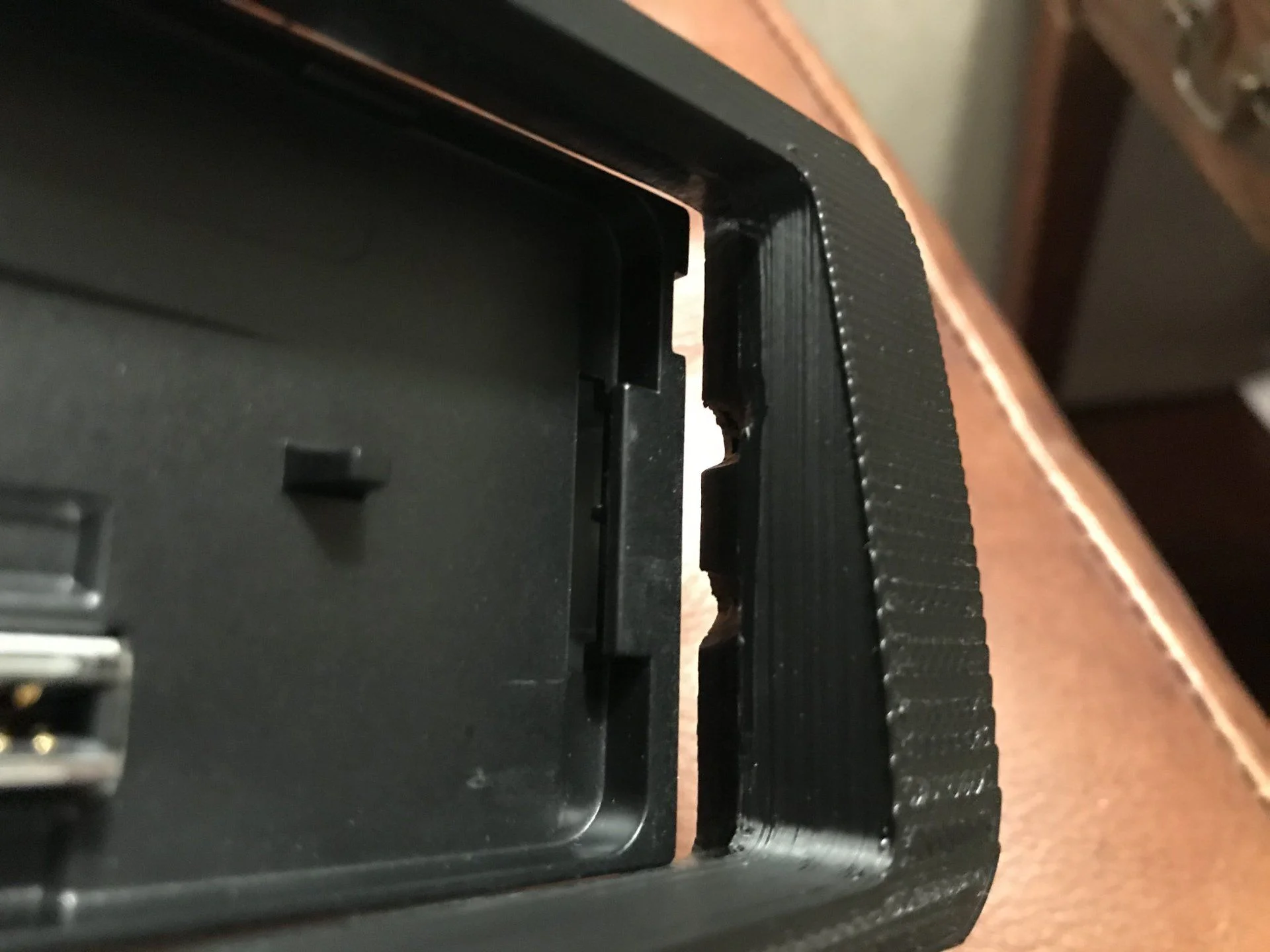

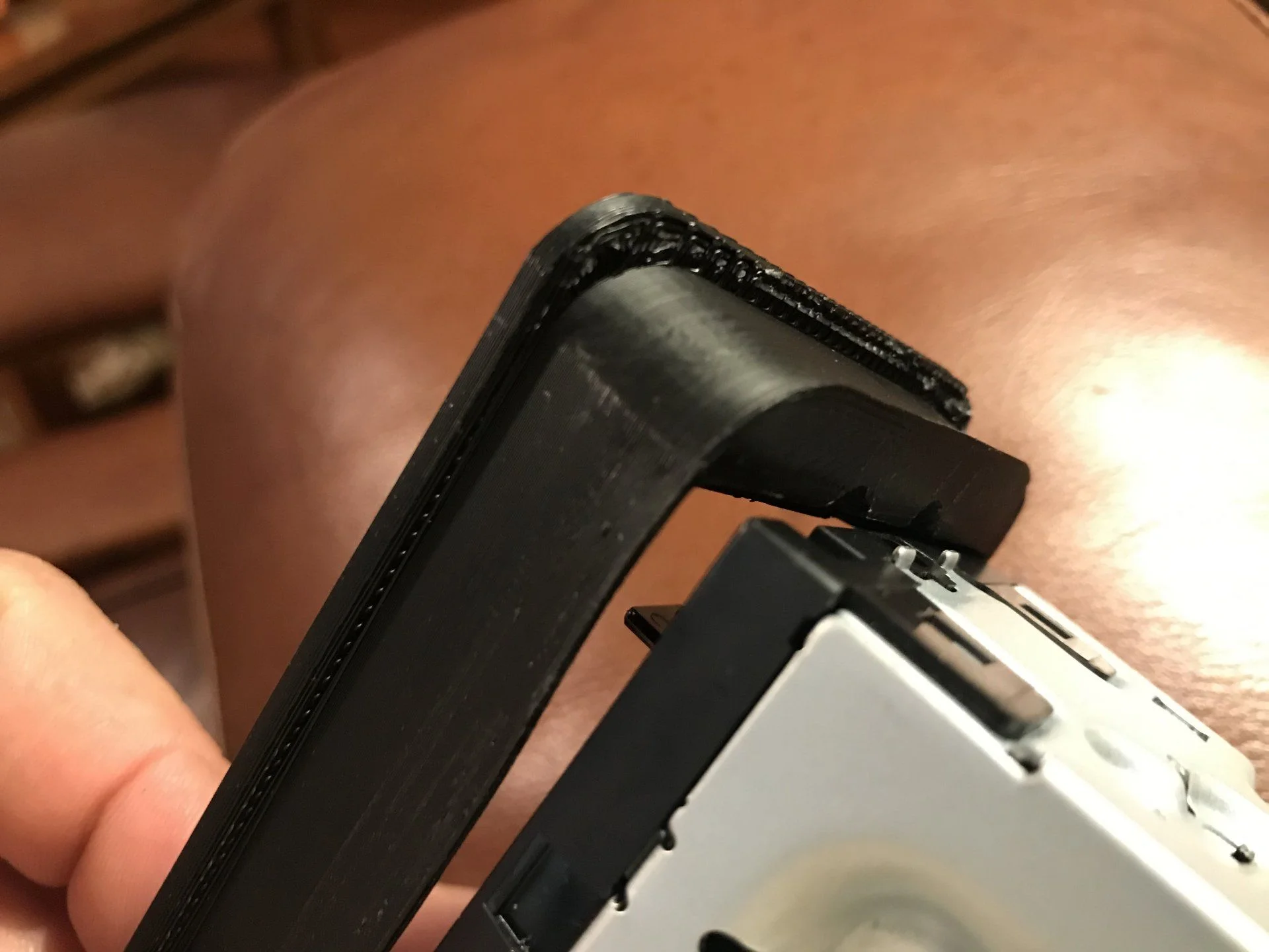

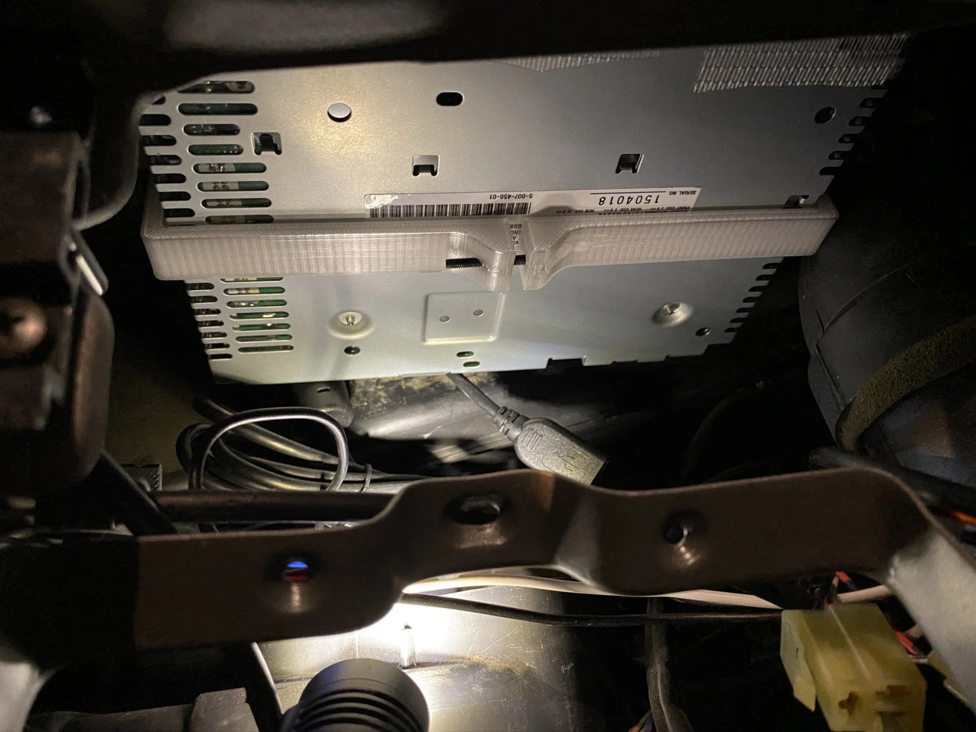

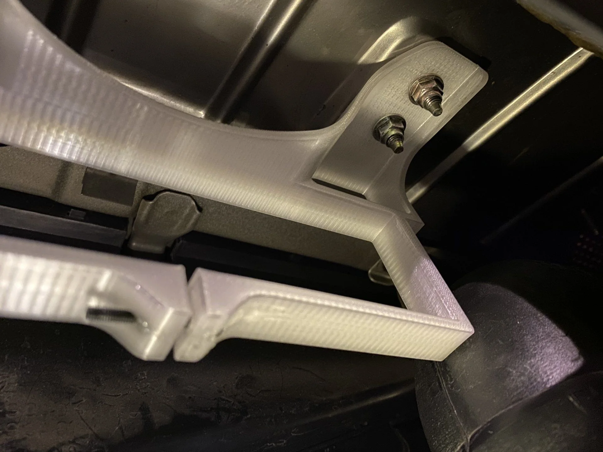

The head unit is mounted using the factory mounting bolts and a 3D printed bracket. The bracket has a pinch bolt to hold the stereo in place. It took a few tries but it fits really well now.
I also printed a faceplate as I didn’t want to cut up the factory faceplate. This faceplate would probably work for other head units, but it might not. I didn’t sand the build lines out of mine because I think it looks better with them, but you could sand it smooth. I added a high clearance ("HC") version to the folder above which should work with more head units.

View attachment 2528203View attachment 2528202View attachment 2528201View attachment 2528213View attachment 2528219
Looks great! Quick question, is that a dash pad cover you have or original dash? Looks to be in great shape.

Just a quick reminder to print these in ABS, PETG, or Nylon. PLA will melt in this location. I'm so pumped you guys are using the designs.

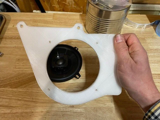

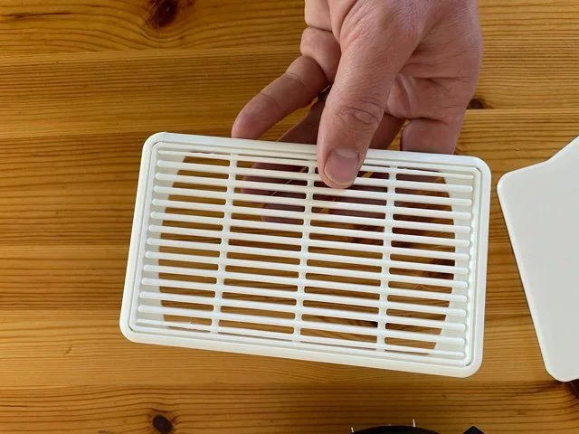

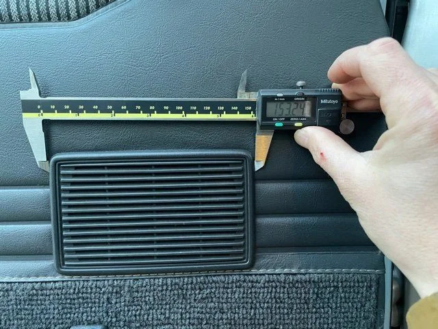

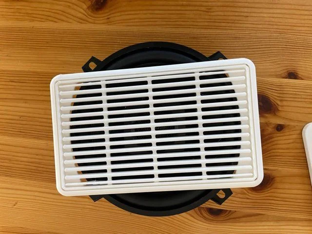

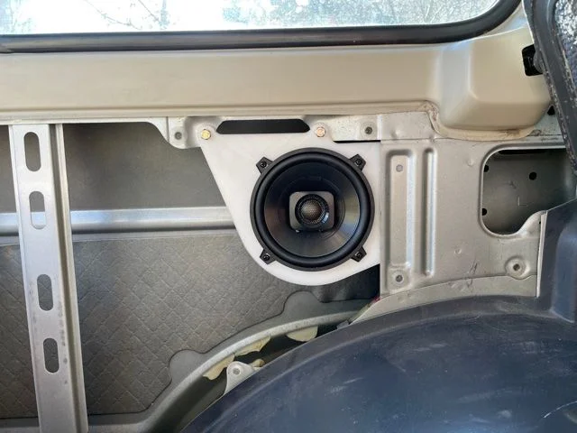

I'm working on the rear speakers and will post those files and an overview sometime over the next few weeks. I'm using the same Polk 525 speakers and mounting them in the most OEM way I can come up with (without messing with trying to get them into the rear doors). This involved creating a bracket and speaker grill. I created a CAD model of the front speaker grill (the blue one below) and printed copies to use on the rear. The opening is annoyingly small, but the front speakers sound great so it must not matter much. The bracket is flat and could be easily fabricated, but it was just easier for me to print it.
@coultl Thanks for posting these files! That rear speaker mount looks awesome. Do you have to drill any holes in the fender or does it mount to factory holes?
It will use three of the existing holes but I'm going to drill one additional hole as I think it's needed. Overall, very minimal messing with the original steel.

Yeah, I was poking around the front and I think fitting larger speakers would be really tough. The biggest issue is that the speaker can't be too deep. The Polk 525 is a pretty shallow speaker and it still needs to be spaced out to keep the magnet away from the window. Also, the speaker grill is so small that a larger speaker might not get the air it needs.
All that said, I think others have found a way to do it!
