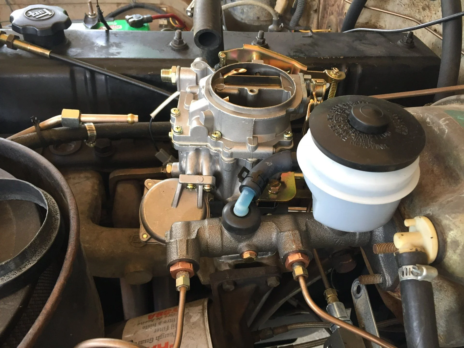

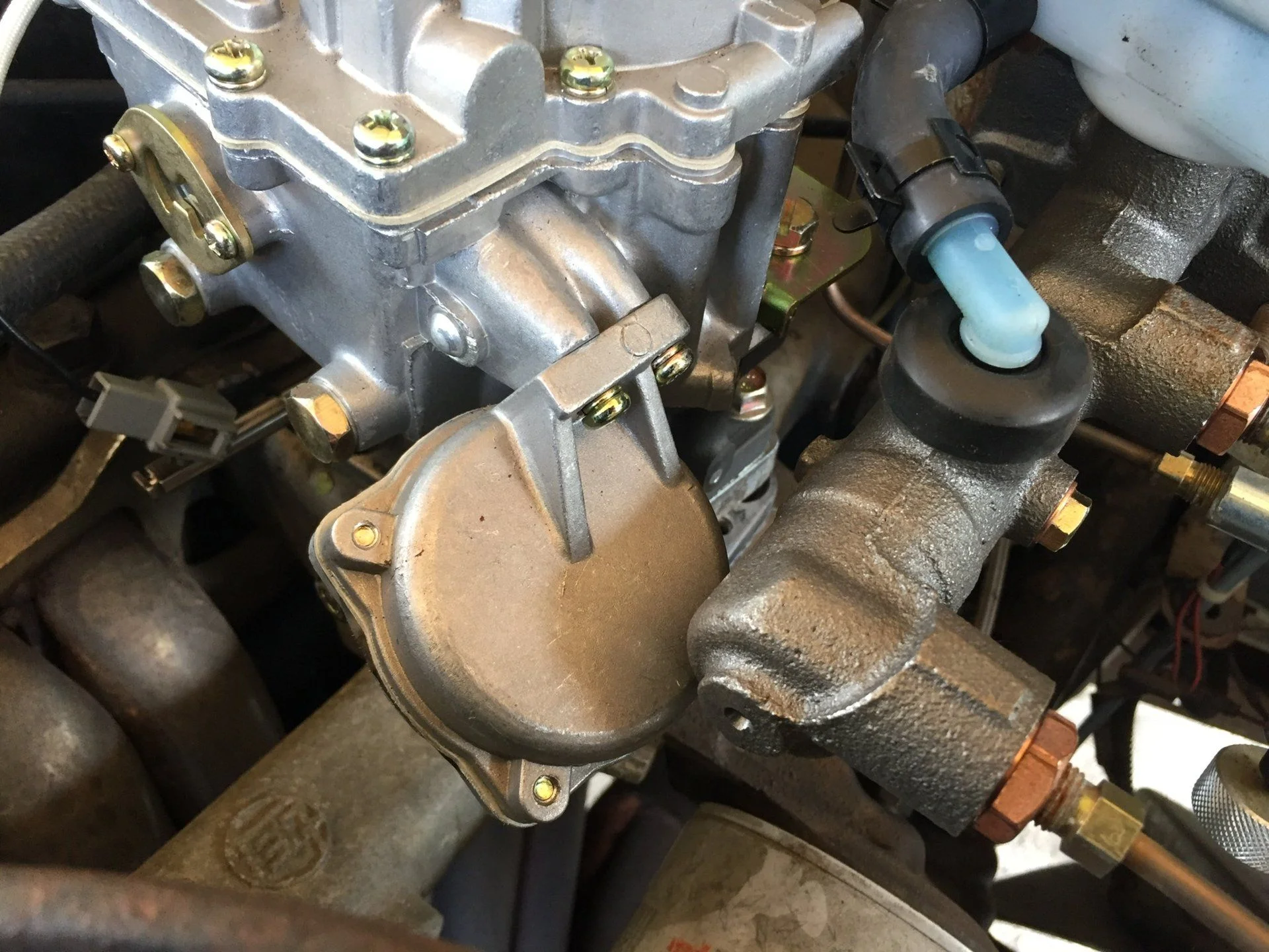

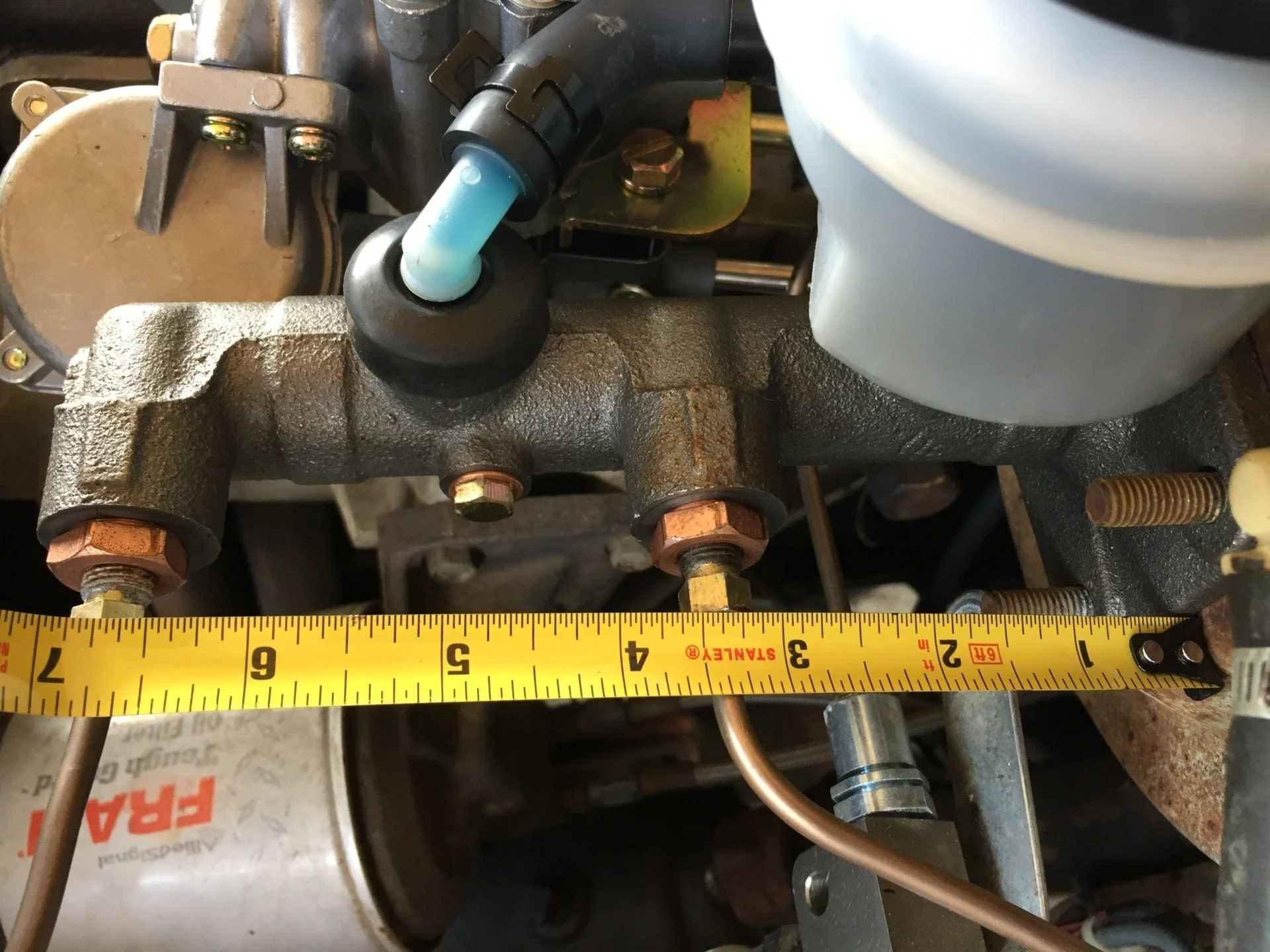

2F carb with the vacuum secondary is in the way of the MC, and I've now tried 3 different MCs - each one shorter than the previous. I just can't find a dual circuit one that is shorter than 5 5/8".
Have any?
I have stock. Was sick all last week and my guys don't know how to work the shipping. So every order I have will leave today.
@Trollhole in need of an F carb.
Have any?
Lets see a pic of your issue?
A later 80-87 intake manifold would probably make it work. Is that just the single diaphragm brake booster?
You know Marshall, I didn't even look at that. Probably given its an older, smaller unit.

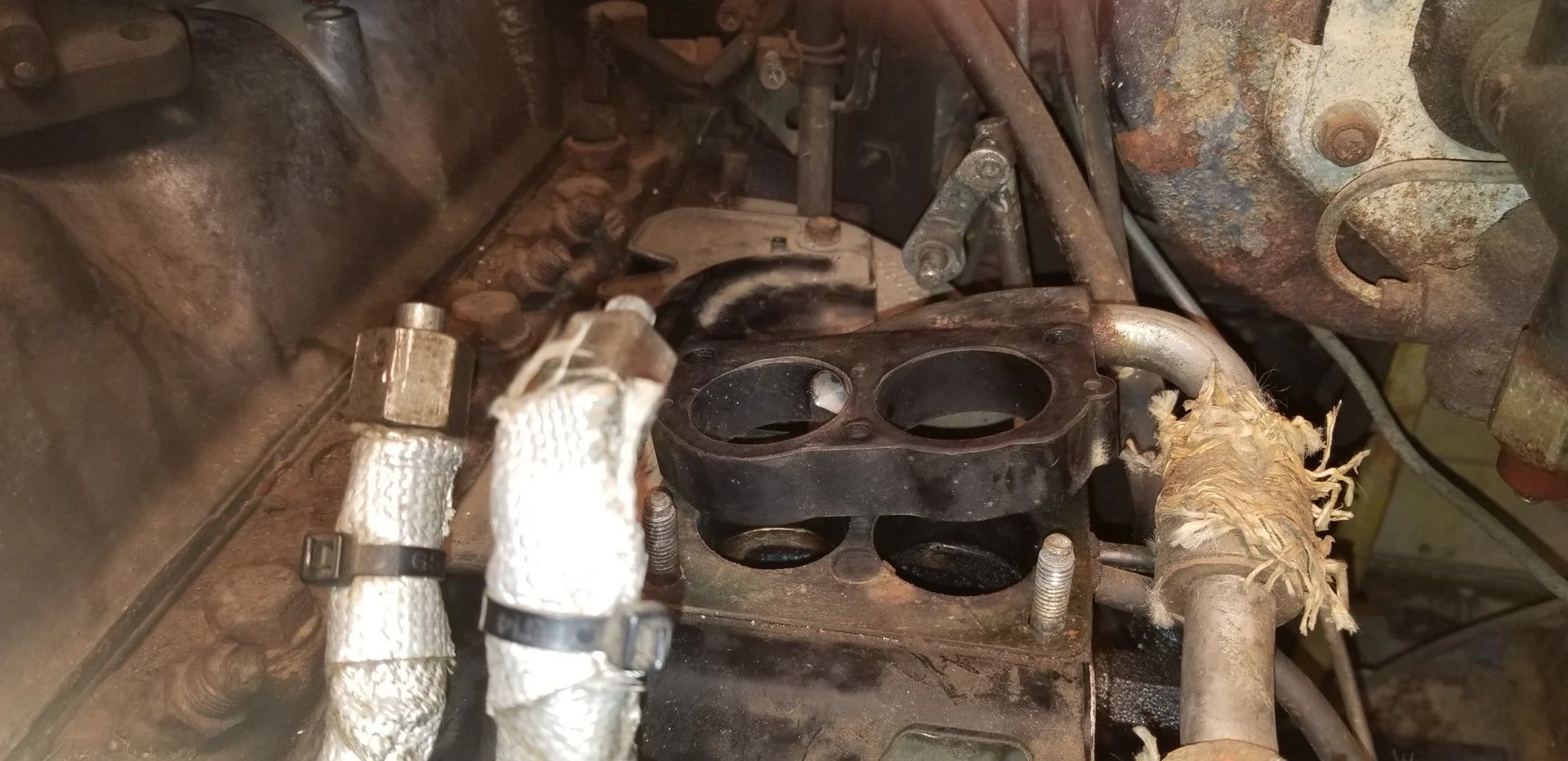

Hey folks, need a little help here. I'm in a dimly lit barn trying to install this trollhole carb. I'm sure the answer is here somewhere but I can't seem to find it.
Do I need this part that I pulled out of my aisan carb or do I just mount the TH carb directly? This looks like the insulator plate but it was sandwiched in my aisan carb...not on the bottom. It's also not a rectangle . I'm thinking it shouldn't be included but then I'm not sure what to do with the fan connection...if that's what that is.
Obviously my mechanical knowledge is limited, but I'm trying:) thanks in advance for helping me out in a pinch
Ok...I think the insulater plate is actually different and against the manifold. This piece doesn't belong in the new install is what I'm thinking.
Still not sure what to do with that air connection though

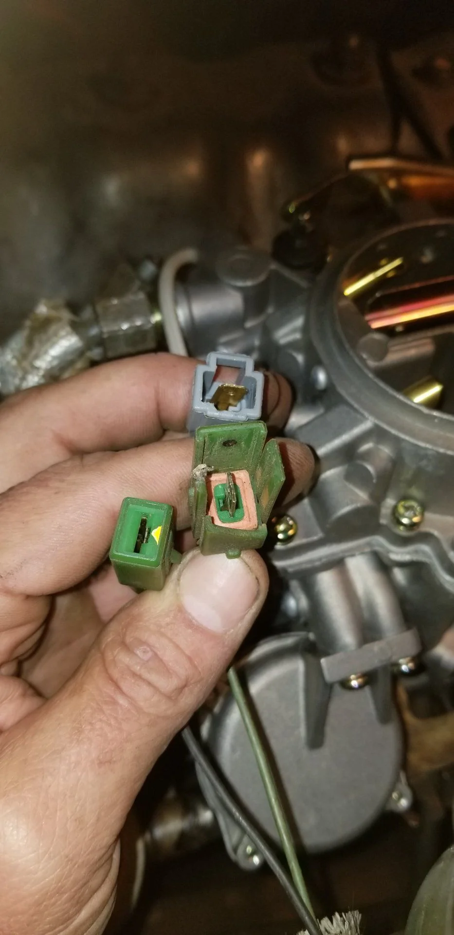

Update: I left that piece out and installed TH carb directly. I plugged the connection from the air fan. The TH carb electrical connection didnt mate up to the green connectors ( see picture) so I just pulled the plastic off of the carb connection so it would work. I connected some spare elec wire to the other green connector and ground it to the fj.
I connected the single vacuum port to the distributor and capped the others.
Not sure if it's all right but she fired up and ran well.
