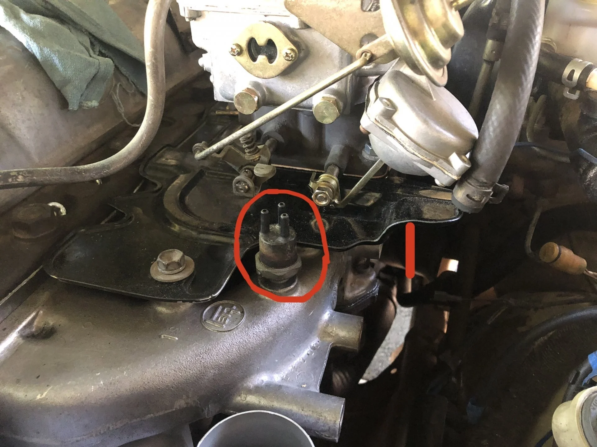

4. Intake Manifold (large) Brake booster ports (see photo #2) on right and the small triple port (#1) black valve on left side of intake manifold- cap off?
YES, cap off all.

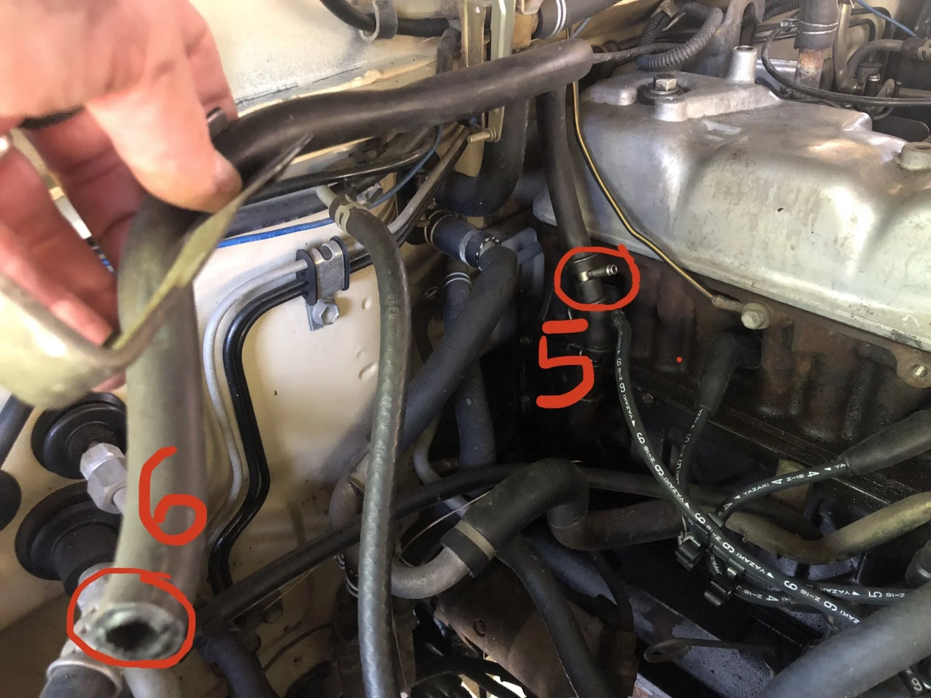

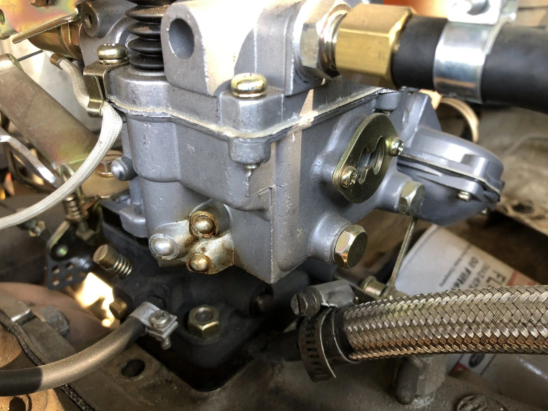

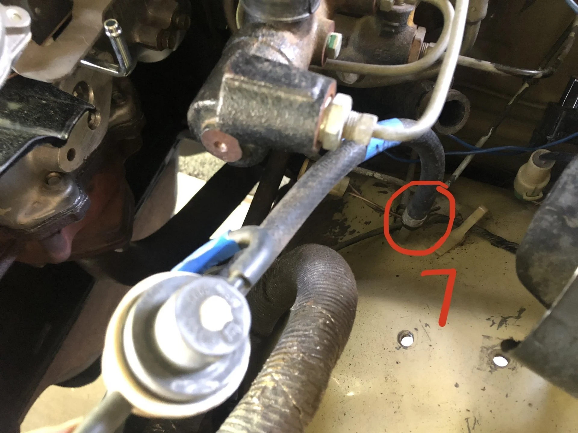

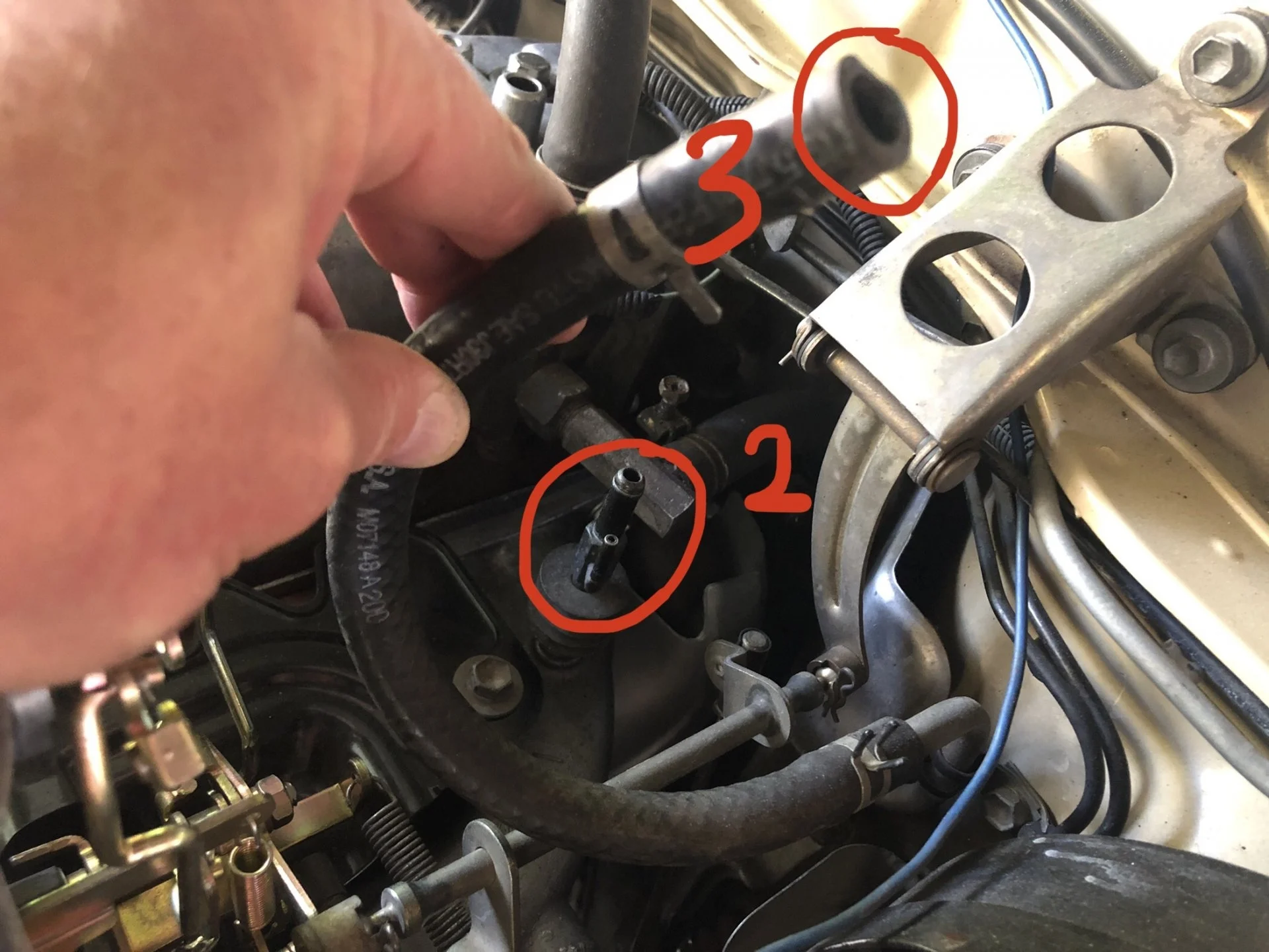

5. Photos of hoses to close/cap or hook back up (see photo #3, #4, #6, #7) and T connector #5
Still need help with these...
