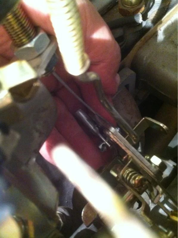

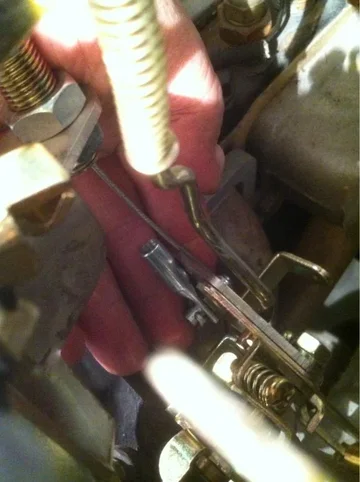

Finally got my throttle cable from SOR. Went to hook it up but cant figure out how it goes together.
I read Im supposed to cut the lead barrel off the end and attach to the lokar end on the carb. Well that end is threaded, and I dont see where you secure the cable to the lokar part??? Just looks like im sticking a cable into a larger hole with no attach points... I must be missing something.

Ok here's some pics. As you can see the thing that I'm suppose to stick my cable into seems wrong.
Am I missing a piece that maybe threads into that hole?

Yeah. PM me your address and I'll send you the correct adapter. I don't know what I was smoking when I sent that to you.
