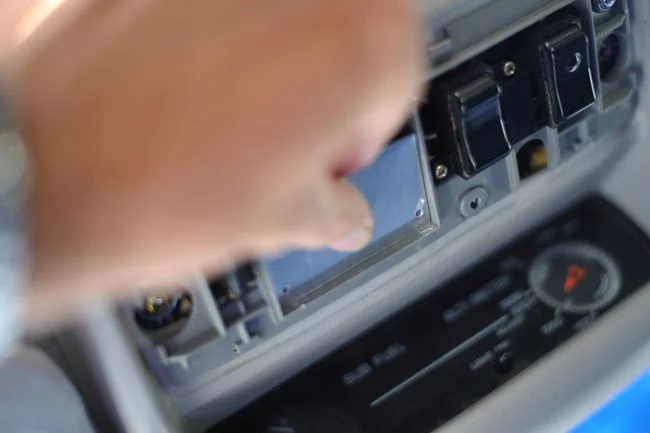

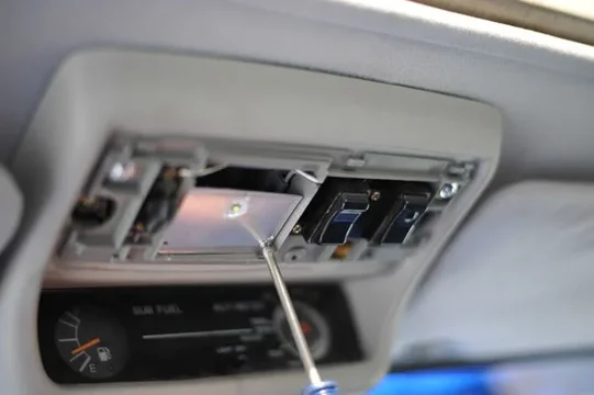

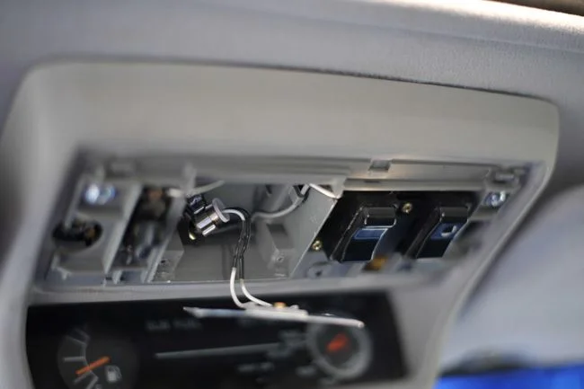

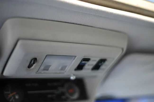

Mark the holes for the screws and use a 5/64 or smaller drill bit to make the holes for the screws
Put the new led base in the socket where the incandescent was
Fasten the plate with the supplied screws

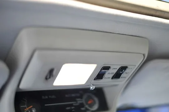

Put the map light cover back on
And check out the new sweet light :cheers:

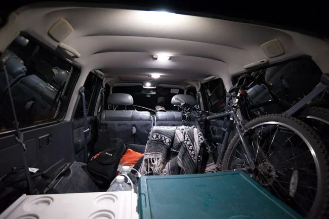

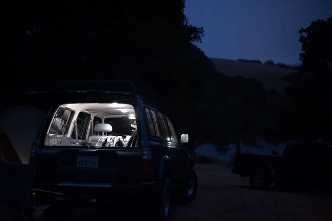

Glad you guys are liking them!
Here's a couple of shots when I was camping at MotoGP a week ago to give those without them an idea of the luminosity.
