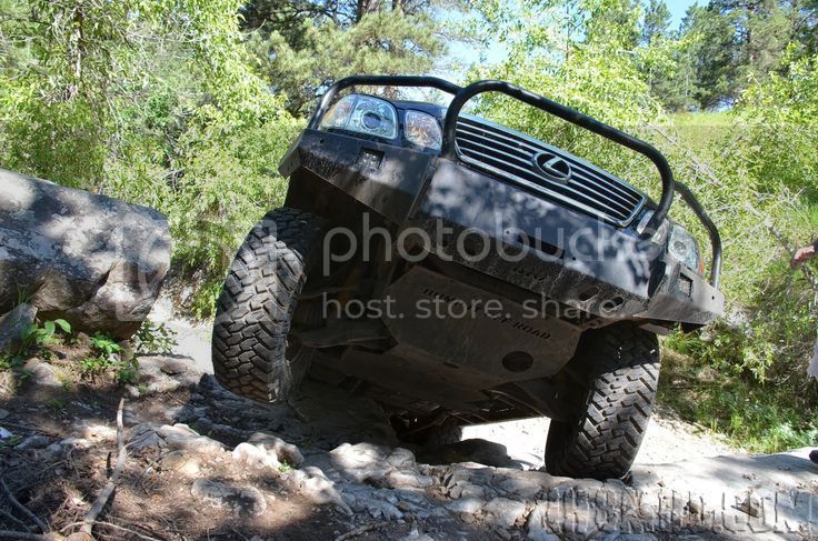

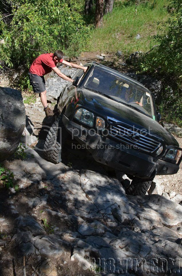

Yes it is the same LX. Here is a pic of the BIOR sliders and skids put to work. The bumper cleared the obstacle.
Pictures do not do the bumper justice! When I first saw pictures I thought the same things mentioned here but you have to see it in person. It gives great clearance and is SUPER stout. You could plow through a deer at 70 and I don't think it would do a thing. Mike does awesome work.
BIOR is on the right;)
x2, the pictures are not telling the whole story. This picture is better, but I see Mike's truck fairly regularly, and it looks much better than these pictures.

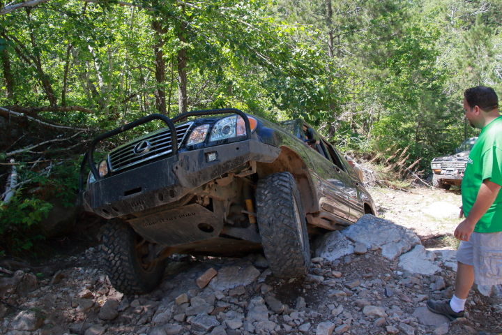

If I remember right, mike has his original version on his. At least I think he did when I met him a HiH. I personally like his old version better. The extra angle at the top of the bumper looks nice but I think it also contributes to the bulk. When I was building mine I toyed with having the extra angle but in order to have it the bumper would have to be much bigger to accommodate the winch.

Another thing to consider is the winch access, while I like the clean look of having no access holes in the front, the top access will not work if you plan to ever run a light bar. Also, you will notice the stock bumper has an opening across the front, this is for air flow, the bumper covers almost half the radiator so in my opinion it is crucial to have some type of cutouts in the bumper. This would likely not cause an issue in colder climates but could in hotter climates. You will notice that most aftermarket bumpers will have some kind of cutouts or opening across the front.
Lastly, the weight would be something to consider as well, it looks to be a very heavy bumper, you will feel it on the suspension and it will have a negative effect on the ride. I do believe it is built very well and stout but I also believe there is such thing as overbuilt as well. I'm not saying that this one is as I do not know the weight of the bumper but when I see 1/2" steel being used for the mounting plates it leads me to believe it could be. I think bumpers are one case where bigger isn't always better:)
I'm not trying to discredit mike at all as I do believe he is a great guy that builds a great product, just trying to give you some things to consider while making your decision.

I honestly do like the look of the bior main bumper but the bull bar is what kills it for me personally. I see what he was tying to accomplish but I don't think the bends have a tight enough radius to pull it off.

It looks to me that he just moved the wings back a bit, here's another photo I found of my original BIOR front bumper. Mike's product is rock solid, I got one of the mounting points stuck under a root, I couldn't go forward and couldn't go back, so we literally had to winch at about a 75 degree angle to break through the root and pull me up. The ENGO was a champ, but the bumper didn't flex at all, and there was a a LOT of weight on it
Mike emailed me last night and said the the LX version can have the center section pushed back a bit, which I'm awaiting more details on.
