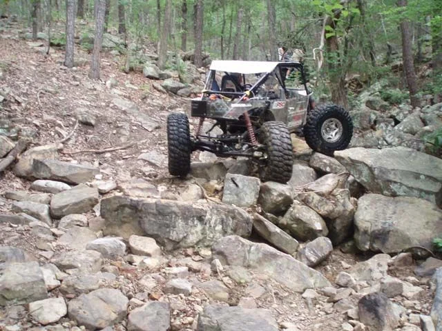

got a little seat time in this rig this past weekend....
impressive...very stable...
