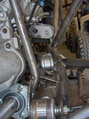

Lots of stuff going on that's hard to see......plumbing started.......exhaust to be finished today and then off to be coated......1st protype bezel made/reduced size to match the cutdown hood.....front bottom link frame attachments and front upper link double sheer attachment points progressing. The arrival of the cowl and hood will allow several areas to be finalized and completed.
But, what the heck is under that jacket?
Later, Jimbro

TOOL pictured? looks like hydraulic ram.
thought about a axle end press, but it does not appear to come apart?
then just a ball joint press, for those POS ball joint 60 end forgings people like to use?
damn anymore pics of this impressive piece? or to show at least its movement? with a hoist tab and that much girth you know it does something great. 1.5" plate bottom?
few more pics....lotta little things happening lately, not much for big picture items....
nice front driveshaft..
This is sweet
attachment.php
getting a 2 piece through a junk leaf sprung rig with a frame is hard enough. This stuff is very impressive.
see that little ridge down the front and back edge of the cowl as it's positioned into place? That is effectively rolled into the metal....presses the ridge to add a great deal of strength to the flat material.
