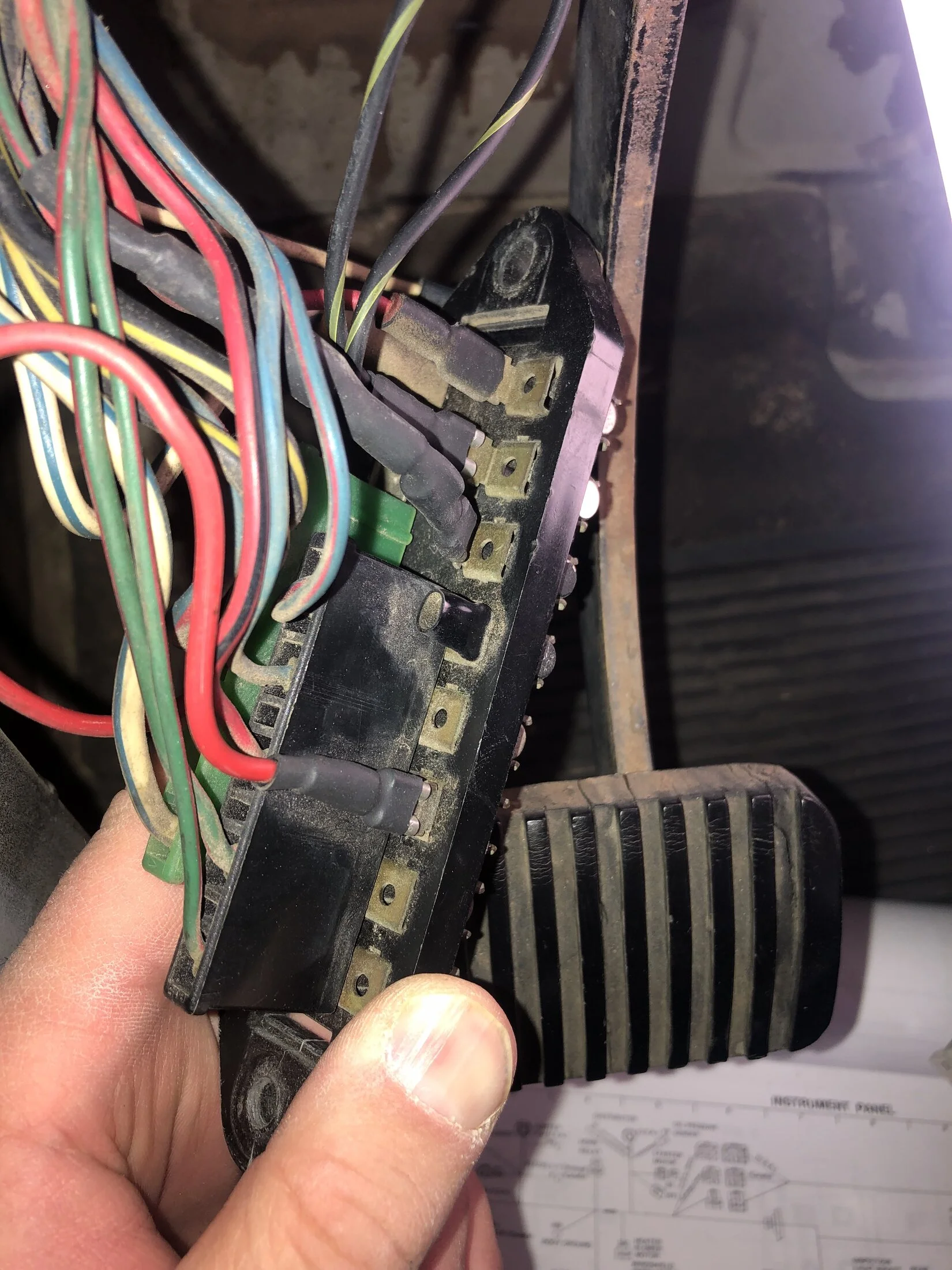

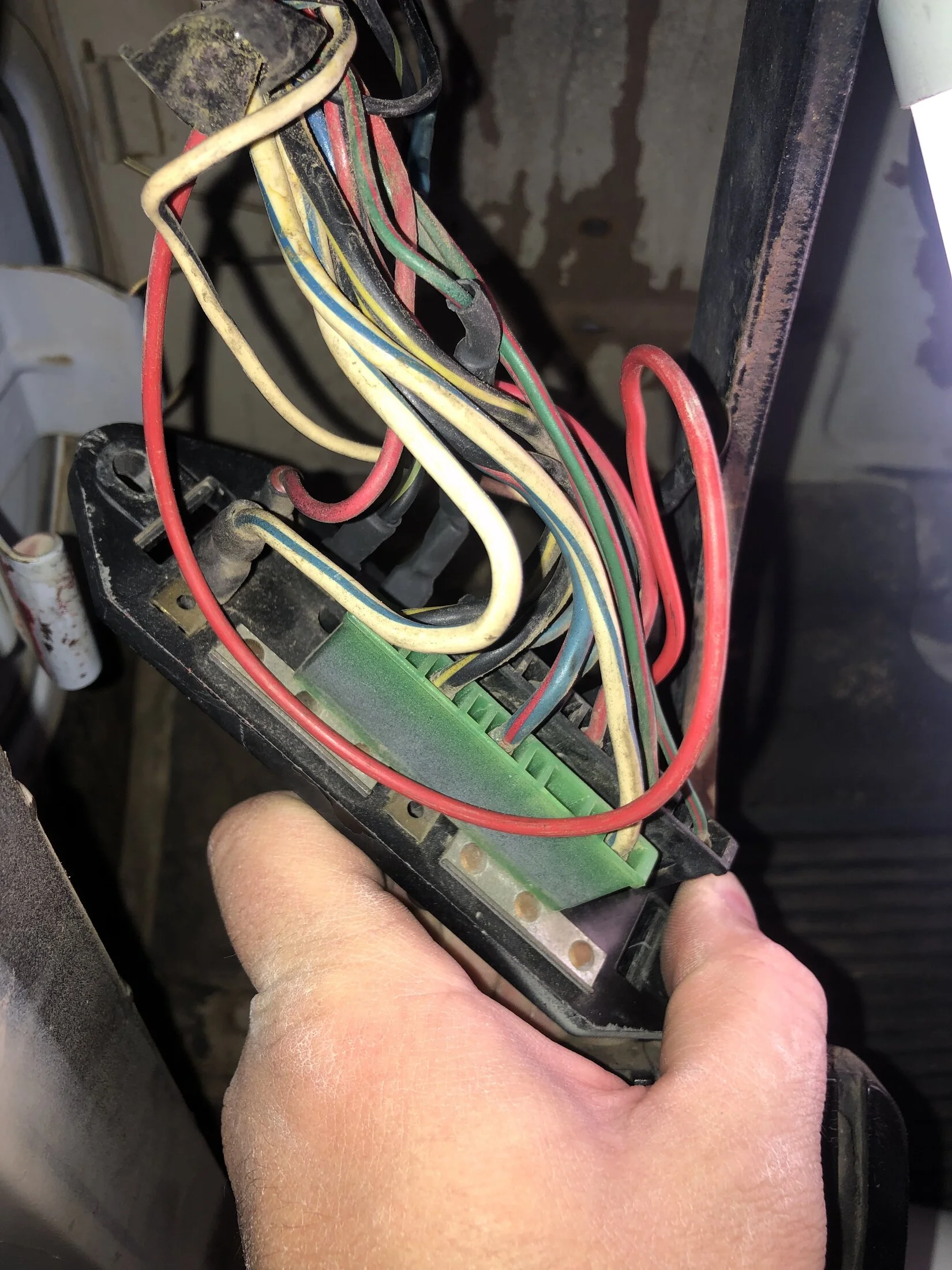

To answer your ? as to where else power could draw from. The main power comes down from ign and ties in at starter. I do believe there are circuits that have power when key is off such as hazards. If you pulled fuses then the draw is somewhere from fuse block to ign then to starter. I would look at back of fuse block for corrosion, pulling the fuses should have eliminated the hazard switch which would be my next target.

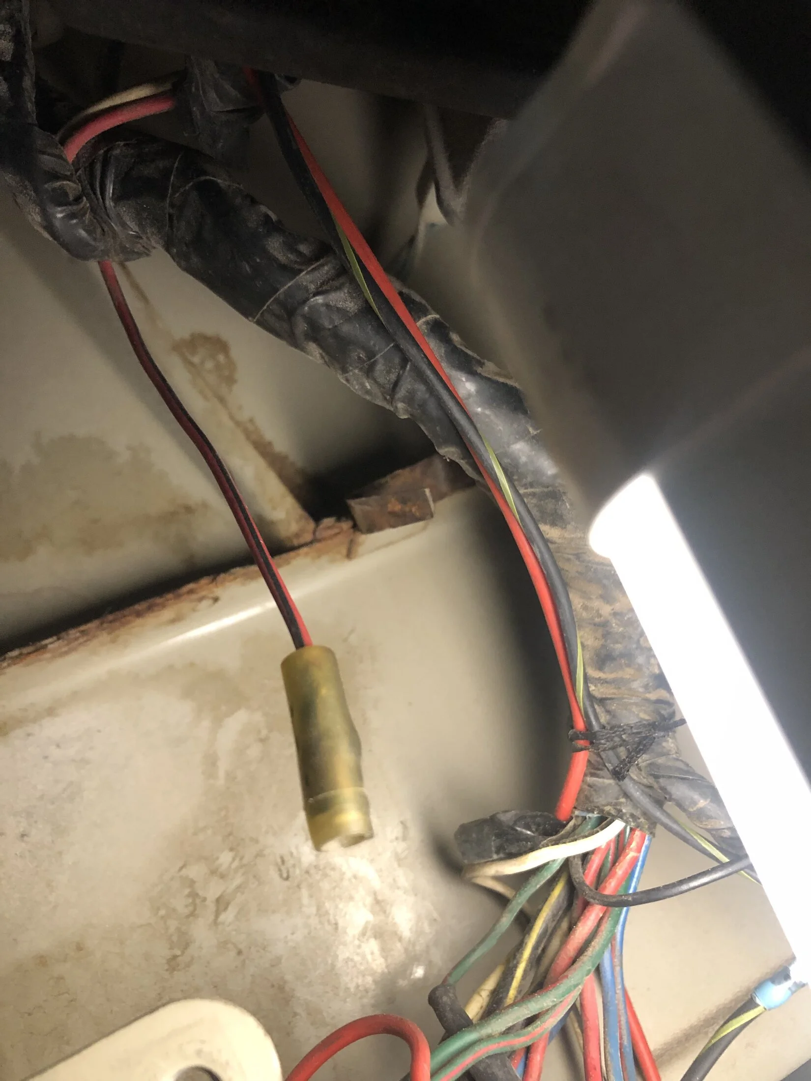

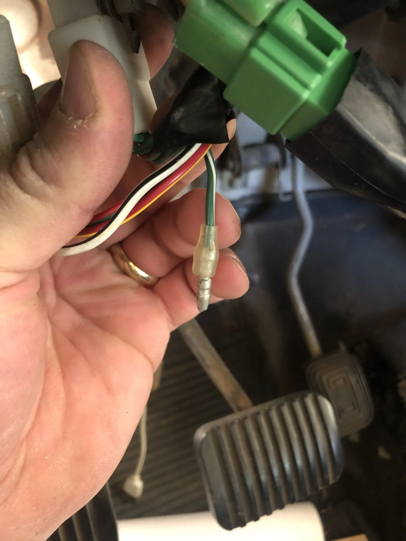

Ok. It’s been on the charger. I got it running and checked the alternator. It is running proper volts as per the FSM but I can’t seem to check amps. I probably blew my fuse. It showed battery charging. I checked the fuse box and it looks very clean. There are 2 wires I can’t identify. A red and black from the body with a female bullet connector and a green and white from what I believe is the turn signal harness. They where connected, I believe I did that some time ago without thinking… I’m not sure where they go or if it would cause a draw.

FYI: That Red/Black wire is a dome/dash light wire. If its's 14ga then it is the Cigar Lighter wire.
The Green/White wire is a left over from when the brake signal wire used to run through the turn switch. That stopped in 1974 when Toyota went to the separate turn signals in the rear lights.

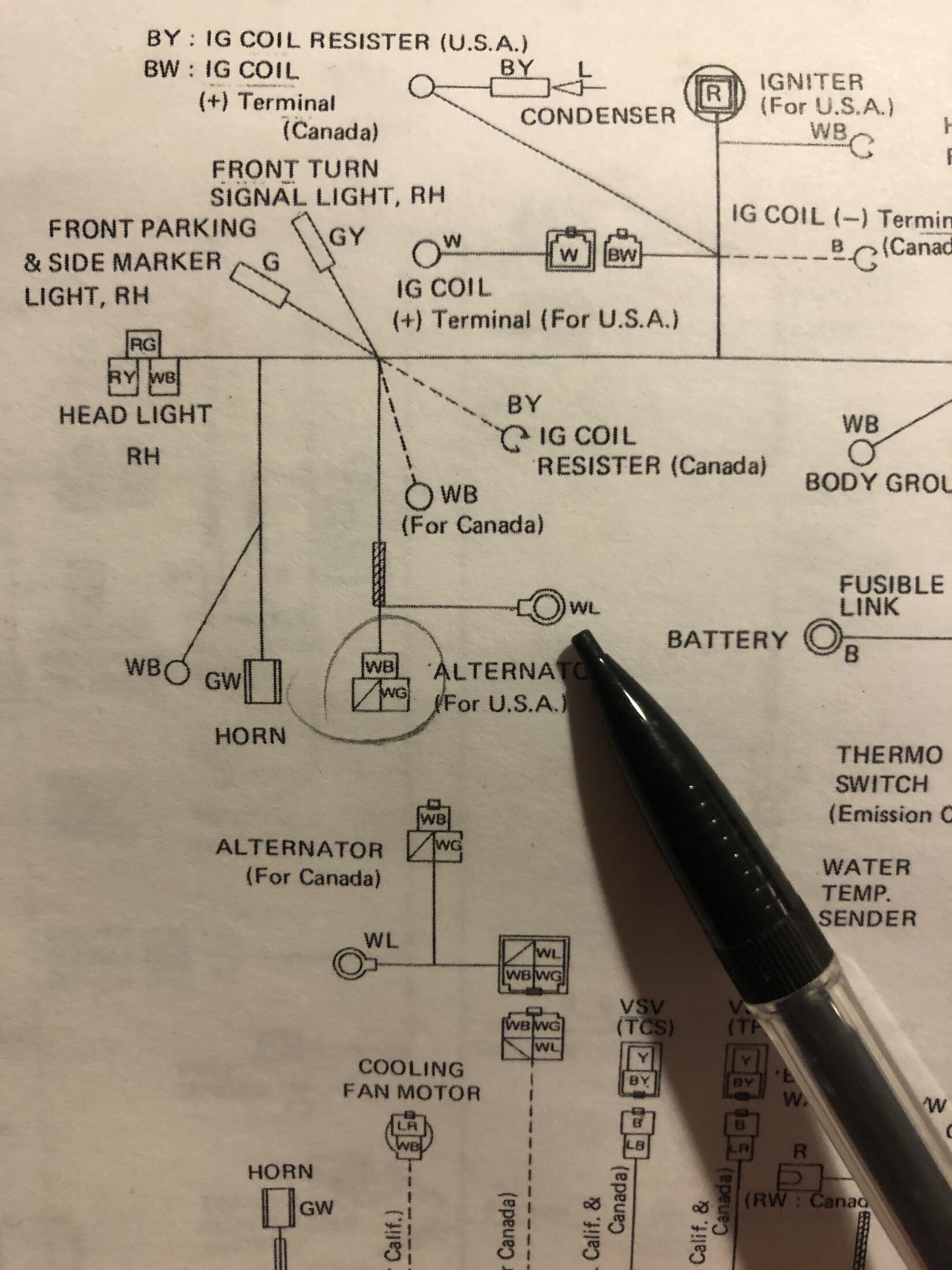

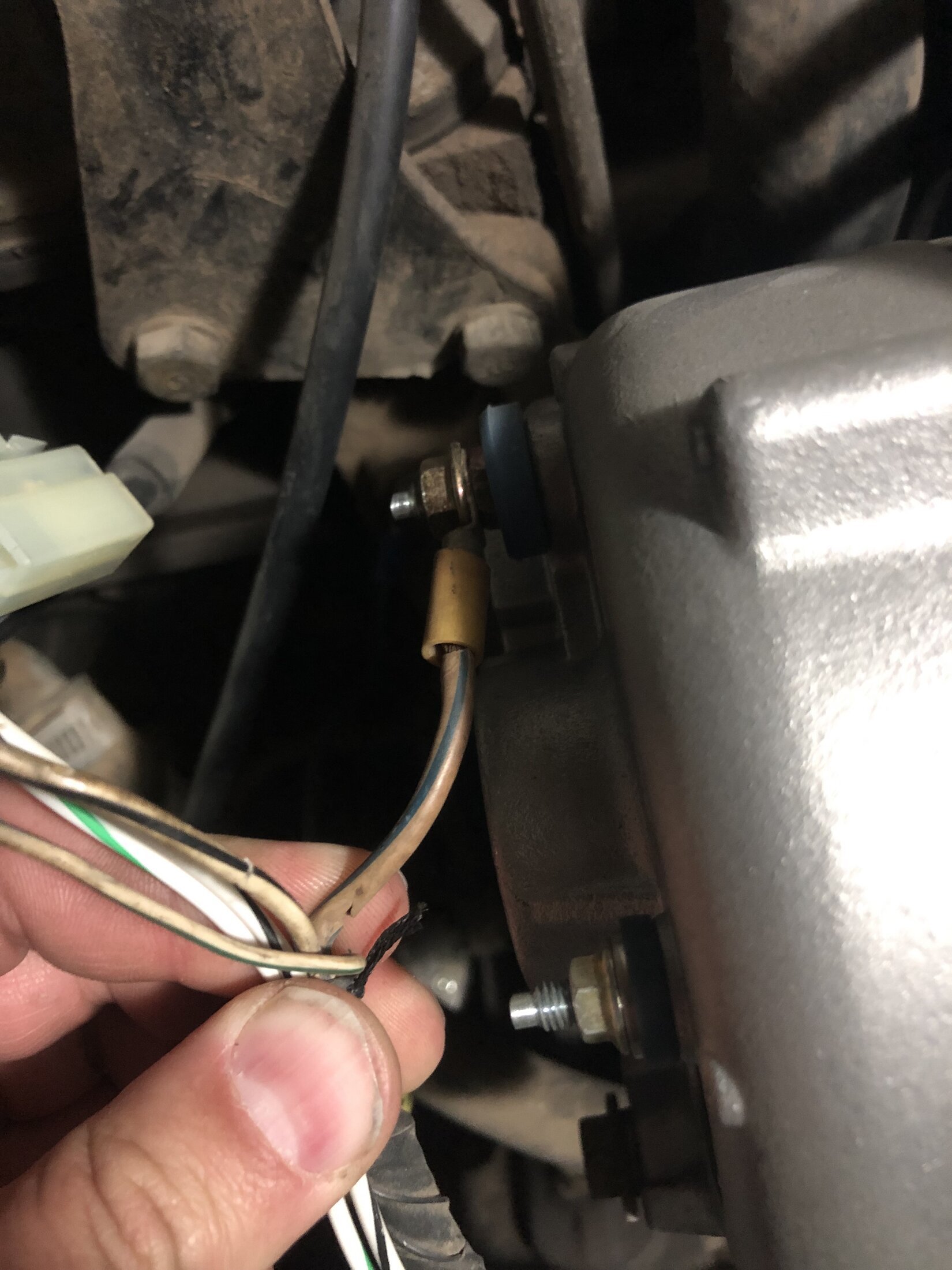

have new results. I disconnected the alternator a few days ago. Then forgot and drove it today and it started right up. I was headed to a car show and didn’t realize until half way threw the day! So I am now looking into the alternator and the last remaining wire that I haven’t replaced. I need to figure out where the other end of this wire is connected to. It’s a thick white and light blue (WL) from the alternator.
@MatthewMcD thats an interesting idea… it is not out of the range of possibilities with what I’m seeing!
Ok! I believe I have found it!!!! Oh my lord I think I’ve found it! My draw is currently .276. If I pull the plug off of the alternator, the draw is still .276. But if I pull off the white/blue terminal lug off, the draw drops to .032! I finally found the wire on the schematics. So I connected the white/blue wire back on the alternator and I pulled the white off of the fusible link and the draw drops to .003. I believe I need a new white/blue wire from the alternator to the ammeter and possibly white wire from the ammeter to the fusible link? What is the possibility that the ammeter would cause the draw?

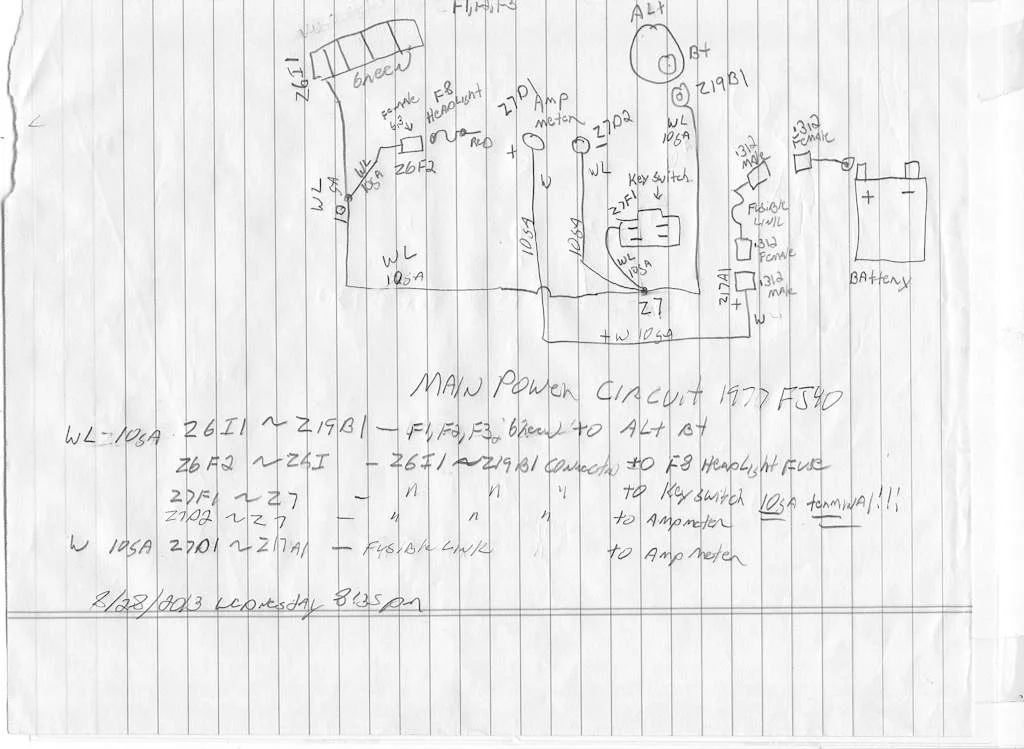

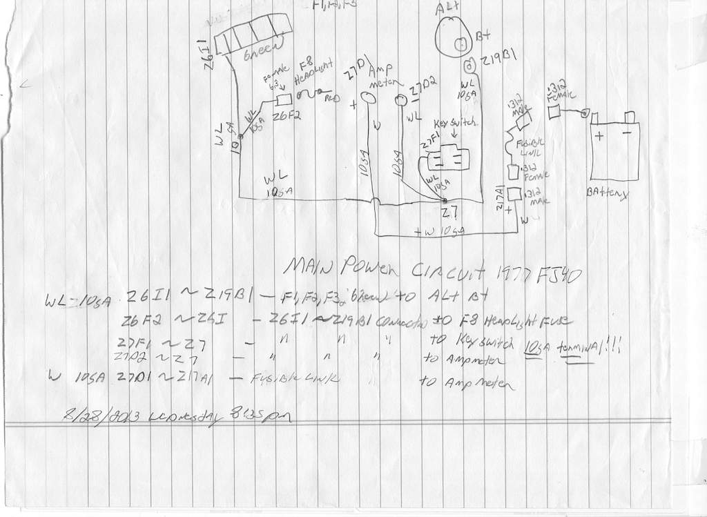

Drawing showing the always on power circuit for your 1977 FJ40.
From your description your problem is NOT the alternator. Your draw dropped when you took the WHITE wire loose. The white wire goes to the Amp Meter, through the meter to the White/Blue wire which is connected to the always on fuses in the fuse panel and the key switch.
I would reconnect the white wire and start pulling one fuse at a time on the always hot fuses until you find the one that causes the draw to stop.
