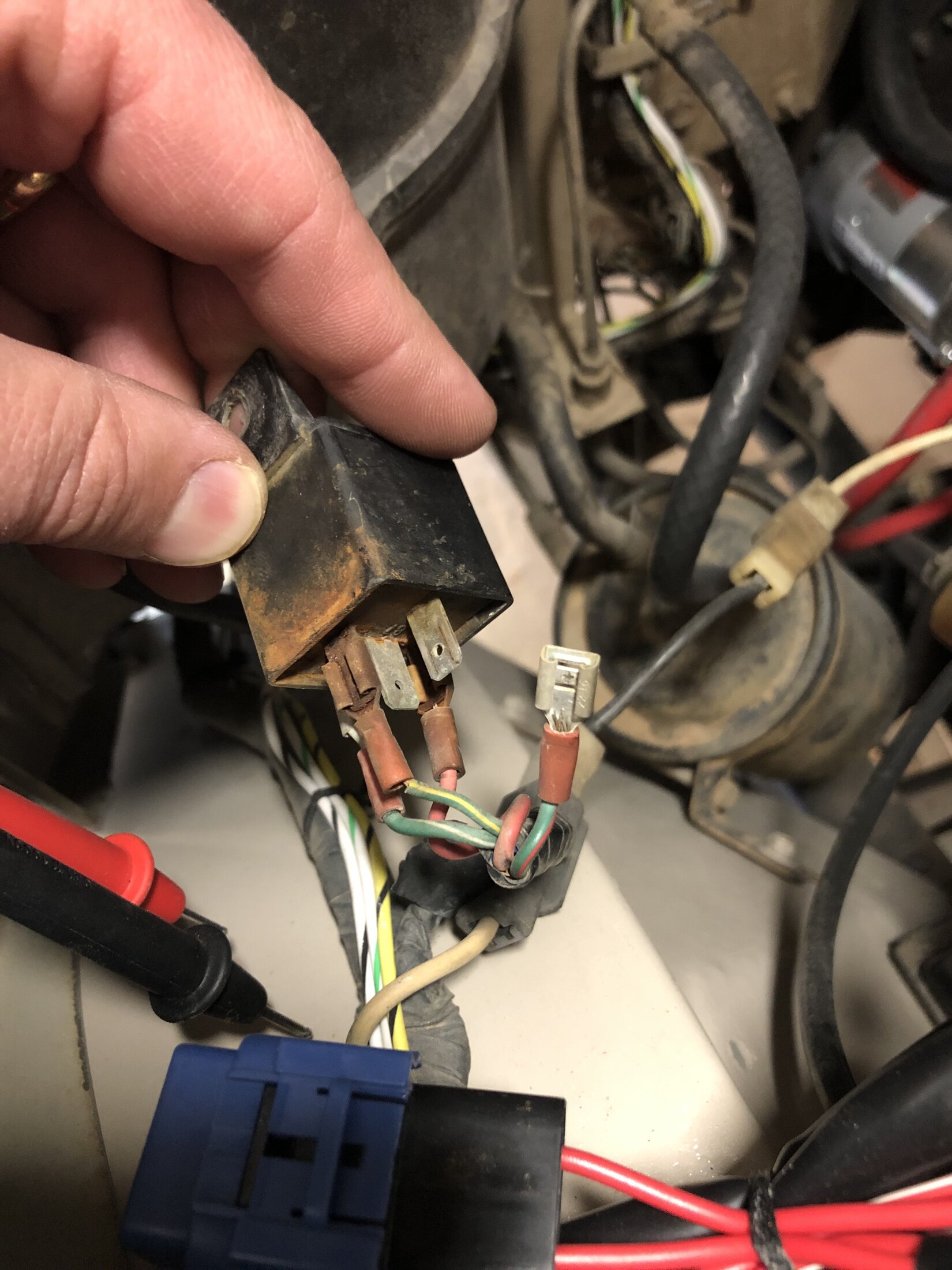

Forward to today. I have my 40 hooked up to a battery tender. and was able to poke around with a multimeter at the fuse box. The top 3 (tail, stop, and lighter) all show a draw of 13.16 volts with nothing on. There’s no voltage to the cigarette lighter, the horn works fine, but checking the turn signal relay it says it’s pulling 13.36 volts. Testing the system I had no right turn signal then spotty turn signals. I’m betting the relay has gon bad. But why is it drawing power when everything is off and why would the red and green wire be drawing power when nothing is on or connected to it? Is it a constant power wire?

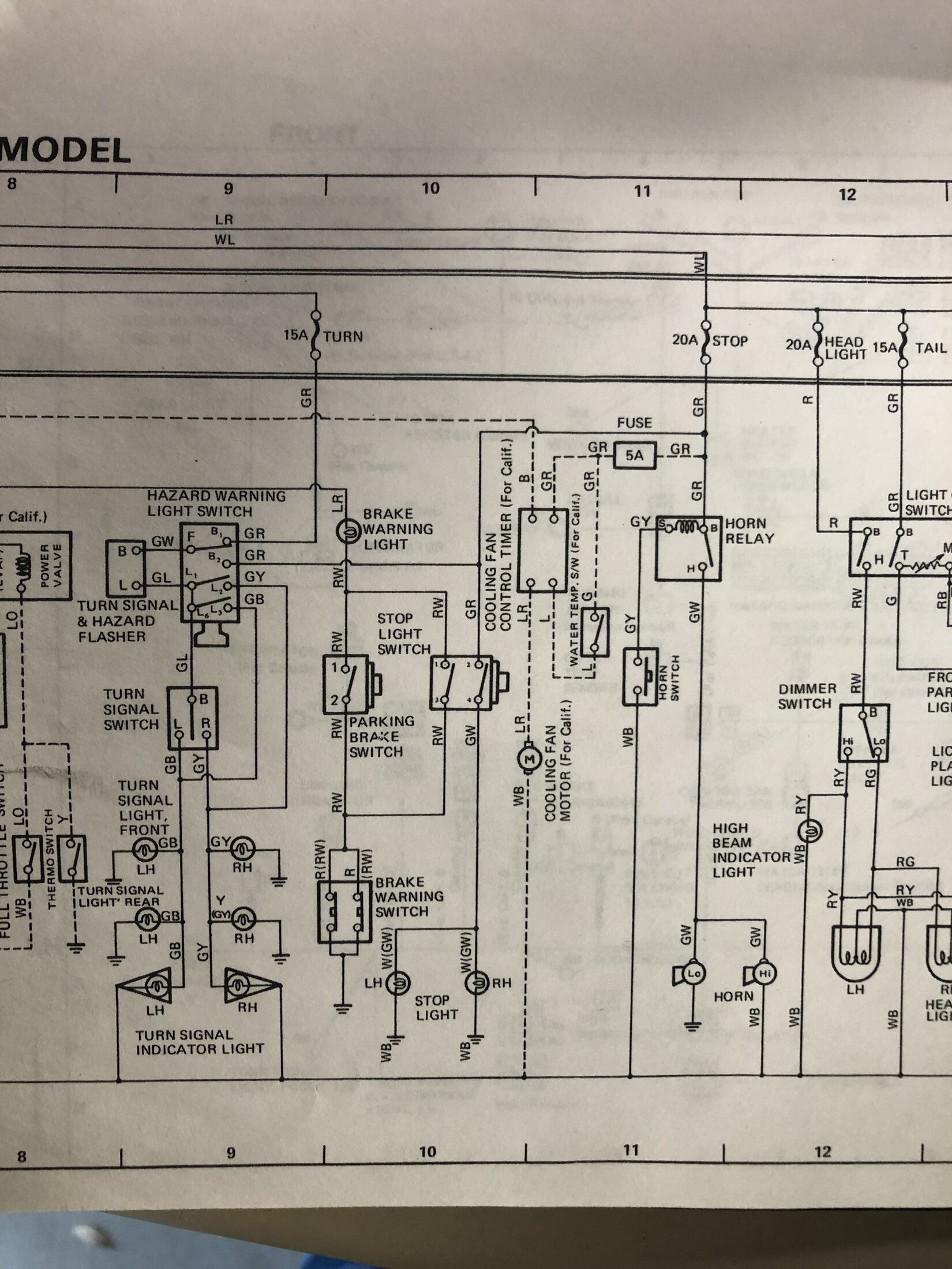

Nothing in your description sounds wrong.
Some circuits are permanently ON (at battery voltage), as shown in your wiring diagram, and only activated when you press the switch. These include - Stop lights, horn, headlights, tail lights, hazards, and maybe a cooling fan if you have one.
Check all of those things are actually turned off when they're supposed to be.
Pulling the fuses out can isolate the problem. If you pull the Stop fuse for example, and the battery still drains, then you know it's not caused by the horn or stop light.
