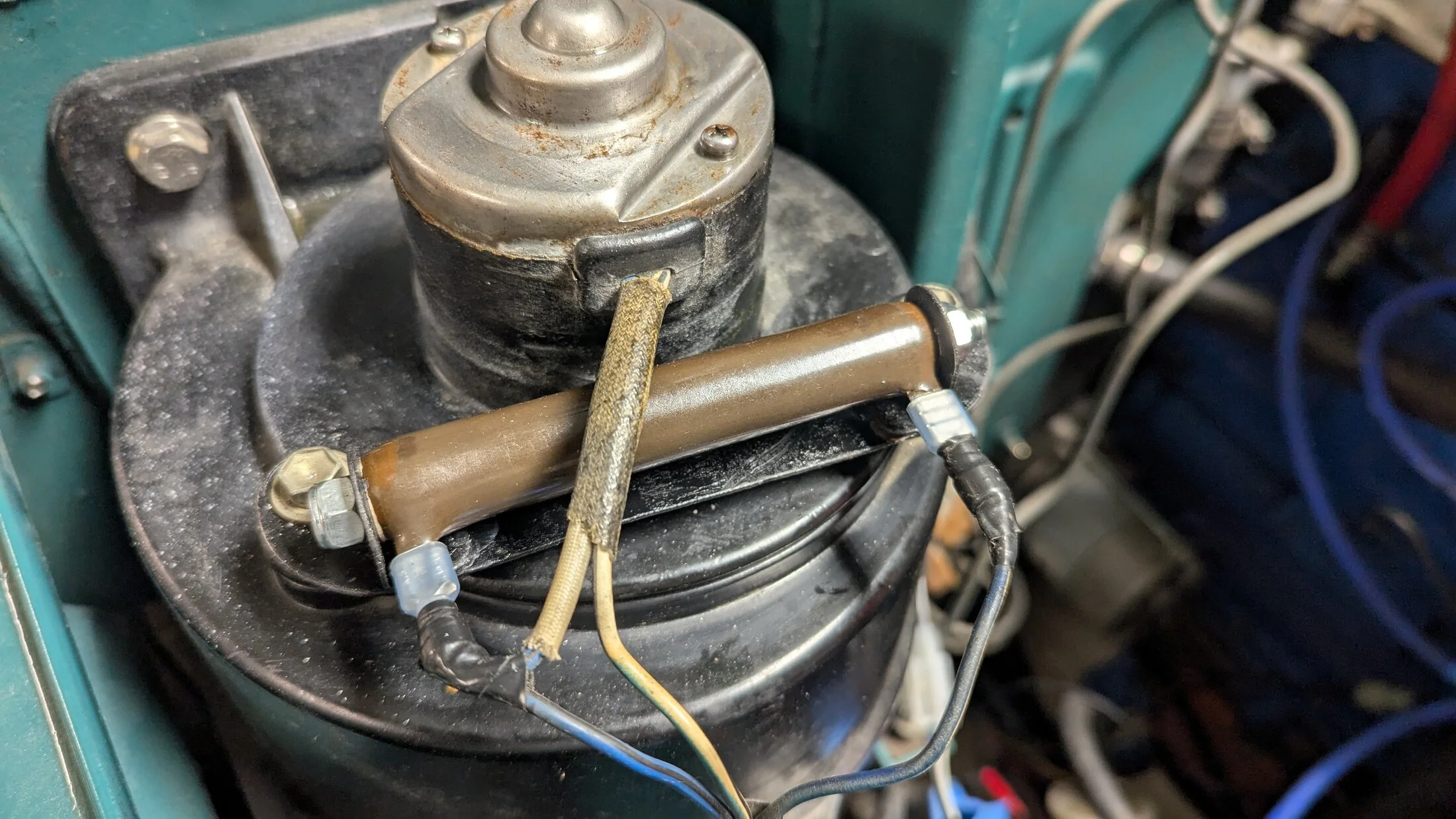

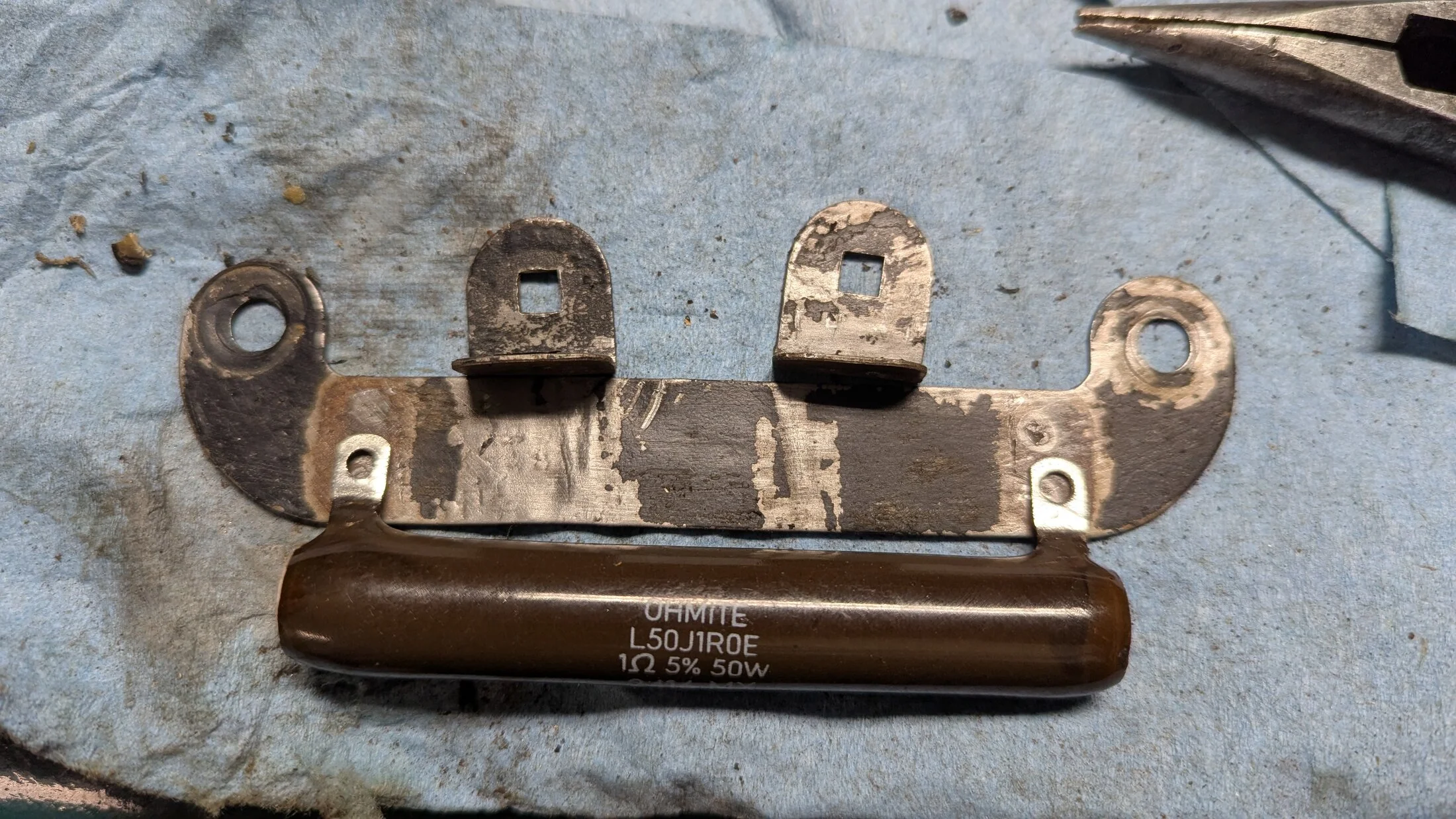

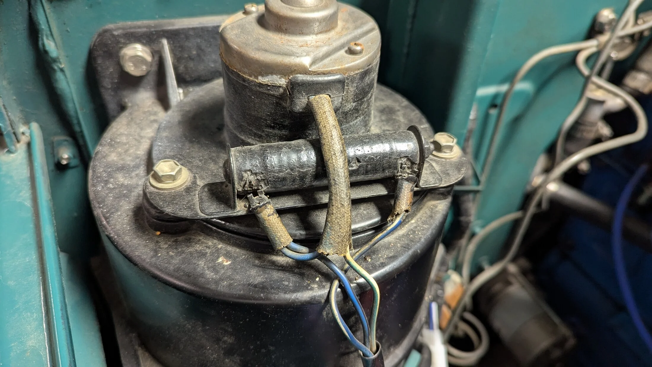

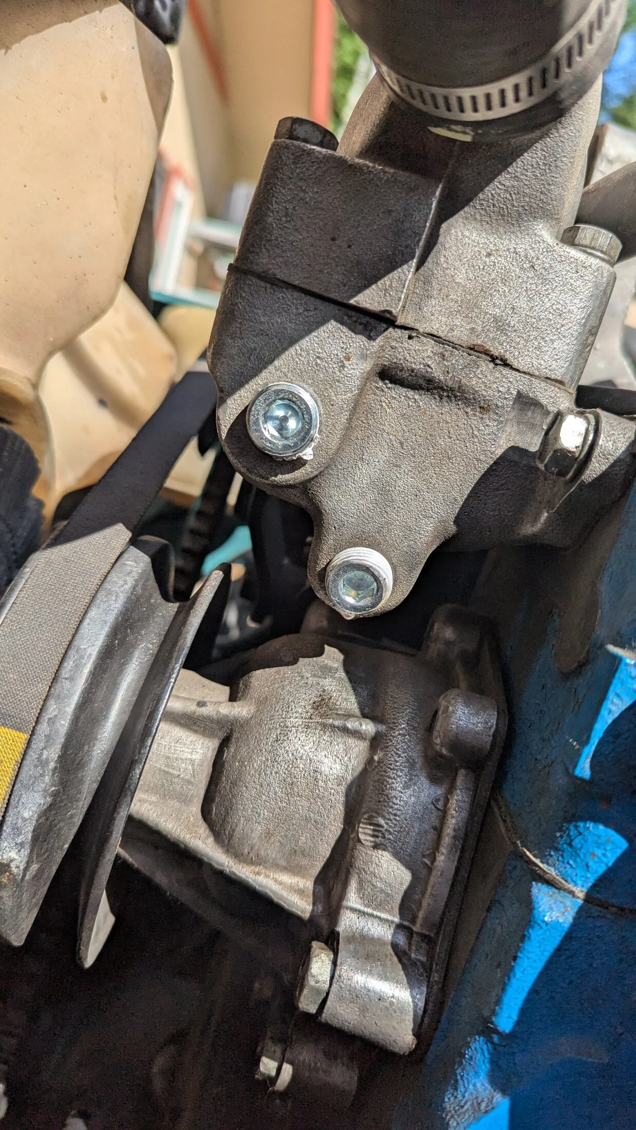

My fan stopped working on low speed and so after some Internet investigation I discovered that the culprit was the resistor mounted on top of the fan box. I ordered a modern day equivalent of the original resistor and mounted it up. Had to make the modifications to the mount you see in the photos. My fan now works on low and high speed. Good as new🤙🏼

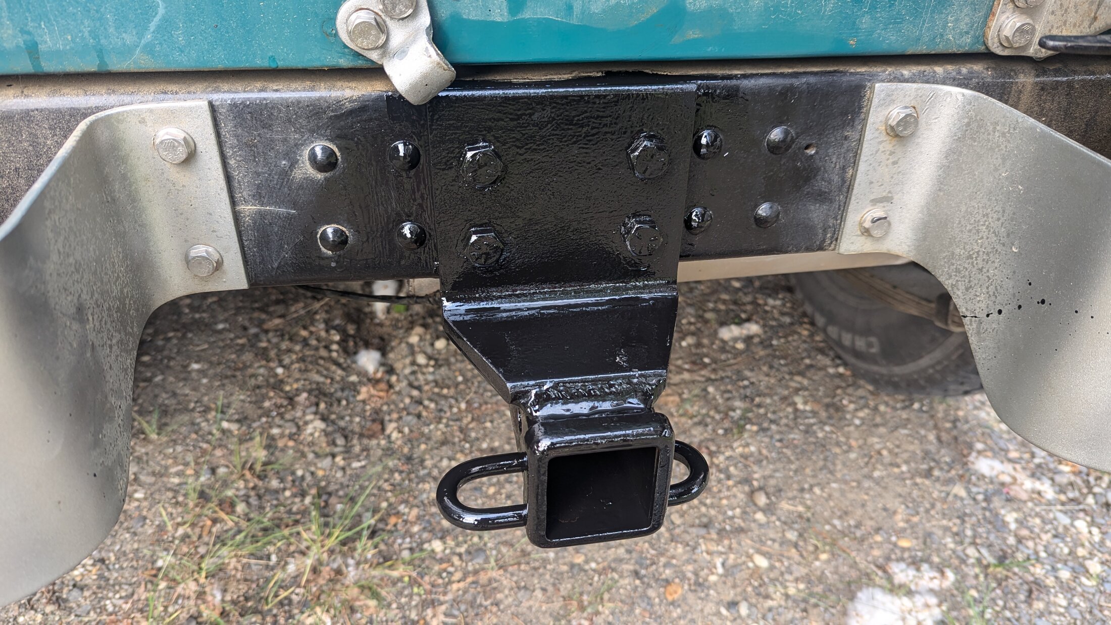

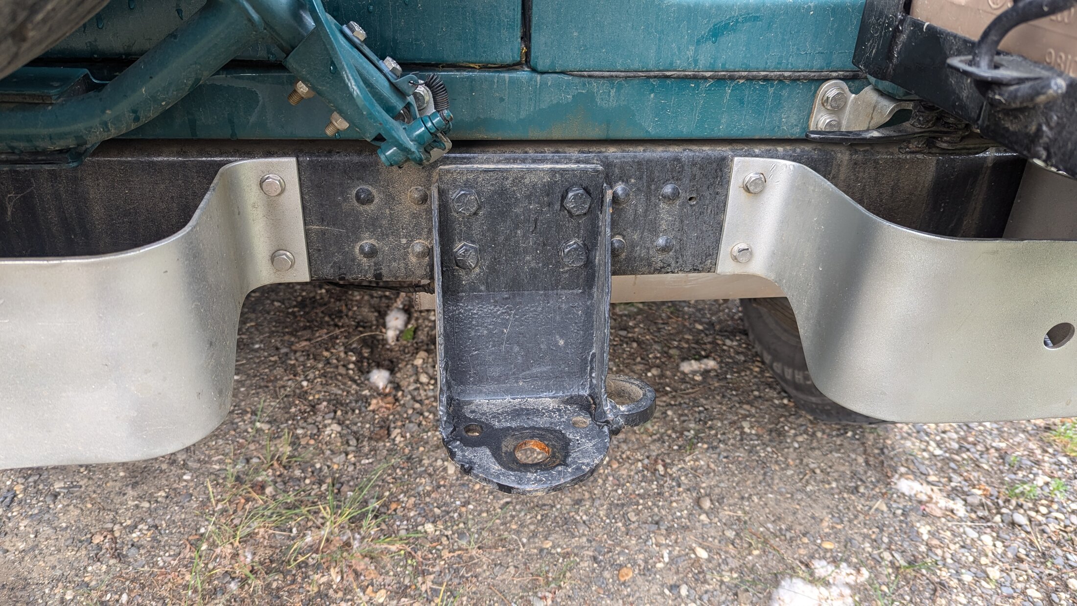

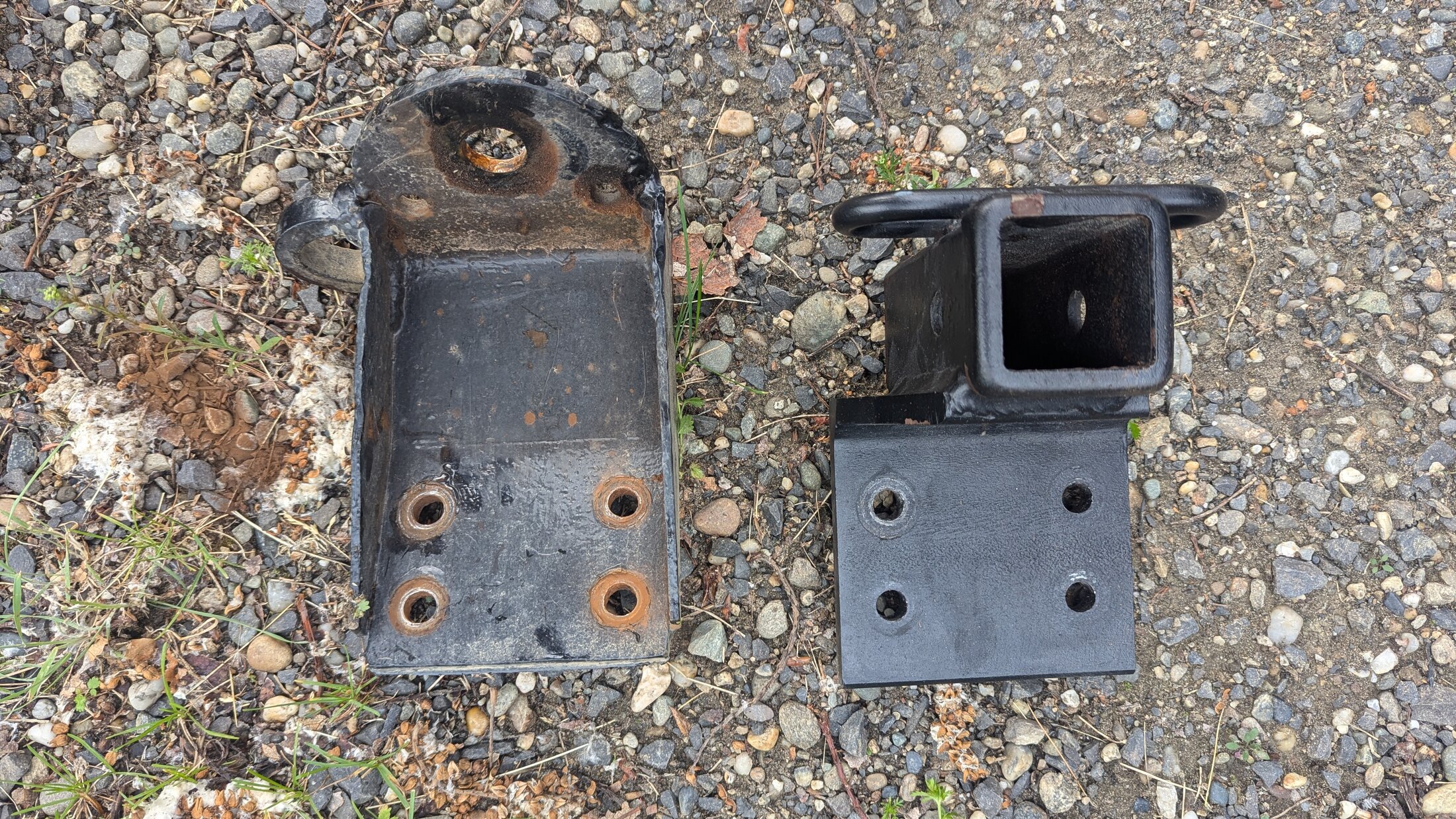

Removed the ball hitch from my rear bumper and replaced it with a CCOT hitch @Green Bean sent me. Had to grind down one corner of the hitch in order for my spare tire rack latch to pass, but it was an easy modification to make with my angle grinder.

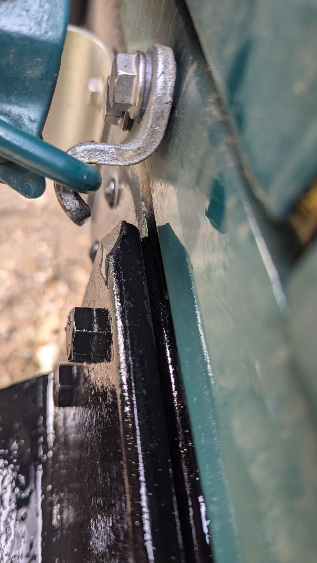

The paint on the CCOT hitch was garbage. Must have been cheaply rattle canned from the manufacturer, and it was flaking off in huge pieces. I scraped as much of it off as I could and then coated everything with POR15.

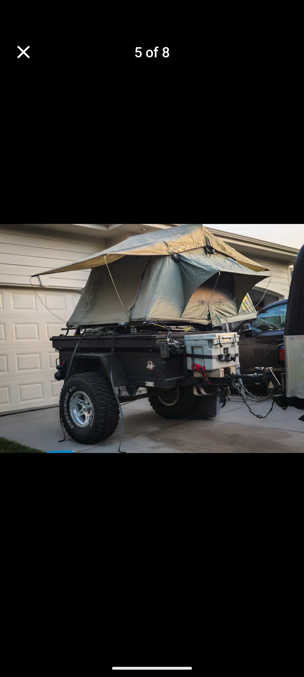

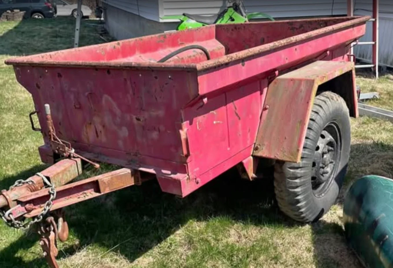

Now I can use a pintle hitch and tow my overlanding M416 military build trailer👌🏼
Do you have picture of your trailer build? I just picked this one up and I'm looking for ideas/ inspiration.

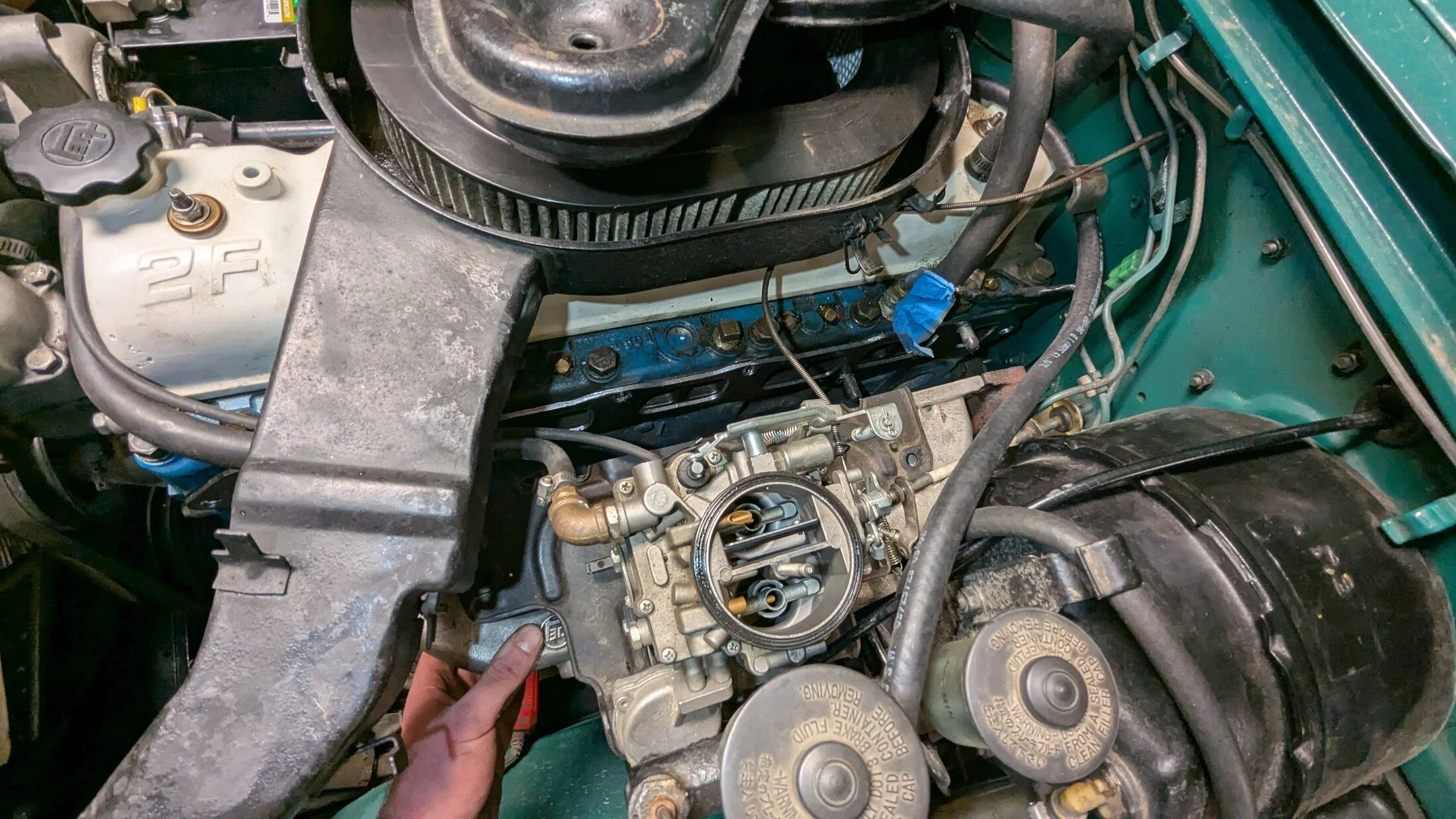

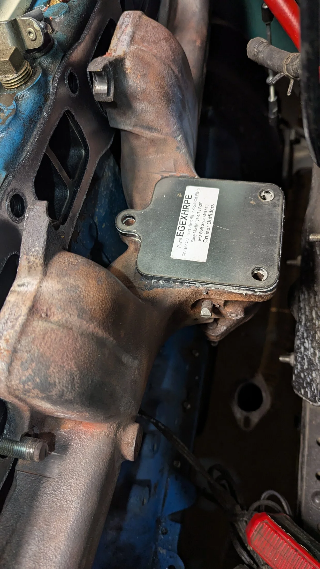

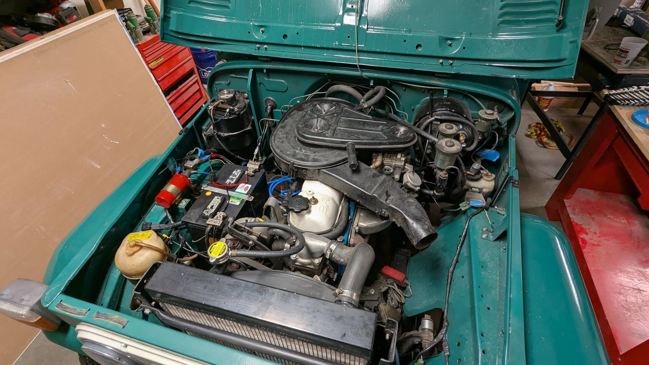

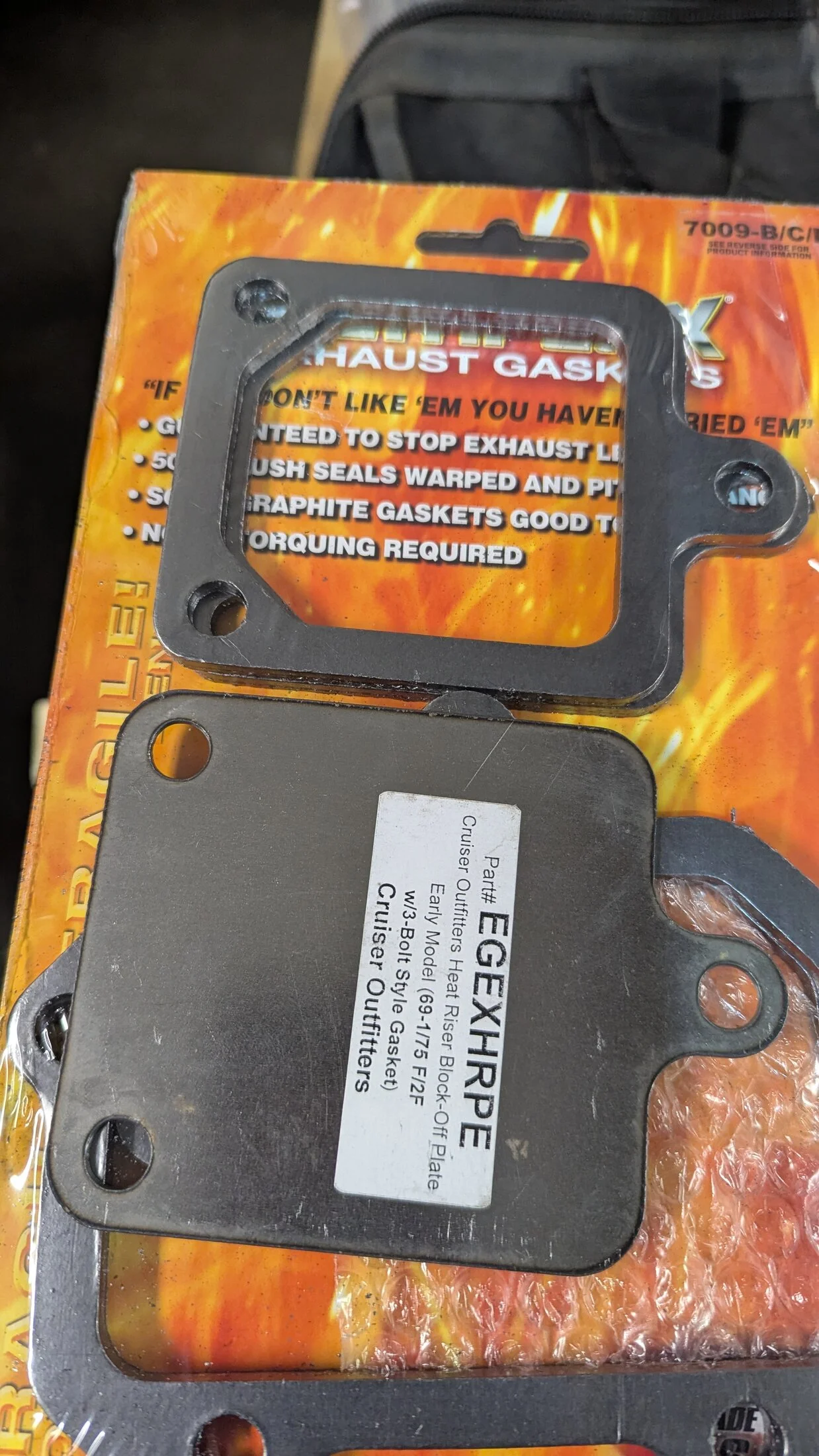

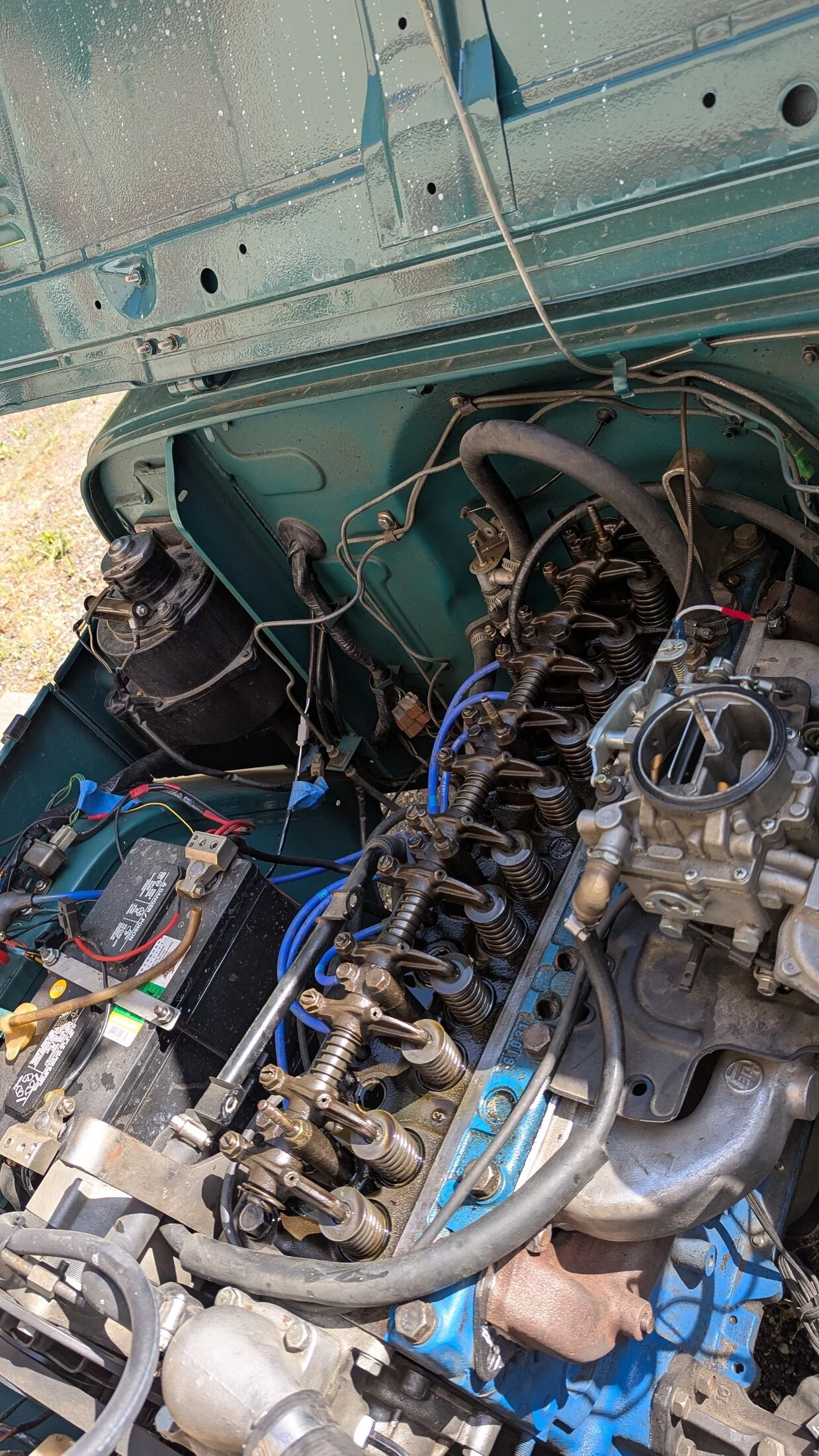

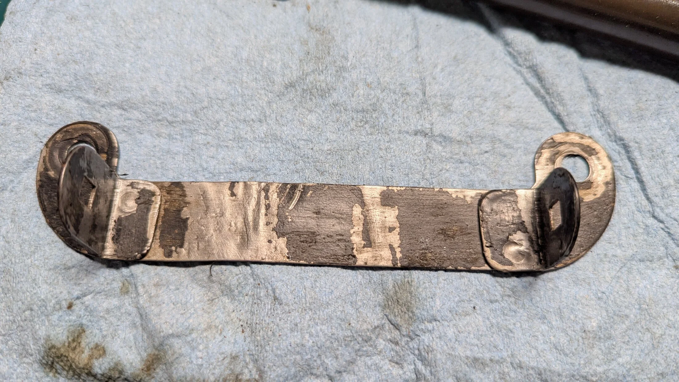

One of my exhaust gaskets blew out and I had to dig into that. While I was in there fixing that, I noticed the PO's fix to the seal between the intake and exhaust manifolds had also failed and so I ended up installing a new block off plate as well. The install for the block off plate was easy and id recommend it if anybody needs to do it.

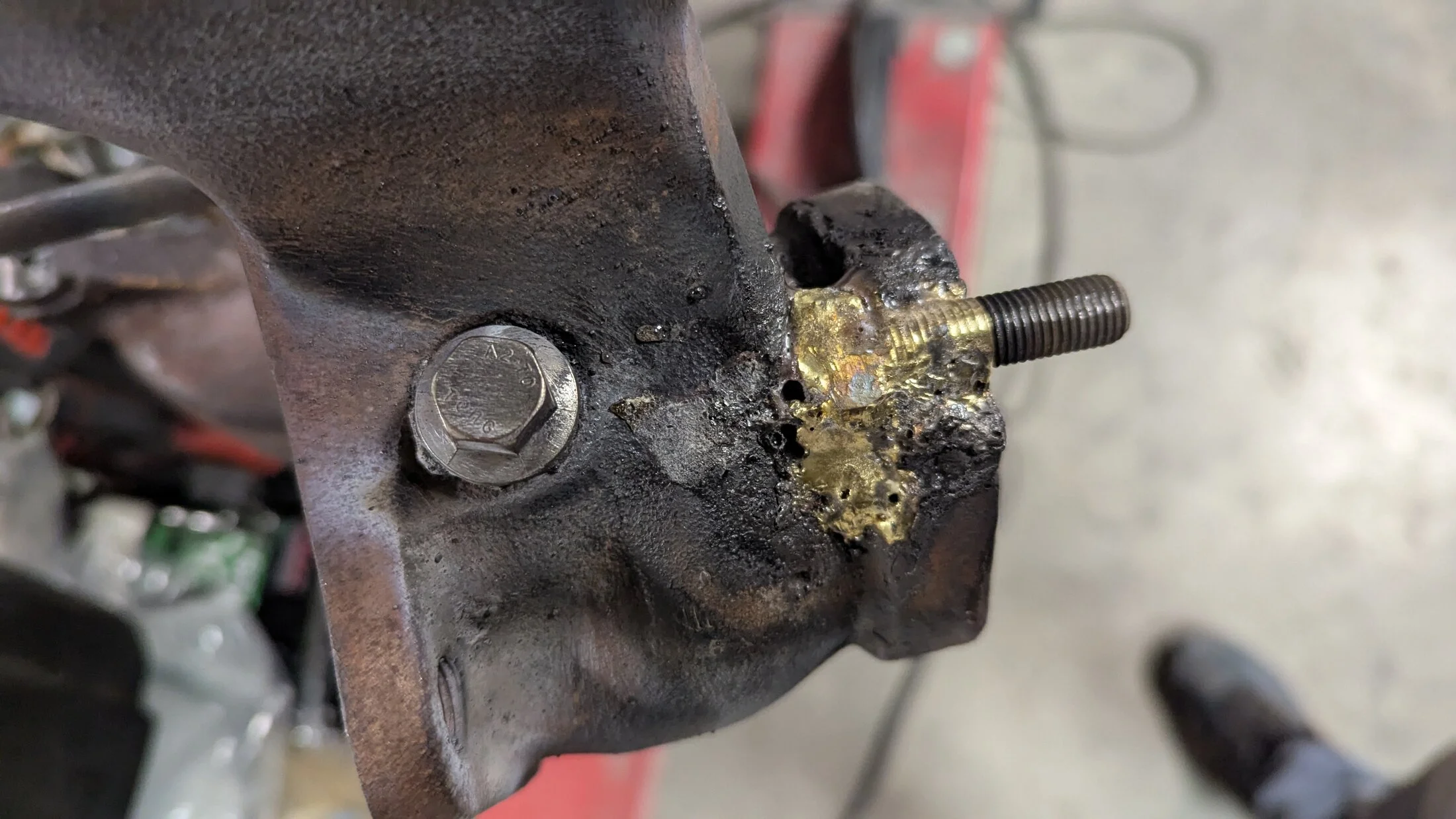

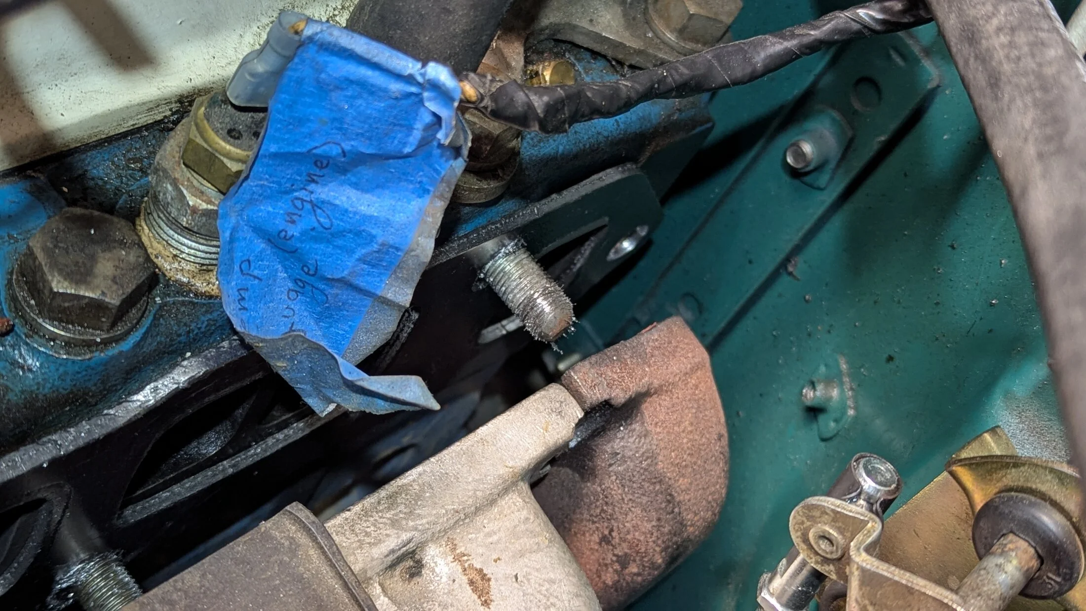

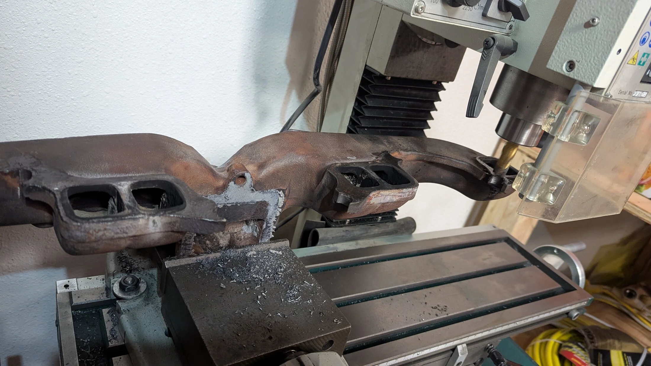

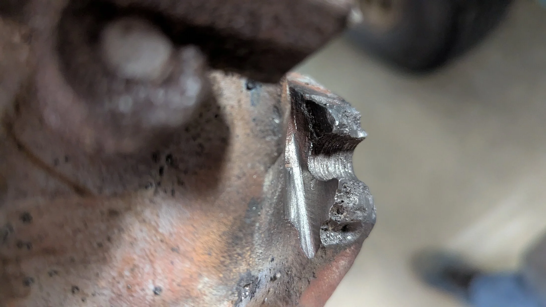

And the hits keep coming... I also noticed my exhaust manifold has cracked where the stud is and had been causing a leak in my exhaust. I tried a few ways to fix this and keep the stud in place and ultimately had to do an ugly job of brazing the stud directly to the cast iron manifold. It's held up pretty well since this repair with no loosening or leaking from this location

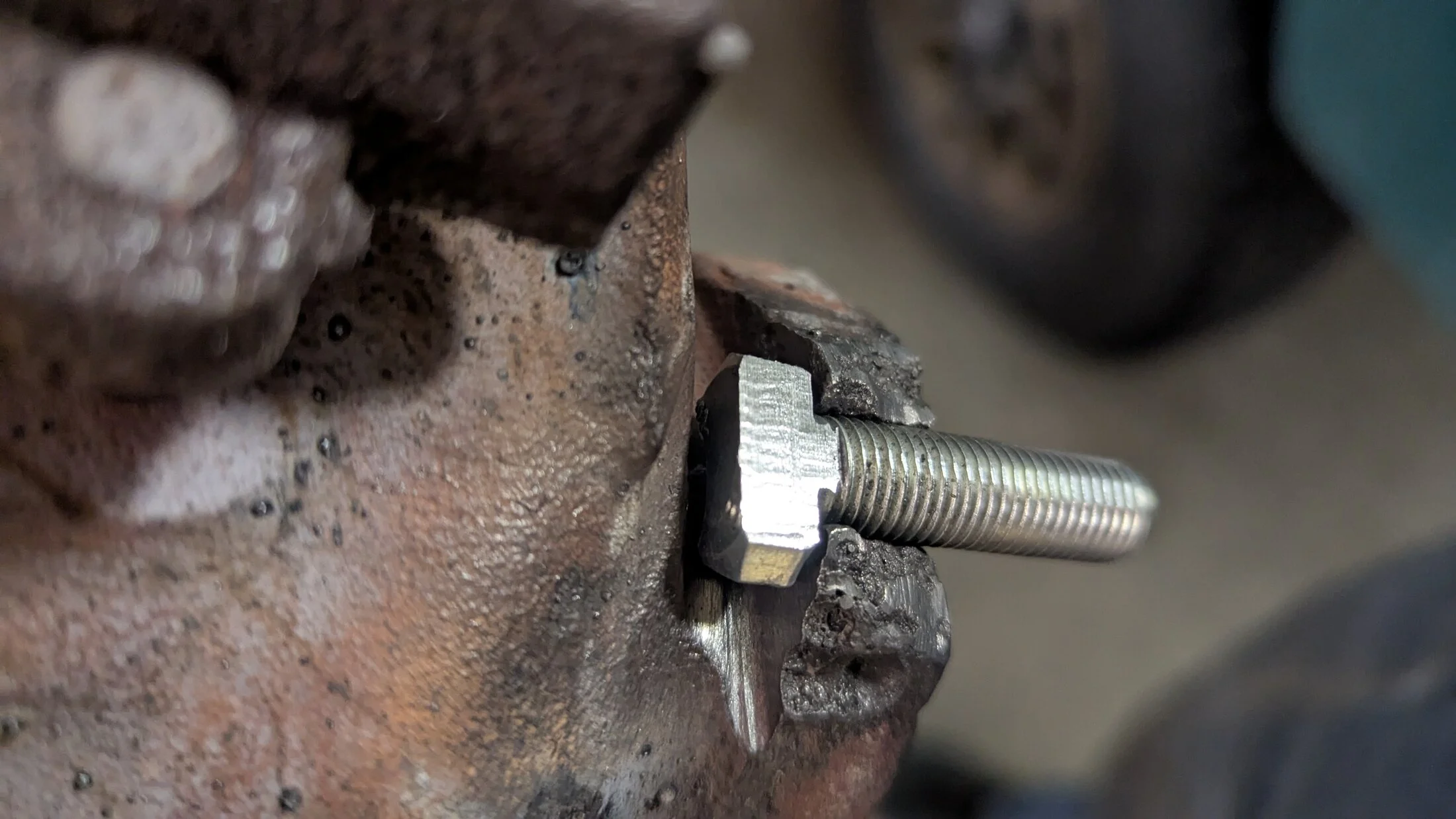

Whilst pulling the manifolds on and off a few times I managed to strip out one of my studs. I made a new one from a spare bolt I had lying around and later realized my local hardware store stocks metric manifold studs. Oh well. Only spent 30 mins making myself a stud to save $1.50🤣.
After installing the block off spacer/seal between my manifolds they no longer lined up well and I couldn't reinstall them to the head. I ended up taking them both to my mill and opening up the bolt holes to get them to slide onto the studs. If it isn't one thing, it's the next thing causing headaches it seems like. Anyways, got them all good to go and bolted back together and reinstalled with a new Felpro head gasket.

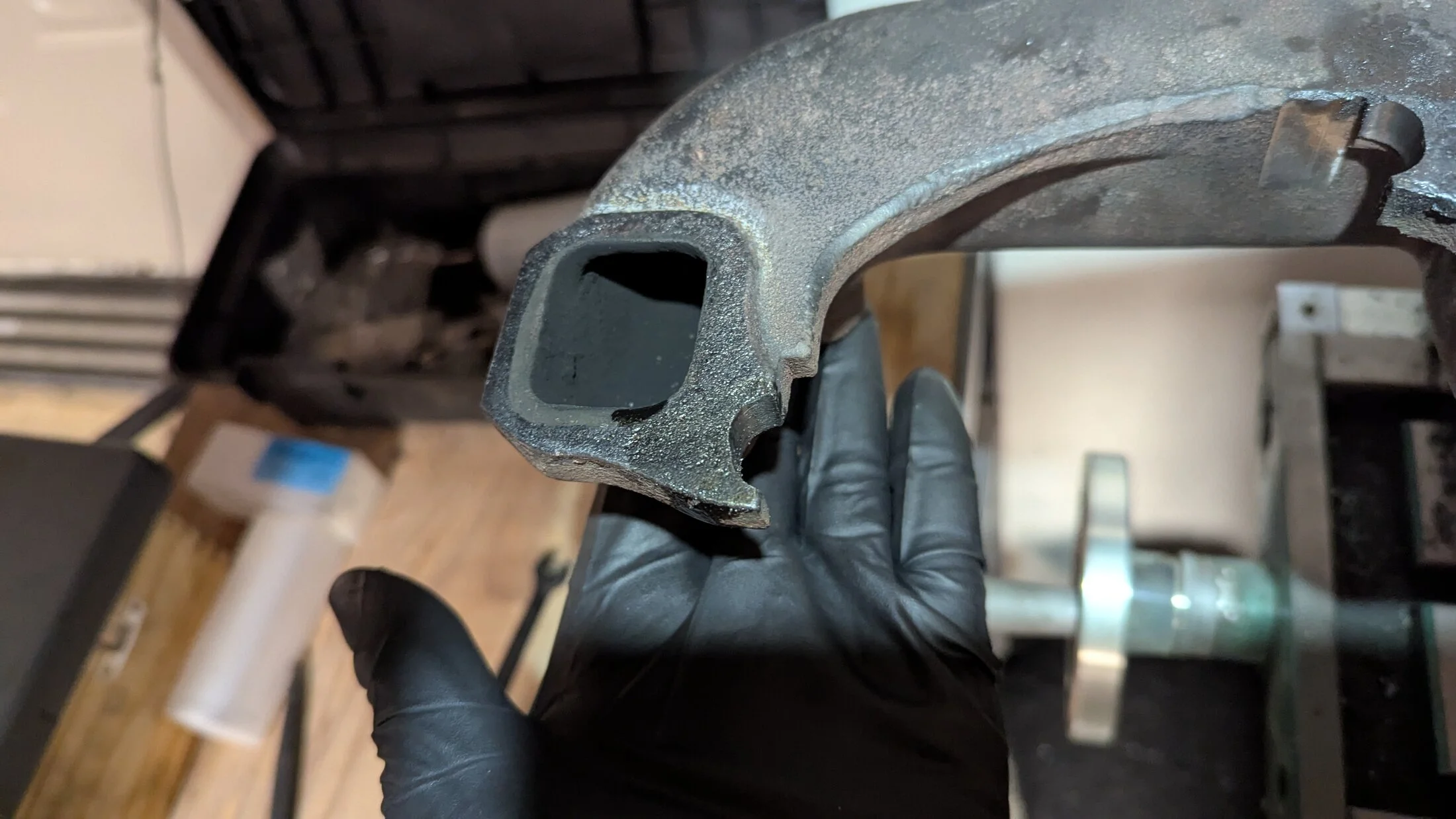

The next issue I ran into was that the exhaust holes on the manifold don't line up great with the exhaust manifold gasket holes. The end result is a small exhaust leak with associated chirping sound upon starting up. As the engine warms up it diminishes somewhat, but never goes away entirely. This is my 3rd manifold gasket and Im frustrated I can't get a good seal. I'm suspecting it's because I'm using 1F manifolds on a 2F head. Open to any ideas, but at this point it is what it is.

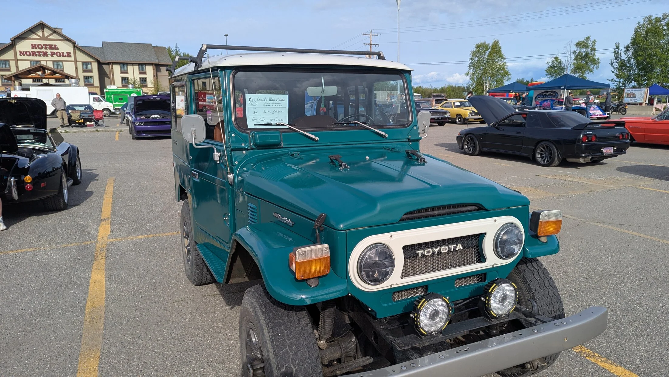

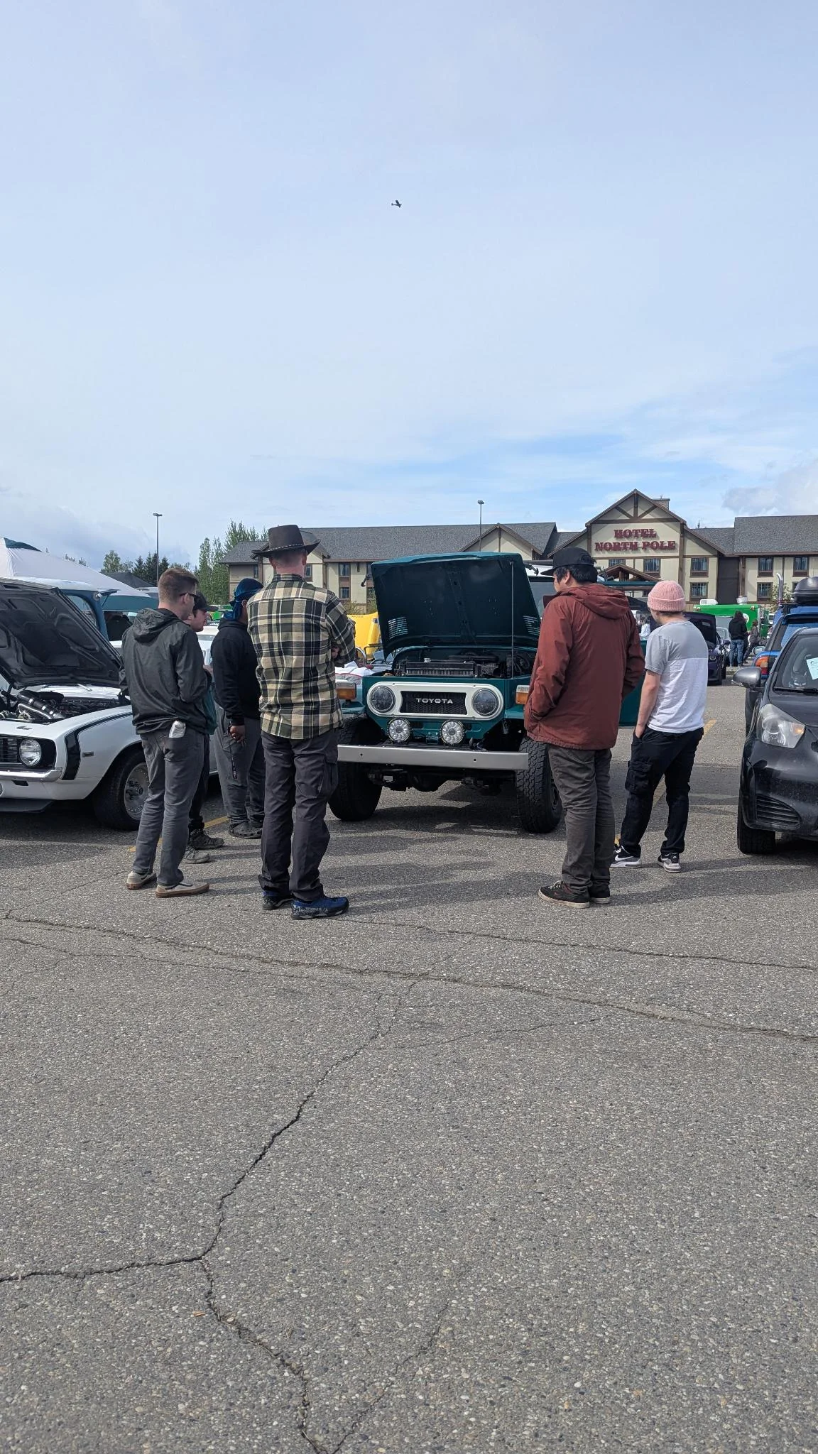

Entered the FJ40 into the local car show over the past weekend. While it didn't win any prizes (not bitter about that at all🤣) it got lots of attention and it was a fun time.

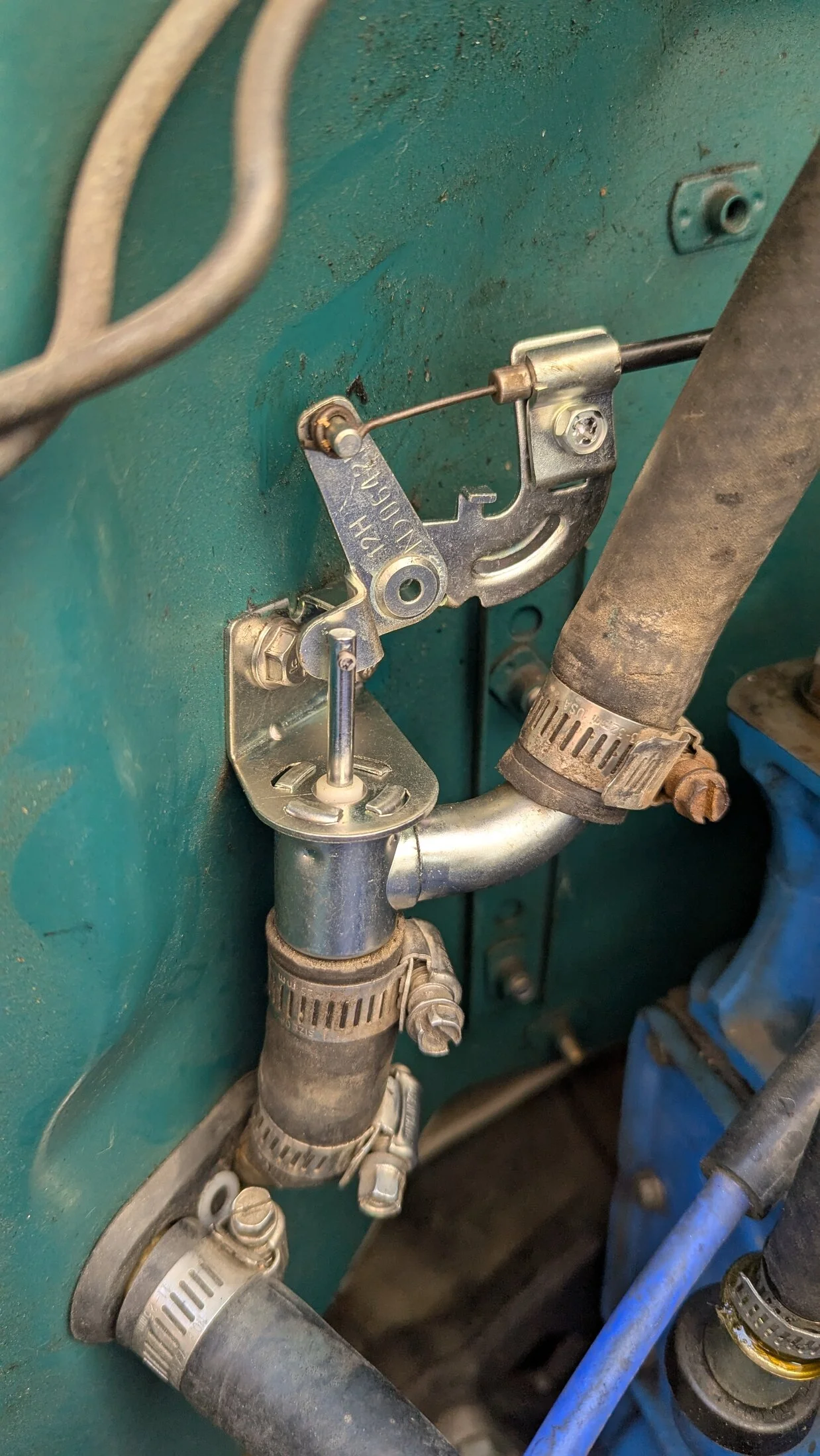

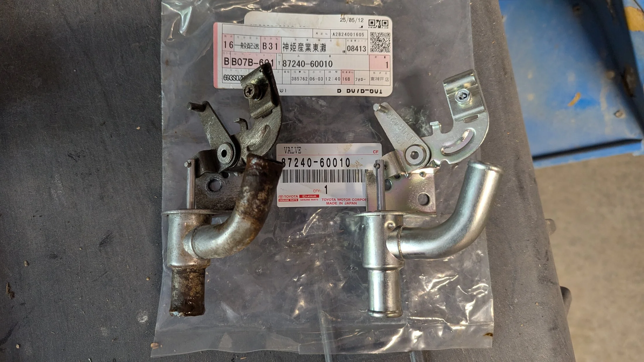

Installed a new heater control valve because the old one was crusty and not sealing well.

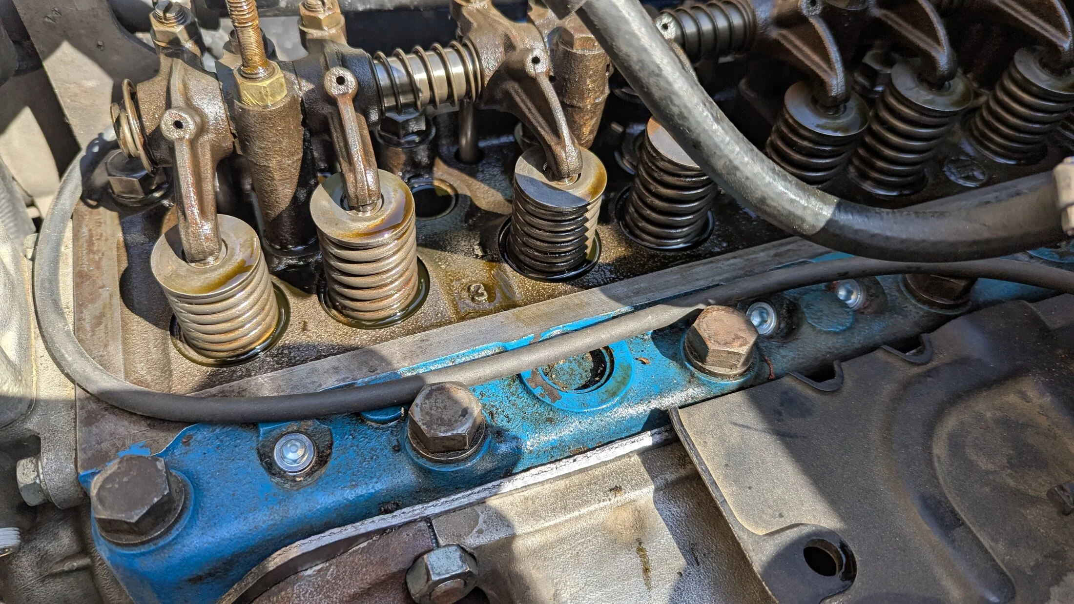

Set the valves, and changed the oil.

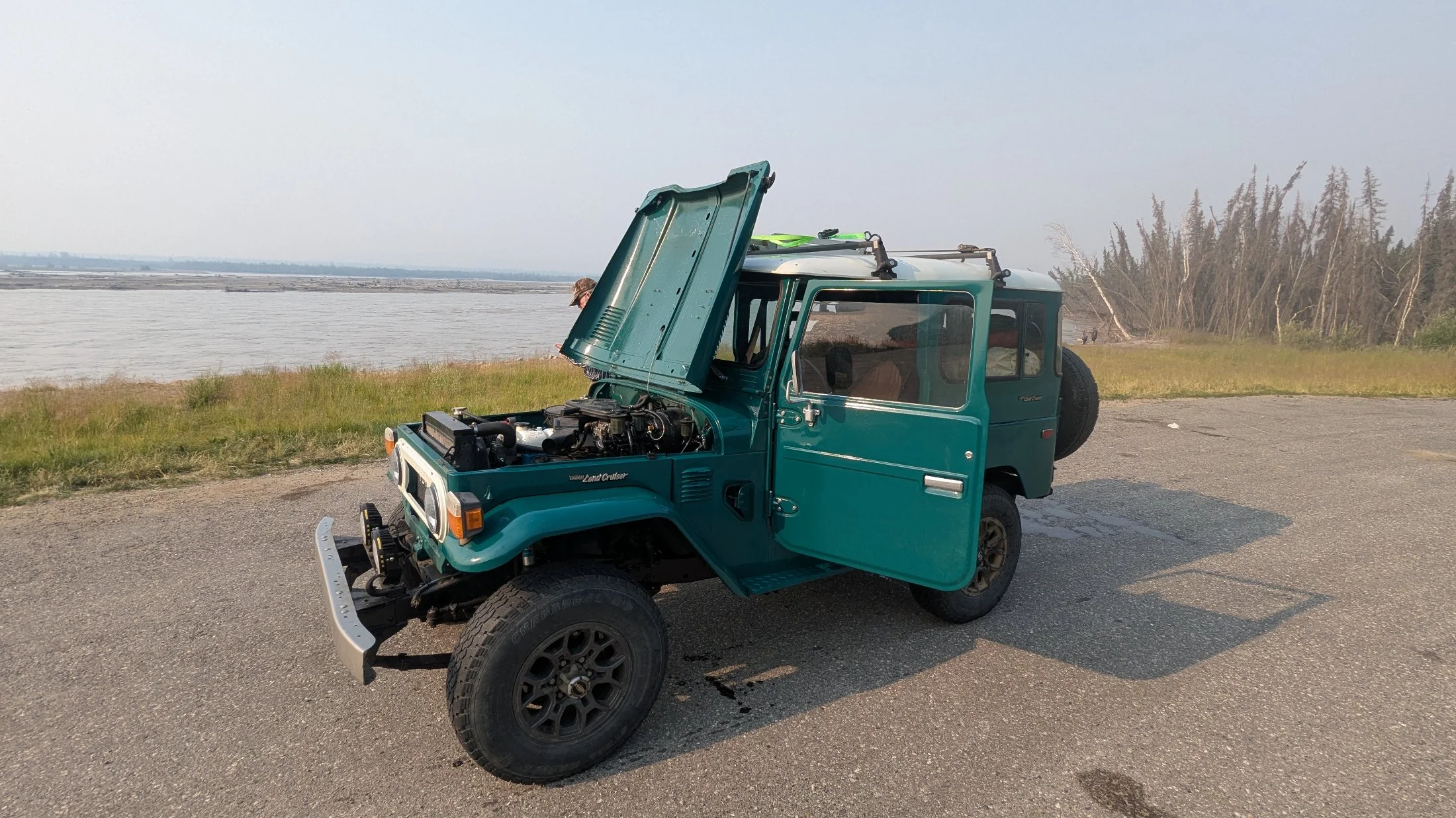

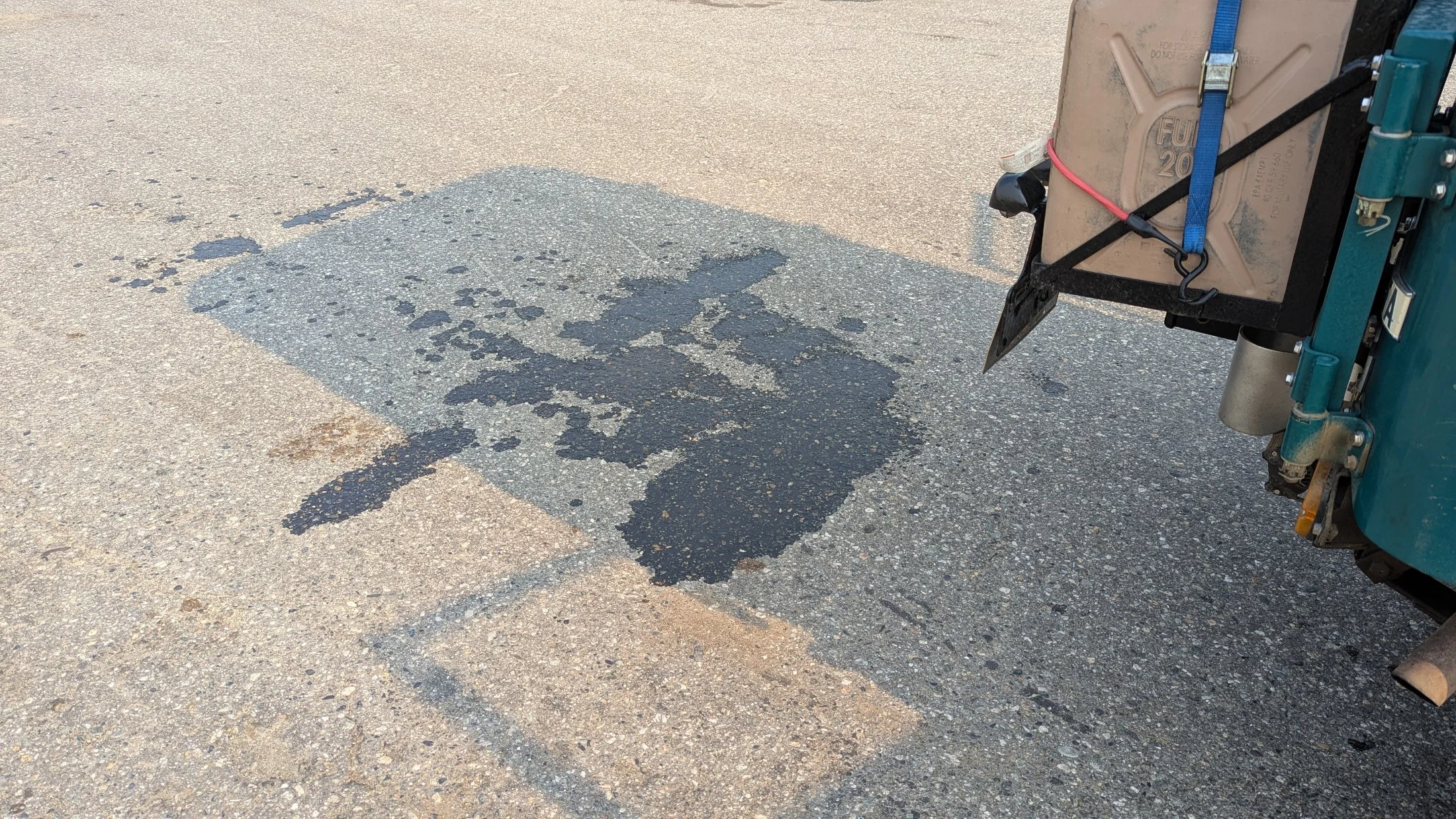

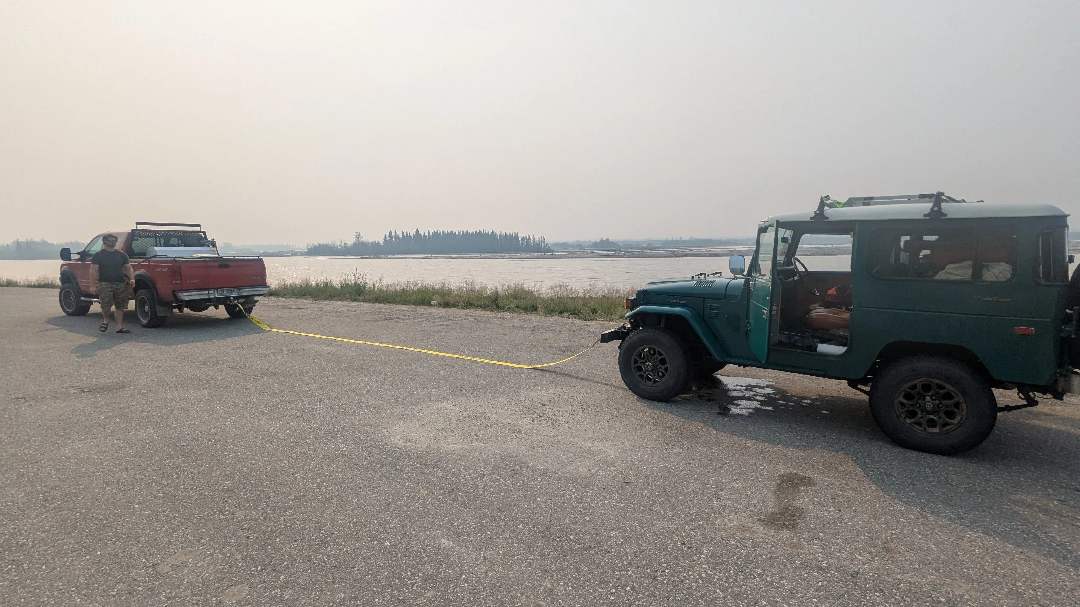

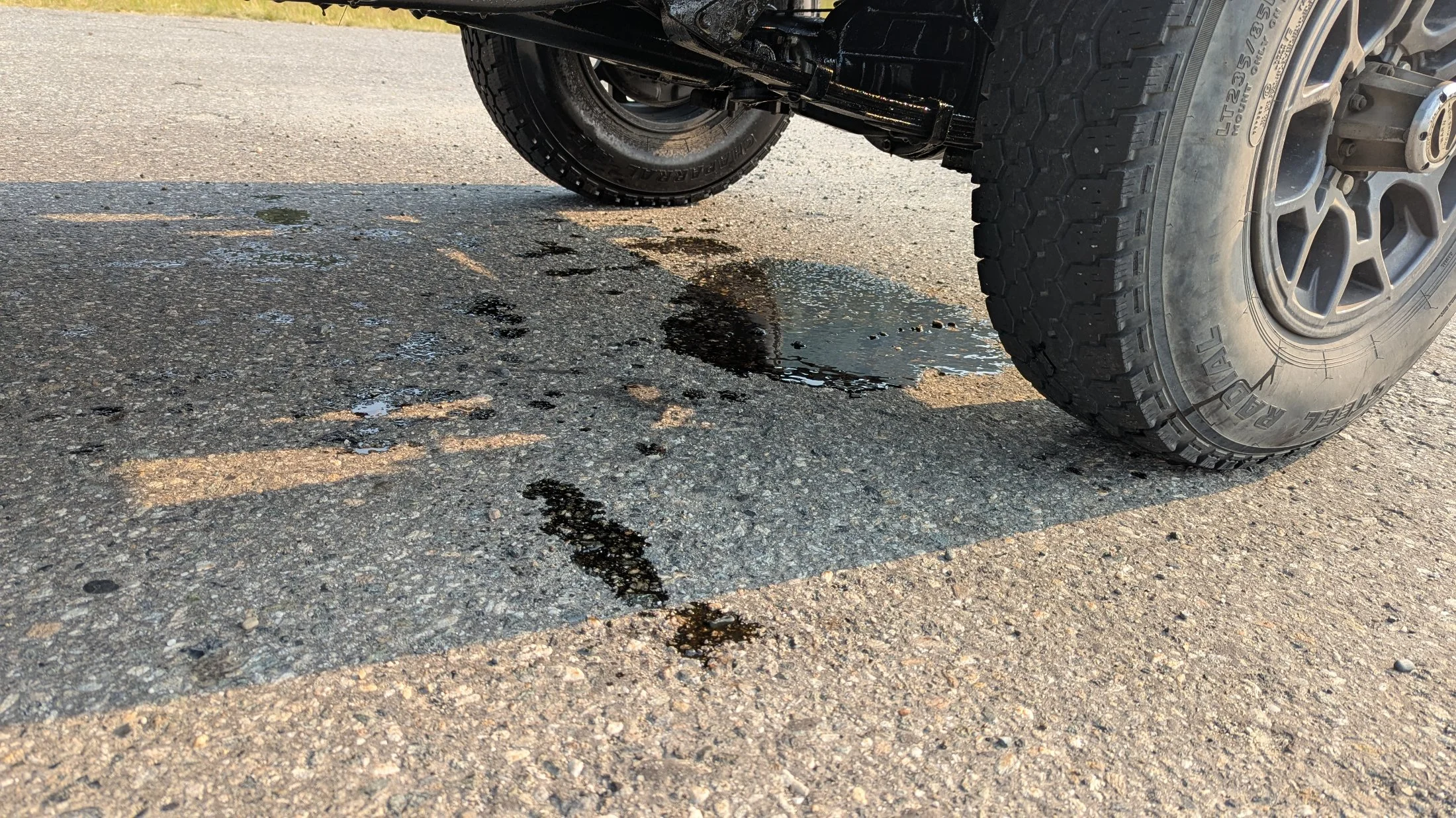

Well, the trip from Fairbanks Alaska to South Dakota started off in a bad way. My dad and I made it about 45 miles until we were billowing smoke behind us and had to pull over. Oil was pouring from the front of the engine and so I had to call my brother and we got a tow back to the house. Bummer.

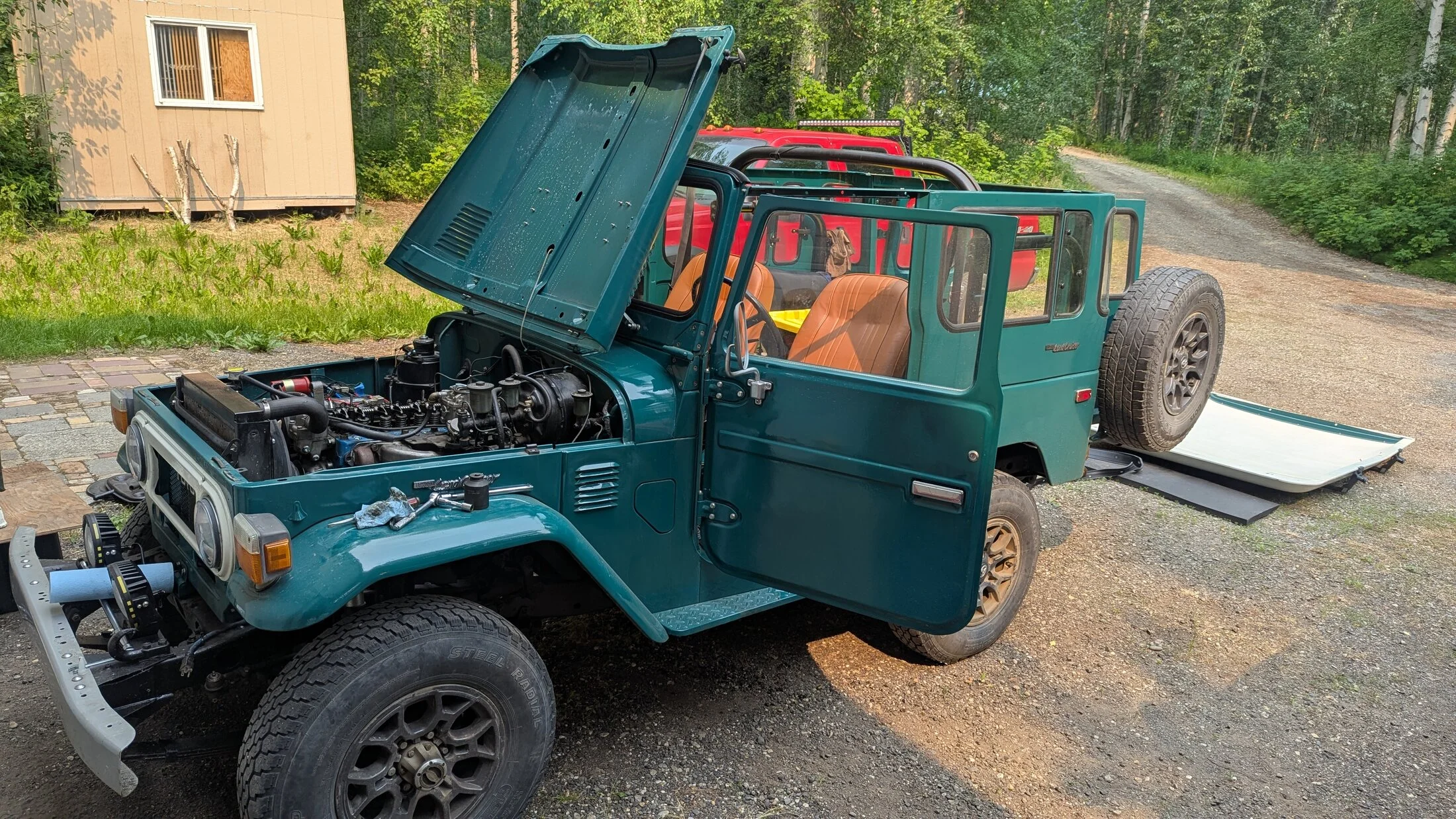

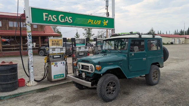

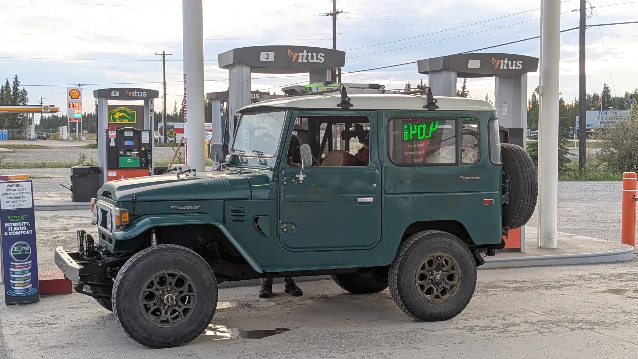

My dad immediately began to book himself a plane ticket home, while we were getting towed. I had a guy feeling the front crankshaft seal was the culprit and that it was not something that we could fix on the spot since nobody in probably 1000 miles has a new front crank seal for the 2F engine.
We have it a shot however and opened up the front of the truck and dug all the way down to removing the timing cover. Once we pulled the flywheel off we found the seal just chilling on the crankshaft no longer seated. It had just simply popped out of the timing cover. What!?!
A few minutes a seal driver and some sealant later we were reinstalling everything on the front of the truck. Once we had it all back together we topped off the oil (7 quarts!) and coolant and started it up. Ran fine, no leaks. Whew! I guess we can still do the 3800 mile trip after all.
We ate some lunch and then headed back down the road.
