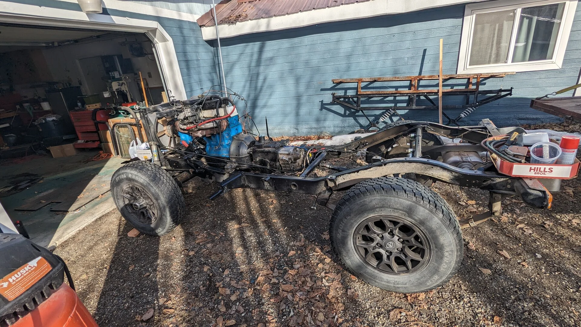

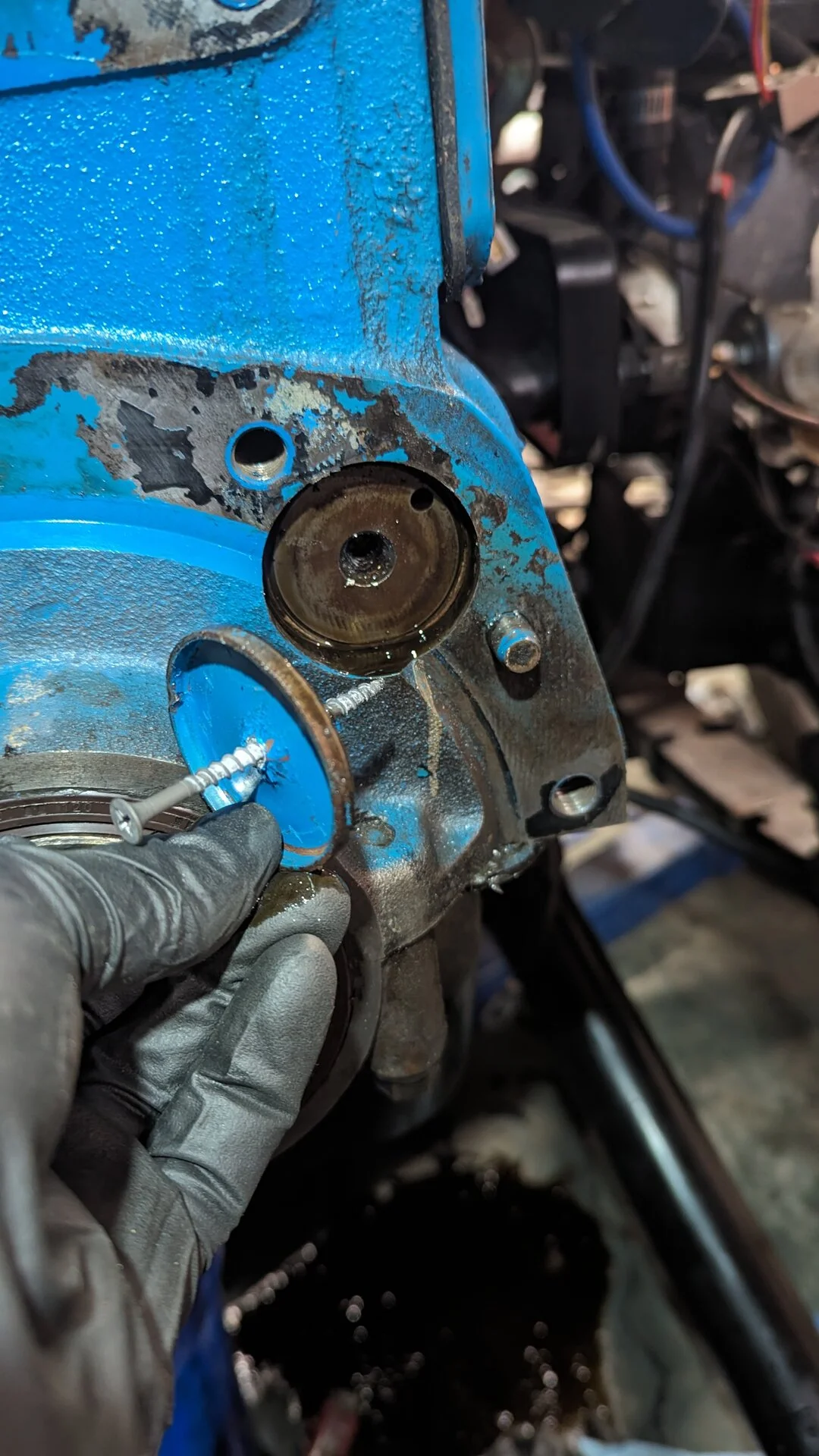

Chasing down a pesky oil leak while it's all accessible. Looks like my brand new rear main seal is seeping a bit as well as the right side of the crank bearing journal area was seeping. Dropped the oil pan, dropped the bearing journal and applied a liberal amount of Permatex #2. Also pulled the rear main seal and put some sealant around it. Hopefully it fixes the leaking. The new rear main seal is new with the rebuild so that's a bit worrying honestly.
Also pulled the cam plug and the oil galley plug since they both had a small amount of oil seeping from them. Annoying to be in here fixing engine oil leak issues again, but I did not replace these plugs when I rebuilt the engine so it's my own fault.

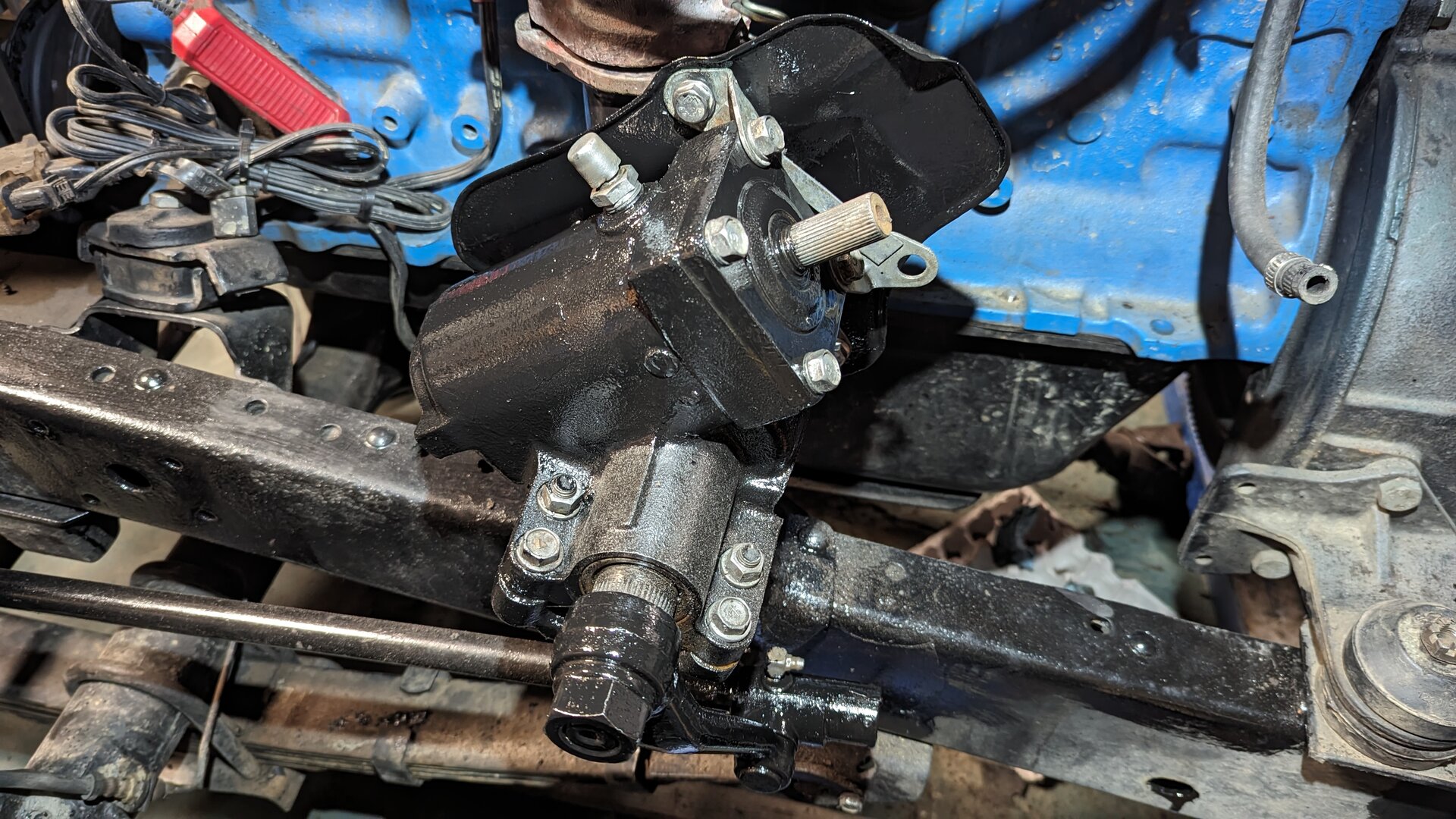

Cleaned up the steering box.

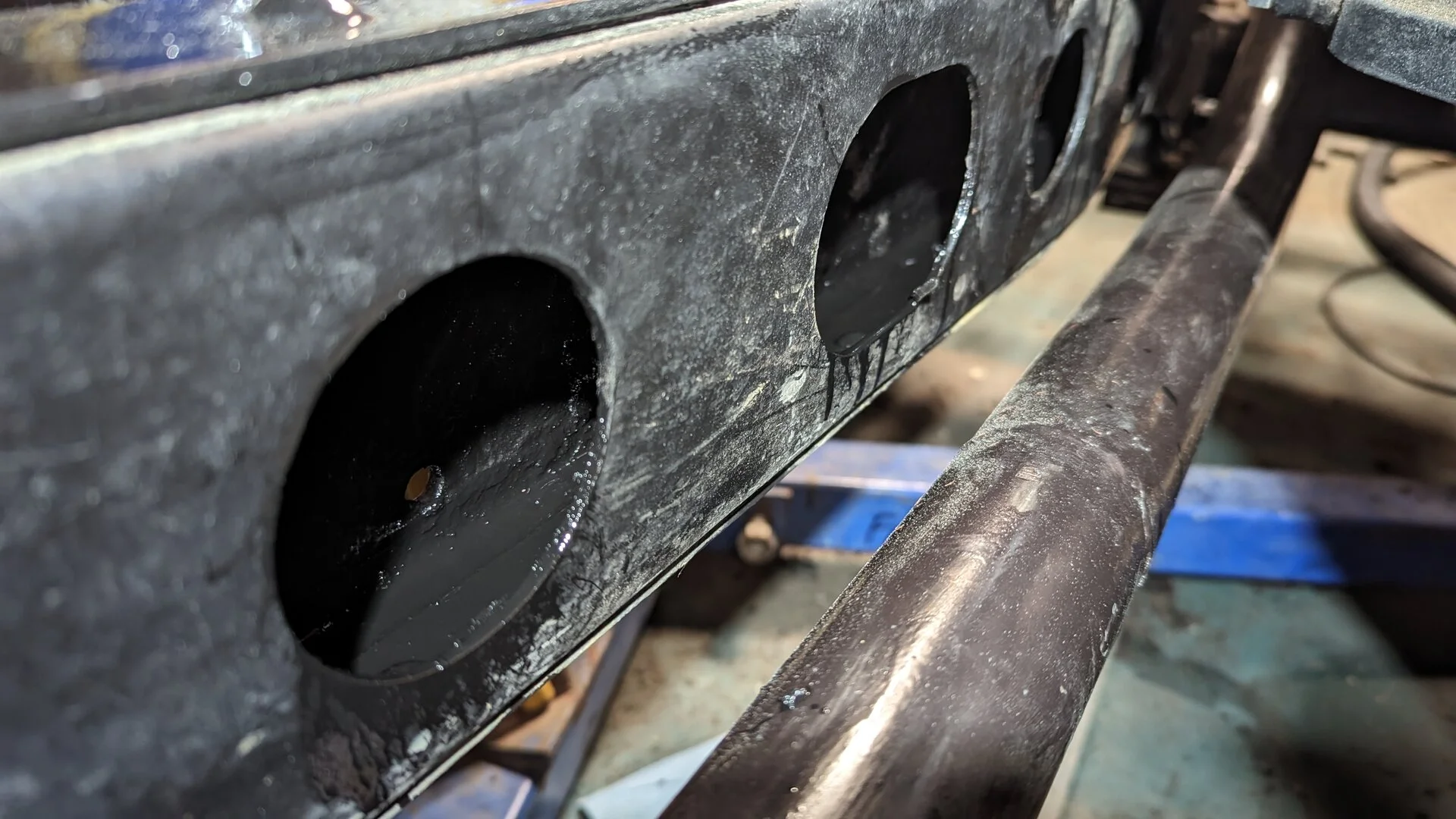

Cleaned out the frame rails as much as possible with a 4' homemade wire wheel on a drill that I could insert into the frame and knock all the dirt and surface rust off. After blowing and vacuuming it clean I loaded it up with POR15. Shouldn't rust away anytime soon.👌🏼

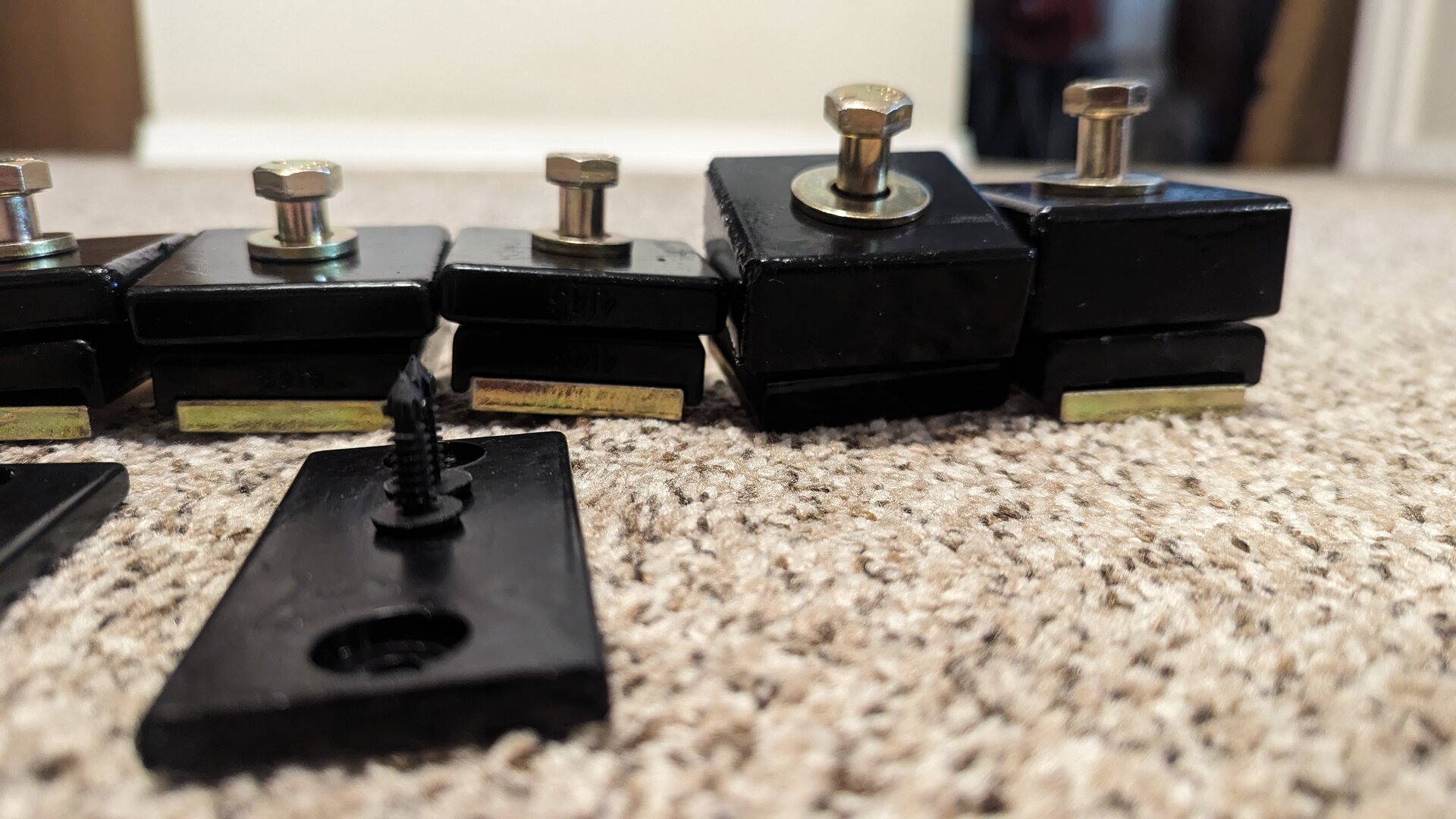

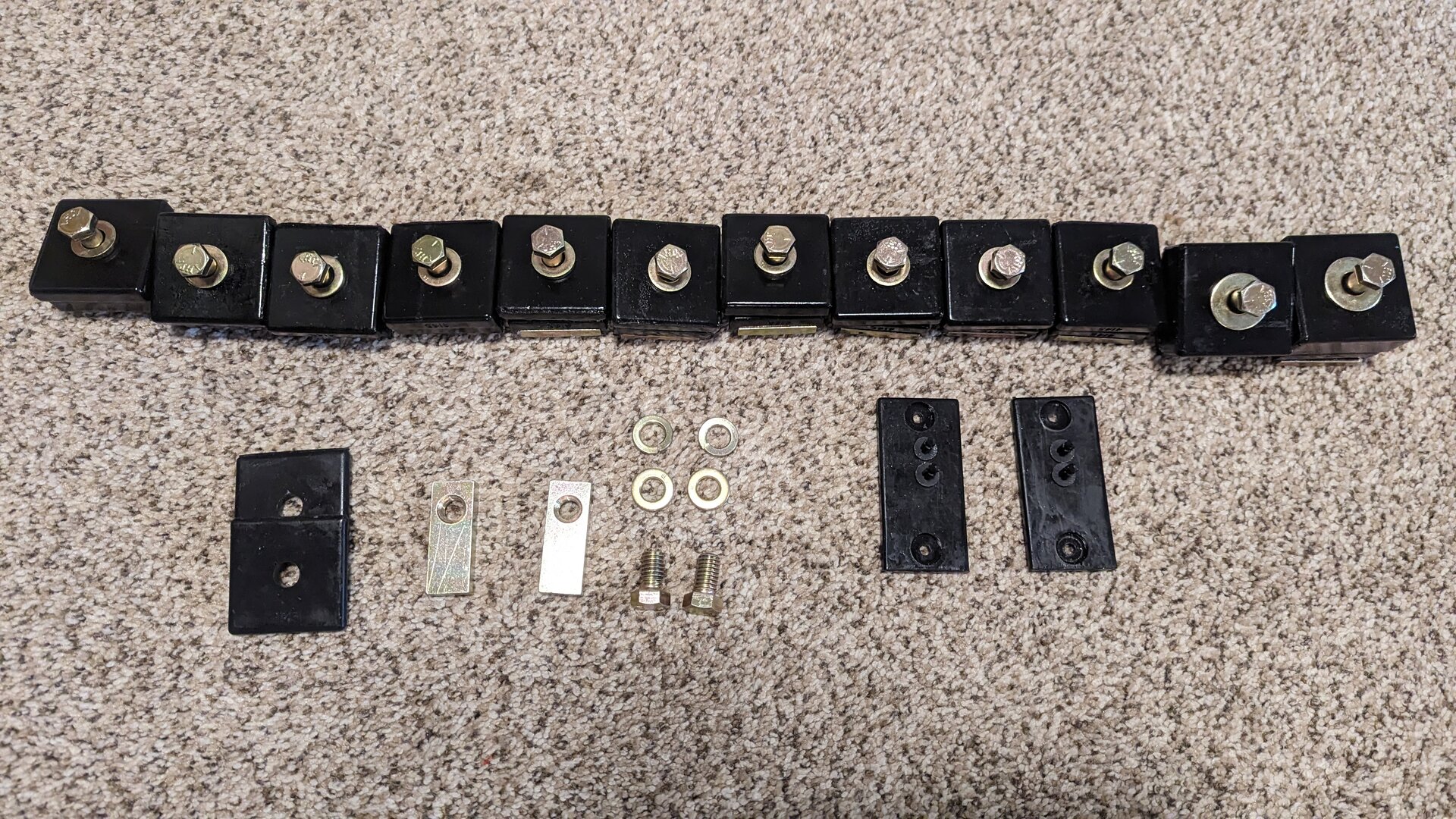

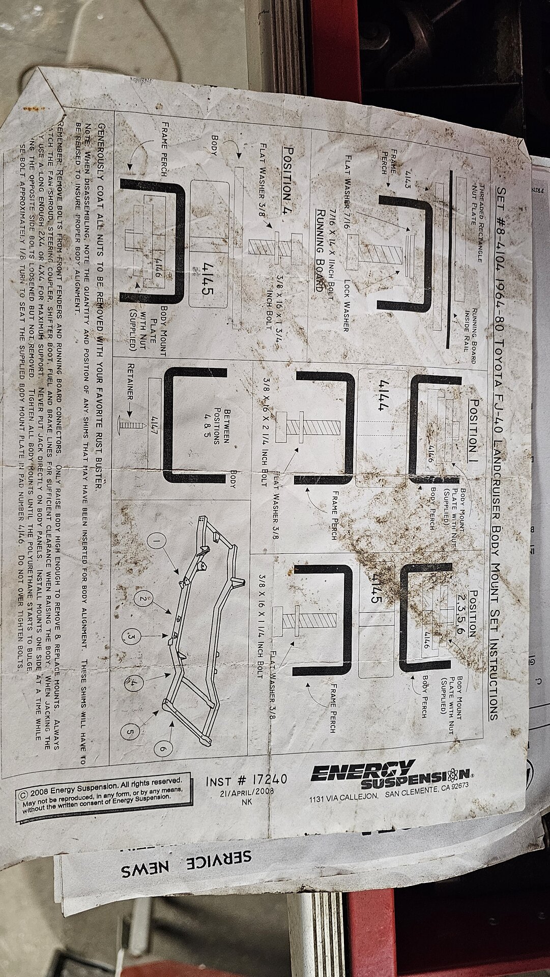

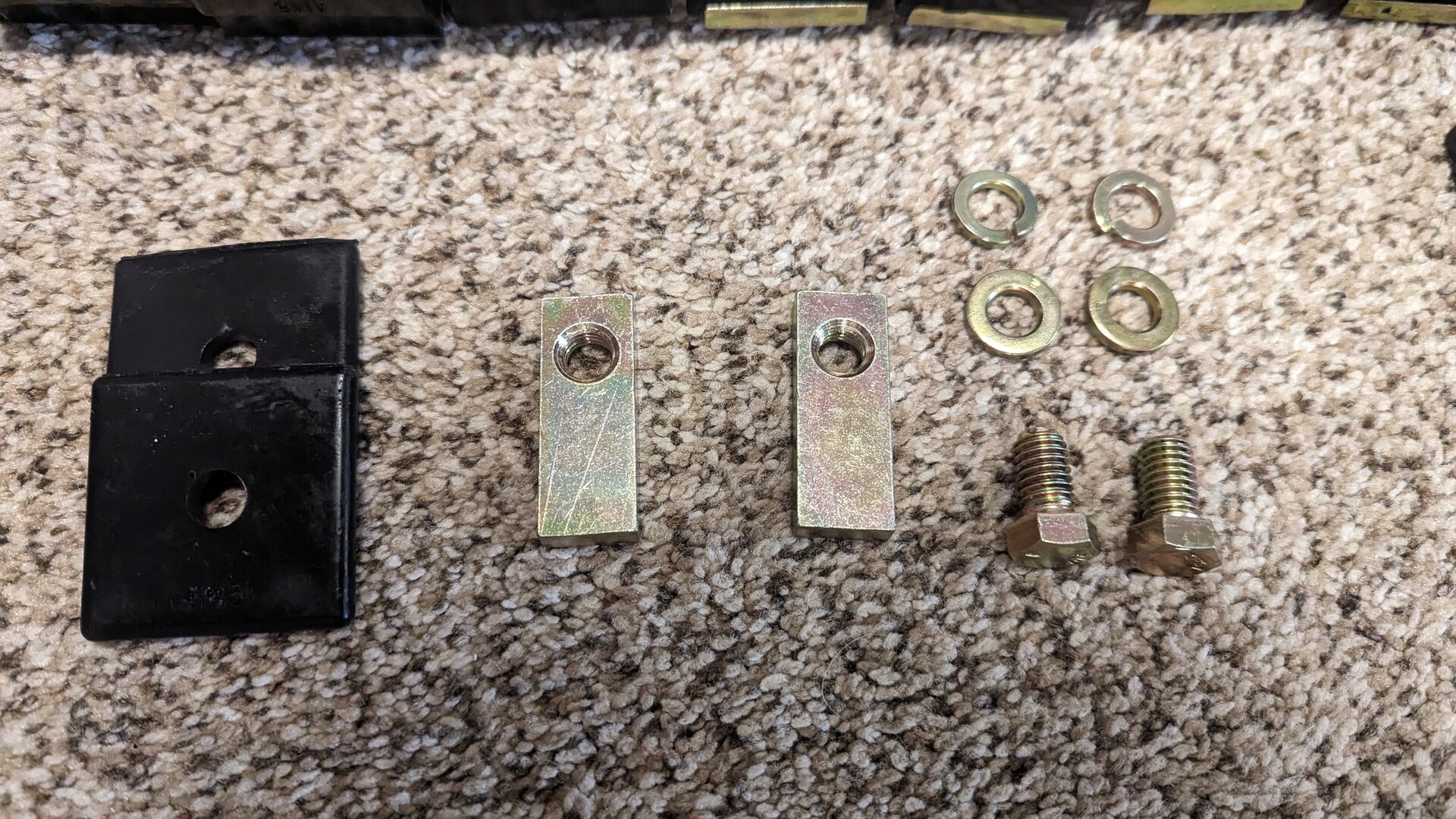

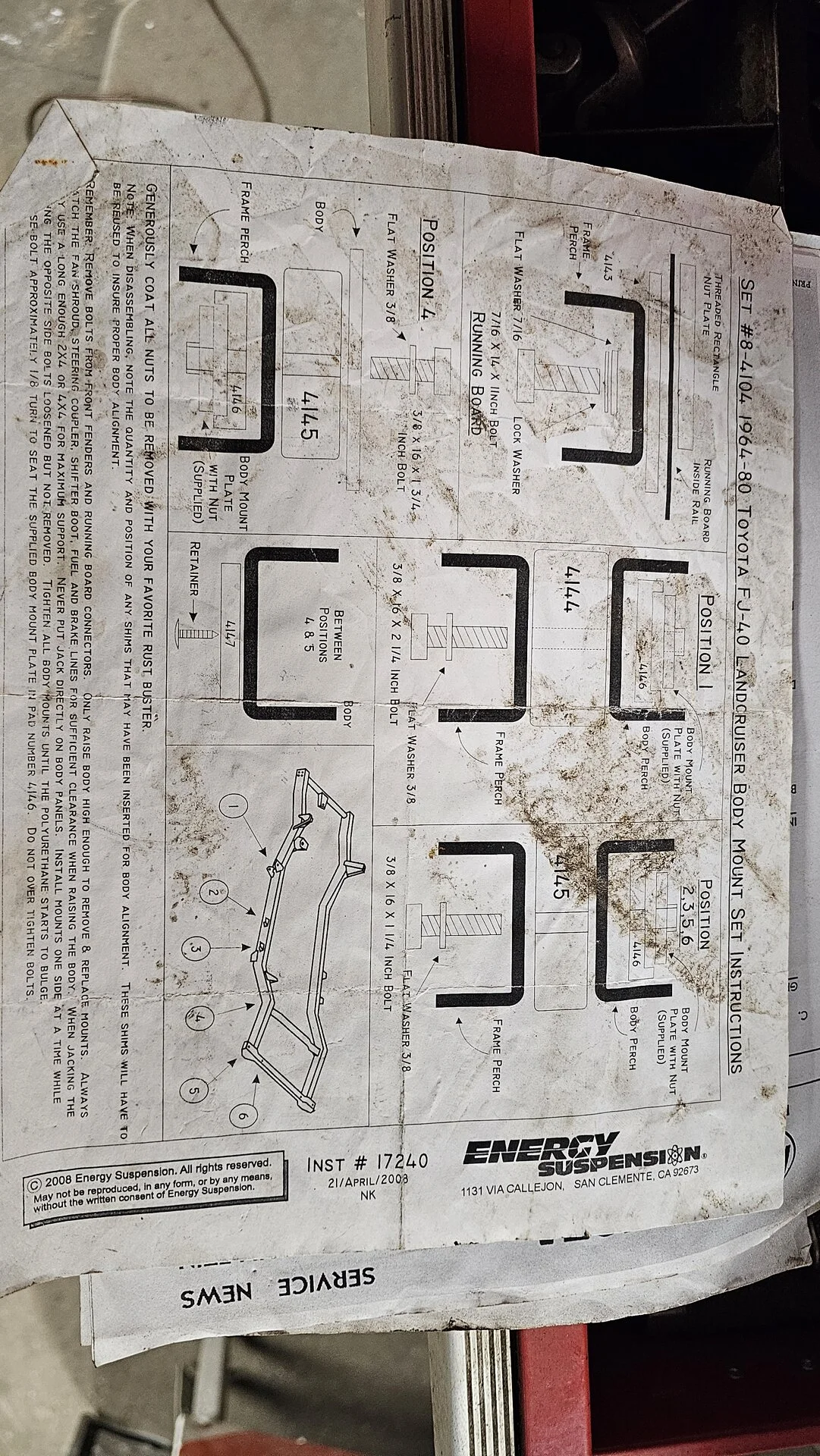

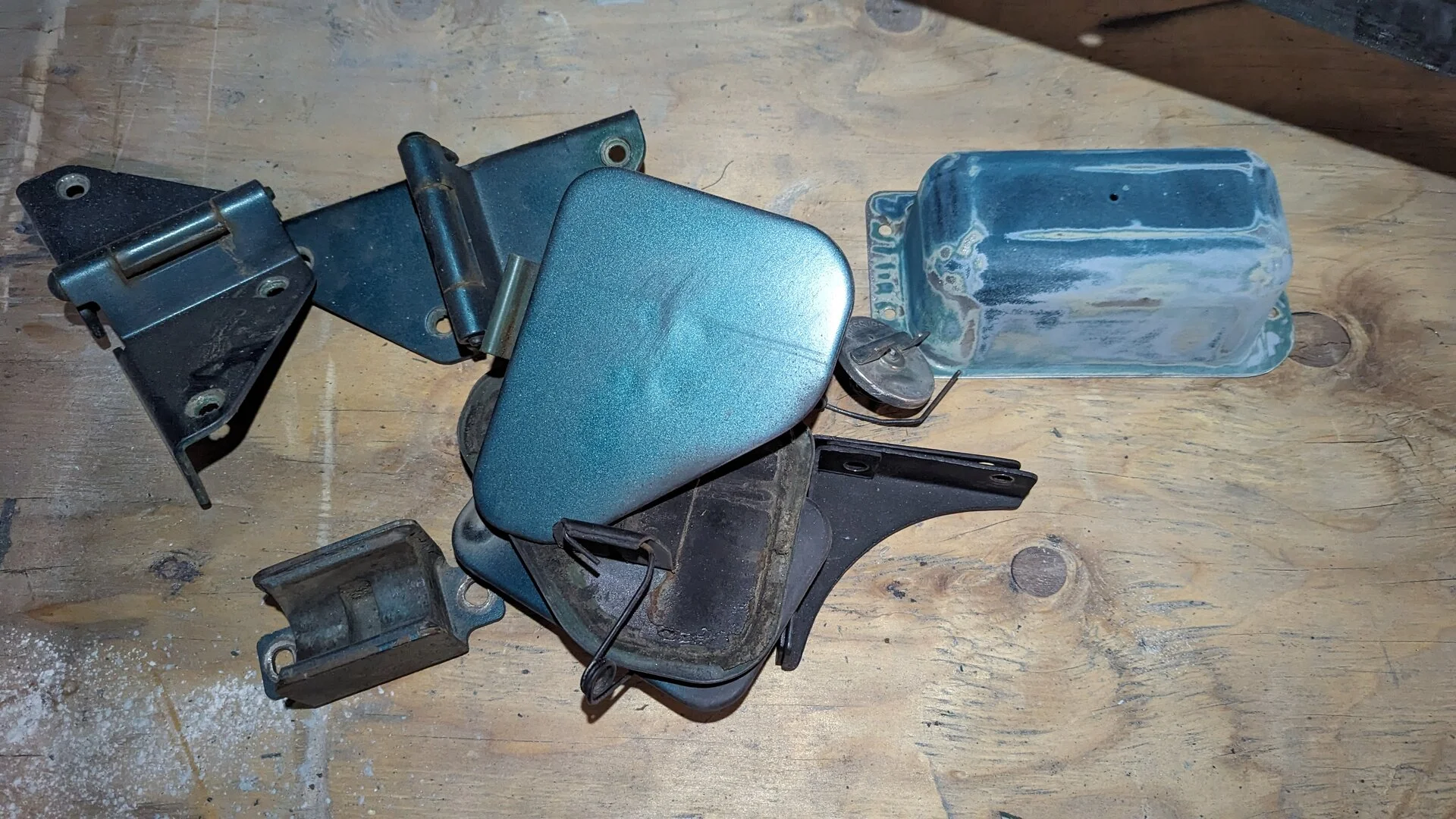

Got a set of body mounts from SOR.
I'm confused by the thicker mounting rubber and the seemingly "extra" hardware and the thin rubber squares bottom right of the main photo.
Anybody know where these go?
Middle photo is the "running board" mount and rectangle nut.
Thicker mounts are position #1 under the firewall
Thinner push-in is between positions #4 and #5 very thin spot where the tub crossmember and frame could potentially meet. Should be a hole in the cross member.

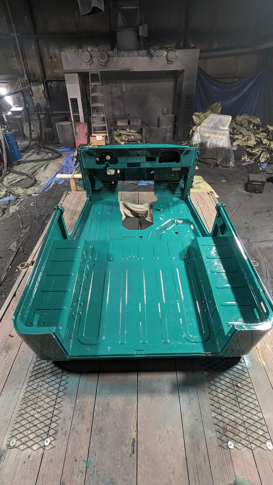

Got a couple more inches of snow. Frustrating when I'm trying to prep for paint.

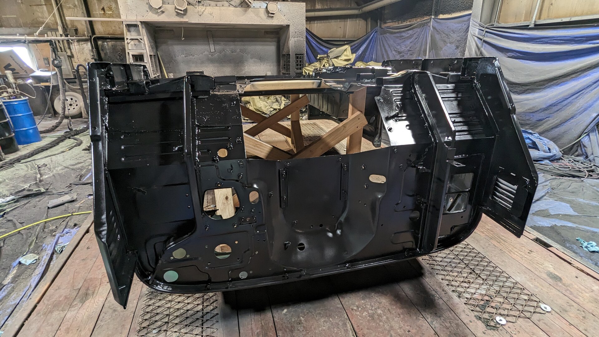

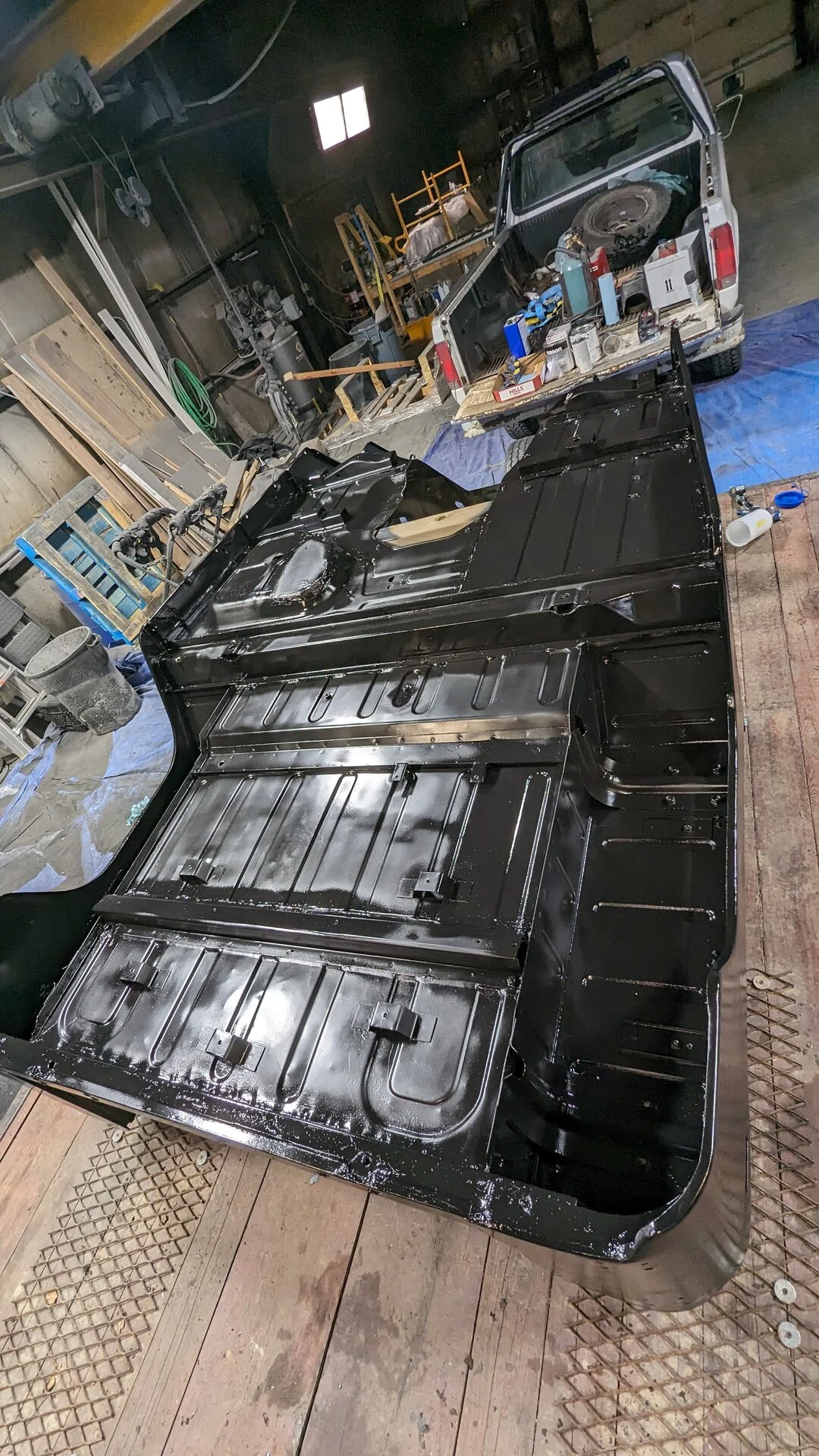

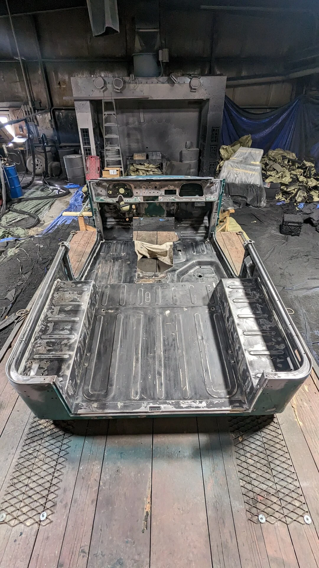

Luckily I was able to use a heated shop over the past weekend to finish hand sanding the body, seam sealing and prepping for paint.

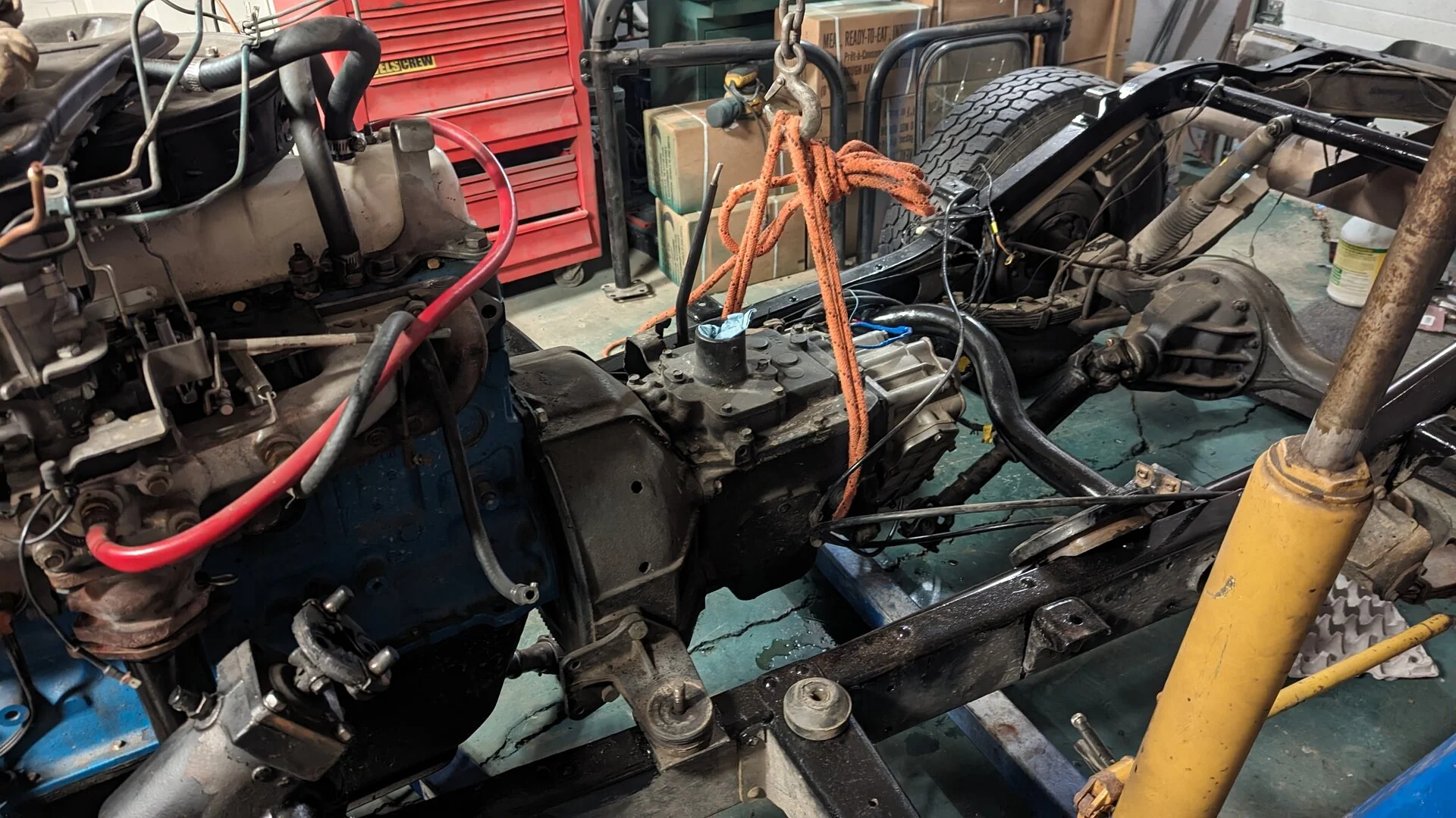

Reinstalled the transmission and transfer case.

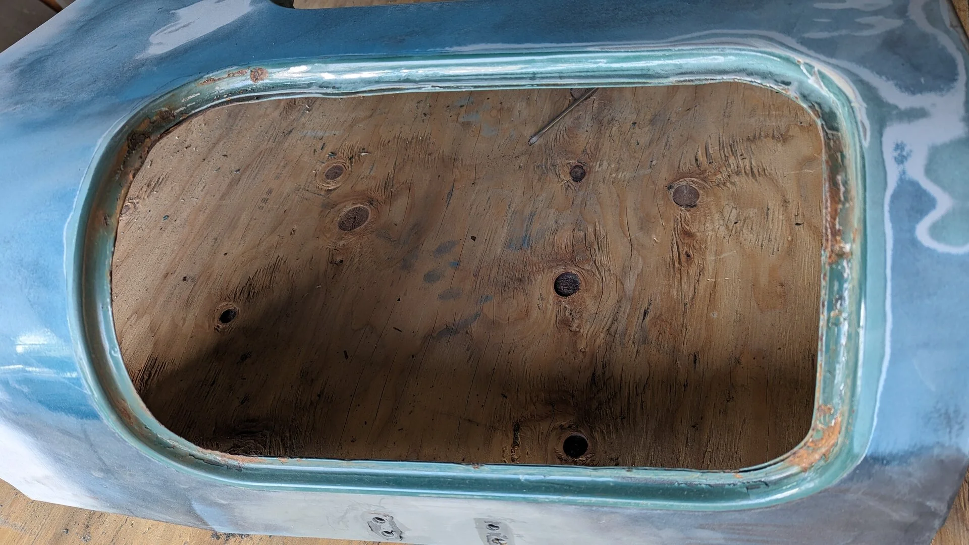

The drivers side rear side panel has suffered some damage in the past and has some filler and rust that will need to be addressed. Ill probably leave the existing body filler in place since it's in good condition and mainly focus on the rust. If there was a replacement side panel easily available I'd be tempted to replace this one, but with a bit of elbow grease this one should turn out ok.

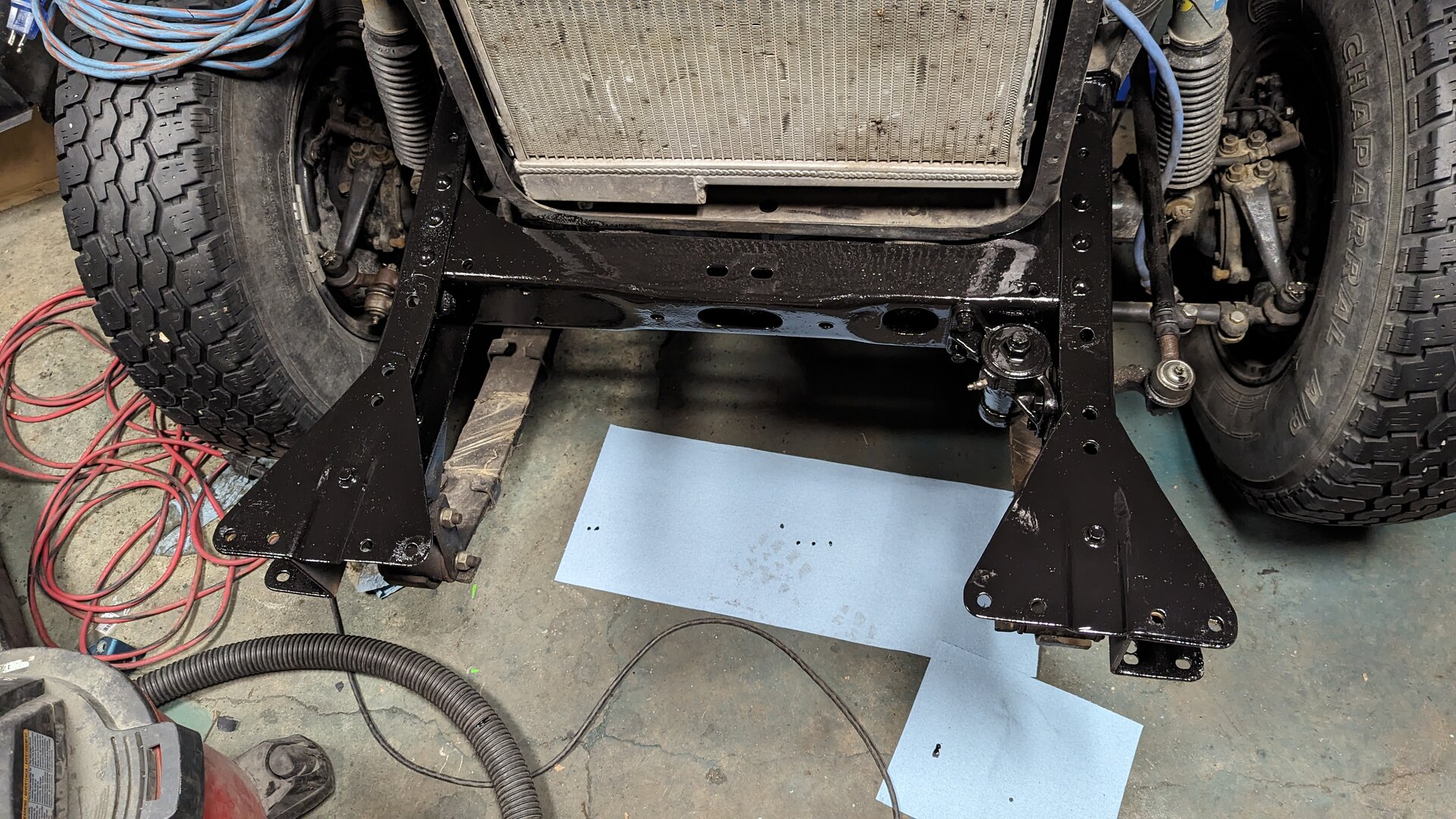

Painted the front with POR15 top coat in preparation for a new bumper.

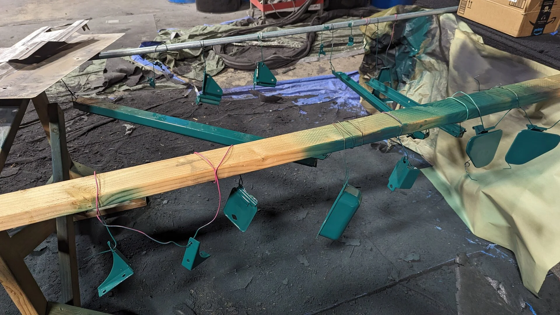

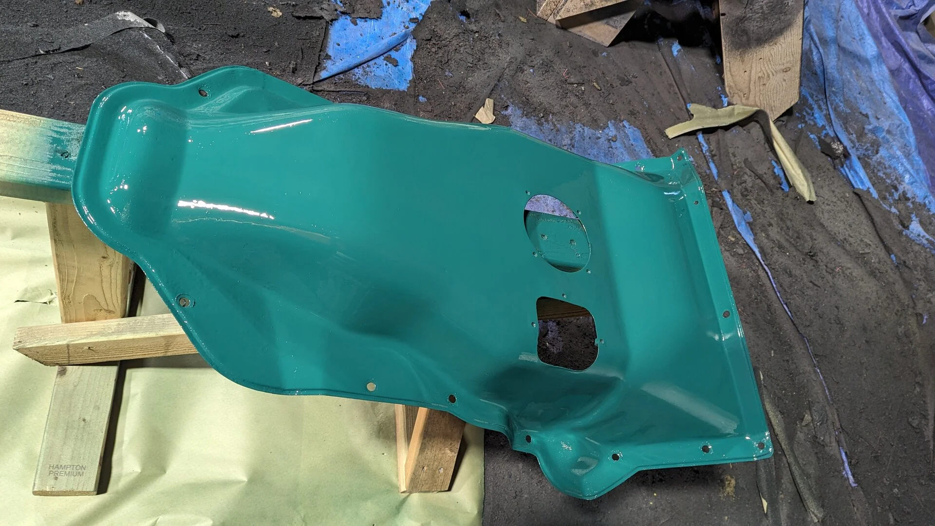

Prepping a lot of smaller bits and pieces for paint.

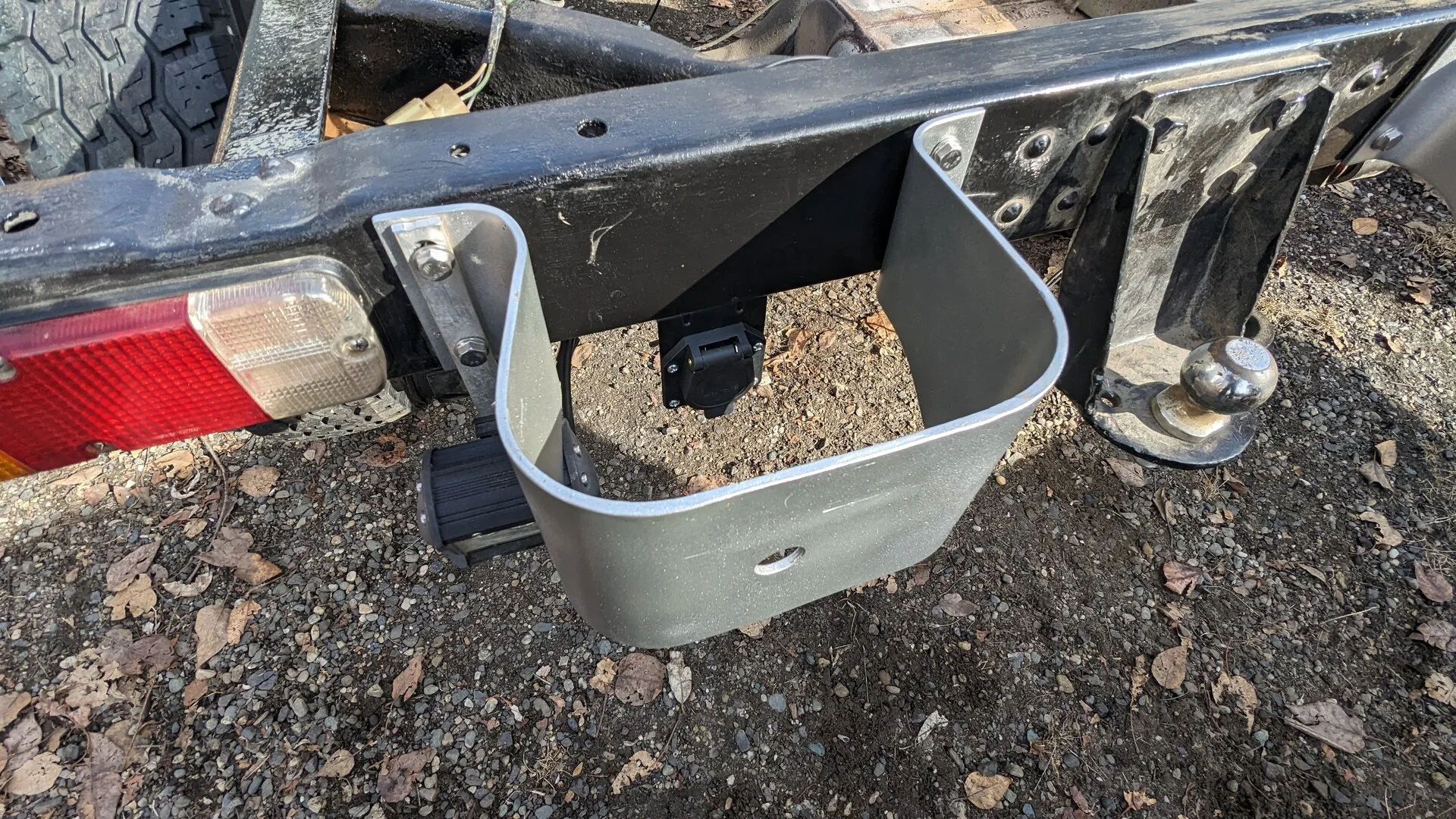

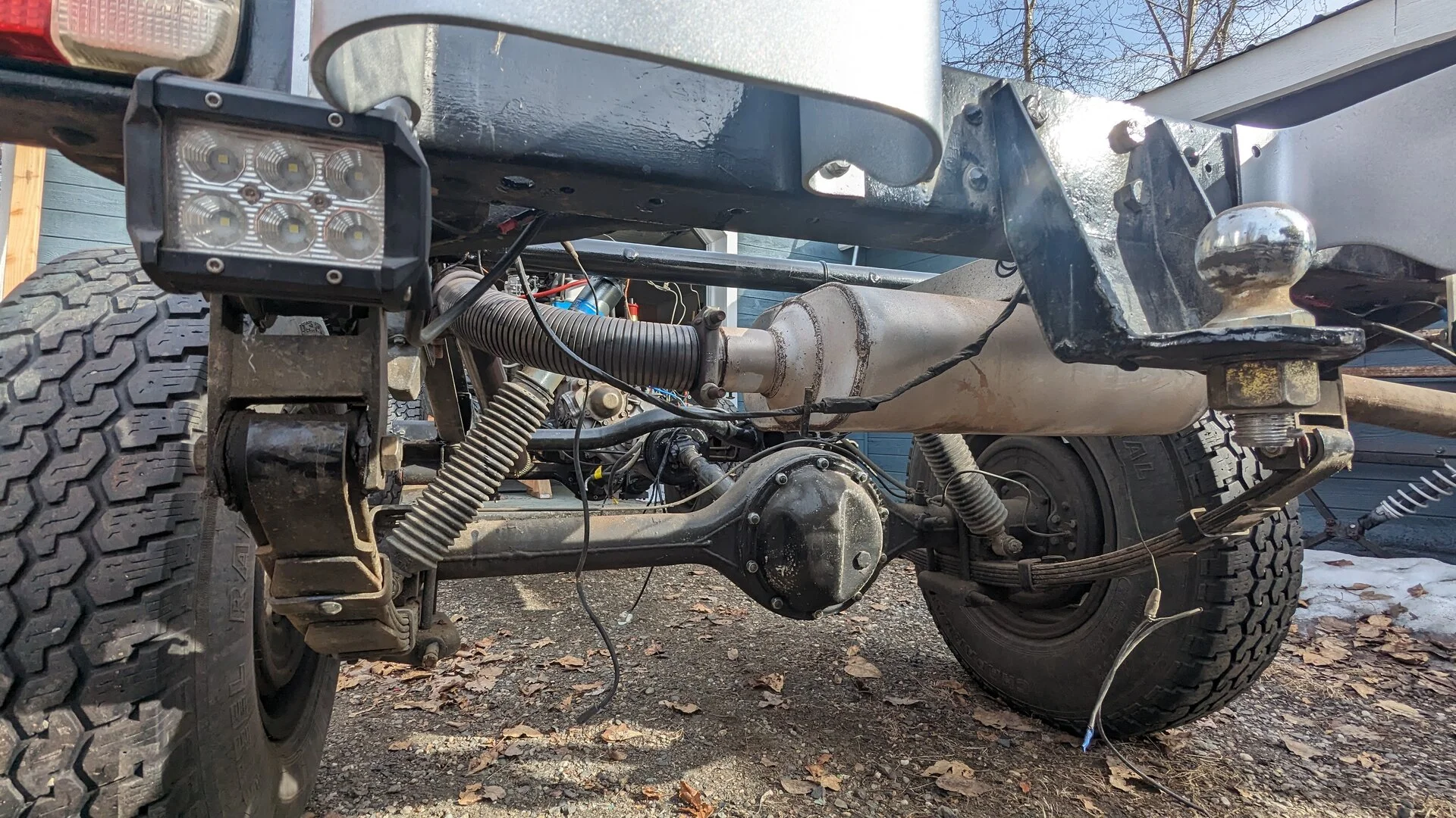

Installed a trailer wiring plug. It's not super visible and is easily removed with no permanent modification to the frame. I'll be wiring in a converter for this as well to convert between truck signals and trailer signals.
New cam plug, oil galley plug and pilot bearing from Spector Off Road installed.
I just installed a new camshaft plug and rear main seal but didn't do the oil galley plug. I'm a little worried I should have replaced the oil galley plug. I'm about to dump new oil back in and run it before I install the new clutch so at least it will be a little easier if I find any leaks after running it.
Unless it was leaking from the oil galley plug I'd assume you'll be fine. After replacing mine I'm guessing it was probably unnecessary. But for a $5 plug I'm glad I went ahead and did it while I was there.
Let us know how it turns out for you and if any leaks show up.
