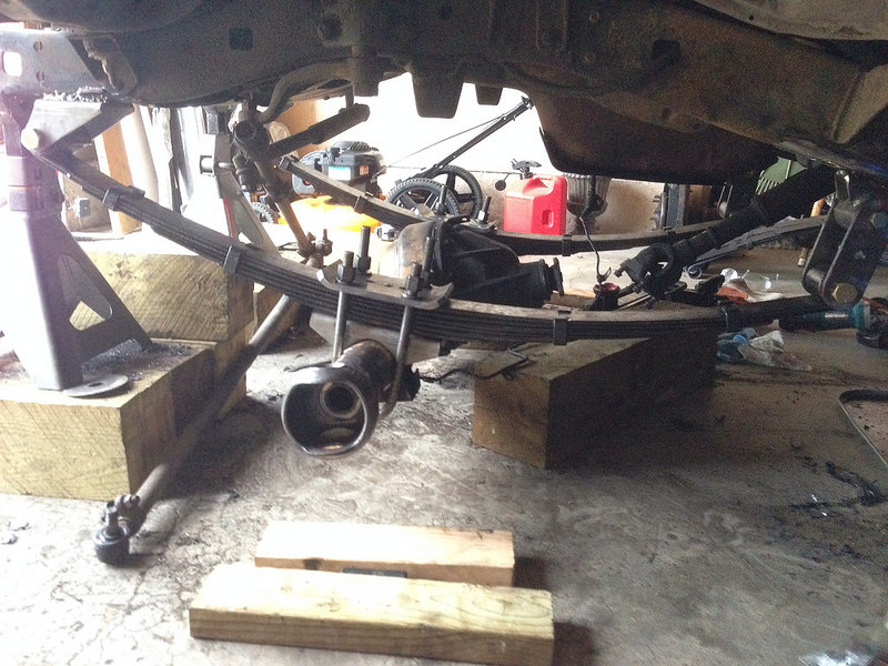

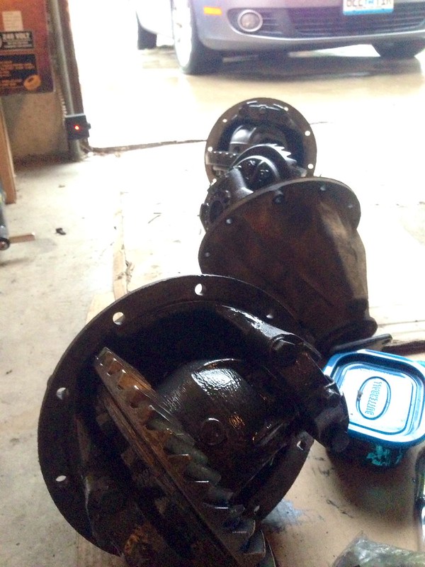

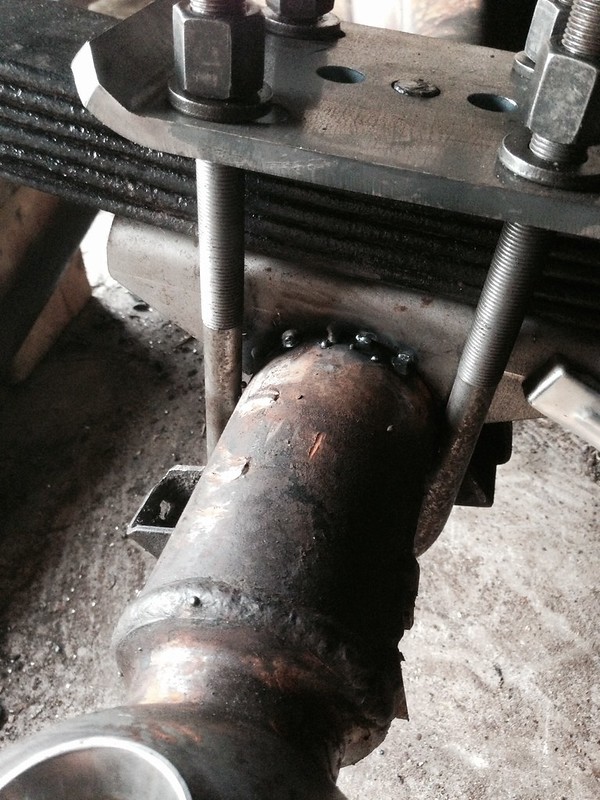

Got some stuff tacked on. This springs are back to sagged at this point, but I pointed the diff and tacked the perches under the vehicle's weight. This was just before I pulled the axle back up to get the perches welded.
Picked up a tank of Argon/CO2 and some MIG wire... What a difference!

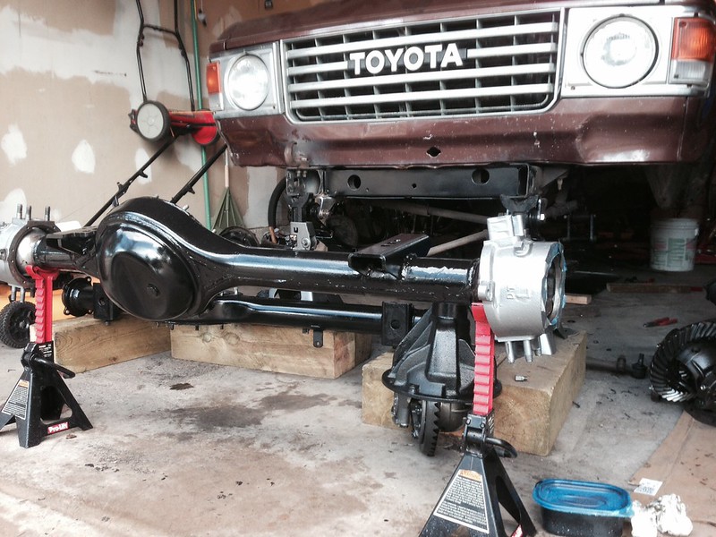

Still need to cut off the old brackets... and paint.

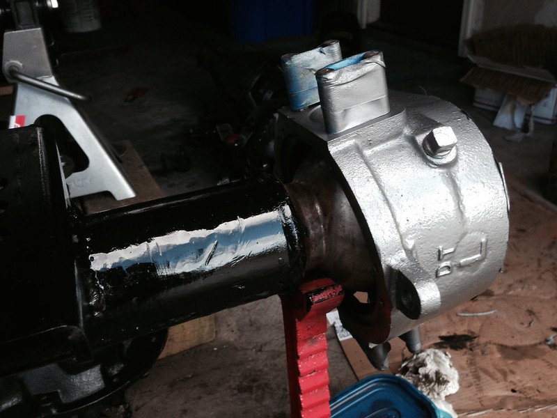

Got a little painting in.
Rusto - enamel bushed on the axles - We'll see how it holds up.
Went with the Rusto Hammered on the knuckles. The under region of this thing should look pretty nice.

Still need to cut and turn, but I just felt like painting today. Kinda relaxing.
These knuckles were beyond filthy, 25 years of grease and gunk. My wire brush is impregnated with the stuff!

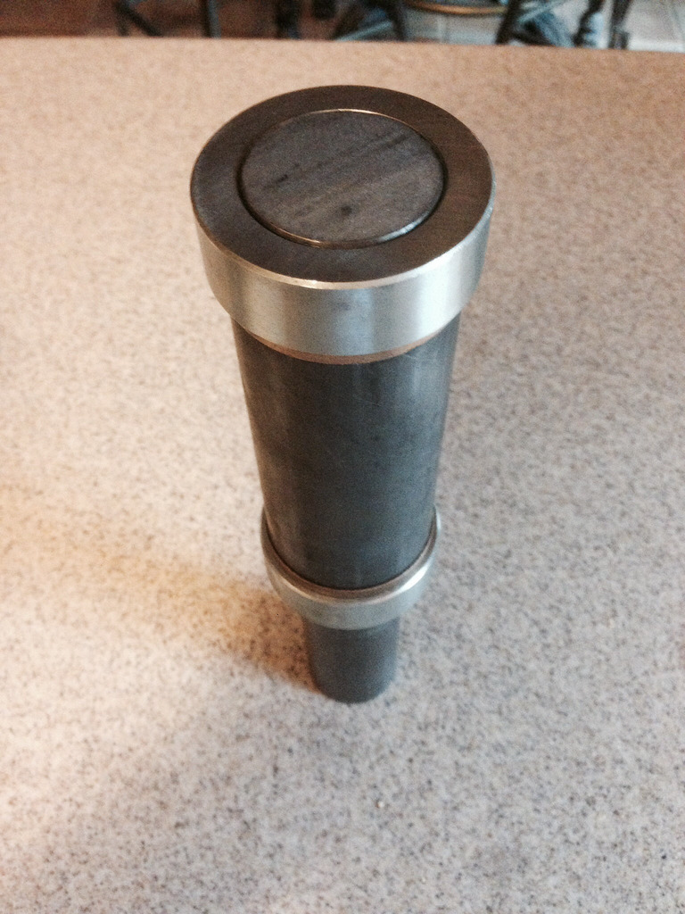

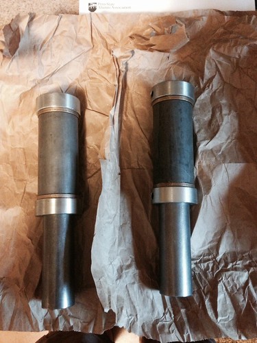

I forgot to tell you, I have the "accessory" spindles ready as well. Gas can swing outs, misc..
Here it is next to the standard bumper spindle.

Got these today. Thanks J! These things are stout!

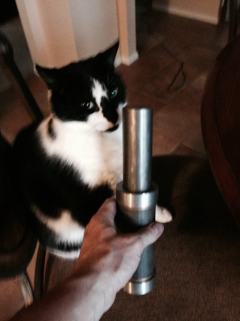

Size comparison (the cat is not impressed with them)

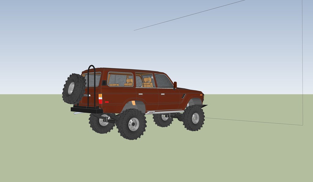

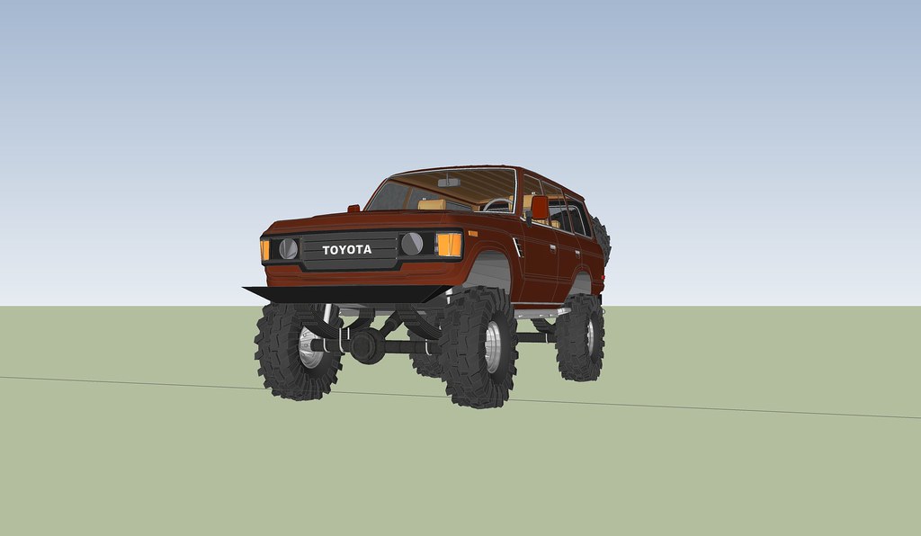

Feeling kinda bad as things have slowed down a bit. See, I'm kinda waiting on this plasma cutter to arrive and it gives me an excuse to take it easy for a few days. I did play around with Sketchup and with a little "borrowing" and tweaking of other peoples work, managed to mock up a much cooler version of the 60 than the one that sits in our garage.
Obviously I forgot to add the existing rusty spots. ;)

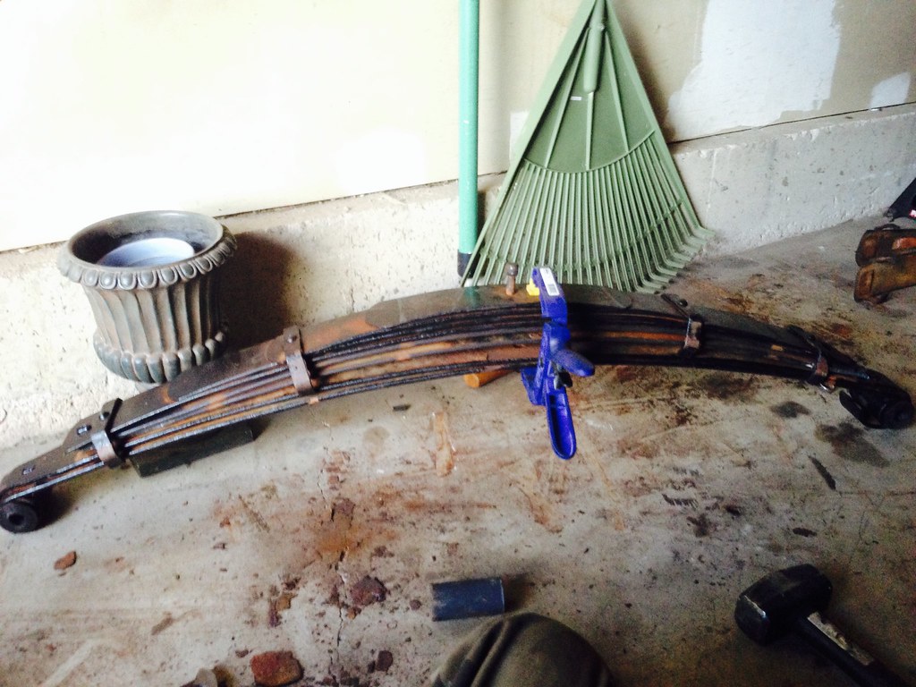

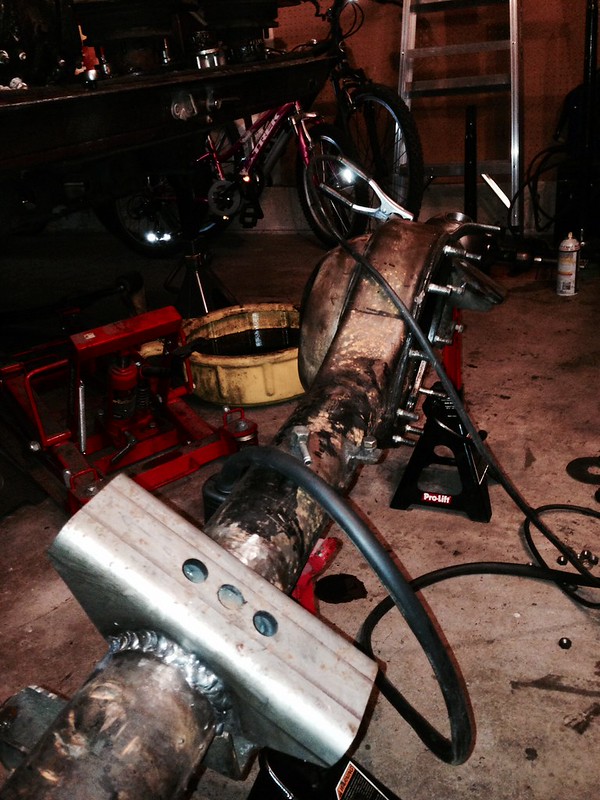

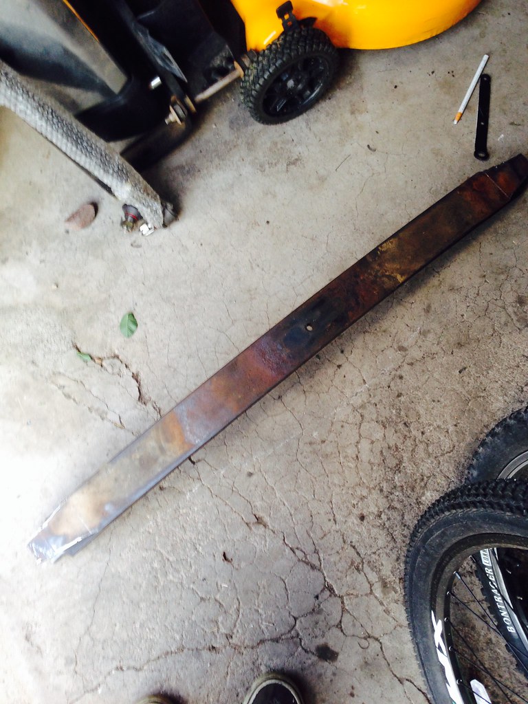

I had mounted the front springs (rear springs moved up front) but after a few weeks with full weight on the vehicle the springs were beyond flat and into inverted territory. Started the process of tearing apart the old front springs and cutting them down to add to the new front packs.
Untitled by farz_fj60, on Flickr
Still need to grab a longer pin to hold the new pack together. Hopefully this doesn't invert on me.
Do you have the plastic sliders in between the leafs on the new packs? They have those in there to prevent spring failure from the ends cutting into the leafs above it. You can plasma cut a hole to hold the plastic piece. Just a thought, if you are building a custom pack. Those sliders are in both the OEM springs and the old man emu springs I have.
Use UHMW or Delrin (Acetyl). If you ask nice I would even send you some pieces of .250 black Delrin.
http://www.ooberfabrication.com/how-to-build-leaf-spring-sliders/
I think I saw thingy in the FSM. Now I know what it's referring to! I had to build some of those thingys for one of my spring sets - kinda sucks.
