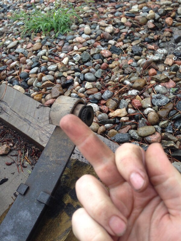

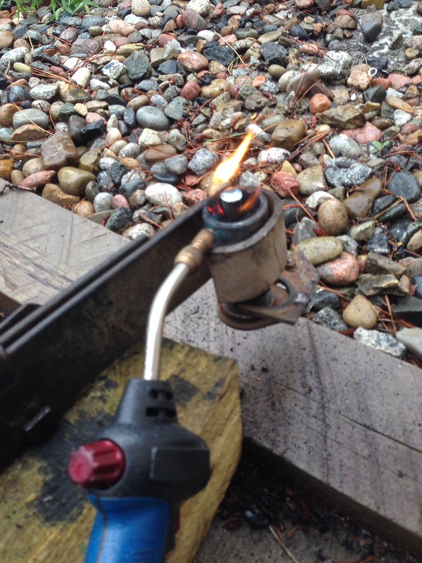

Got these damned shackle pins out--- killing it with fire.by farz_fj60, on Flickr
I found a great way to remove them....and now I can't remember what I did. I had 6 axles out at one time....
See how easy your job is - just two axles!

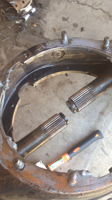

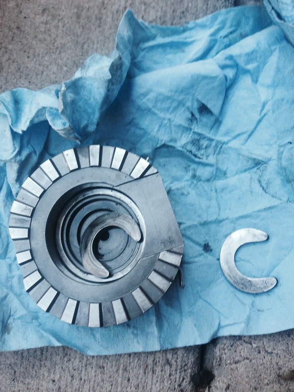

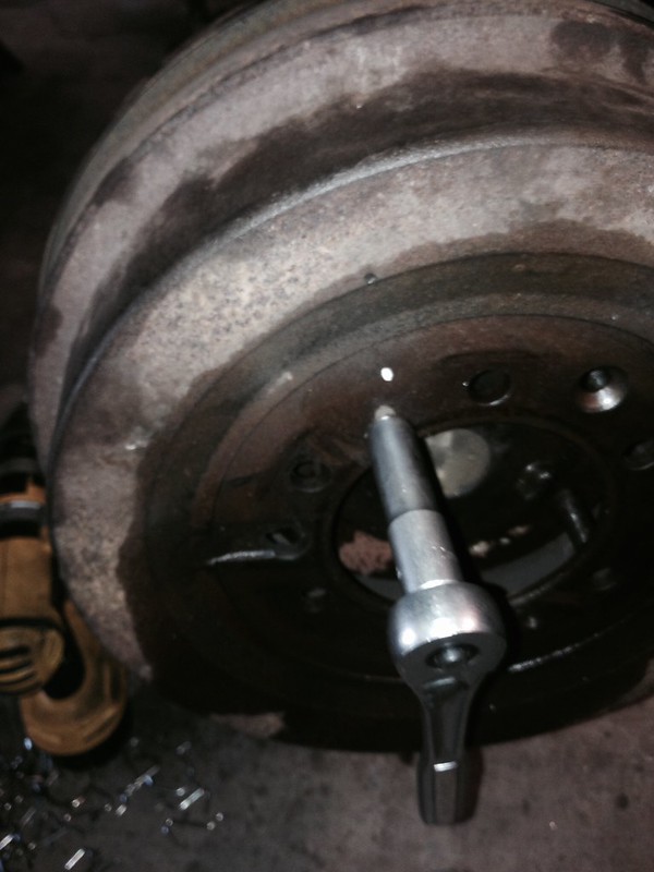

Ok, got some more done. I've been waiting on my buddy to pull his 3rd members so I could get them prepped for my 60 axle. The Diff's are coming out of a 40. Anyway, instead of pulling the 1st of the 2 diffs for me, he was nice enough to bring the whole axle so I could get them out myself. Of course be brought the rear first- so, guess who had the pleasure of dealing with removing c-clips around around this dumb locker? This guy. Anyway, I was happy to do it, getting a sweat deal on these. 4.88's and lunchbox's x2.
013b11956893be699db82ce33750918475a016e3ce by farz_fj60, on Flickr
He apparently had bent an axle shaft!
017176acc2ee75aac8995bfb60e6d64c5c2e13d42d by farz_fj60, on Flickr

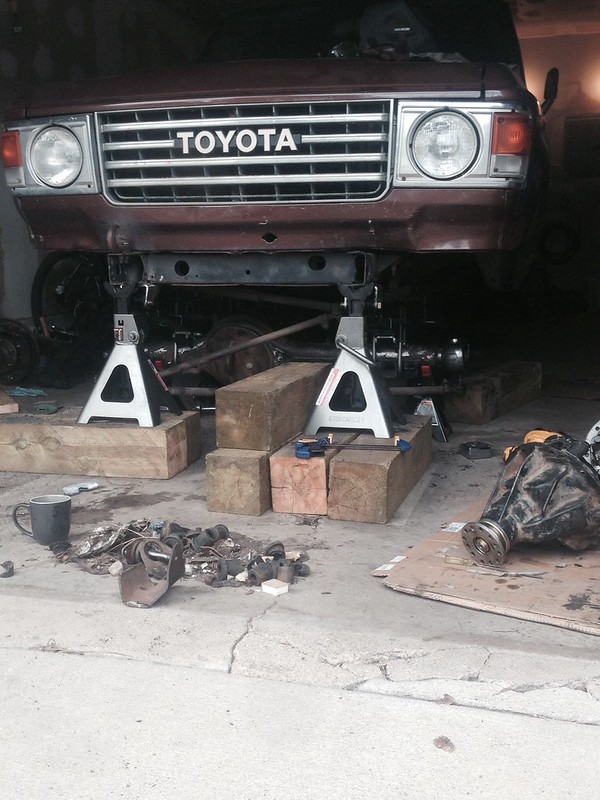

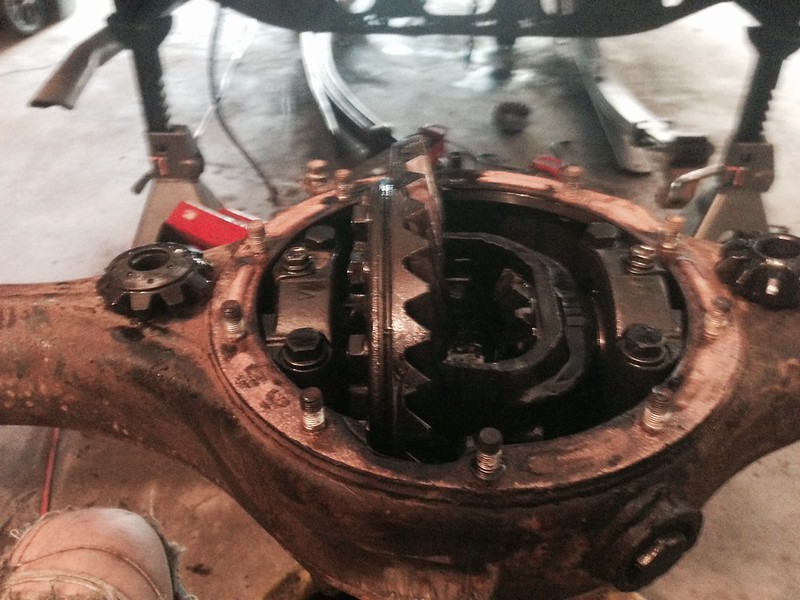

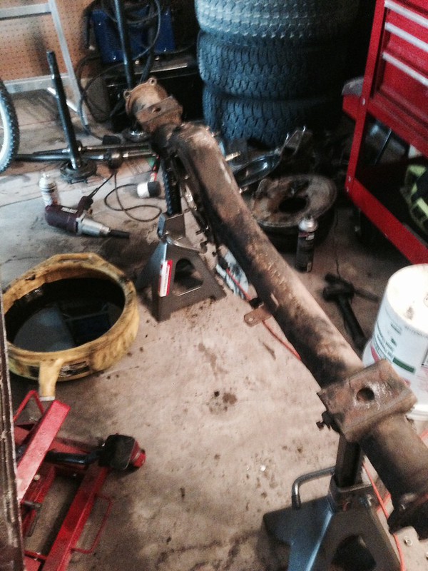

Started breaking MY rear down to drop in the new and improved diff.
01f39626ac769d8f55ce6d6a025d76294b72a1cf0e by farz_fj60, on Flickr
010e4c25c98498446e6ad536d6496b625d1d1da22c by farz_fj60, on Flickr
So much easier working inside of here with just spider gears as opposed to the locker.

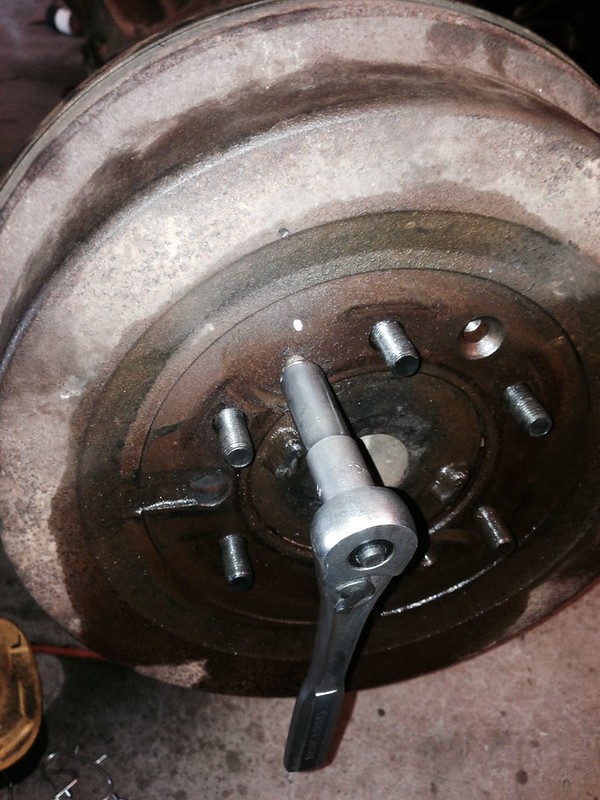

010801636fe75fde47966a47b3e48424ed89e75f64 by farz_fj60, on Flickr
and done.
01affb7da0e521b6e7f940b4d95bbdee158ef890ee by farz_fj60, on Flickr
