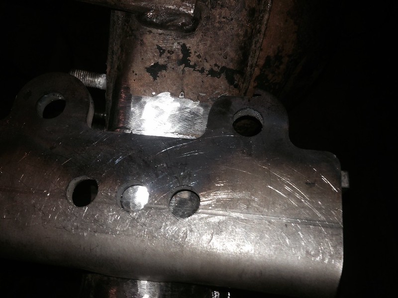

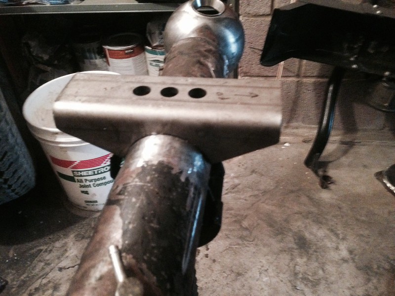

Ok, question time. I have the Ruff Stuff perches and they are not going to slide down and sit flush on the axle. Is it normal to have to grind them down to fit the axle housing? Also it looks like they sent me the 0 degree diff cut thingy. This saddens me a great deal. I'm afraid my Makita can only handle so much.
So after a day of grinding and getting perches to sit flush with the axle housings, I made a small bit of progress.
Ground this to fit.

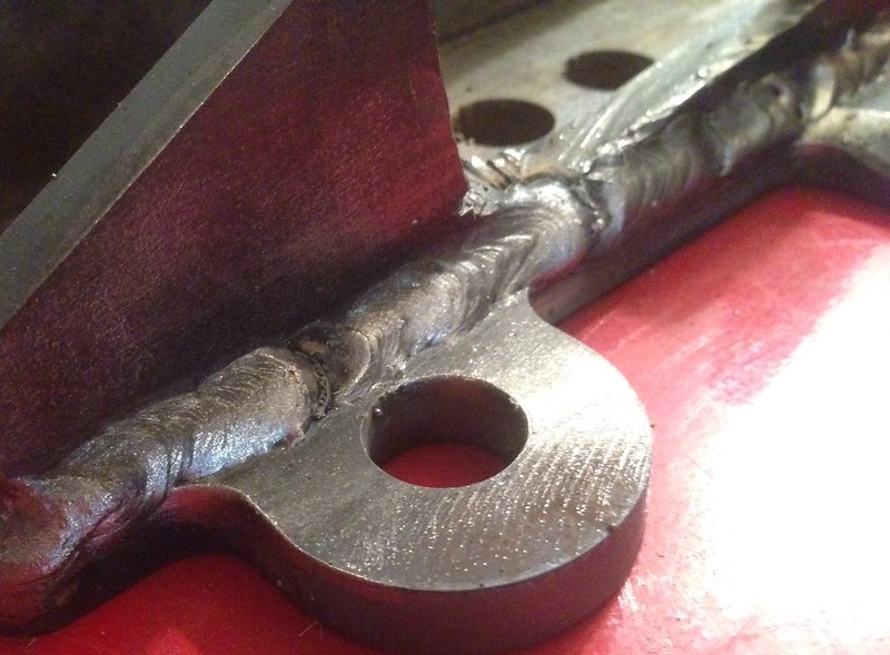

This thing.... shoot me in the face. Ruff Stuff did indeed send me the 0 degree cutout thingy and this meant a great deal of grinding and reshaping the slot to fit around the diff. ground the hell out of it and joined it to it's sister piece. It sits on there pretty flush and plenty of area weld to the axle later.
01ad24bbf1b8bba63fca5282c49844b2ffeb5a3203 by farz_fj60, on Flickr
Yay it's permanently one piece now!

Are you going to cut and turn the ends? Or did you already do that and I missed it? Since your spring perches are already off, it's harder to get the factory angle. I did a SOA and measured mine - it's somewhere here on mud.
Yeah no c&t yet. Like dbleon said- I'm gonna point the pinion to the transfer and just rotate the casters back to fall between +3-5 or so. I did take a measurement when it was still attached in the original configuration and I think it was sitting about +1 degree. Let me know if you feel like I'm making a mistake Ricky.
