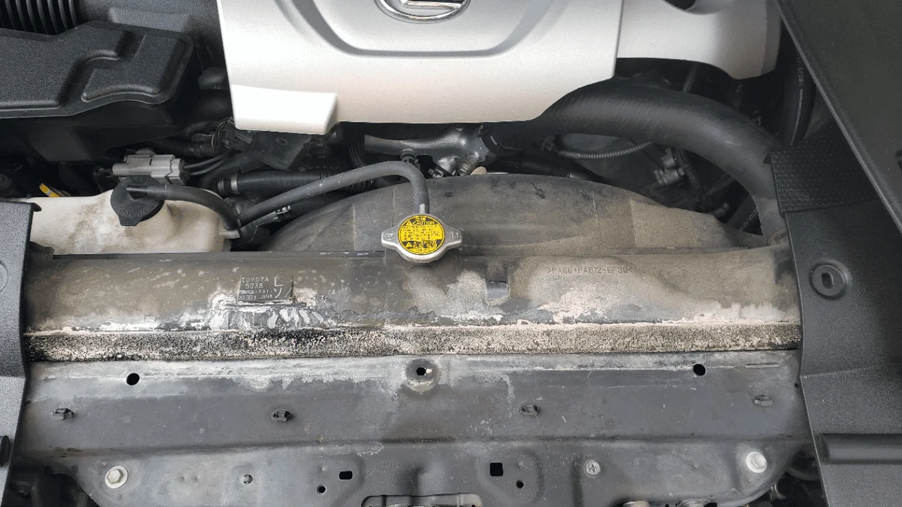

When I received it from the driver (Madison, NC to Sevierville, TN), I took the engine covers off and noticed pink on top of radiator. Now I know these have issues around this mileage so I refused delivery, and they agreed to reimburse me for repairs.

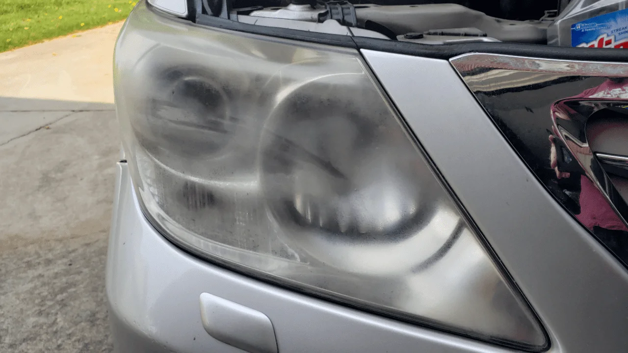

I already have plans for front and rear bumpers, sliders, 17" wheels and tires, and a Phoenix PX6 Tesla style stereo. But I am hesitant if I am staring at multiple thousand dollar repair. I cleaned up the headlights with the 3M headlight kit.

Good catch on the radiator. Definitely the typical crack. Check under the water pump for pink crusty there too, radiator replacement time is a good opportunity to do water pump, serpentine, etc. "while you're in there".

New radiator for sure. And that oil is dirty, which to me says is a leak, not a spill during a fill.

The radiator is a wash. You would have needed to replace it anyways right around now. As CharlieS said, there is also a laundry list of other things that you should chalk up to "preventative maintenance". These are all recommended even if they are not bad yet.
