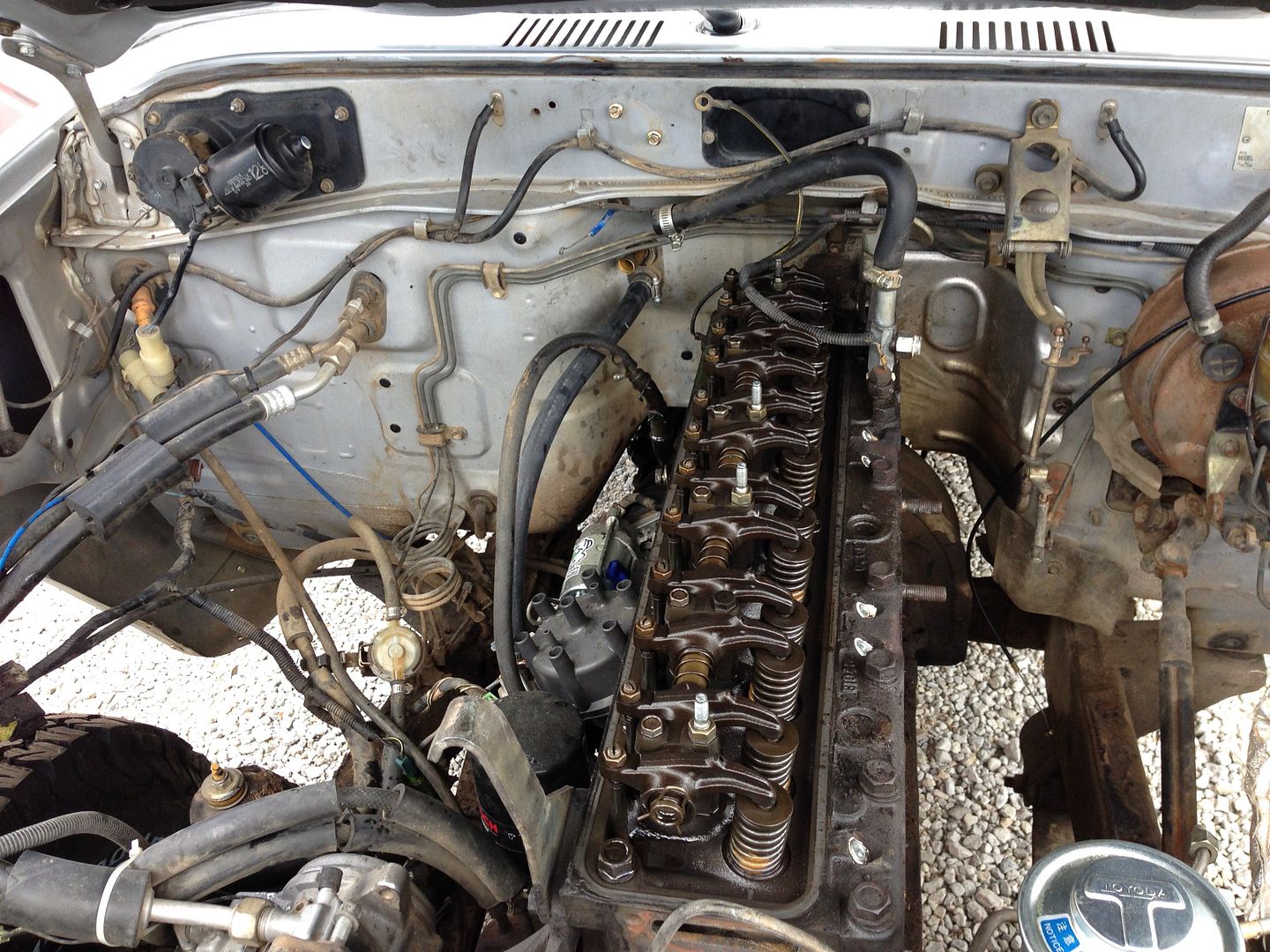

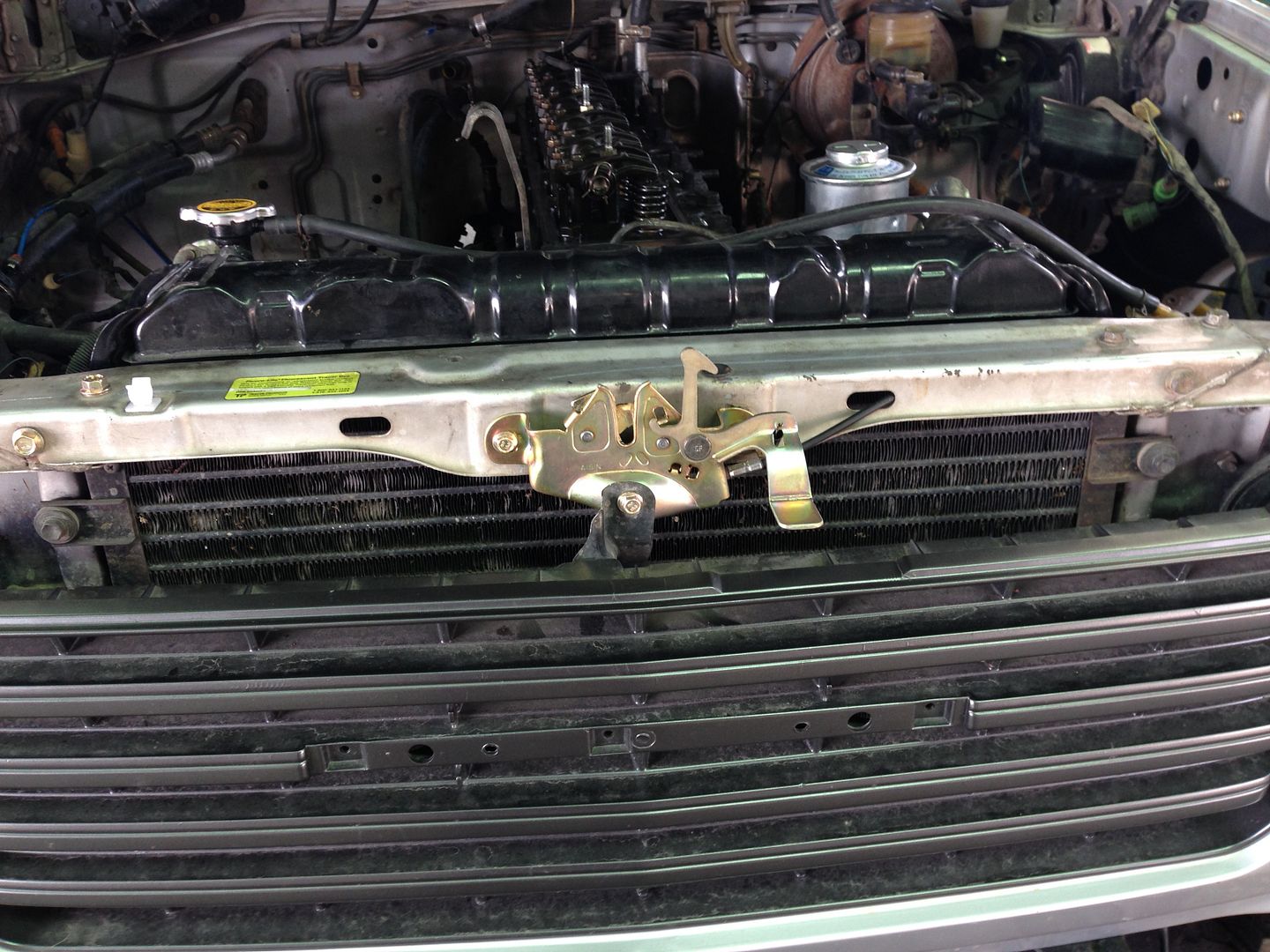

I like to take the rocker assembly apart and clean the shaft the arms rotate on, it all cleans up really easily. They look good though.
Put it back together and do a valve adjustment .05 more than the hot clearances.
