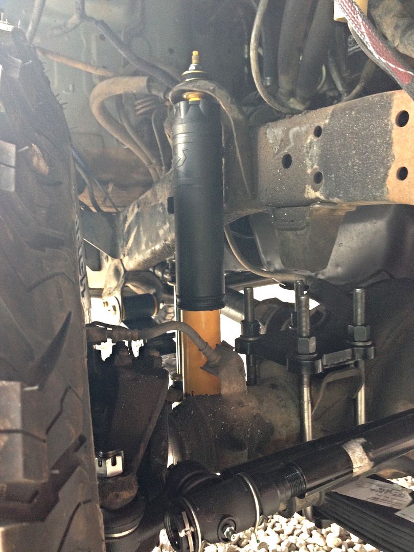

How's the angle of the shocks with the U bolt flip kit? I'm still wondering if I might have the wrong kit and would like to see if yours is the same.
Man - that was my first 'real' wrenching job on the 60. Absolutely CRAZY.
Angle of the shocks? Hmm. . .should I measure the angle?
I lined them up with the center of the flip kit and had no clearance issues.
How do I check the shock angle and what should it be?

Just a picture from the side with the wheel off will do if you happened to take one. No big deal if not. Thanks!
The stock shocks are pretty much straight vertical seen from the side. My flip kits put an angle to the shock on both front and rear. I'm wondering if Man-e-fre sent me a set for a different vehicle.
Shop had the wheels back on to move it off of the rack - got this pic but will take more next week:
Correct me if I am wrong!
But aren't those U Bolts suppose to be pointing down?

Good observation - yes, typically they are but I ordered the 4Plus flip kit from Dave. Absolute beefy product and they look friggin badass.

So if that's the case don't you cut down what's left of the threading. From the pictures looks like it will go through the oil pan on a good bounce. Or hit something
Just read the thread on the flip kit. I get and see why!
Yeah - and the back is the same, hehe. Didn't have time bf it was put off the lift. Cutting the excess is job #1 this coming Monday - if I can get some lift time. Thanks for the reminder. . .
