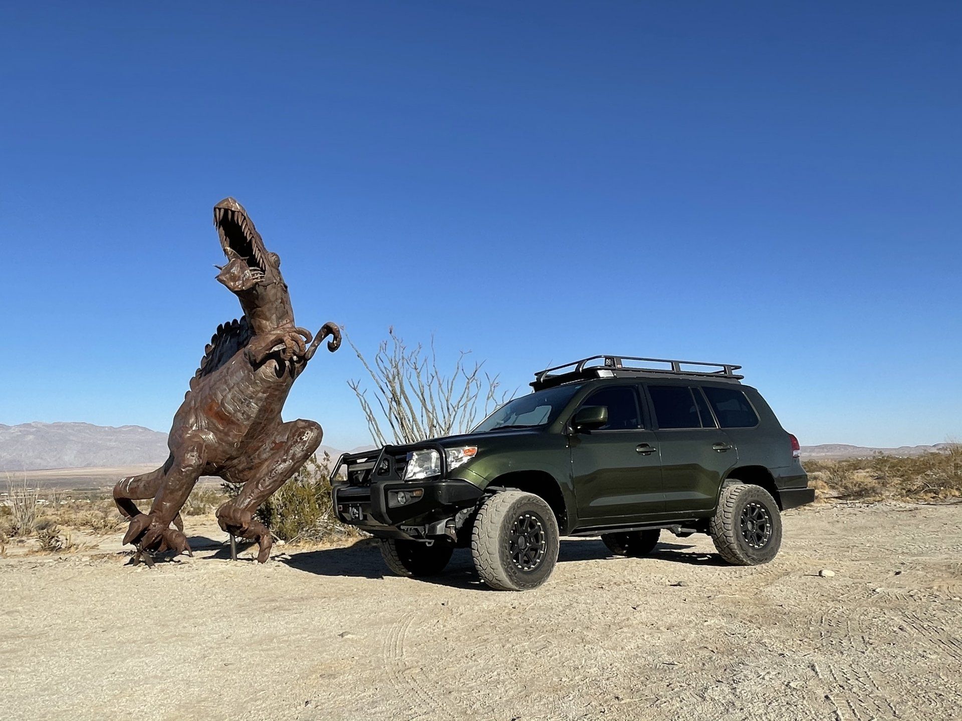

@timjax is running zero offset, no flairs
+20 offset on 11.5” wide wheels just barely stuffs into the wheel well when driving straight.
if you go with 0 offset I would think you would need to roll/stretch or cut the fenders in order to fit. Otherwise on a big bounce on the highway you’re risking slicing the tires with the fender and also smashing up your fenders.
YMMV of course

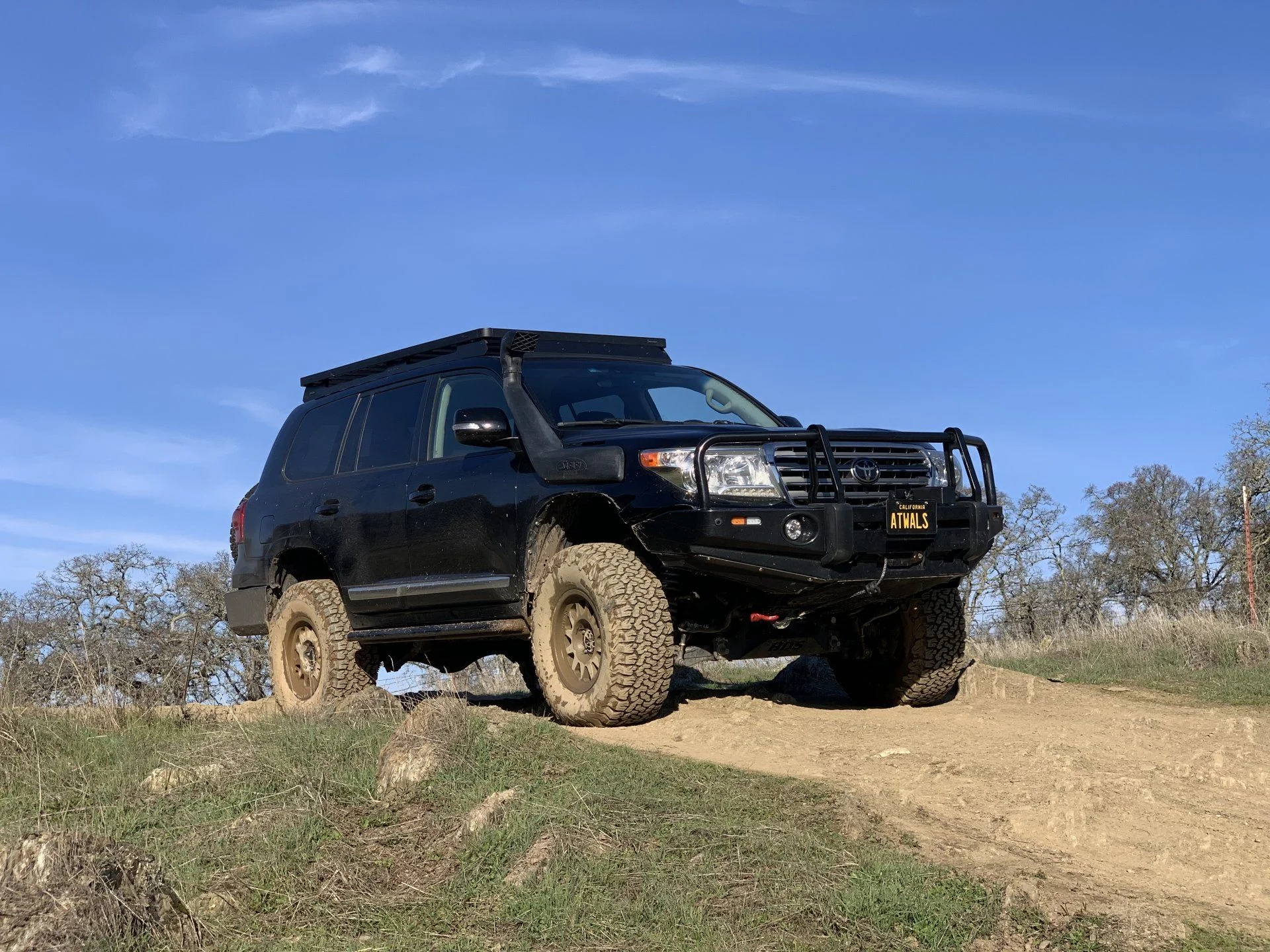

OP I'm running 0 offset, check the build thread in my signature for some pictures. IMO on-road it doesn't warrant adding flares and if it did I'd pay to change that as I hate most flares I've seen. Off-road with mud you will throw some pebbles and dirt around just a little bit more but I've fully articulated the truck plenty now and it stuffs fine with the tires I use. IMO it works perfectly if you do the typical rubbing adjustments everyone makes but is on the aggressive end of what would work perfectly, any further and you've got flares and fenders to address for sure. I can't see any reason to go there myself.
Each person has slightly different use cases/or aesthetics they are solving for, I like my set up and it works great. That being said those wheels came on my truck when I purchased it and if I were to buy a new wheel it would be the one @mcgaskins has ended up with which look better to me and are just slightly less aggressive at a +25 offset I believe. I think I might be able to go up a 1/2" in tire size if I did that slight decrease in offset.

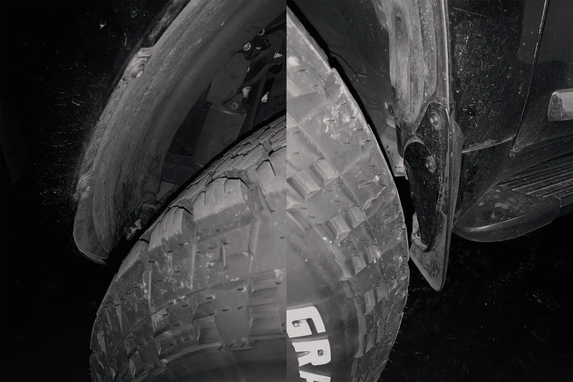

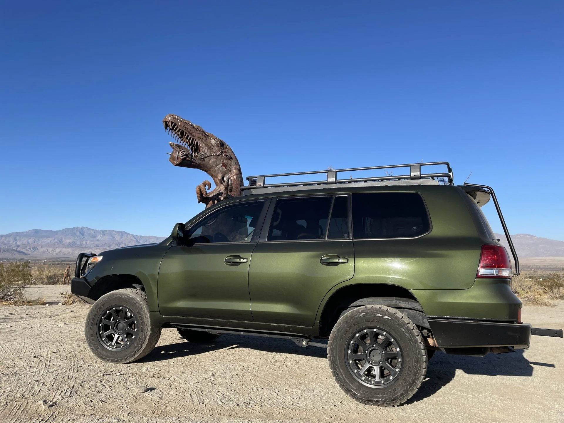

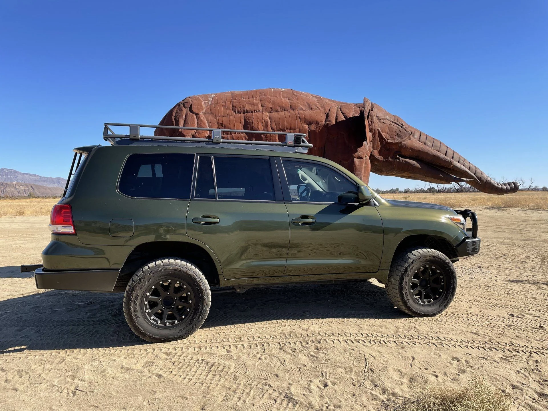

Yep: 17x8.5 +0 on 285/70R17 (33's). Stock suspension aside from the OEM Toyota front coil spacer which gives about .79" of front lift. Pushed the fender liner forward, trimmed the mud flaps, trimmed the rocker panel corner, and sawed off the rocker panel bracket. -12 offset would be a bit crazy, I would say 0 offset is the limit and that +18 to +25 or so is the "safe" limit.

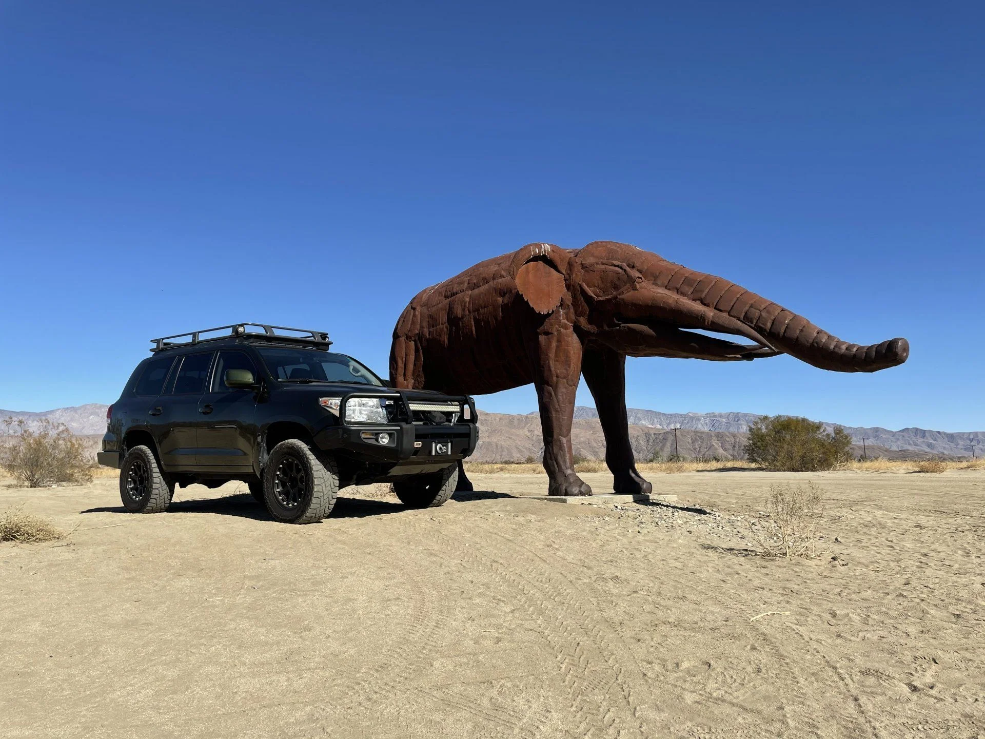

@Prime and @drftsub are even more ballsy, running 35's on 0 offset. Few more builds above as well.
