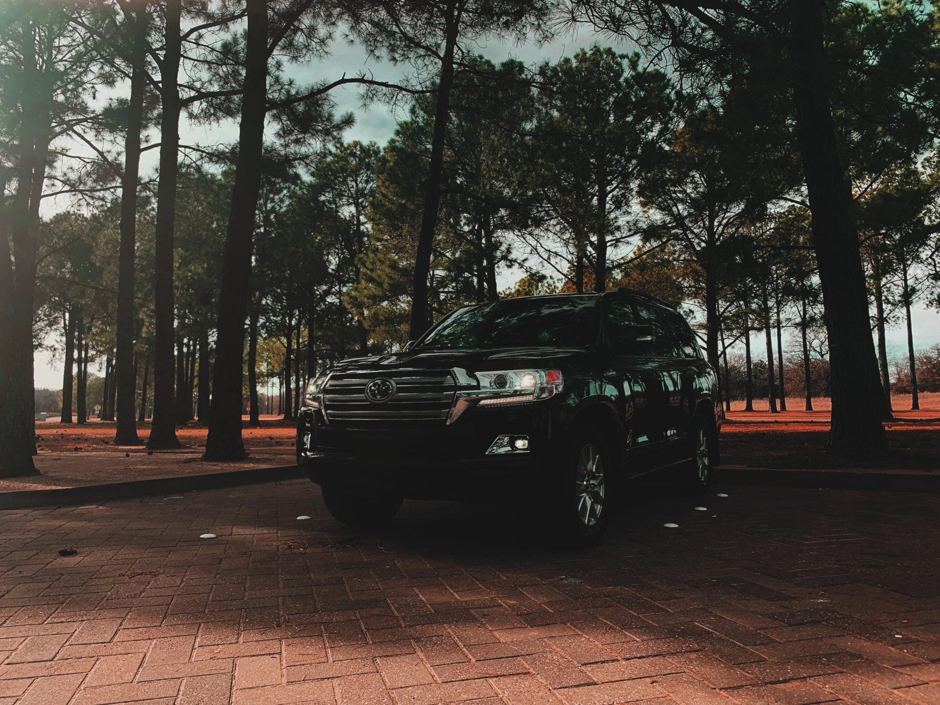

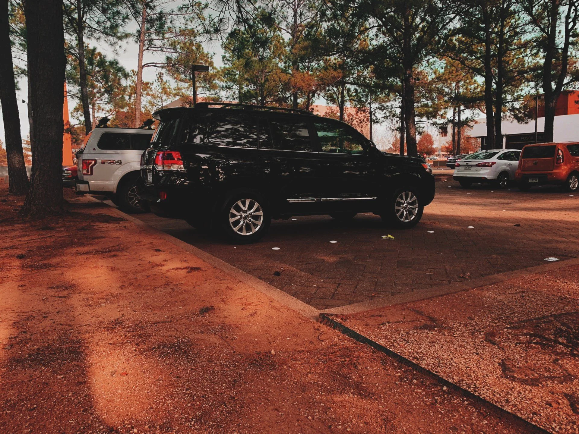

Hi guys, just wanted to post an intro thread (maybe this will turn into a build thread?). Here's Oso, the Land Cruiser that I am blessed to now call mine.

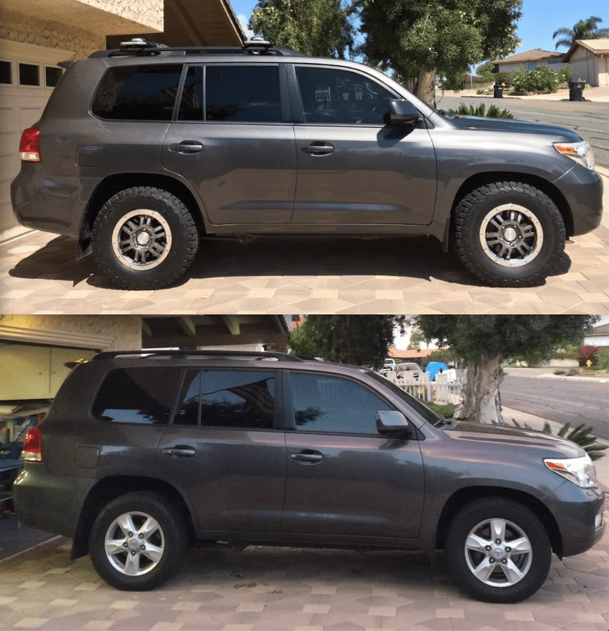

Toyota is specifically referring to this wheel/tire combo shown below (“Rock Warrior” wheels from US Tundra for us, at 17x8x50...and 285/70/17 KO2s). The combo looks/fits/performs great with no further mods.
Here are photos of each (stock wheels/tires in 2nd pic are factory 18”) on my 2008 truck. This was the very first significant change I made (besides removing the side steps)...

Looks really good, thanks for the tip. Love the switch to 17’s and 285/70s. Dustin at FN says he test fit the 17x9+25 with the 285/70, with no rubbing issues, except with mud terrain tires rubbing slightly on the mud flaps. I feel that a wheel with a little lower offset fills out the wheel wells nicely, and if it test fits okay, I’m fine with the minor risk.
But in regards to gaijin and your warnings, I’ve taken out the 17x8.5+0 wheel from consideration now, that’s just too risky and it’s not worth running a tire 1” smaller diameter and width wise just to run those poke wheels.
