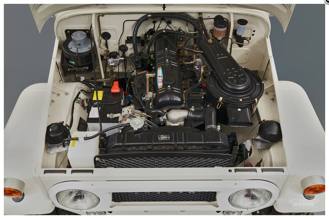

Correct. A 2F is not the correct engine. However it is possible to disguise one to make it look older than it is. I'm not sure it's worth it but, it is something to see.
Screenshot 2022-09-23 at 12-34-18 Land Cruiser Heritage Museum - 1967 FJ40.webp
Looks like someone added an oil fill to that valve cover.
Yup.
It also has a 2F carb, distributor, alternator and oil cooler. It all looks factory and if you didn't know better you'd swear it is.
