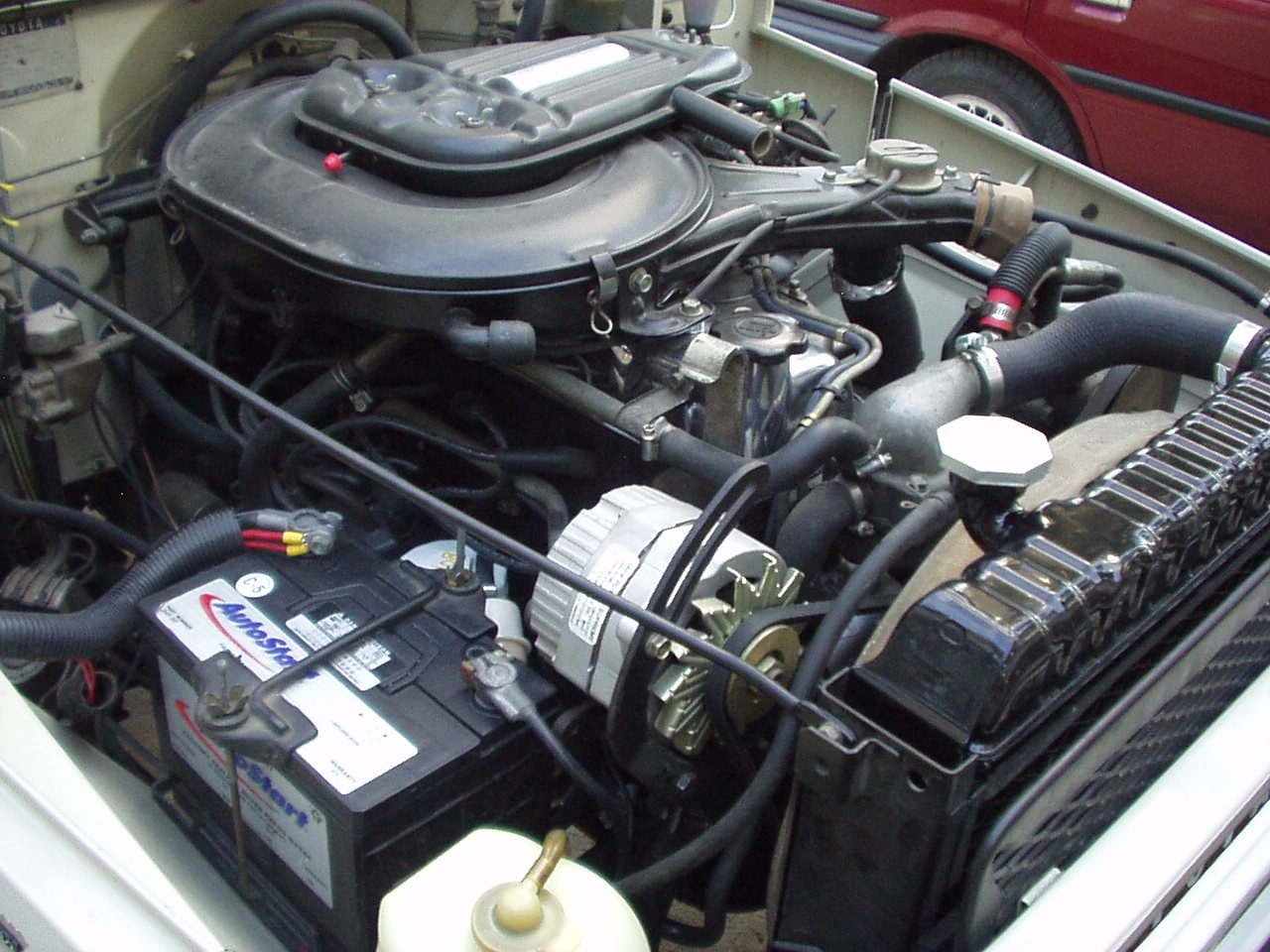

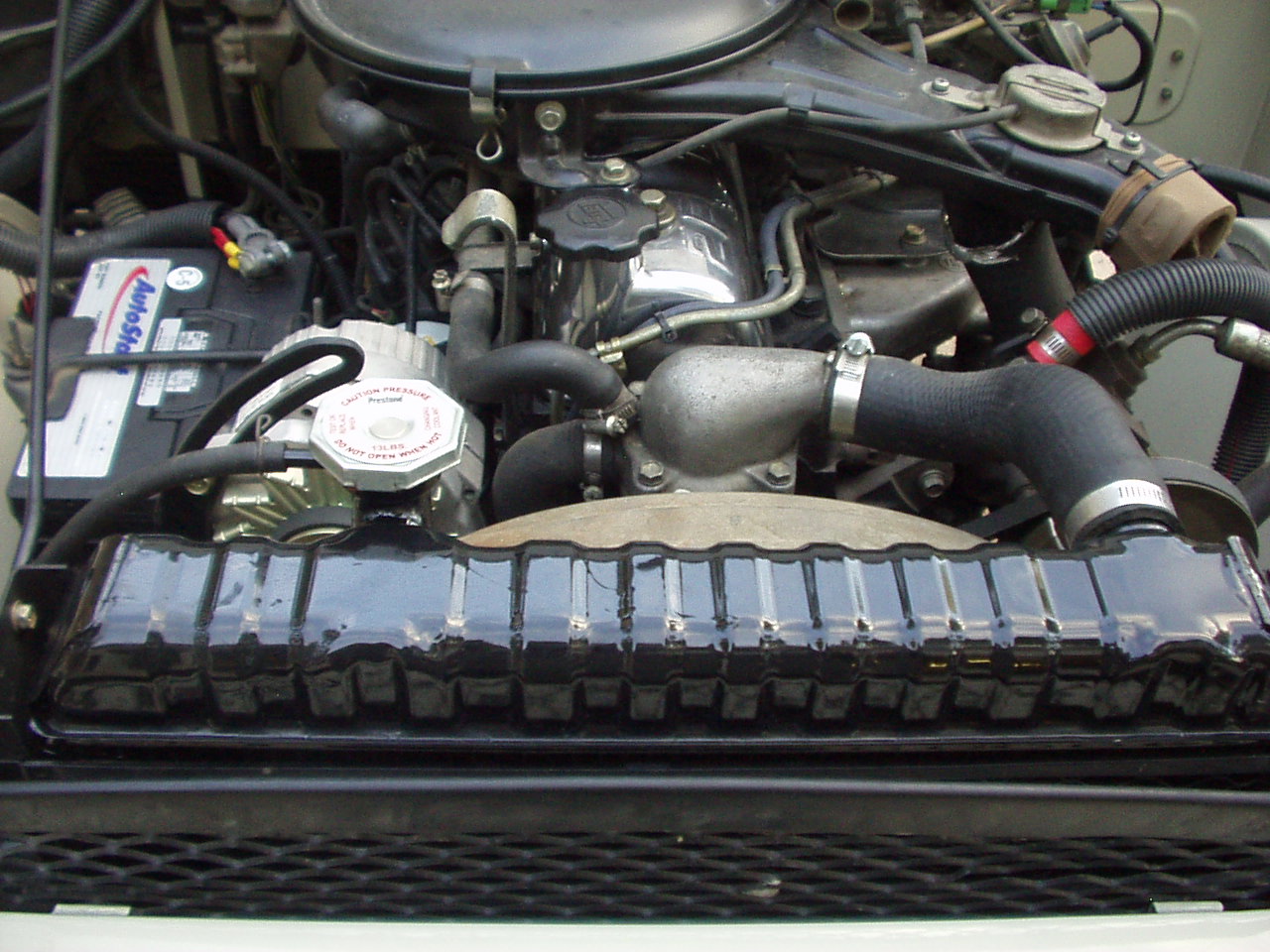

I installed an '83 2F into an engineless '65 FJ45 I bought and never did anyone complain about this engine choice. (yes, that's a GM 1-wire alternator). Far from original, but sanitary and with power steering and a brightly polished 2F valve cover. All the painfulness of an FJ45 (seating position, horrid ride, turning radius) was not made any worse by this engine. I did this 20 years ago when you could find nice used 2Fs easily. Not sure what I'd do now.
Nice looking engine compartment there! I don't remember so many hoses in mine? I'll have to look up my tear down photos now.
