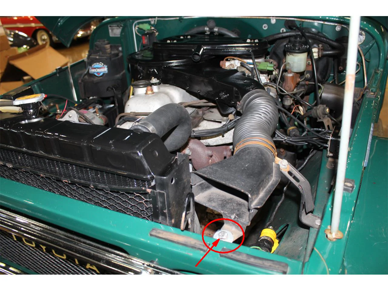

I'm trying to figure out how to mount the intake horn from a '76 on the 2F I have in my '71.....can anyone post a picture of the bracket and how it mounts to the front bib (see picture below for reference)?
I can't find any pictures looking at that area from behind. I just need to know what the mounting bracket looks like, and where it attaches, so I can make my own.

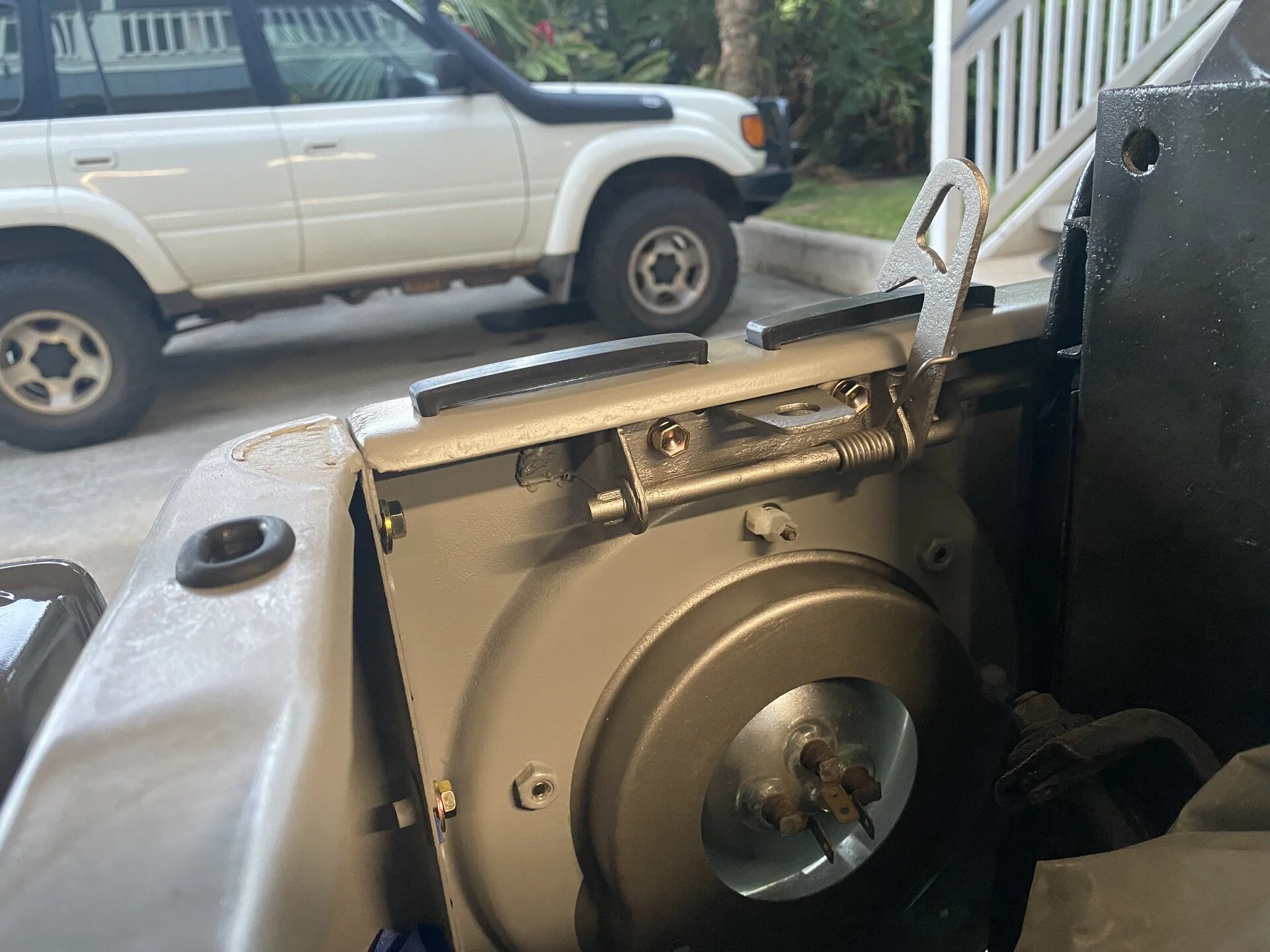

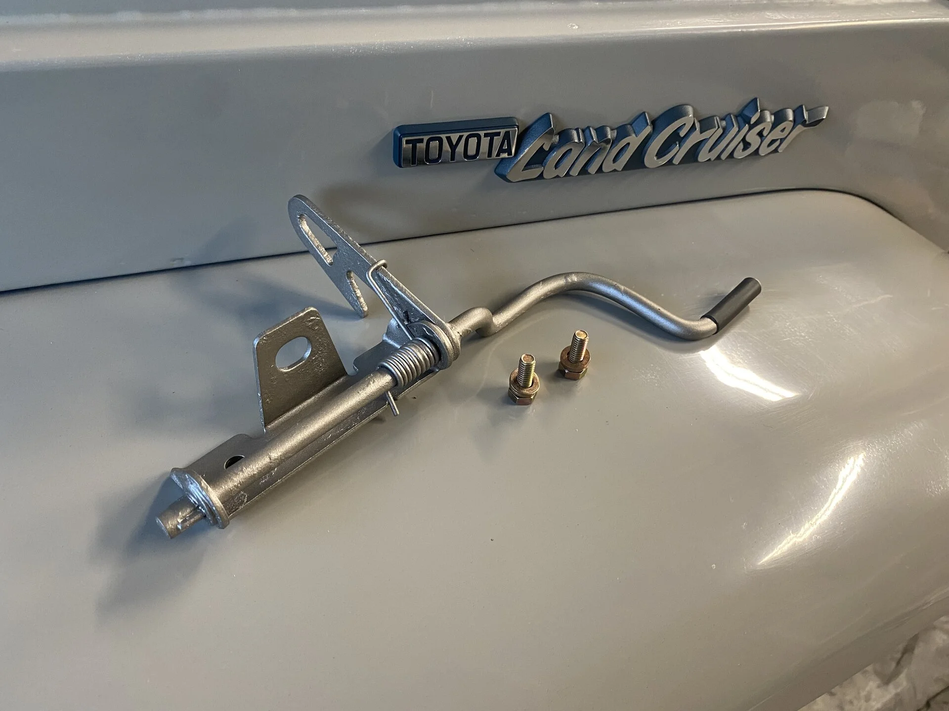

The intake horn mounts to the hood release lever. Your ‘71 most likely doesn’t have that mount.
I had a replacement front bib of an earlier year and had to weld on the bracket mounts from my rusted out ‘75 front bib. The hood latch is a nice safety feature that I assume was added in later 40’s.
