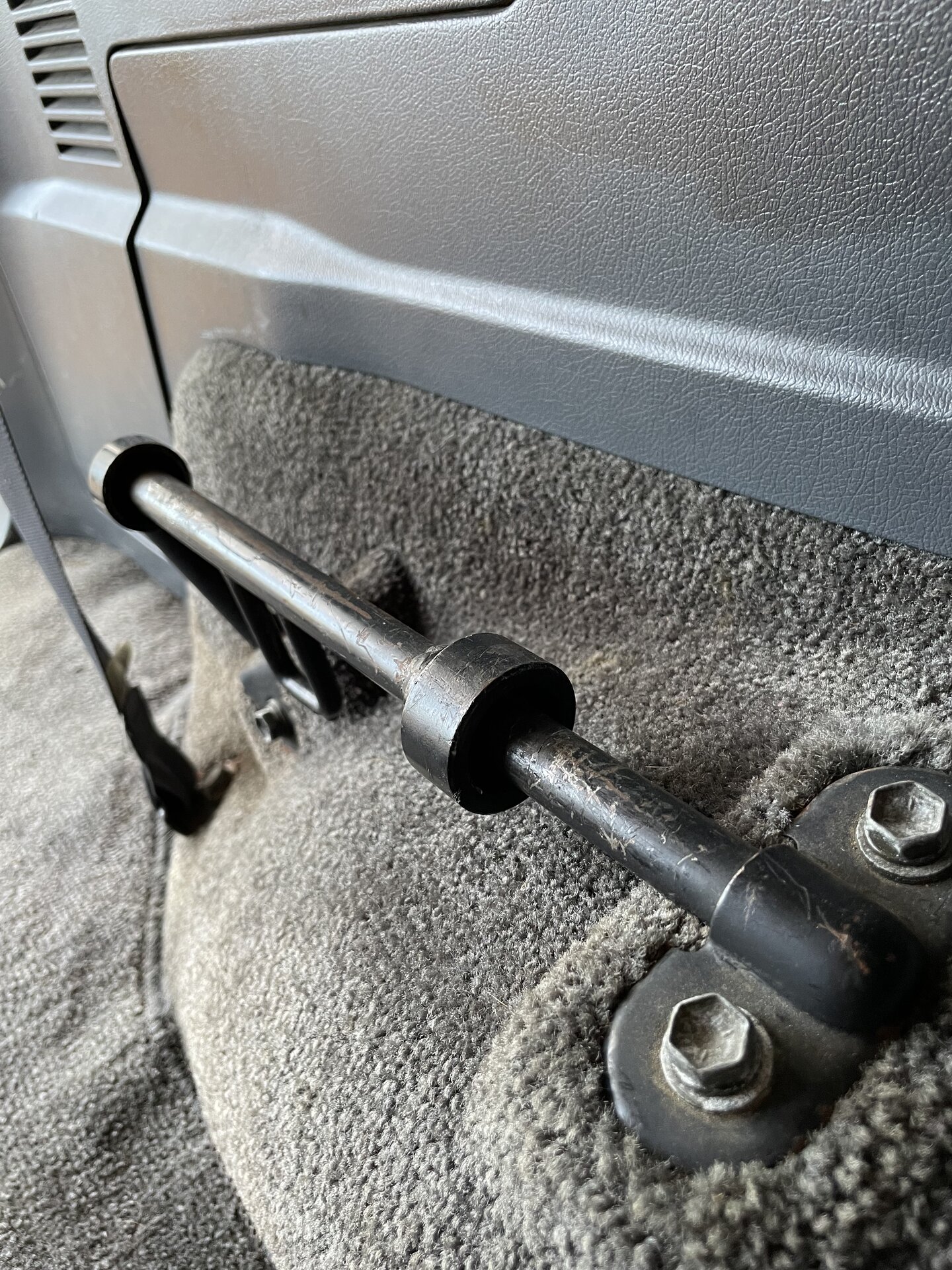

I'm having trouble with the 3rd row seat attachment points. The seats don't want to fit properly into the rail and they come loose when I try to raise them up to the side. I think I'm missing a bushing on the rail that is bolted to the wheel well. I'm not sure what it looks like. Can anyone chime in with a picture of their 80 with the 3rd row bar. Thanks for any help.

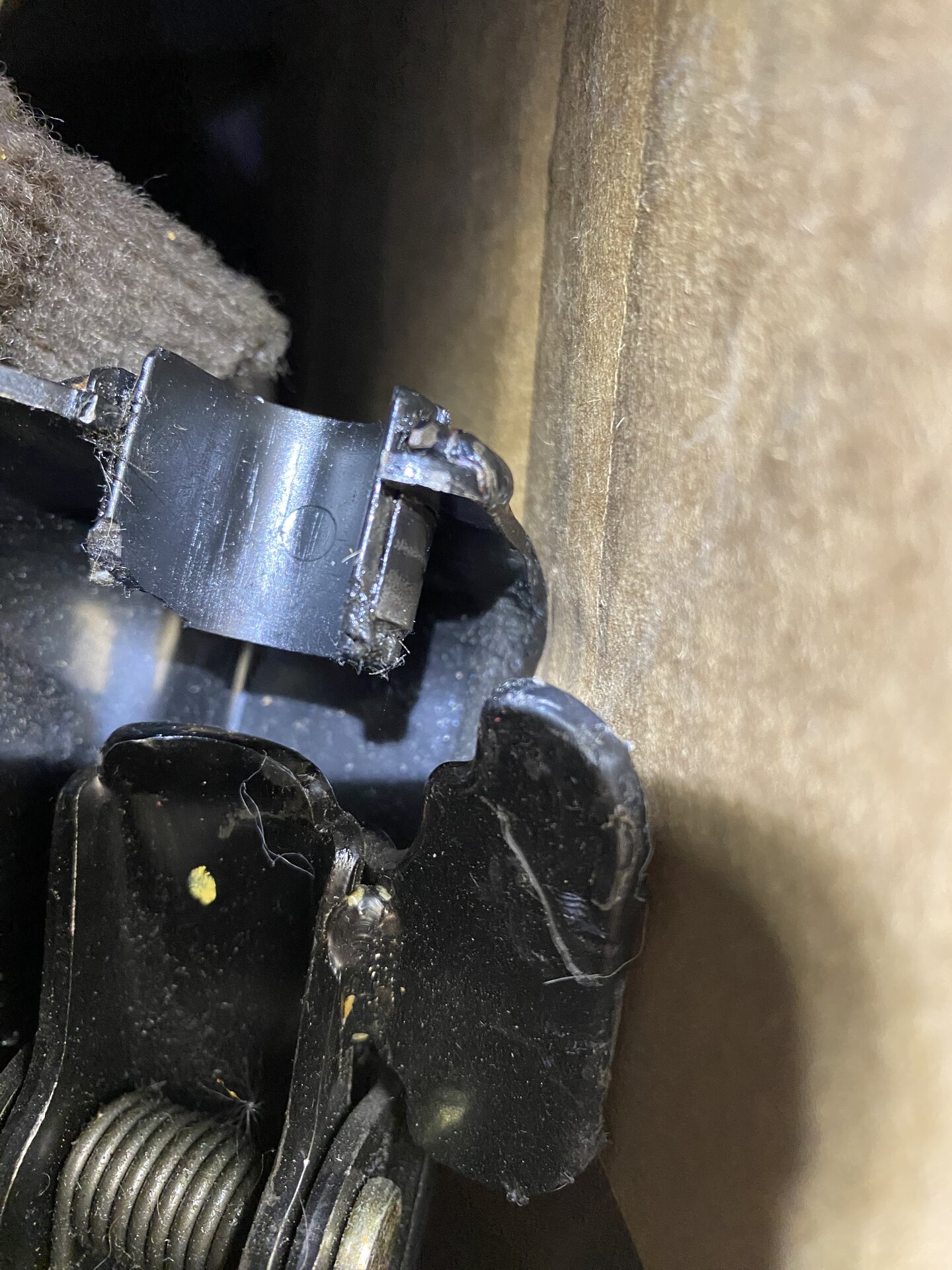

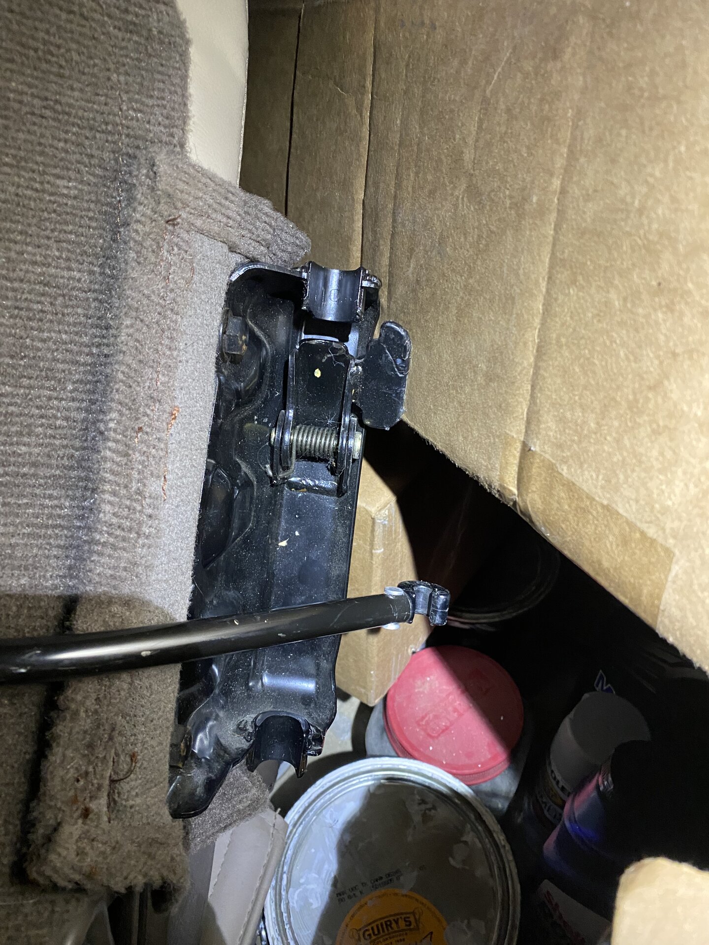

Yep I tried that but can never get a positive engagement. There were some pieces of plastic that came out in pieces before and I thought that it was part of a plastic bushing that was supposed to be there

I'll try to remember to snap pictures next time I'm messing with my 3rd row. The plastic bushings are on the seats themselves, not on the mounting rail. your mounting rail looks complete to me.
Bushings are part of 78910A (RH, 7891060020) and 78620A (LH, 7892060010) in the diagram above. Seems like you can still find the assembly from Toyota dealerships or you could rob it off of a complete set of 3rd row seats that you find used.

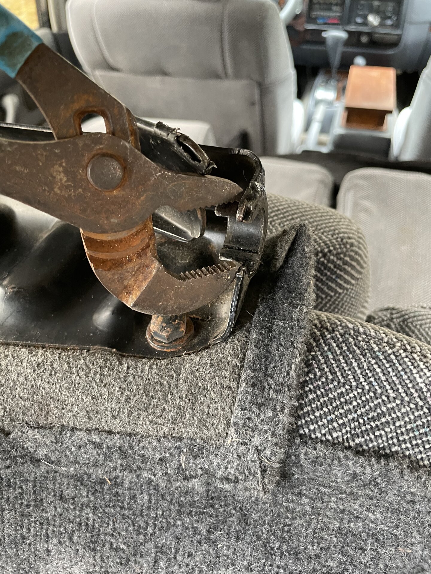

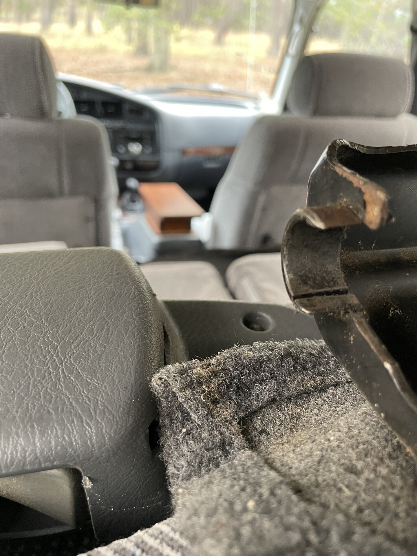

So with a little finagling, I figured out the problem and the seats go in easily now. The semi round tabs that engage were just slightly bent enough to not go into the female slot. I used a pair of channel lock pliers to bend them enough that they fit inside intil the spring clasp secures the seat, problem solved. I have been fighting this since I’ve had the Landcruiser for four years and could never figure it out. Thanks for all the help!
