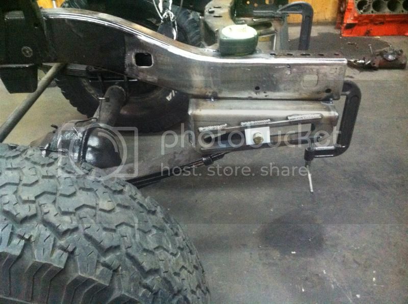

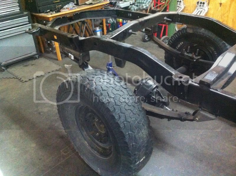

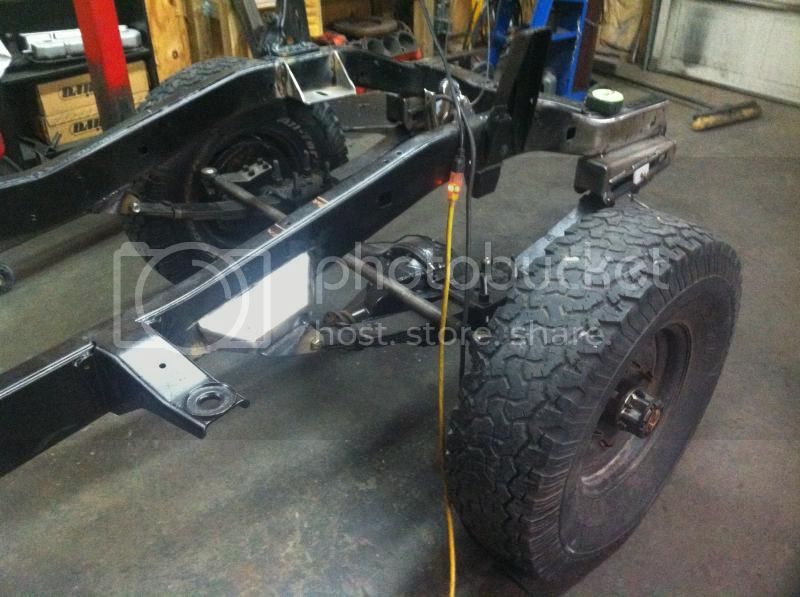

Sliders tacked on front and rear
Droop and compression tested and full travel is allowed without running out of track on the sliders

Sure do like the look of the sliders. Your guy is doing a good job. Nice job on the boxing in of the spring hangers, too.

I'm really happy with the sliders. He's going to make some gussets for the front sliders next week to better brace it against the frame

The Soa was a bit of a rough road, but in the end seemed to turn out ok. I say seemed because the pigs been on the back burner for a while, so its not yet drivable for me to be able to test it on the road. . It was taking both too much time and too much money and I don't want to take too many shortcuts. I will say this, it lifted it quite a bit more than i expected it to and never settled in lower. I have a hdj81 with a 4" lift (same size tire), and it is A LOT easier to climb up into.
