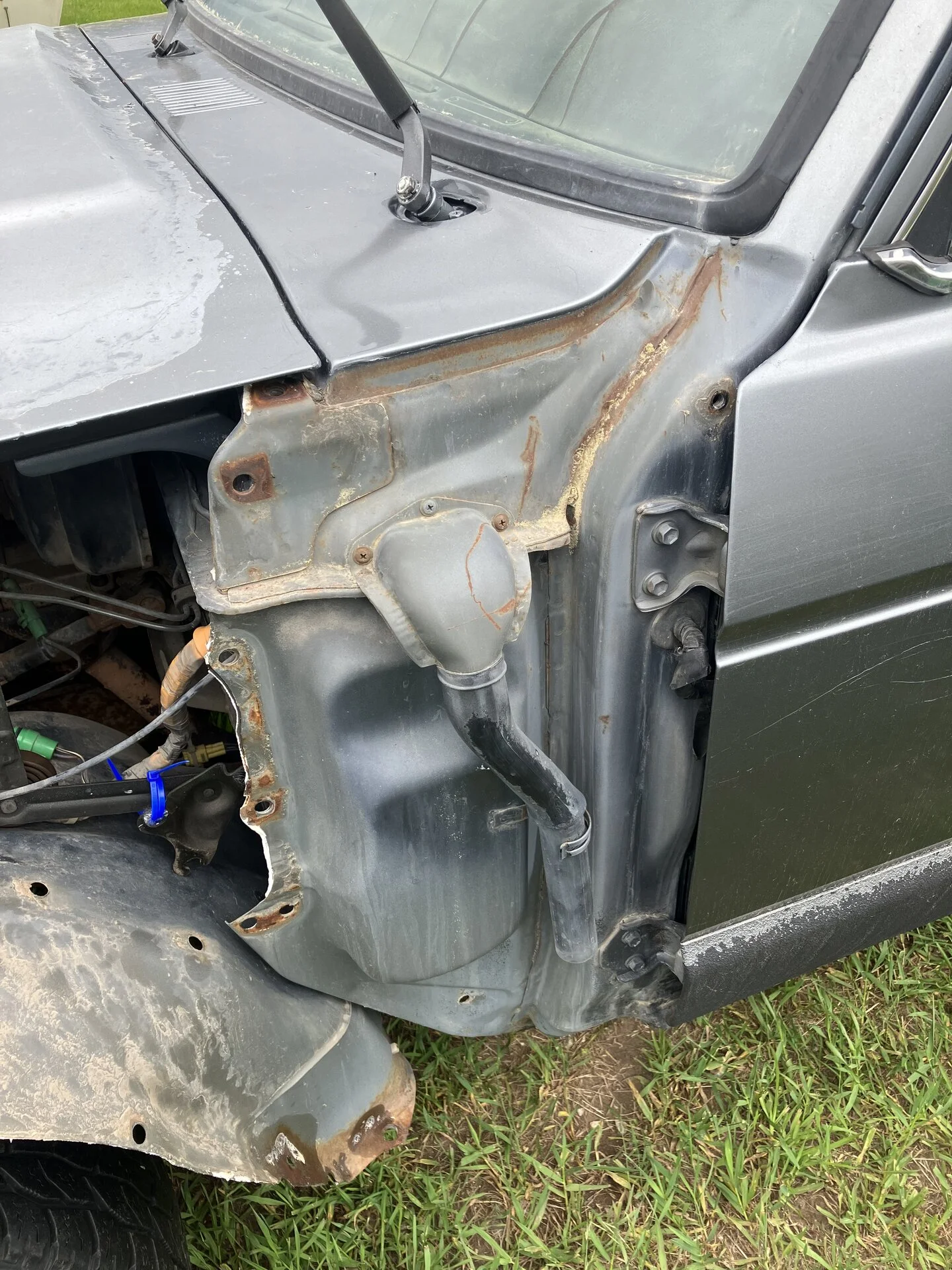

There is that drain pipe inside the fender which clogs up with leaves (lower right in photo, I removed it when the photo was taken). But you have to take the fender off which requires removing about 734 screws and bolts. But I got mine clean, sealed as much as I could and we had a major storm last night with zero water coming in that side. There is a little bit on the other side but I think that's coming in the door trim.

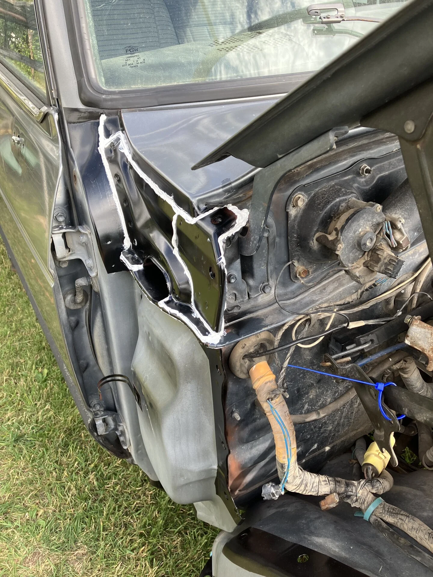

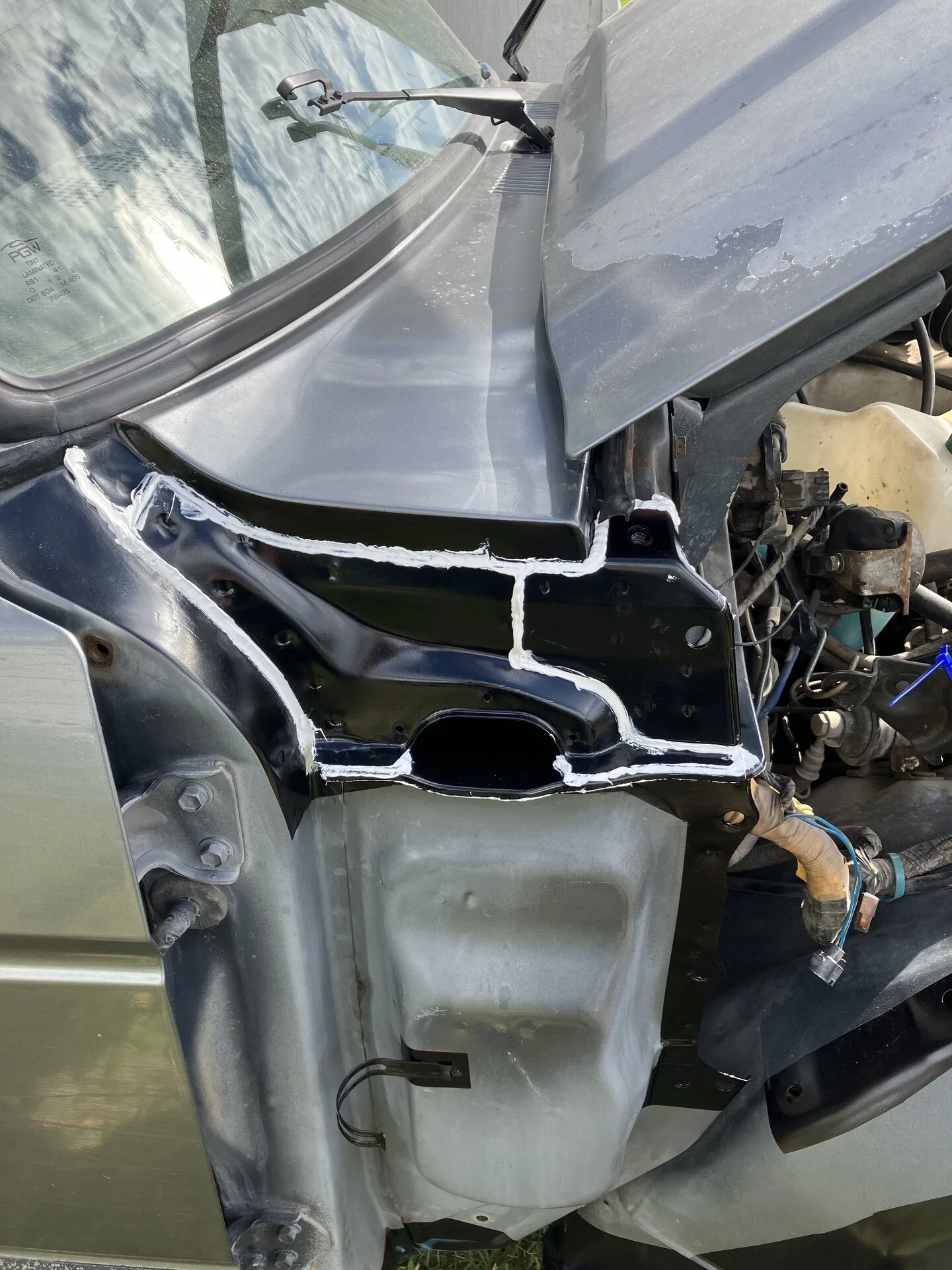

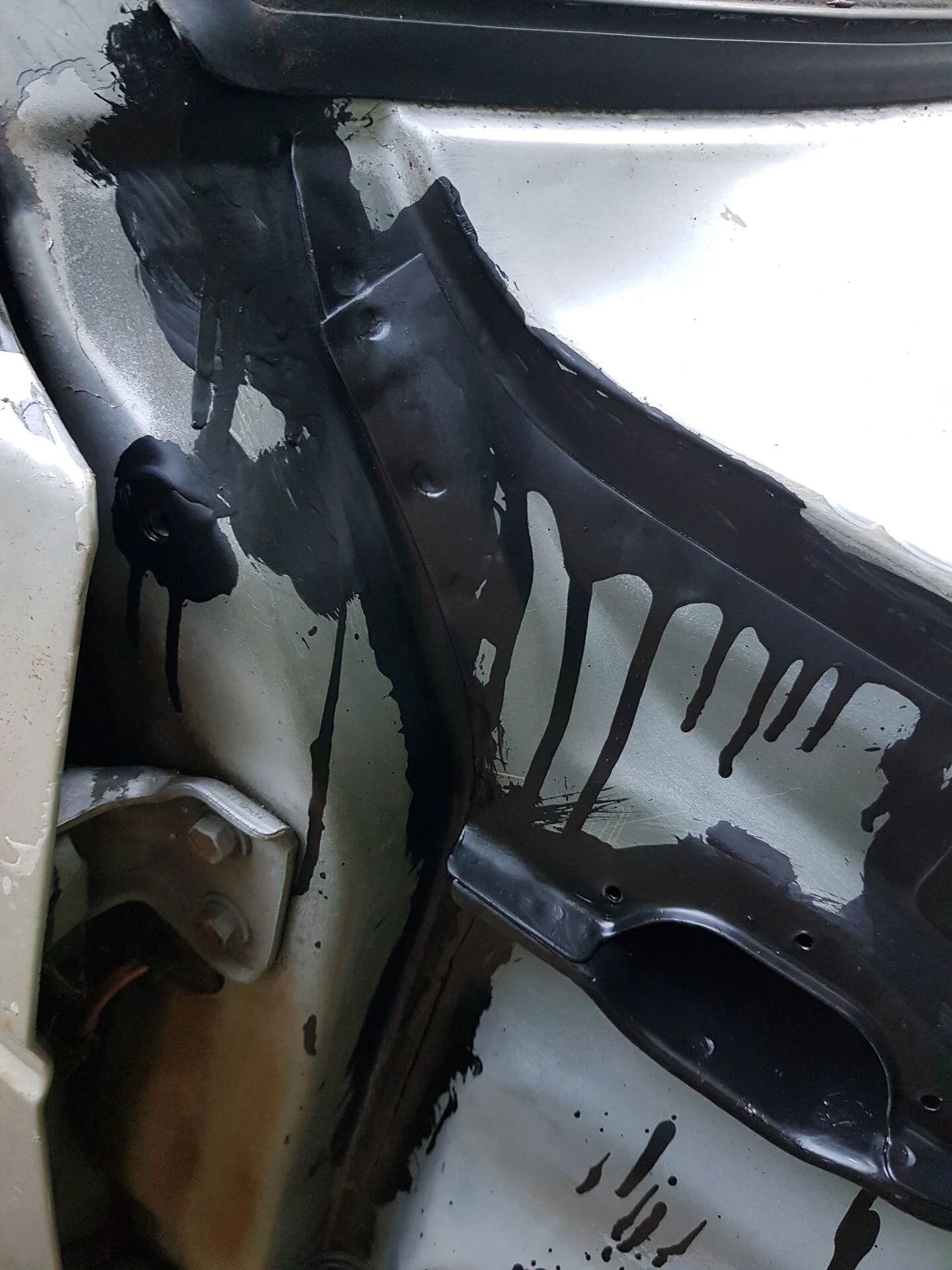

Here’s some photos - passenger side derusted and resealed
Driver’s side before reseal

Fyi...In your images you are missing the passenger side down drain and the plastic tube that attaches to it.

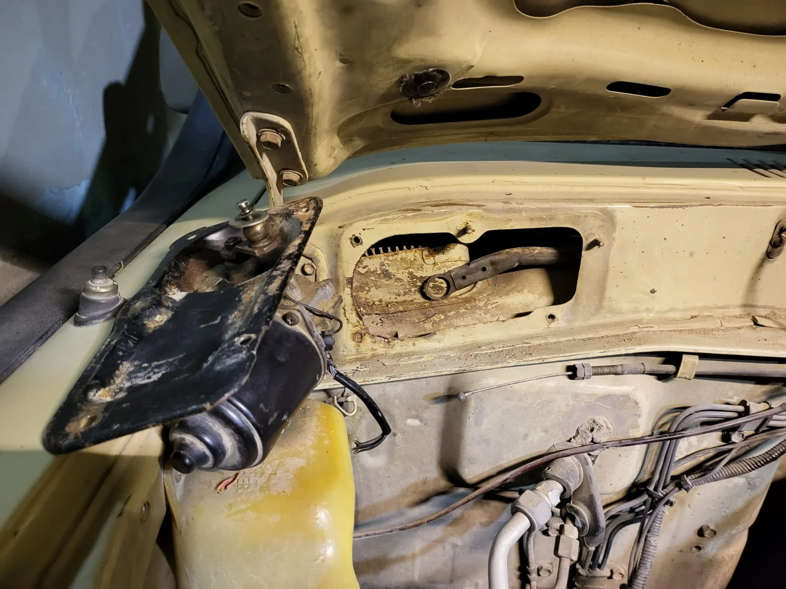

This photo, from another thread, shows what we are referring to. I have hesitated to remove the motor/plate as everyone that has says it is beyond challenging to reconnect the drive to the end of that black rod

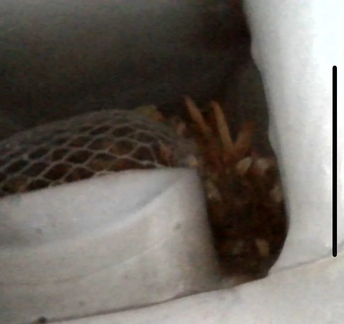

I found a cheap camera/scope with an ‘eye’ at the end of a 4’ stiff/flexible wire. Connects by WiFi to my phone. This is looking behind the ‘top hat’. To the right is the sheet metal that would be directly below lower edge of windshield. Top is underside of cowl. This is after 30+ minutes of alternating vacuuming and blowing with a 1.5” shop vac hose Inserted thru firewall opening above rear of engine. Thinking of trying my backpack blower, aimed thru the same hole…
