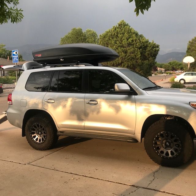

Here is my rig with Fuel Vector D601 (9x18 +20) and 275/70/18 KO2s (33.2" x 11") w 2" lift. My tires are 1/2" narrower but .7" taller than the ones you are considering. I put mine on before the lift because I wanted to work out any rubbing. They fit fine after I removed the front mudflaps and pushed the front edge of the fender liner forward about 1.5". With those 2 mods, I get absolutely no rubbing with or without the lift. I am now running an aftermarket UCA, which also repositions the tire in the well. Honestly, if I were to do it again, I would run the 2" lift w 34s (305/65/18). However, this would likely require some additional tweaking.
Thank you so much! This is what I imagined how my ride would look like with those wheels :). With 2inch lift and SPC UCA what else do you think would I need to fit 305/65 tires on there? I love the 305 look and have seen members on here run it with method NV wheels which is 5mm offset less than the Fuel wheels.
