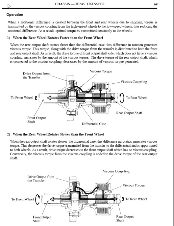

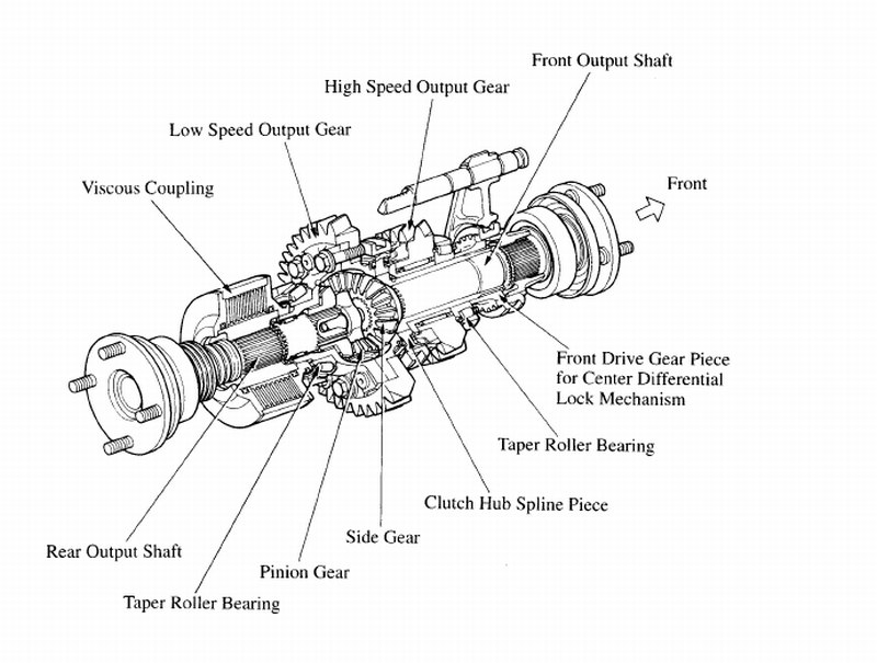

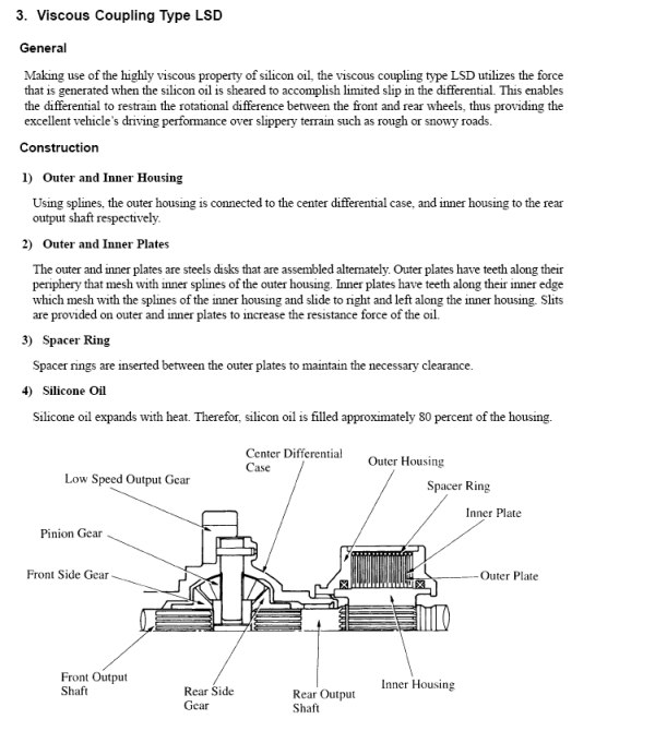

View attachment 3448434View attachment 3448435View attachment 3448436You may have only noticed it when it was locked, but the problem was there the whole time. You may as well have had 30” tires on the front and 35” tires on the back.
Any suggestions on how to proceed with addressing this after I regear the rear dif??
Is there a way to test if I’ve shot my viscous coupler? Or if my transfer case is toast?
Not sure how to Troubleshoot this especially if it seems to still be running fine.
This is something I’ve never seen before. What was the PO thinking about when regearing one axle only??? We may never know, but it’s going to bother me forever.
I’m glad you figured out the issue. Keep us updated on the progress.
Was there a VC in a 94 or did they start in 95?
My understanding is that disc braked, ABS equipped models have VCs. His pic shows stock aluminum wheels, so I assumed his had it, but something to confirm. I also thought 3x locked came on the FF/disc/ABS only but that may not be the case.
I’m not aware of an easy way to tell. I’d search around - I’m sure someone smarter than me has posted a way to test function. If it’s running fine then I guess up to you if you want to deal with it or not. It can be replaced separately but still expensive. I’m sure there’s many that don’t work well (or at all) anymore and it goes unnoticed. Unless you’re in icy/wet/low traction conditions regularly you probably won’t notice a difference. It’s like driving with an open diff versus a limited slip diff. You still have the option to lock it like a “normal” transfer case.
More importantly, I think I would pay a shop that’s familiar with 80’s to go through it in depth. This is a pretty egregious error on the PO’s part. I would be seriously concerned about other “upgrades” hiding in the truck.
