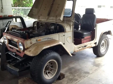

I know how you guys like pics so here you go......
