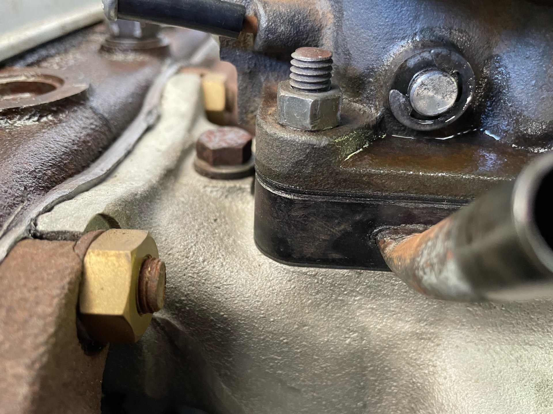

My main issue is the gas leaking from the shaft at carb base.
Idles well at 600 rpm, 18 inches of vacuum. Timing is advanced, I think, BB is below the window, seems happiest there. I think I read another thread where someone suggested grease on the shaft, but wouldn't the gasoline thin through that?
The throttle shaft joint is not very tight, so a little vacuum leak or gas leak is not unusual.
That said, you should not have gasoline dropping on the throttle butterfly at idle. At normal idle, the gasoline should be going through the idle circuit and entering below the throttle butterfly. Three things to look at. 1. When you adjust the idle mixture screw, does that affect the idle? If not, your idle circuit is not doing its job. 2. If you disconnect the idle solenoid wire, does the engine stop? It should. 3. If you look down the throat of the carb at idle, is there gas dripping on the throttle butterfly?
1. Idle mix screw will affect only if its almost all the way in, around 1.5 to 0. Right now set at 2 turns out.
2. Solenoid is working. Disconnect black wire, engine dies.
3. No gas at idle, that pic was taken after adjusting my throttle cable, working the pump to get that little barrel end into the linkage. I noticed a vacuum leak there prior, and carb cleaner after spraying into idle solenoid circuit.
If that's acceptable, I will carry on, booster leak and suspension are next. Thanks edwjmcgrath!

There isn’t supposed to be any liquid gas at the primary throttle plate to leak out. The reason that there is a “leak” may be because of a manifold vacuum leak or primary fuel circuit clog so you had to adjust the idle speed screw to draw fuel out of the main nozzle at idle. Take the air cleaner off and look for fuel dribbling out of the nozzle at idle. If so, this is Evidence of an idle fuel problem.
There was a leak at the gasket just above the nozzle. No fuel from the nozzle, jet, spray or otherwise. Clogged. Instead the fuel would dribble/gush from the gasket where the two plates meet. Took apart the carb (thanks to your YouTube vids, which are awesome btw!) dipped, cleaned, blew, reassembled with new gaskets. Runs really good, I will try taking off the Air cleaner and peeking down there, if it dribbles at idle i will remove the solenoid and try blowing air through.
No dribbling at idle and the leak at the throttle shaft seems to have disappeared, even if I work the throttle and flood the carb.
