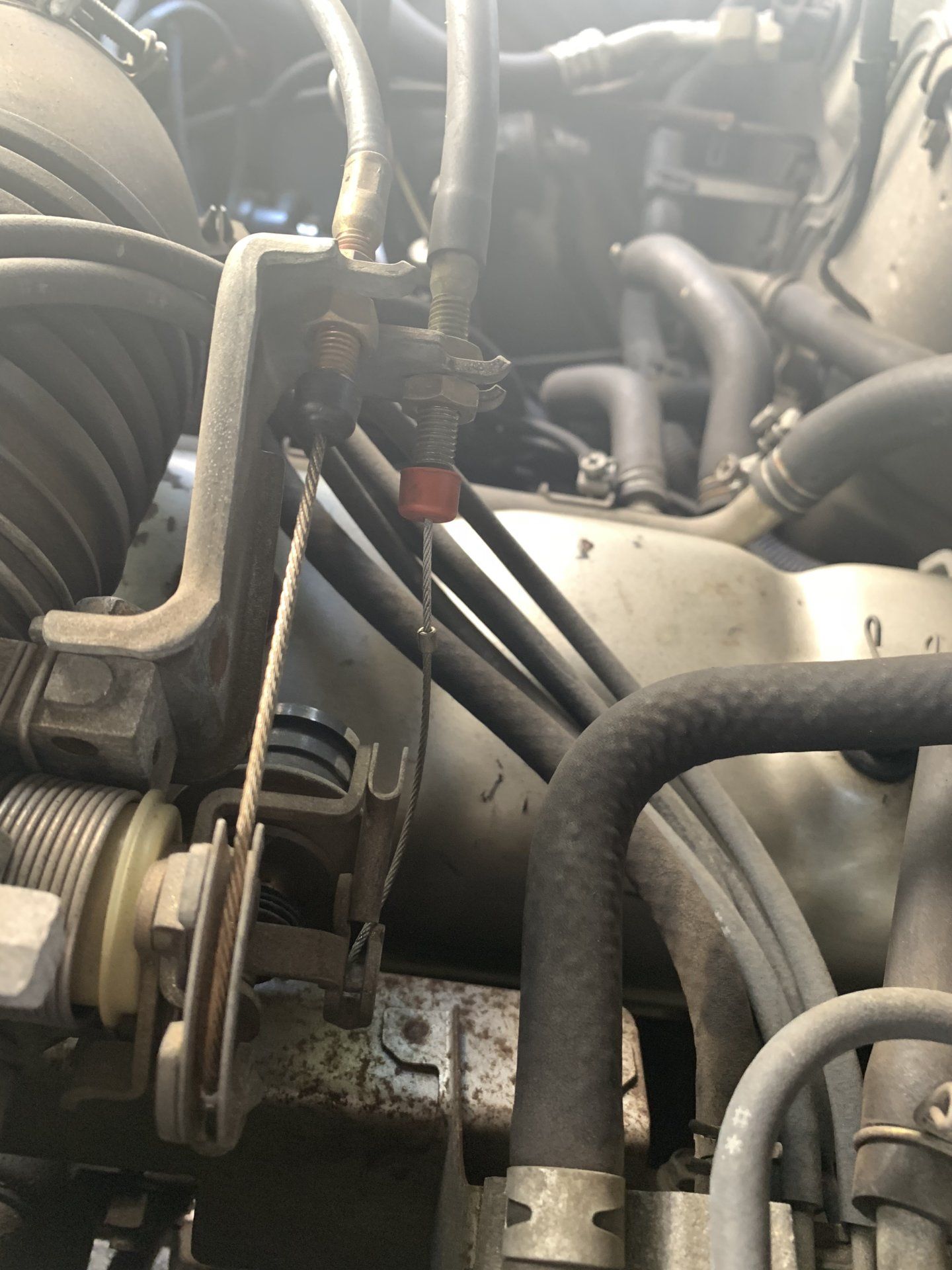

Thanks randy!! So I look under the hood and throttle cable looks good but the other cable going to the transmission is super lose. It the one with red end on it.
That's your kickdown cable. Something is amiss. Read up on the adjustment procedure.

In addition to cable being too loose as previously mentioned, next time you're driving up a steep grade just manually downshift out of drive into 3rd, or 2nd if need be.
The cable may be broken or stuck inside the sleeve somewhere. Mine was. Shifting was way off!
Replaced and adjusted cable, and BINGO! Back to normal, even crisper, shifting.
Your kickdown cable is way too loose, that's your red flag. Try adjusting or replace if needed.
