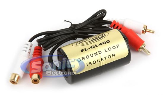

I installed the head unit in my 40 series, and ran into engine noise in the line. Haven't installed it in my 55 as I'm still tearing it apart, but I've got it figured out for when I do install it in my 55. I have the head unit installed as laguna80 described by mounting it from the back, and have it ran to a 2-channel 100 watt amplifier (listed below). I used a short RCA cable with a ground loop noise isolator (also listed below). The power wire to the amplifier and radio are hooked up to a condenser (like the one found on your stock distributor). I got two RCA marine speakers for the rear, 6.5".

Ground loop isolator:
http://cgi.ebay.com/NEW-Tsunami-FL-GL400-Ground-Loop-Noise-Isolator-Filter_W0QQitemZ360212711199QQcmdZViewItemQQptZLH_DefaultDomain_0?hash=item53de59c71f
