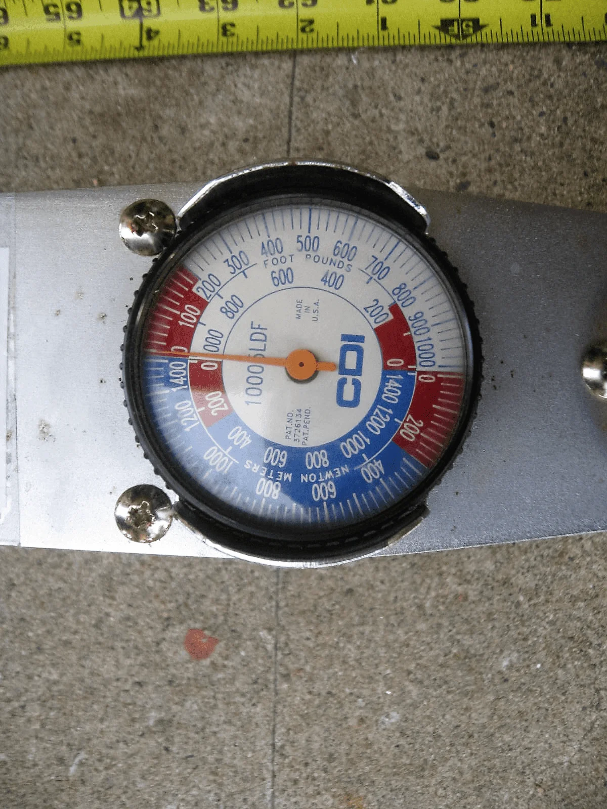

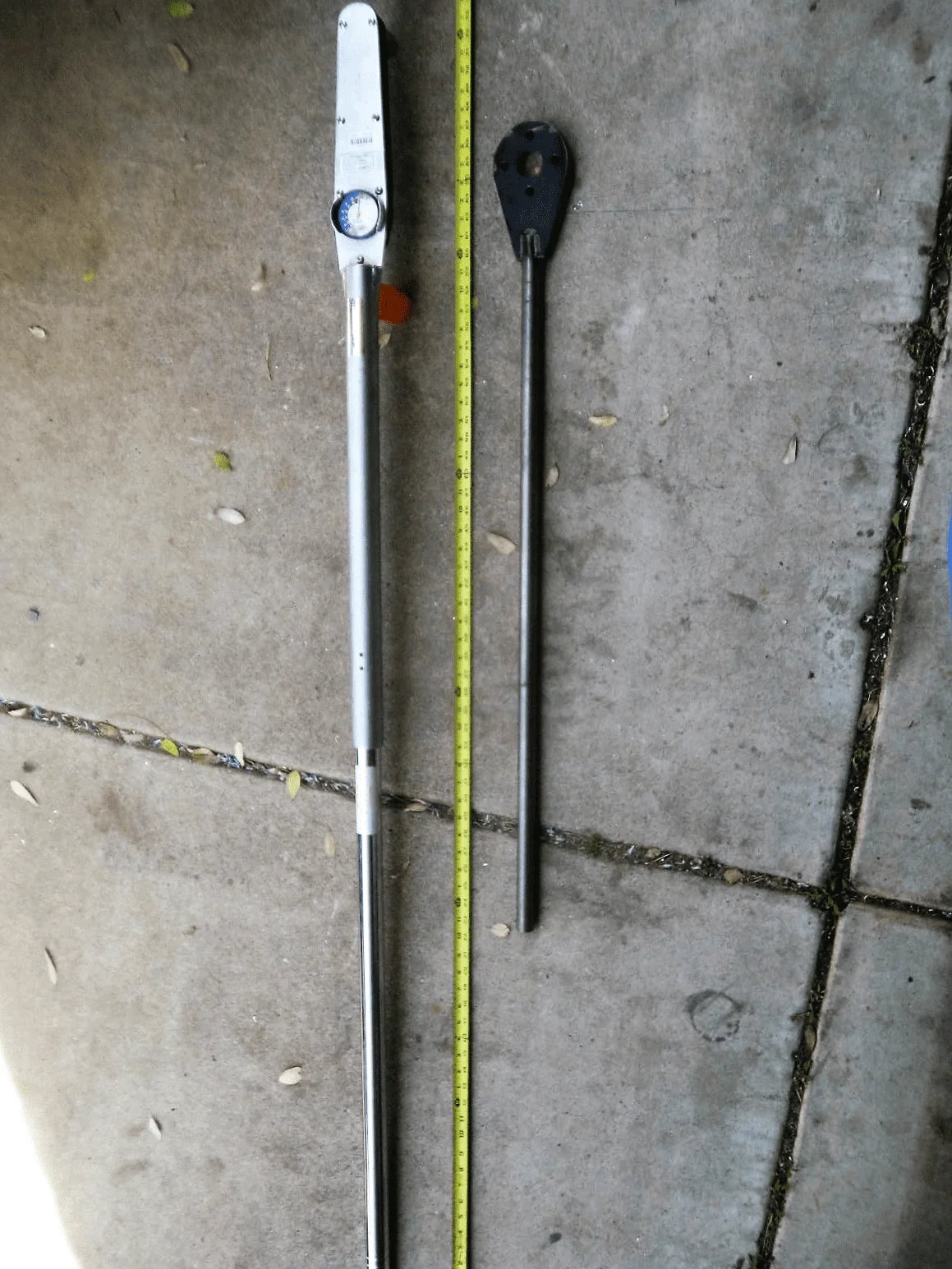

You guys need to stop screwing around with those kids toys, and step up to some man size tools, Ha Ha. Here are some photos of my 1 inch drive, 1000 foot pound torque wrench. So you can get an idea of it's size, next to it is a tape measure extended out over 6 feet.

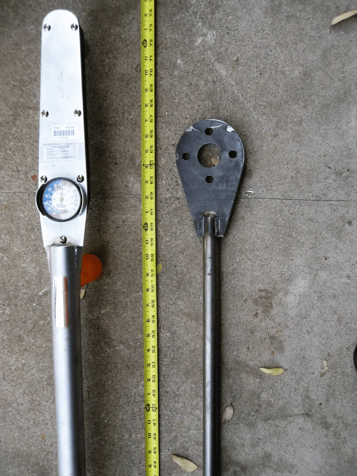

The thing next to the tape is an adapter i made to hold my Land Cruiser's crank pulley, It bolts to the pulley, then as you turn the pulley the adapters "arm" butts up against the frame, keeping the pulley from turning, you can use it to both remove, and install that pulley bolt to 304 foot pounds. The reason i made it, is because I'm not to crazy about using my starter to bust that crank bolt lose.

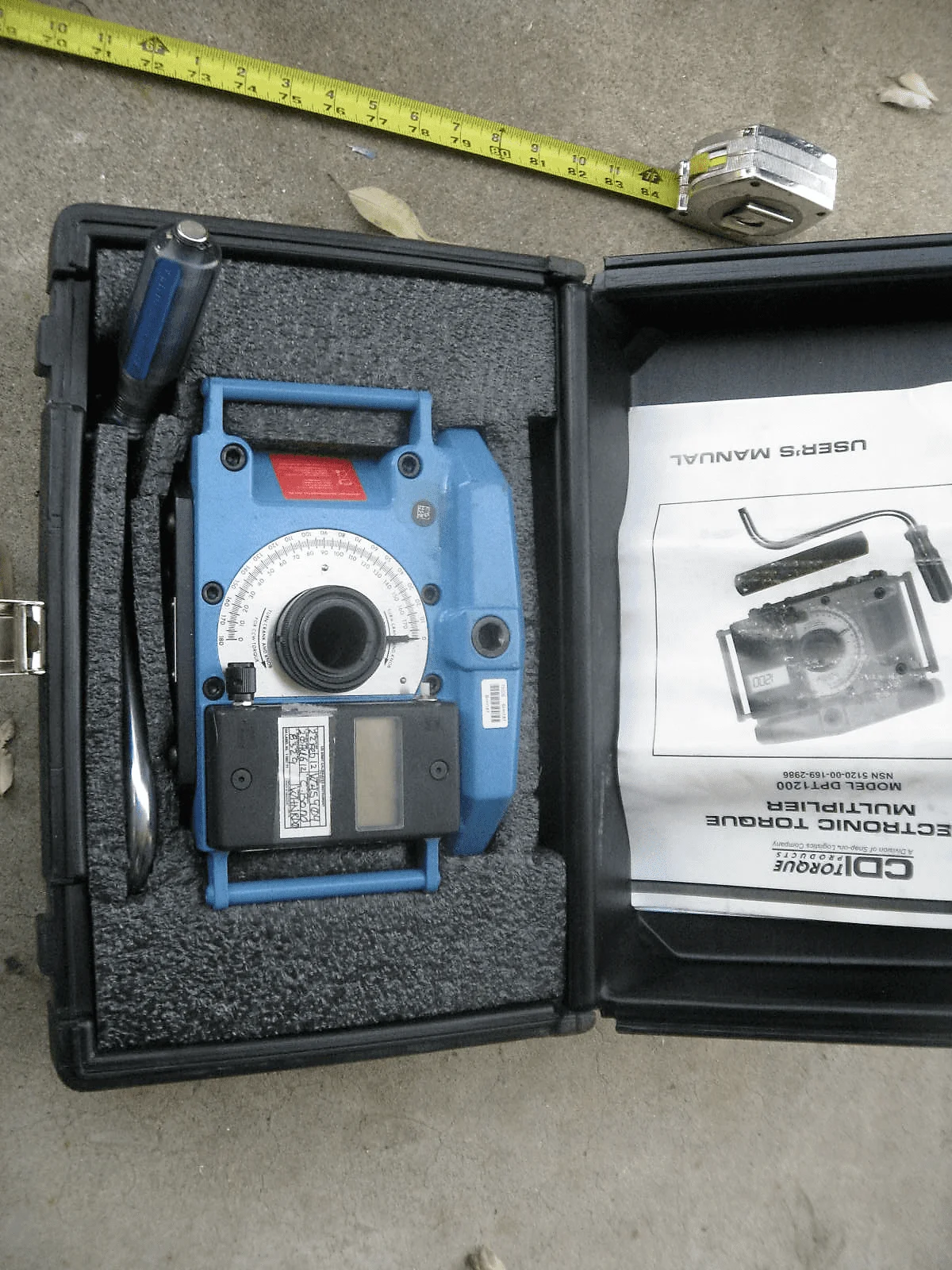

And last, for the really tight bolts, is my 1200 foot pound, 800 to 1 gear reducer, lets just say it makes short work of those stuck on bolts.
800 to 1!? Wow
