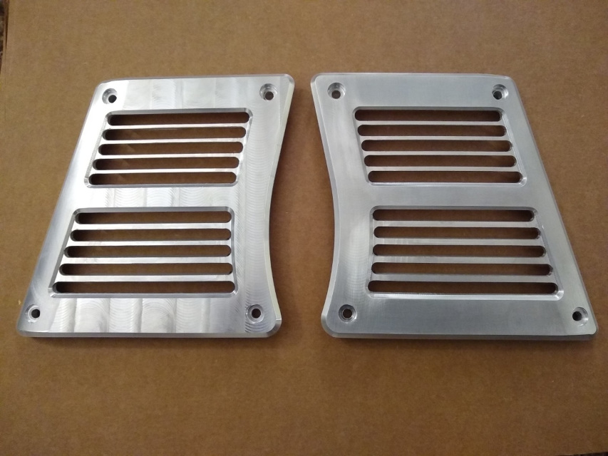

Splurged on the D pillar vents from Trail Tailor. Machined from 6160. They are a piece of art!
I have the idea to dump my exhaust from my diesel heater through them…. Something similar like the marine guys do, but was trying to make it more stealth without having to drill another hole in the pillar.
