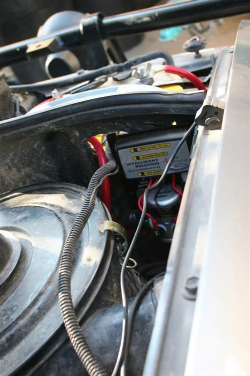

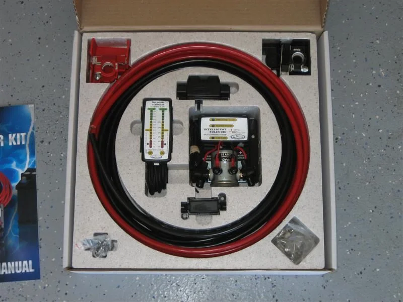

As part of my prep for my expedition I upgraded my dual battery set up. I went with the National Luna set up from Equipt Expedition Outfitters for 2 main reasons. Primarily for the monitoring ability of the battery level. Secondly because I was told that dumb people, ie me, could do the install no problem.
So I had used some off the shelf isolater from autozone or somewhere (fzjfillmore gave it to me) for about a year. I was never comfortable with the setup. Just didn't trust that I wouldn't show up and have 2 dead batteries. So after about 20mins gettng my truck back to a stock setup I installed the National Luna isolator.
The total install took about 45mins. i was out of heat shrink so i'll need to re-crimp all my connections and clean up the wiring just a bit but I wanted to get it finished before the long weekend. I chose an optima yellow top for my aux battery and still running a basic battery for my main. i'll be replacing it a couple weeks before I leave.

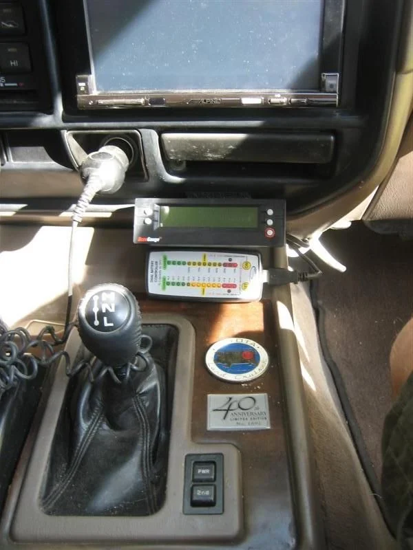

Intsall was very simple. all the connectors, wire, etc were in the kit. the most difficult part of the install was finding a place to mount the isolator. i bolted it to the back of the aux battery tray. i ran the cable under the upper radiator support. second most difficult was getting the cable for the monitor through the firewall. i had to cut a decent size hole in the grommit on the passenger side to get the cable through. the connector is similar to an rj45 connector which as i'm sure you can imagine doesn't pull as easy as plain wire. i've yet to permanently mount the monitor but you can see it in the pic. you can also see that i'm at 10% of my aux battery. my truck has only been driven about 4 miles since monday with the fridge set at 33 degrees. nice to see the optima can handle the drain okay.

Nice - I like the monitor.
Is the solonoid an automatic one or manual?

the solenoid is automatic. ben posted the price below. i know kurt from Cruiser Outfitters has installed a few piece meal into some customer rigs. it's a bit more expensive than some of other options but in my situation I wanted something simple, that worked and most importantly monitored the status of my system so any symptons could be indentified in advance. not a big deal to lose a battery in moab or cali but quite different if I lose one in honduras or venezuela. if i start to see dimished performance from my setup i can anticipate and make arrangements at the next major city.

I circled a part in your kit, what is it? I was looking through the owners manual on National Luna site and it does not show this piece...It looks to be a mount for the battery monitor, but I could be wrong..

It is the enclosure for the 100amp fusible link. the similar looking item at the bottom of the kit is the enclosure for the 50amp fusible link.

I love the National Luna. As I originally noted the simplicity of installation was a big bonus for me when it came to choosing a 'kit' for my dual battery set up. I only have had one issue and it turned out to be a positive thing. Somewhere in southern Argentina I noticed the indicator light on my second battery starting blinking, not a signal blink, but just random blinking in the green area of the indicator. So i was charging properly but something was inconsistent with the signal. first check was the isolator solenoid but all the connections were tight. then i check the terminals and they were fine. I looked to the primary battery and still everything was fine. Finally i realized my second battery had come loose in the tray. The inner mount bolt had torn a little bit and the bracket had come loose. I tightened down the two nuts on the end of the battery bracket bolt to snug the battery up and the blinking light went away. still not sure why the sensor was picking up inconsistent charge but obviously a bouncing battery on a washboard road would lead to some issues. I recommend the National Luna because of the simplicity and more importantly the monitor. my truck has been in a a container for over 3 weeks and I can't pick it up for another 15 days. i'll be curious to see if i have any juice left to start it.
