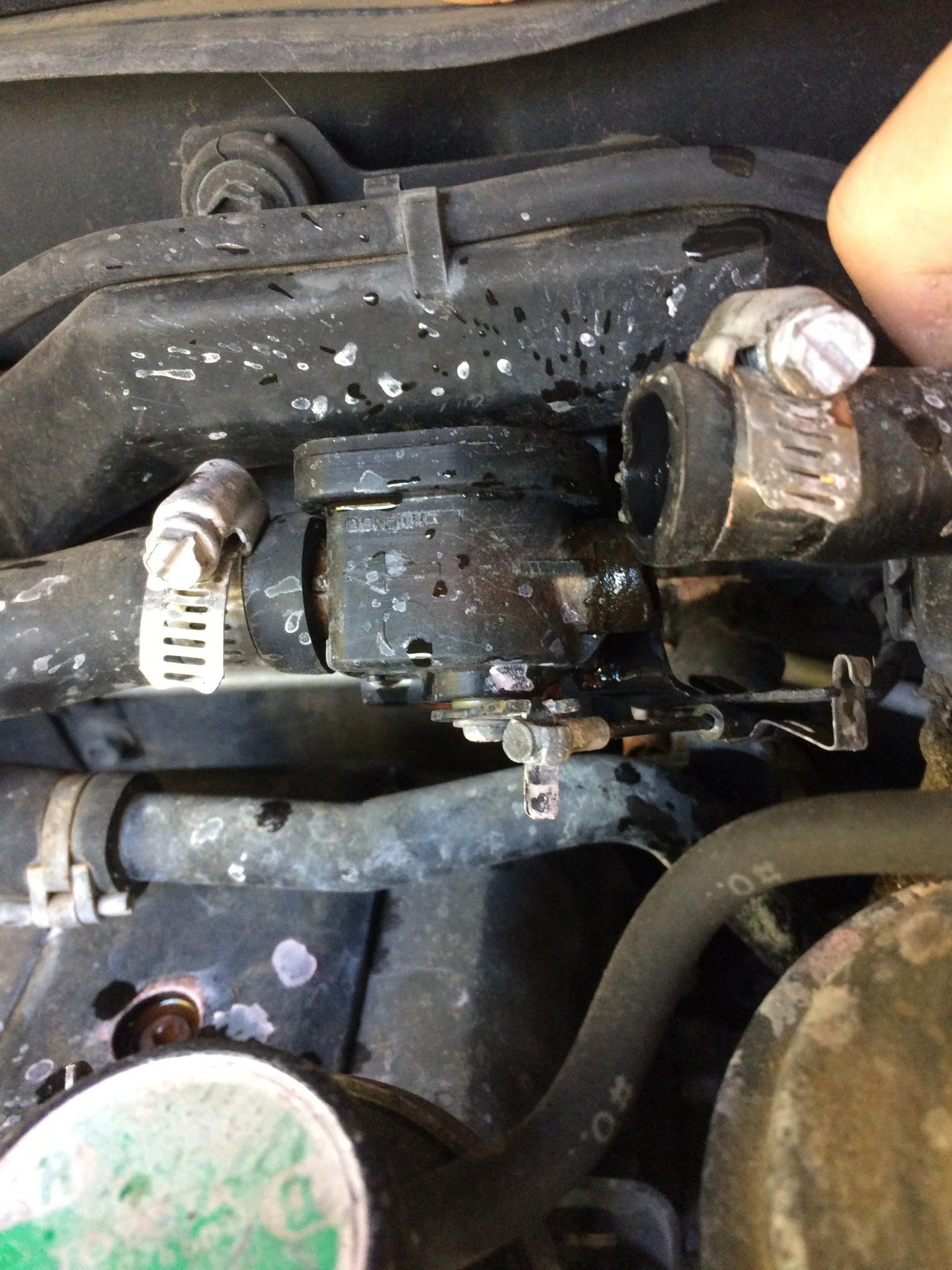

I have this piece that is broken off at the top of my engine bay. It's a part of what I believe to be a control valve for the cooling system. I can't find the part number or name of it. Any ideas?
That is the heater control valve. The inlet nipple broke off. Common problem on these older 80 series.

Wrong part number for his application.
87240-60170 is the correct part number.
I searched and saw that the 87240-60140 is for 91-94(?) and the 87240-60170 is for the 95-97, but can you tell me what the difference is? They look pretty similar from the outside, and I know the hoses are the same, but obviously there is a difference. I imagine they'd be interchangeable in an emergency?
