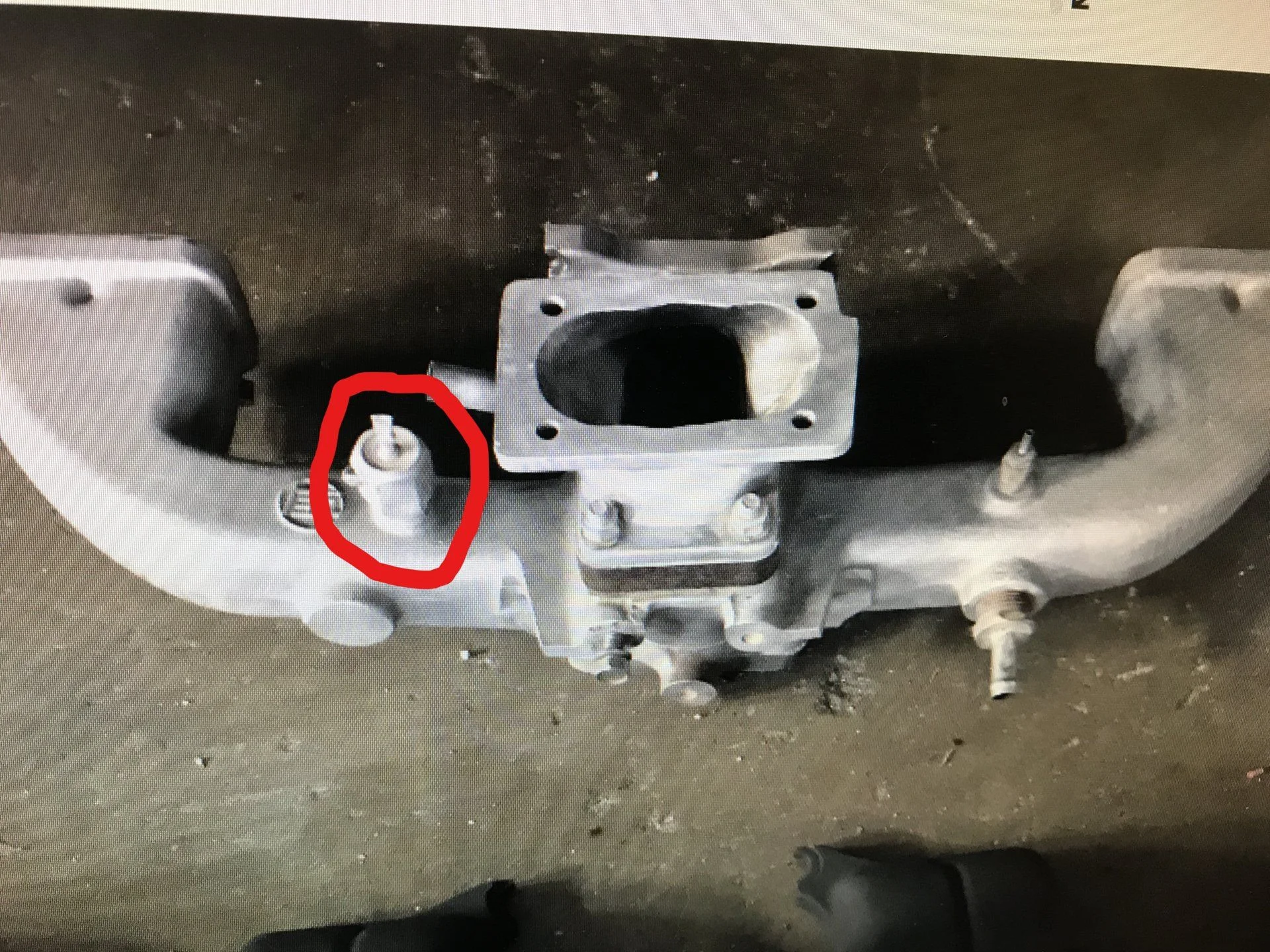

I am working on a 1972 FJ40 and found a vacuum switch on the intake manifold but have no clue as to what is does. Can anyone help identify this part? Also, if the Aisan carburetor is such a good choice for the FJ40s why are there so many that have been changed out? Why, back in the day, would anyone think a Rochester was a better option than the OEM Aisan?
Thanks MUD
If I recall that's where the "gas filter" goes. At least in later models. It's just a vacuum port to operate some of the carburetor/emissions functions. Depending on the year, there might have been one, two or three vacuum ports on it.
