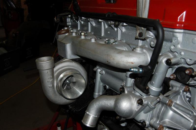

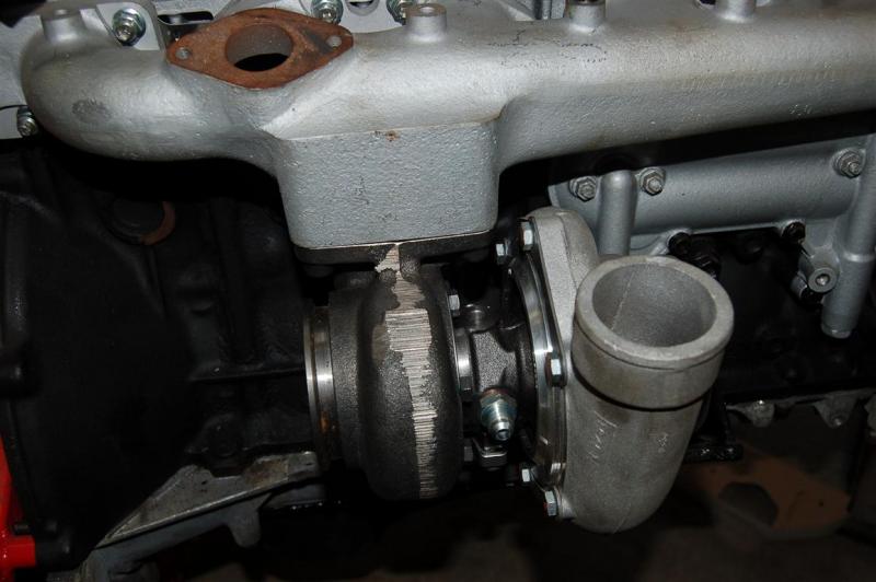

The engine is ready to be installed for the most part. All I need to do is order the lines and it's all done.
I decided that I wanted to use all stainless braided lines with AN fittings. You need to cut into the oil pressure line and water line.
On the water line I had a AN bung welded onto the supply neck and I welded a 1/4" NPTF saddle flange onto the heater return line.
For the oil line I used an 1/8" NPTM x 1/8" BPST adapter to thread into the oil cooler and a "T" fitting. From there I installed the pressure gauge and an -AN3 x 1/8" NPTM adapter.
The oil retun line is an -AN 10 bung welded onto the side of the upper oil pan.

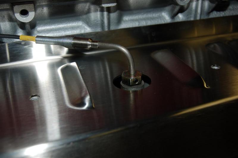

I also had a spot on the manifold to drill and tap for an EGT sensor. I drilled and tapped that to 1/8" NPTF for the sensor itself.
here are a few picks of the EGT sensor
That is sexy.
Keep an eye on that T adapter you are using for the oil feed. Those T adapters have a tendency to crack after a while with the vibration of the motor + the weight/pressure of the line/sensor connected to it. Sometimes they last a long time though, still a good idea to check it every once in a while.
I'm actually thinking about making my own adapter. I don't like how things are positioned with that thing. It's simple enough to do but like everything else it adds more time.
