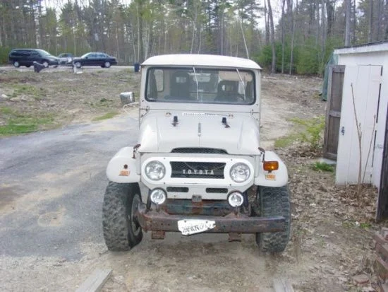

Well I have finally gotten off of my @$$ and moved enough stuff around to get the garage cleared enough to start putting this together. I bought it a few years ago with plans of putting it together for me, but now that my son is turning 15 I thought it would be a good time for him to learn some basics and possibly have the coolest ride in High School.
This was originally a California rig brought back to NH by a local guy. He actually bought it because it was a V-8 converted rig with a chevy 283 with the correct numbers for his vintage Vette. He pulled the motor (which ended up being junk anyway) and I bought what was left.

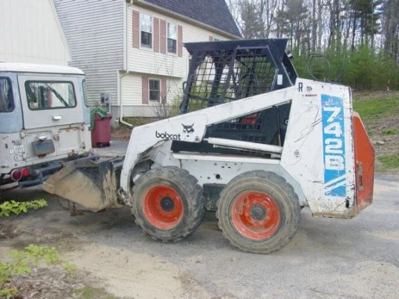

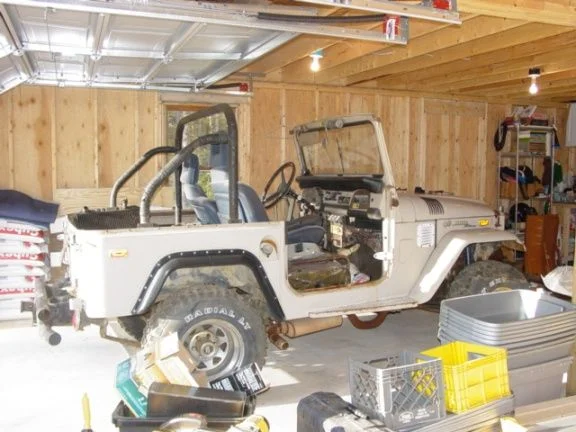

The first picture is it's current power source. The second one is the boat anchor of a rear bumper which is going to need to be cut off, and the last one is of it's current home in the garage with the top and doors off.
Next weekend I pick up the donor truck, an 88 Chevy 1/2 ton 4x4 with a 350 TBI. I will likely keep the TBI and harness but start out with a carb since he will not be doing much wheeling. Then when I have everything else all set, I can think about getting the TBI in.

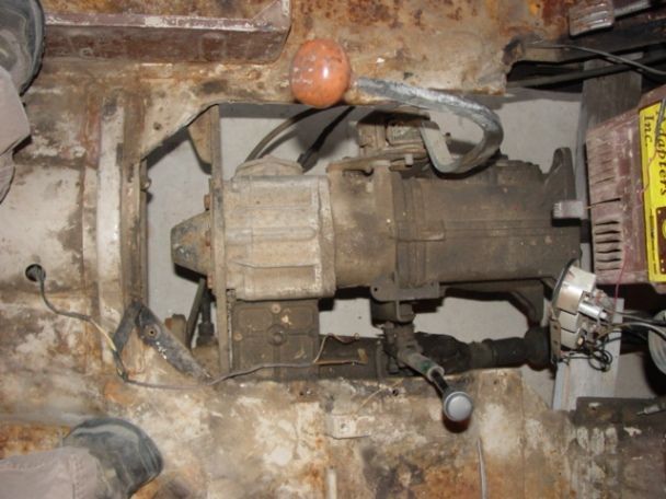

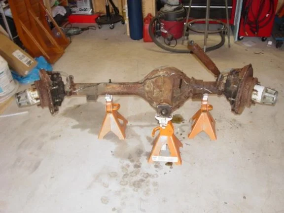

Some Mechanical aspects, The disc front end out of a 76 I parted out. The movement will be via a Muncie 4 speed tranny conversion done by the PO with an AA kit. All in all it looks nice and compact, but he was not gentle with the transmission cover. I will try and put the three pieces back together, but may need to shop for a new one. TIme will tell on that one.
Also tilted the windshield and the frame is amazingly clean.

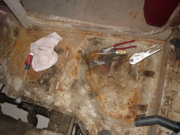

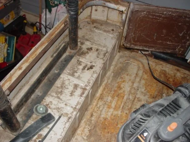

Last ones for now. Here are some floor shots after I pulled the seats and tank and did some vacuuming. Actually my son did the vacuuming for the most part, you've got to start learning somewhere and vacumming is as good as anything else...
Sooooooooo clean for a rig located in New England!:bounce: :bounce2: :bounce: :bounce2:

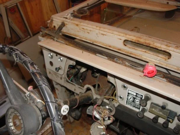

Well really made some headway on the tear down today. Had to drill out some stubborn screws that would just not break loose, so now I will need to buy a metric tap set to clean up some of the holes. Was able to get off the bib, the aprons, the fenders, the running boards and the windshield frame. Pulled all the marker lights and will have to order replacements for those as well. The harness is a mess, and I will likely buy an EZ harness off of ebay too. From what I have seen there will be to patches on the 1/4 panels in the rear, a small patch on the bib unless I can find an older style with the marker lights in it, and part of the drivers floor. Not sure why the PO cut it out as it appears it was all solid. I will need to go through the bolt thread to see what I should order for when I put this back together. Hopefully another good day like today and I can have the rest of the tub stripped of switches and heater box etc., get it off the frame and get it patched up and sand blasted.
Here is how it looks right now.

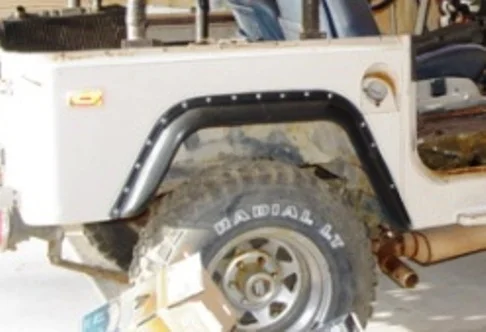

The PO really clearance the 1/4 panels which is fine since I will not be lifting it, but keeping it stock height since I am going to be putting a 16 year old in it!!

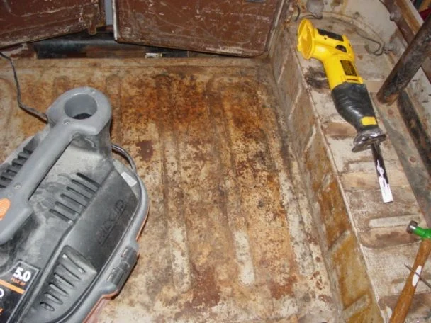

I found a suprise on the floor as well while stripping it down. The floor inside the underseat toolbox was cut out and patched. This will need to be fixed.
Does anyone recognize these flares? I would like to replace them with new but also want to keep this style since I beliefe he used them as a template to clearance the 1/4's.

If I can replace them successfully, you can have them for the shipping cost. They are not in good shape what so ever and cracked pretty bad. Need to check SOR.
