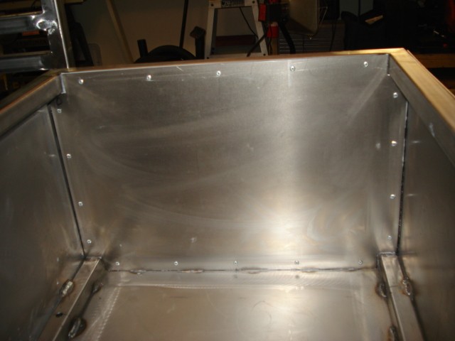

Here is a shot of the spot welds I made along the edge of the steel. Then I burned them in in the order mentioned above, but I thought the HAF looked cool on the outside, I think it penetrated well. :D
One last shot of the inside of the little "coffin."

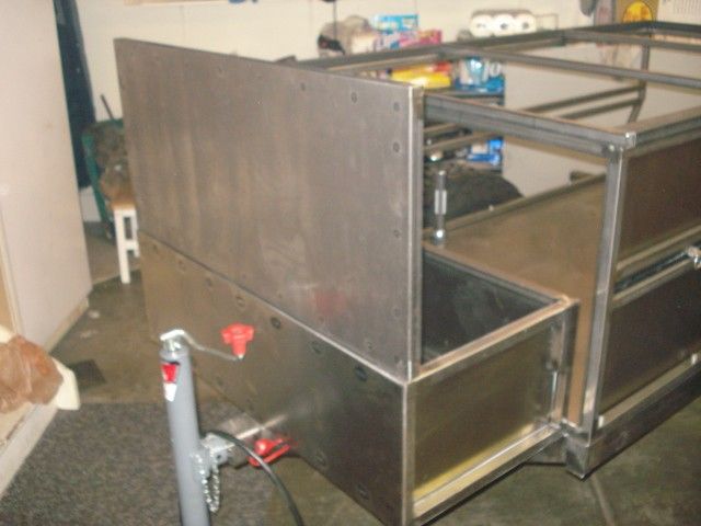

Next up... riveting the side panels in place.
First off I fit up the panel and made sure all my rivets were going to all line up... they didn't. After a quick clean up on a few holes they all dropped in. Then I used a bead of Sikaflex and spread it around the face of the tubing with a disposable puddy knife.
There are no pics of the process because once the adhesive goes down I had to be in full speed mode. I was surprised at how nice it came out. I cleaned up any squeeze out with a little acetone and it came together really strong and nice. Very happy :D

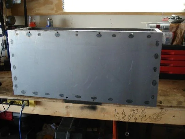

Today I started to make the lid and rack for the front box. I welded up another stick of my 1x1" 16ga square tubing, but I used the sheet metal as a template. Today was fun because I realized I am thinking steps way down the road, and I am saving myself lots of time!
After about 30 minutes, I had a rectangle... measured, cut, cleaned, prepared, tacked, squared, welded, ground smooth! :D
Then it was a matter of tacking the sheet metal into place. I used my measuring stick above and I flew through the welding. In fact, I was nervous I was going to start warping the metal as I was really able to move along quickly.
These shots show how this lid will lift from the front. Otherwise the rack would hit if lifted towards the rear.. that will make sense in a few more posts.

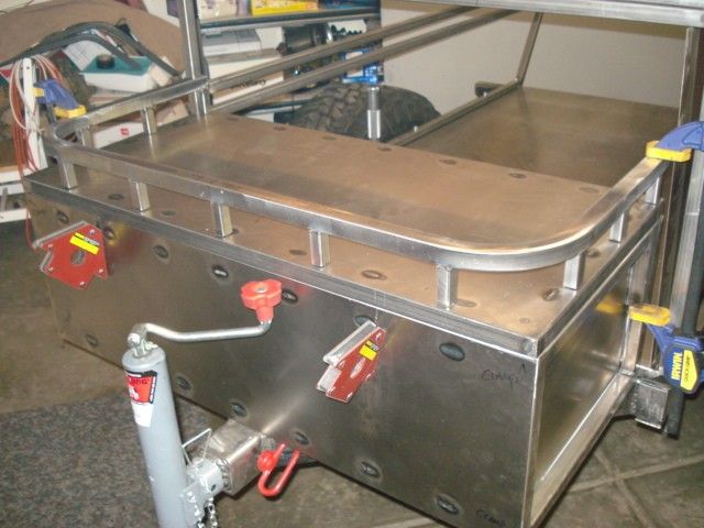

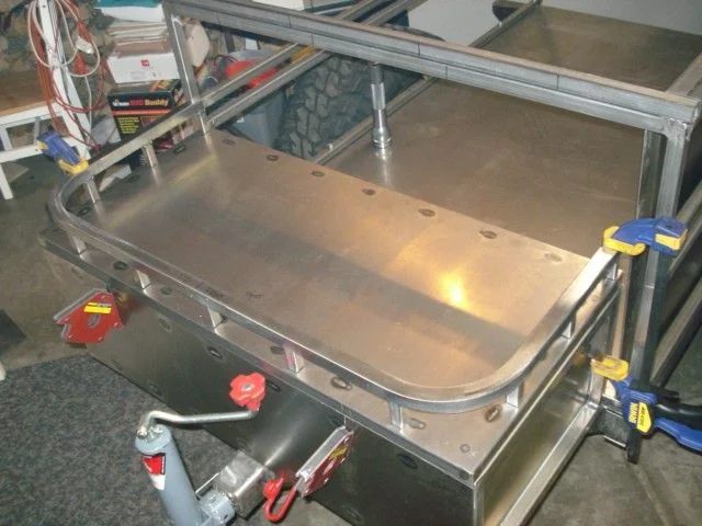

Next up, the rack for the front box.
I started by cleaning the surfaces with the cleaning wheel- Rapid Strip! :D
Then, to save time, I cleaned the tubing I was going to use .75" 16ga square tubing all at once, before cutting it so I didn't have to clean that later. That one little step must have saved me about 20 minutes of tedious work!
The last shot is of a very simple jig. If you have a need for lots of pieces to all be the exact same, here is a great little trick. It is a simple "stop." The idea is you clamp a stop (in this pic it is a piece of .25" plate) in the exact spot you want to cut the tubing at. Then you simply drop the saw down, move the piece, slide the tubing until it hits the stop and repeat... in my case 12 times! Simple, but it makes for fast work of lots of little pieces.
Then after filing all the little burrs off the steel ends, I measured about 100 times and got, what I feel, is the correct spacing and tacked them each in place. The time it took to get the little tubes in place, square in all directions and tacked took quite a while, but the end result looks really great!
I am still deciding how to attach the rack. My options are:
1. Weld them to the sheet (warping might be an issue though, that close to the edge). Paint could get tricky as well, as the lid and rack will be different colors.
2. Create a "bottom" by welding some 1" strap to the bases of the little rack spacer thingy (technical term :D) and bolting them through the lid.
3. Weld little "L"s onto the inside of several legs and bolt it down that way.
Whatta' ya thinks?
