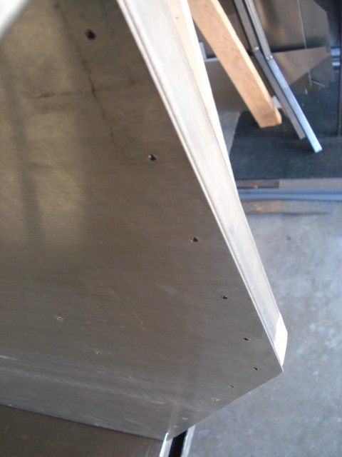

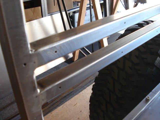

Well, I started out by tracing the tubing onto the sides so I knew where I was supposed to drill for the rivets...
Then it was time to measure out and drill the 78 holes PER SIDE! :eek:
After the holes were laid out in the sheet, I lined up the panel on the tubing, checked everything a few times then got after clamping it down and drilling all the holes in the tubing using the sides as a jig. Not too bad, but lots of fitting and grinding, and shimming to get everything just right!
Shim- I used a few pieces of scrap steel to shim the sides off the floor enough to leave a gap so I could go back in and weld the floor to the tubing as well.
Trim- I had a little fitting to do with the drivers side, I used a cut off wheel and a flap disk to get this edge to line up with the tubing. Not too hard but things like that really eat up the time.
Notch- I had to open up the 1" notches so I avoid grinding down all my interior welds. These weren't tricky you just have to stay in the right spot or you risk having a gap in your final sheet metal work.
Now it was time to get messy and apply the Sikaflex... good stuff so far. Great tack/hold and lots of working time, it is a super product.
I cleaned all the mating surfaces with the rapid strip wheel, both the sides and the tubing, this should allow the adhesive to do its job well.
At this point know where your rivets and gun are, have some acetone around to clean up any mess and you just gotta go for it. :D
I leaned the sheet into place then started to fit about every 3rd rivet moving all the way around the side, then I came back and started to pop the rivets. After the sheet was in place by itself I began to insert all the other bazillion rivets and make quick work of them. As I type my back is sore from leaning over and I now have super human forearm strength from all the pop rivet action today! :D
FWIW, I ran about a 3/16" bead then spread it around with a disposable puddy knife before sticking the sheet to it.
Sorry for the blurry pic, but it was the only one I took of the whole thing once the adhesive was on... no time to get artistic with the shot :hill:
And here is a shot of the panel in place after popping all 78 rivets by hand! :doh:
I cleaned all the seams with a bit of acetone and a few clean paper towels and I think it is ready for the next step, welding on the front panel and the floor.
