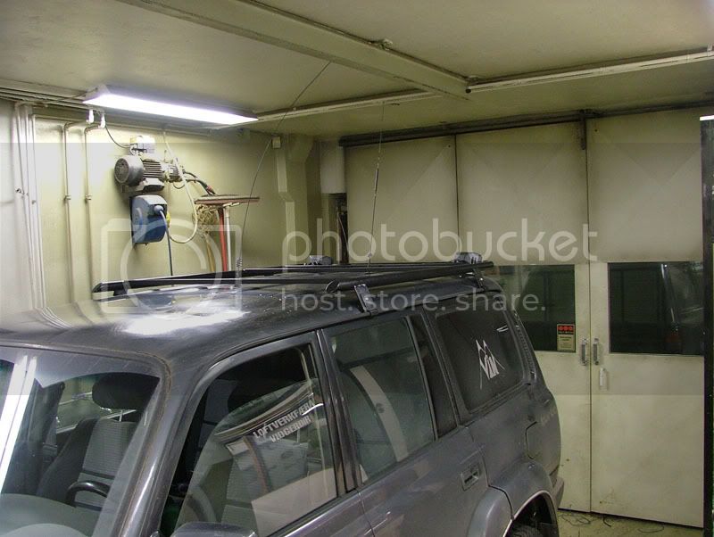

I got my roof rack from the powder coaters yesterday, put it on an wired the backup lights to night.

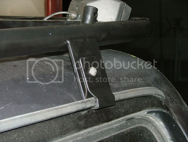

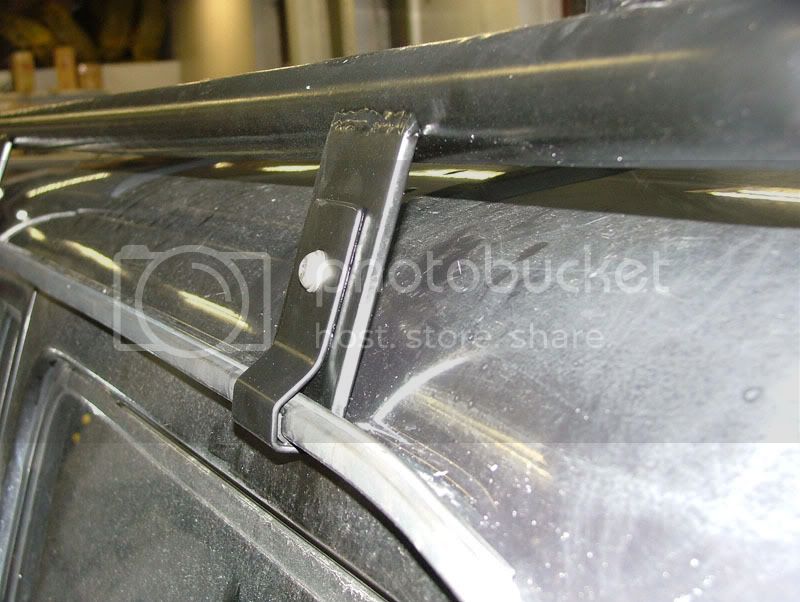

Someone asked for a close up pic of the gutter mounts I made me.
The backup lights work great

I like it! Nice work.

Nicley done...why can't manufacturers make a rack that is as flush to the roofline like yours....good job.
airlaird
Yeah...really nice fab work...how did you line up the mounts when you went to weld them on? Did you clamp them onto the gutter then place the pipes and weld while on the vehicle? You must have access to metal work equipment such has brakes etc.??
First I made the rack it self, then I used some wood blocks and placed them on the roof (the paint is bad anyway). Placed the rack on the wood blocks and made the gutter mounts. Welded them just enough to hold the in place. Removed the rack from the top and welded properly.
Yes I´m working in shop, where I have access to some tools ;)
