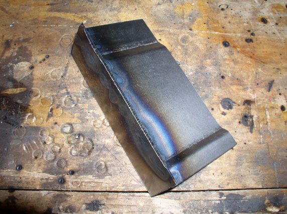

Door Rehab
Finally got the doors on after working diligently on them for the last few weeks. I'm quite happy with the results even tho I was skeptical initially that I could pull off the sheet metal repairs. I had fun during the process and took a lot of pics. Please note that my welding skills are terrible and all the repairs were done with a crappy wire feed welder. However, I think the low power of the unit actually helped.
Both doors had some damage from the PO's roll cage. He basically just mashed the doors into the front part of his ill fitting piece of crap cage. Fortnuately they were completely free of rust and otherwise very straight. The following photos show how I repaired them with some pretty basic tools.
Couple pics of the completed pieces welded on. Also, the door limiter pivot on the passenger side was broken off. The door limiters themselves were long gone. PO had bolted a short section of chain to each door to act as the limiter. That s*** had to go.
Stripped, skimmed my repairs lightly with filler and sanded. As before I used wax and grease remover and a tack cloth to get as dust free a finish as possible. Primed them and laid down some rattle-can. They are starting to look really good now.

Here's a few pics of the repaired areas and a door fully reassembled.
