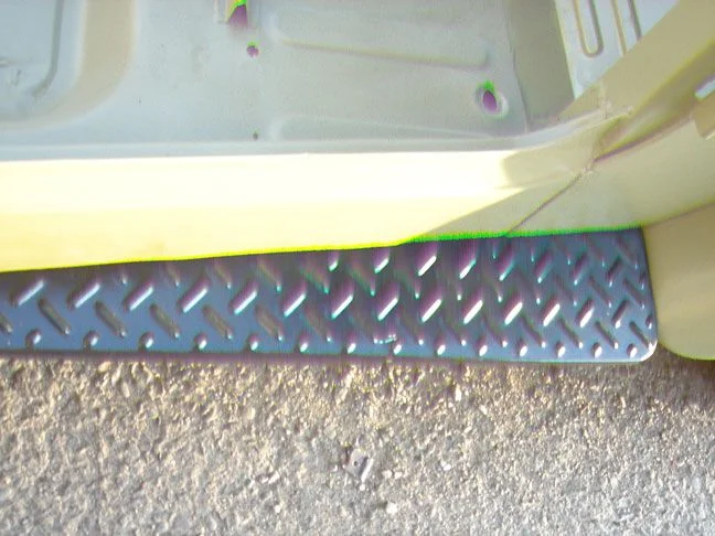

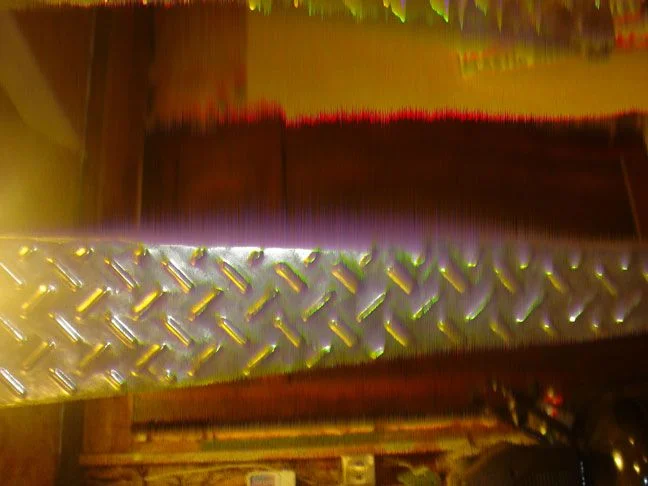

Ive got that POS diamond plate on the rears as well. Took of ONE side so far...Someone actually shoved a PEPSI CAN in the GLOB of bondo to use as backing reinforcement. What do people think!?!?!?!

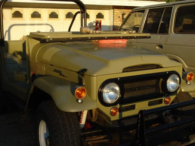

i a have a compressor sprayer and some auto paint let me know when you want to paint your rig i would have no problem helping you out ..... here is a couple of pics of my rigs i have painted

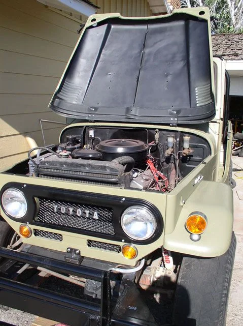

Hey guys, been a while since I've updated. Been out of town a little, running around a lot and there's never enough time for the cruiser (at least according to me, not my :princess:). I've been chipping away tho and thought I should share some pics. It's getting damn close now and I'm hoping to have it back on the road after this weekend.
Sorry for the photo quality of some of the pics...my camera has been dying slowly over the last several weeks and is now all but useless. I broke out the back-up camera today - hopefully the images come out :meh:.

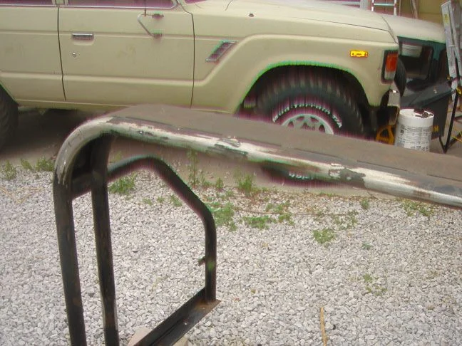

Following is a couple of that roll cage from earlier. It turns out the roll bar was a pretty decent aftermarket bar, I think made by Smittybilt? After cutting of the PO's lousy addition it looked pretty good so I cleaned it up and am keeping it until such time as I spring for a better one.

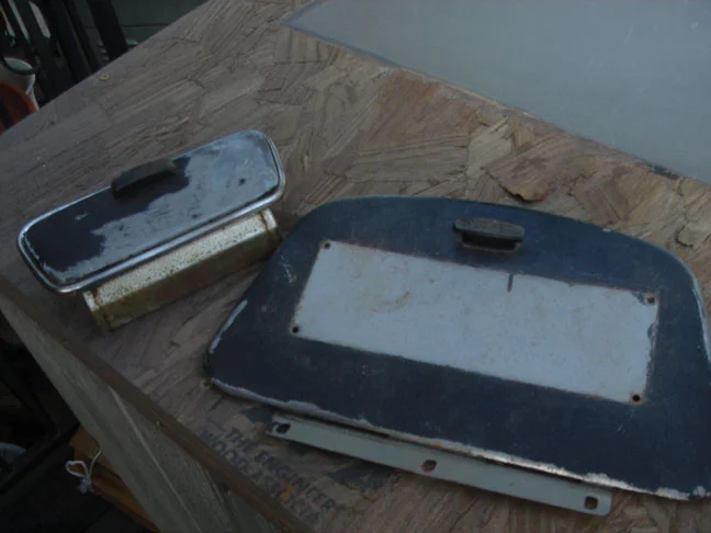

Also pulled some of the dash pieces, glove box door, ash tray, etc. Sand blasted them (not pictured) and awaiting paint. Thinking I might buy this paint from JTO to do them and a few other bits. And if you were wondering, I did paint the interior. Here's a blurry shot of the dash in primer.

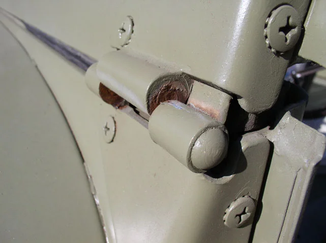

Also, my windshield hinge pin gave up the ghost when I folded it down. It was just too rusted in there to move. Searching for a solution - maybe just a new set of used hinges? New ones are ridiculously expensive. :meh:

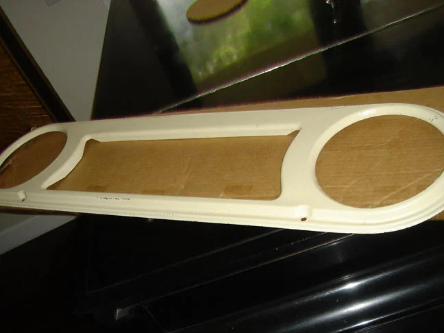

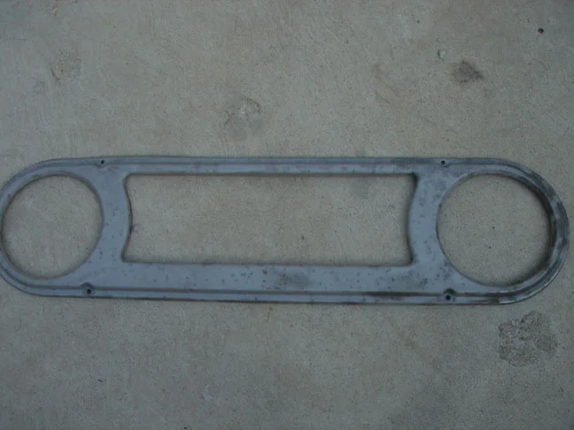

I was very happy the day my new (to me) bezel arrived in the mail, purchased from a fellow mudder. It had some rust pitting but otherwise a very solid unit. Wire wheeled, sand blasted, lightly skimmed with Bondo.
To get it on I had to remove the Warn winch. That was fun. The PO had a welder and he wasn't afraid to use it. The Warn works great but I'm going to leave it off for now. It will get a little refreshing in the next few months. Also, a new bumper will be coming soon but this one doesn't look too bad now that I've cleaned it up.
Anyway, check out the new bezel. I can tell you I was one proud cruiser owner the day I bolted that bad boy on. :):):)

FWIW, that roll bar is a Smitty-bilt, I have an identical one (minus the add-on) on my cruiser. It seems smaller that the average roll-bar that I'm seeing on most cruisers on this forum and I think it affects the fit of the rear seats.
I had the same ordeal with the broken hinges a few years ago. I spent an evening trying to heat them up and pound out the broken pin...
Don't let that route tempt you.

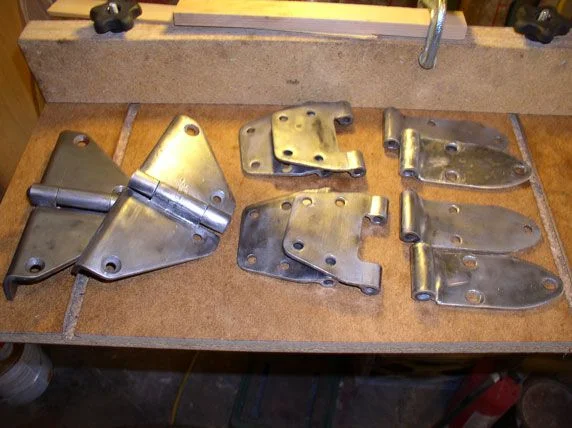

looks great Ed, wind hinges are not too expensive, check CCOT (cool cruisers of texas), they have a few options for windshield hinges that are aftermarket as well as SOR has a few options I think.
Noah

So, 35inch, are you saying don't attempt to beat the pins out? I did see that replacement door pins are available on the CCOT site and I believe these are identical size to the windshield. I found a thread by Coolerman where he drilled the old pins out on a drill press here. It does look like a lot of work.
Noah, unless I missed it, SOR wants $98 per hinge!...check here. They sell others that are fixed, i.e. no pivot, but I think that's kinda lame. I want to be able to fold my windshield down. I didn't see any at CCOT or MAF.

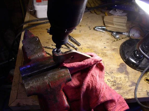

I am happy to say I fixed that window hinge. It was, however, a real pain in the a**. I burned thru half a dozen drill bits on my drill press and lots of cutting oil before trying a carbide cutter in my Dremel which finally did the trick. Once it got a hole all the way thru I was able to finish it off on the drill press. I found a replacement hinge pin and got it put back together. Sand blasted the lot of them and painted 'em up.

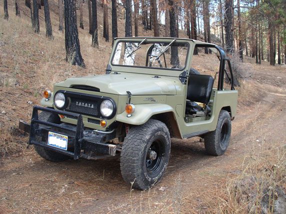

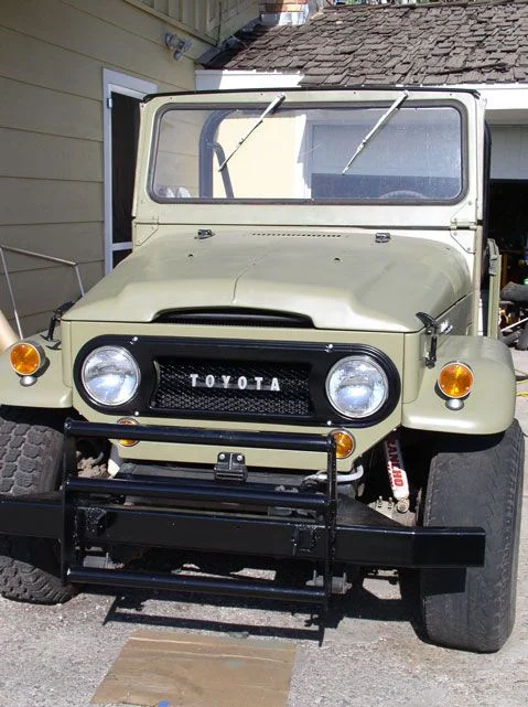

I scored a set of lightly used 33 x 9.5 x 15 tires off of Craigs List. I painted my old white rims black and mounted them up. They look good. Also got my spare tire carrier mounted up. I had my eye out for some used OEM rims but those are kind of hard to find but the search continues. The canvas bikini I sourced from Jim - OCDBeetle. It's very nice and was very reasonable.
So here's some pics that I took of her today. I absolutely love driving it whether it's on or off-road. It certainly gets a lot of looks. There's a number of things that I've done that I've forgotten to document and there's many other things that have yet to happen. For example, if you're like me you're thinking it would look even better with a 2.5" OME lift on it, right? I also need to do some tuning on the TBI system. It runs great, but could run a lot better. I'll be picking up the hardware to burn my own chips soon. Oh, and I gotta get the hard top and doors on hopefully before it snows.
