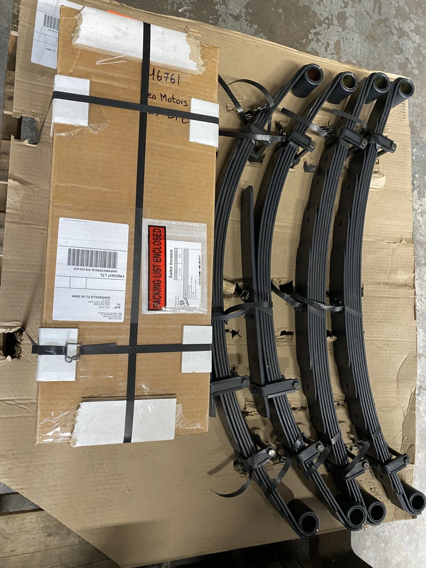

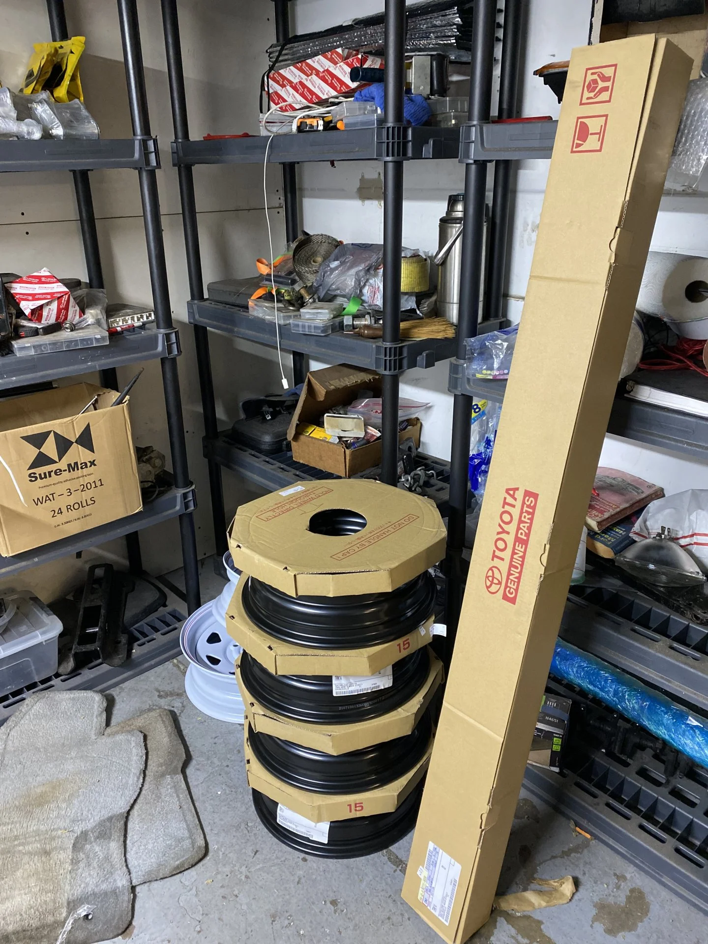

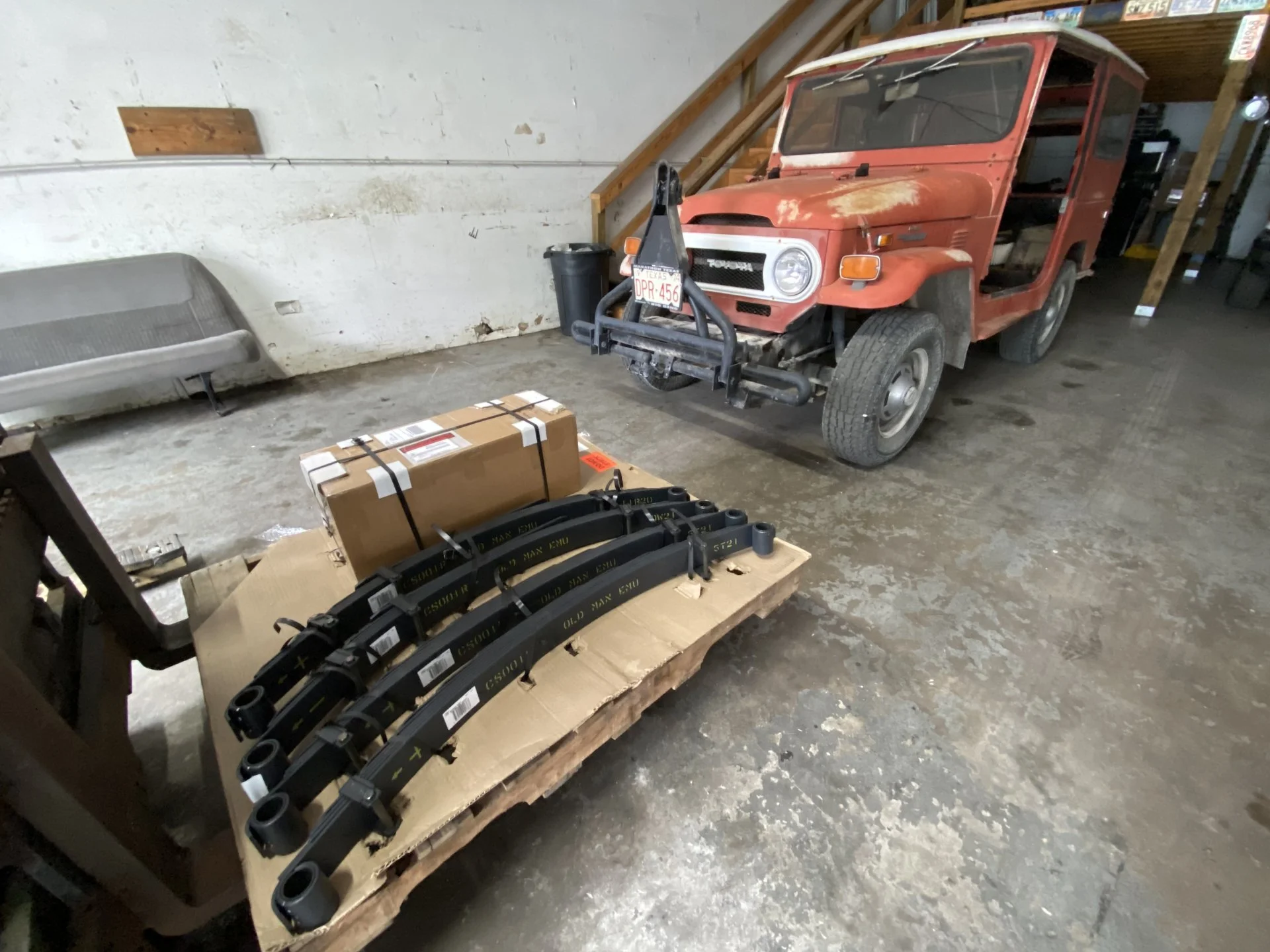

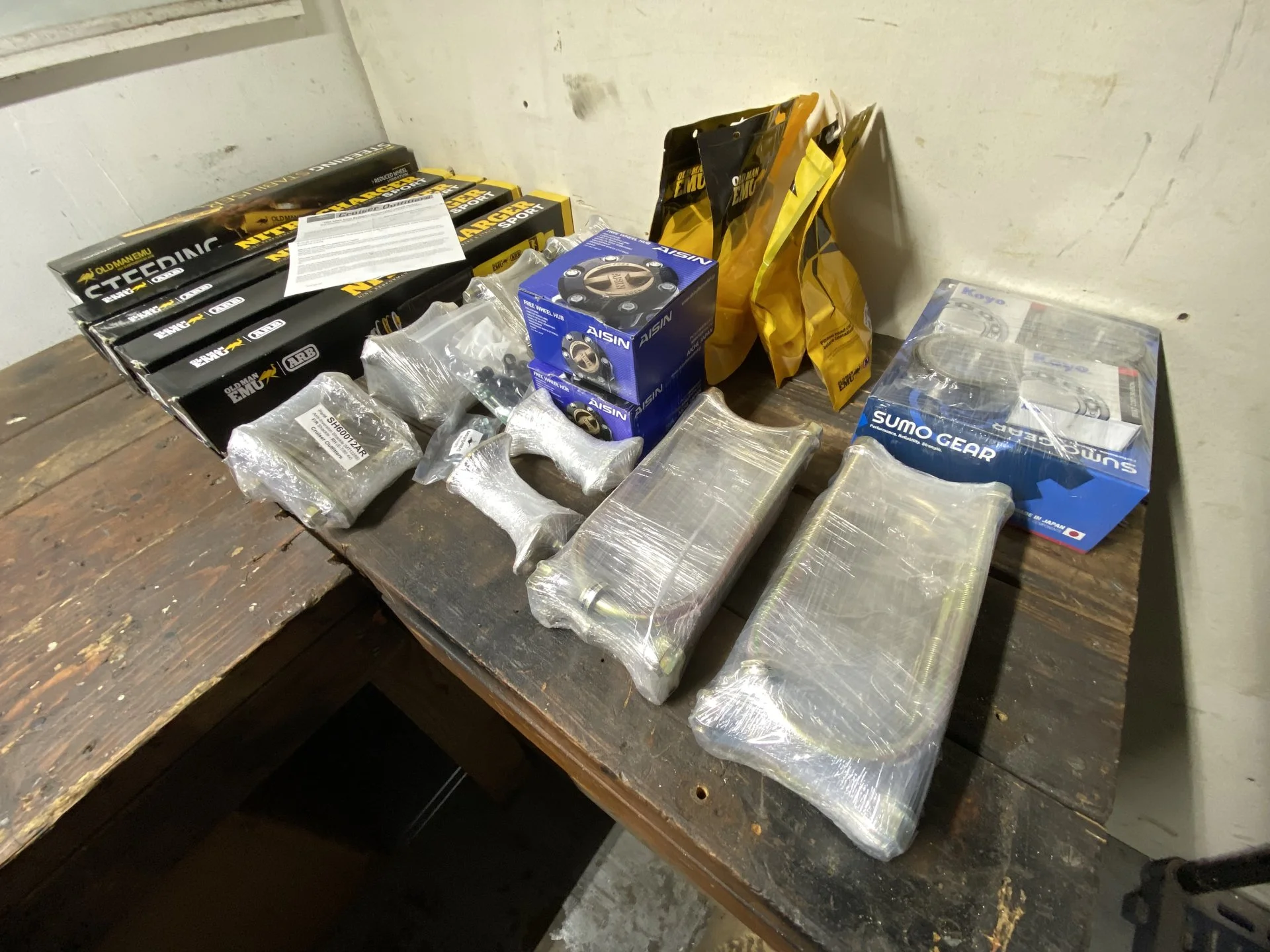

Expertly pack’d and shipped. Exactly what you’d expect from @cruiseroutfitters.
Thanks Guys!

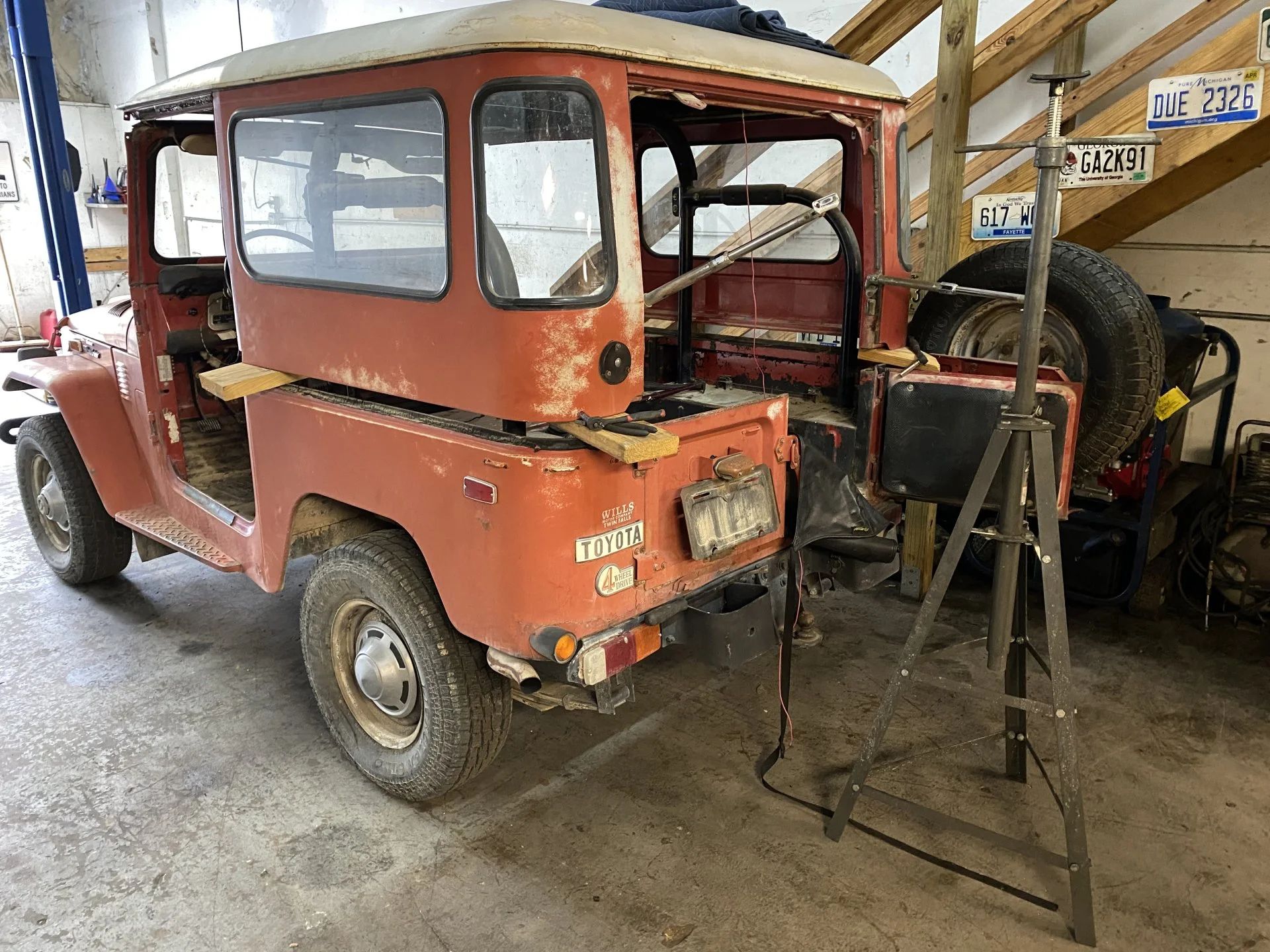

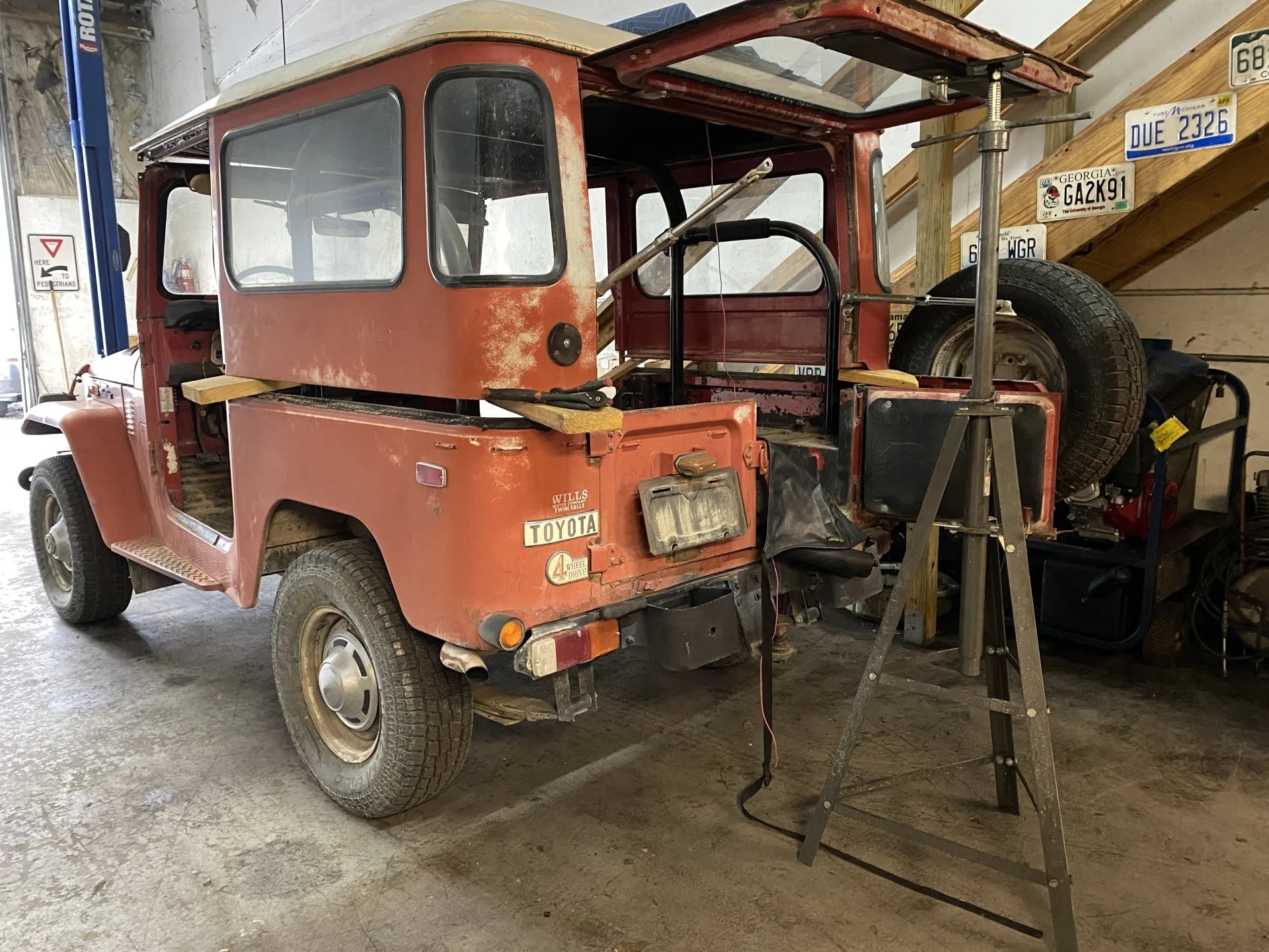

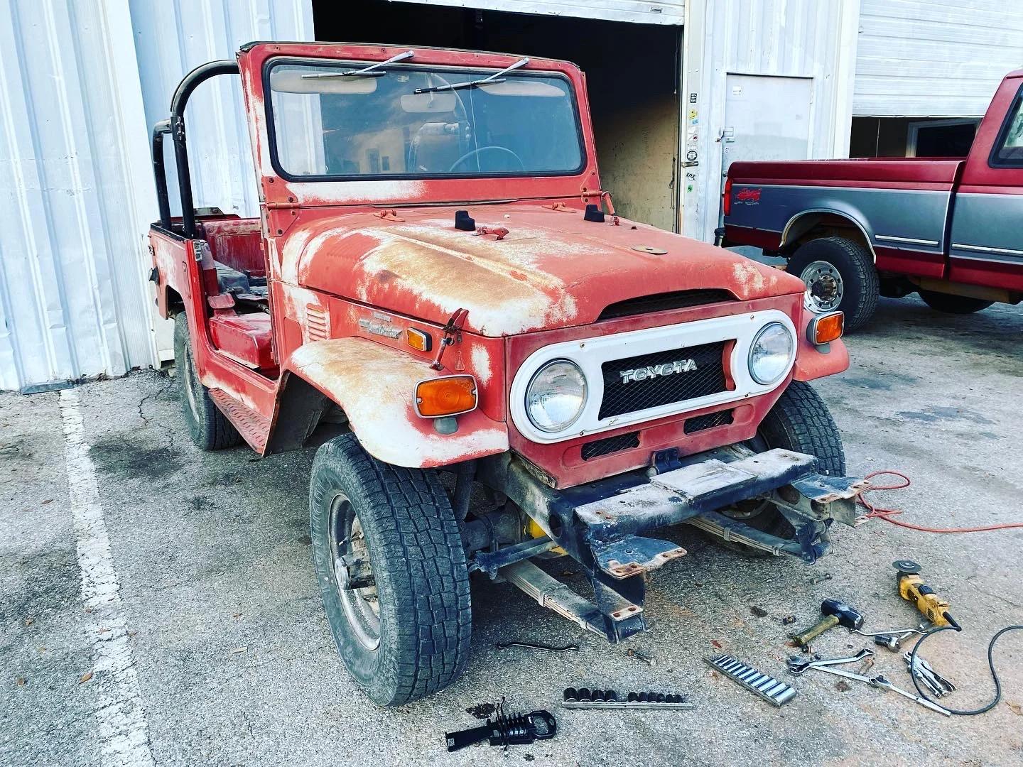

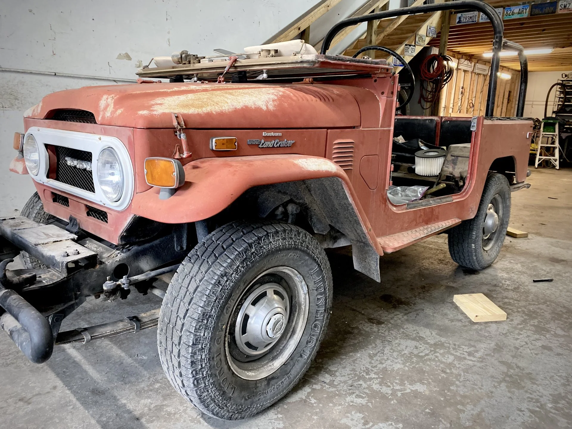

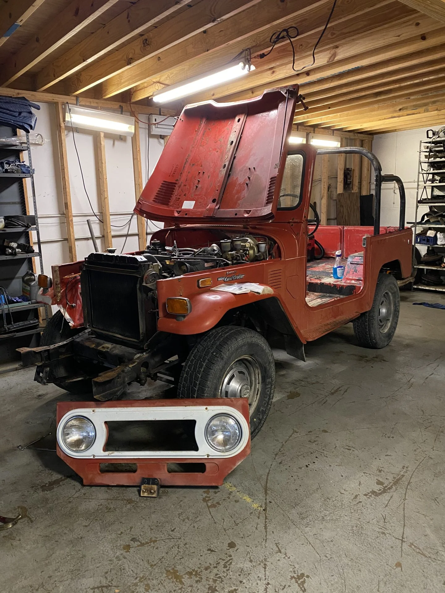

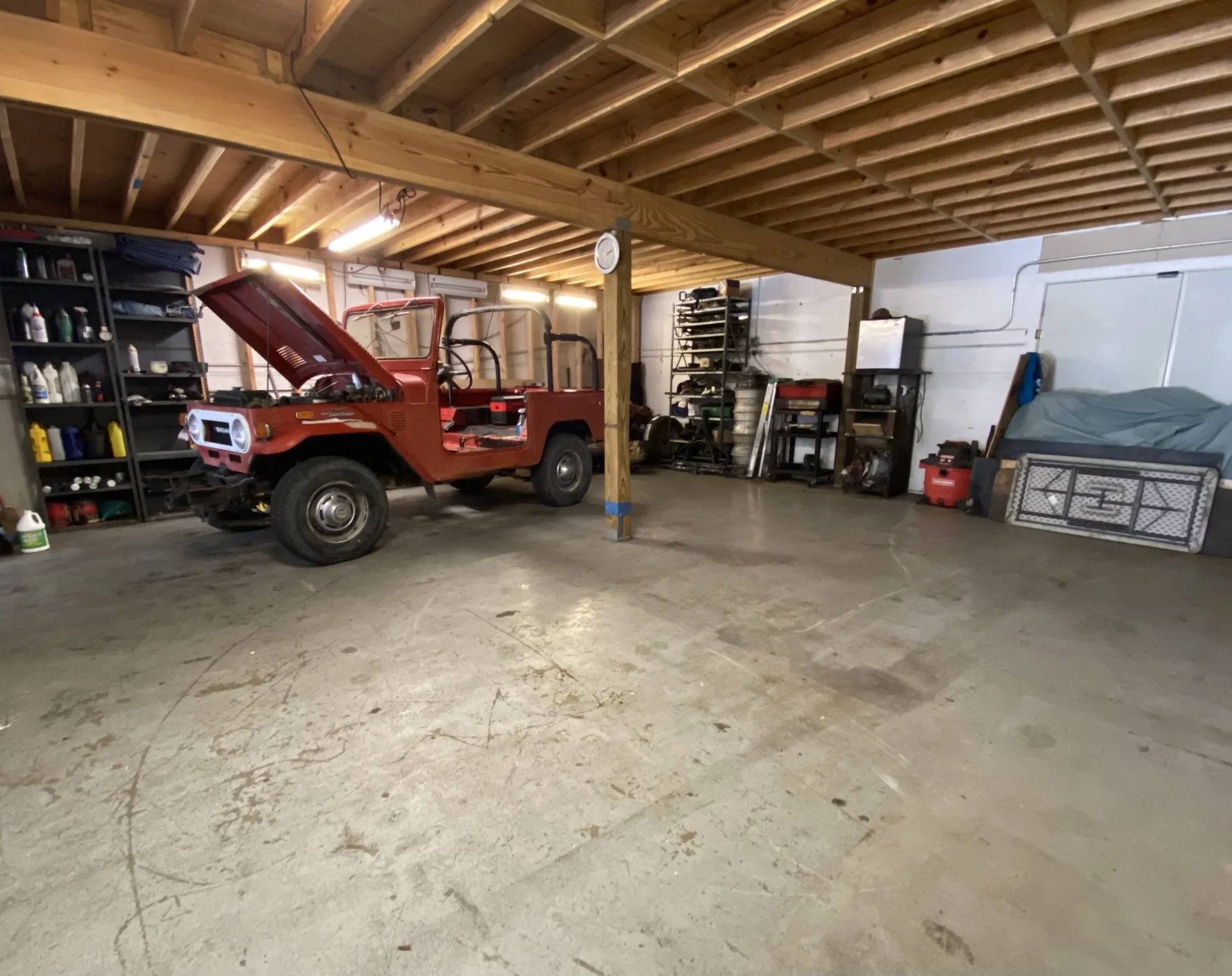

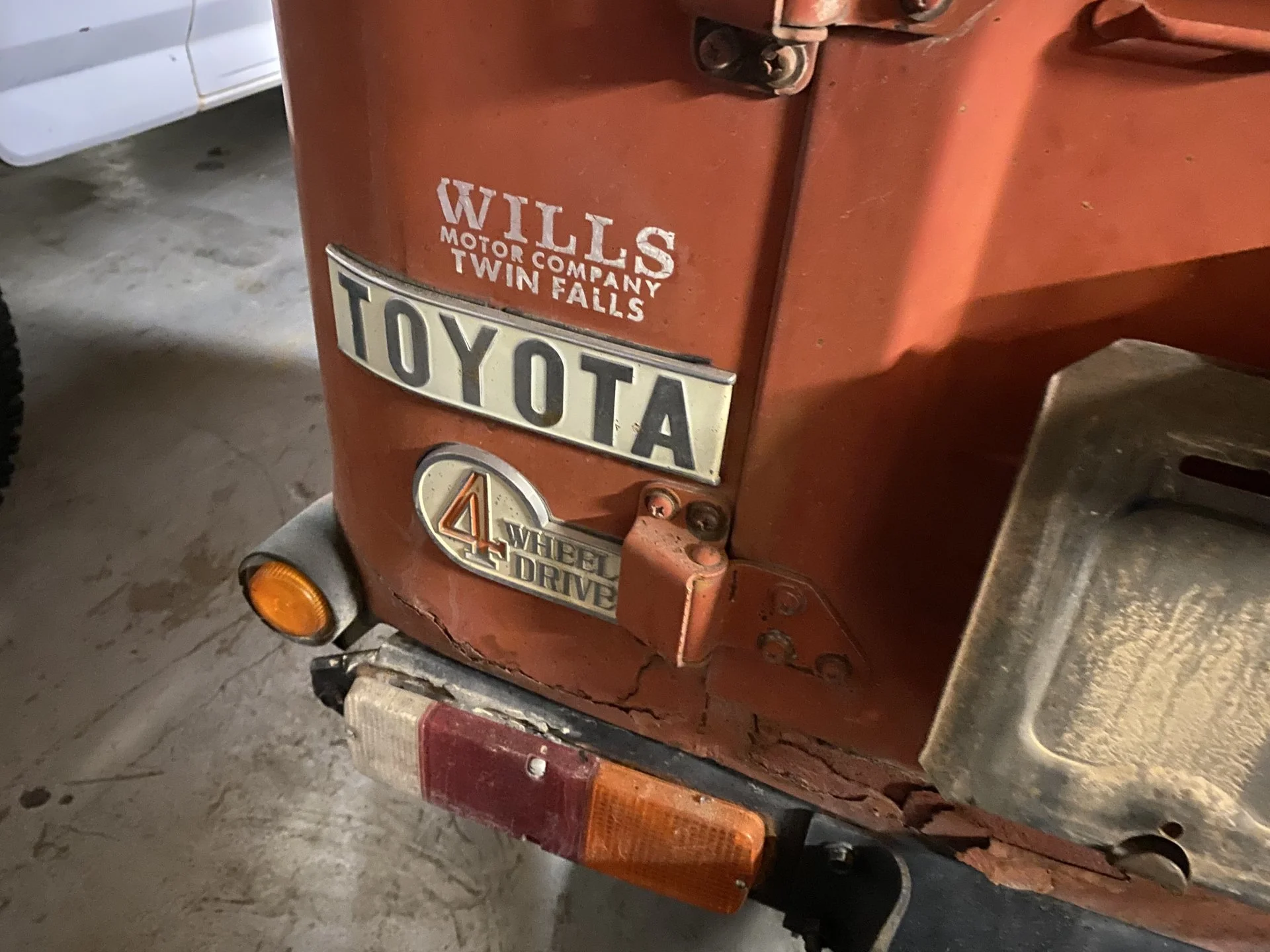

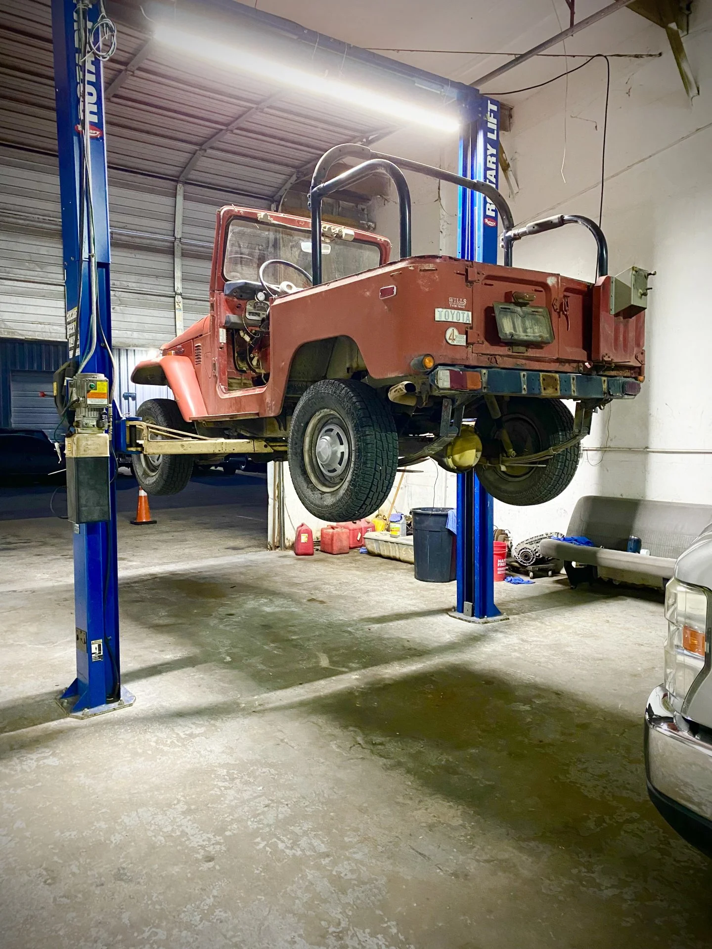

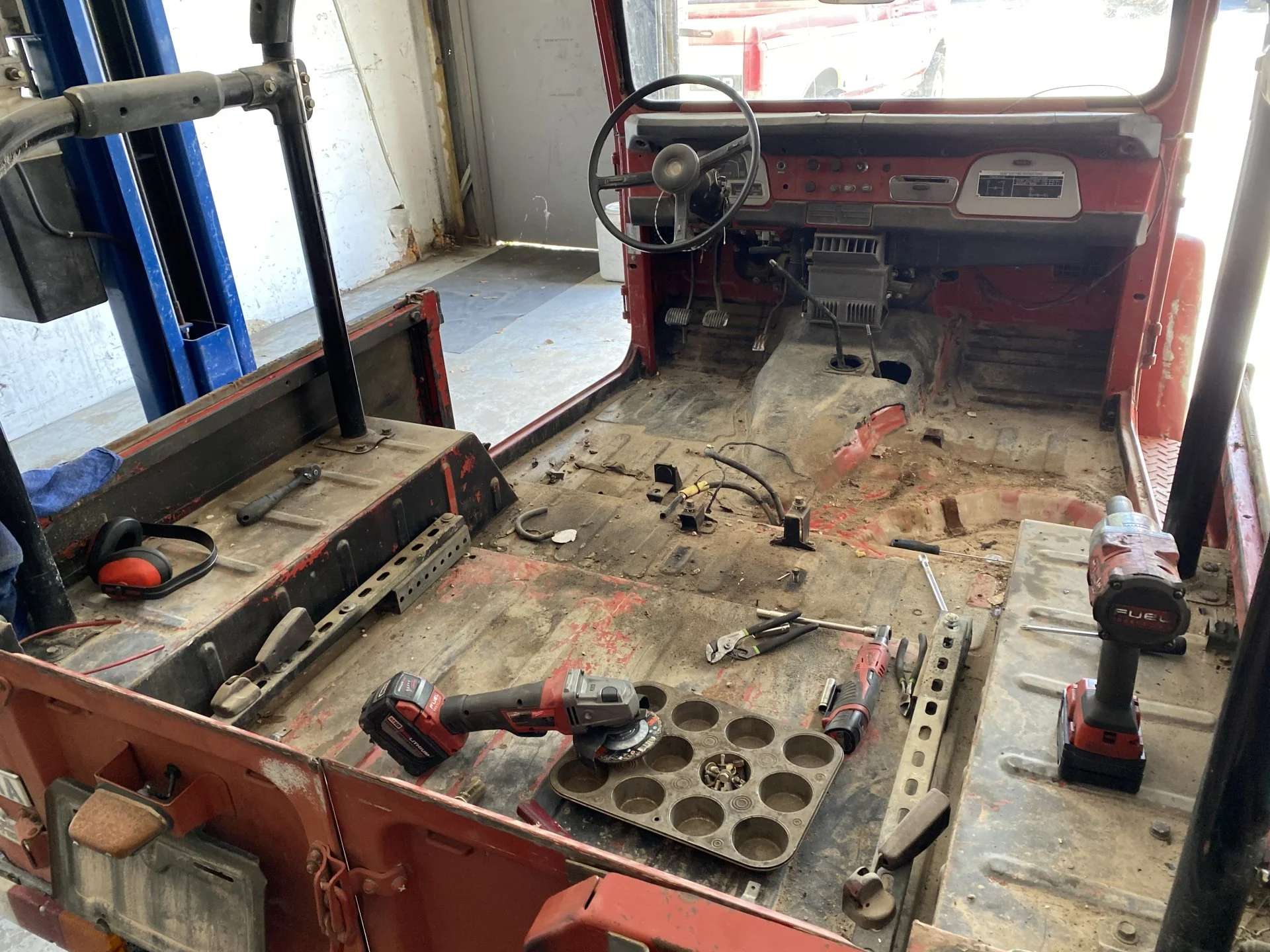

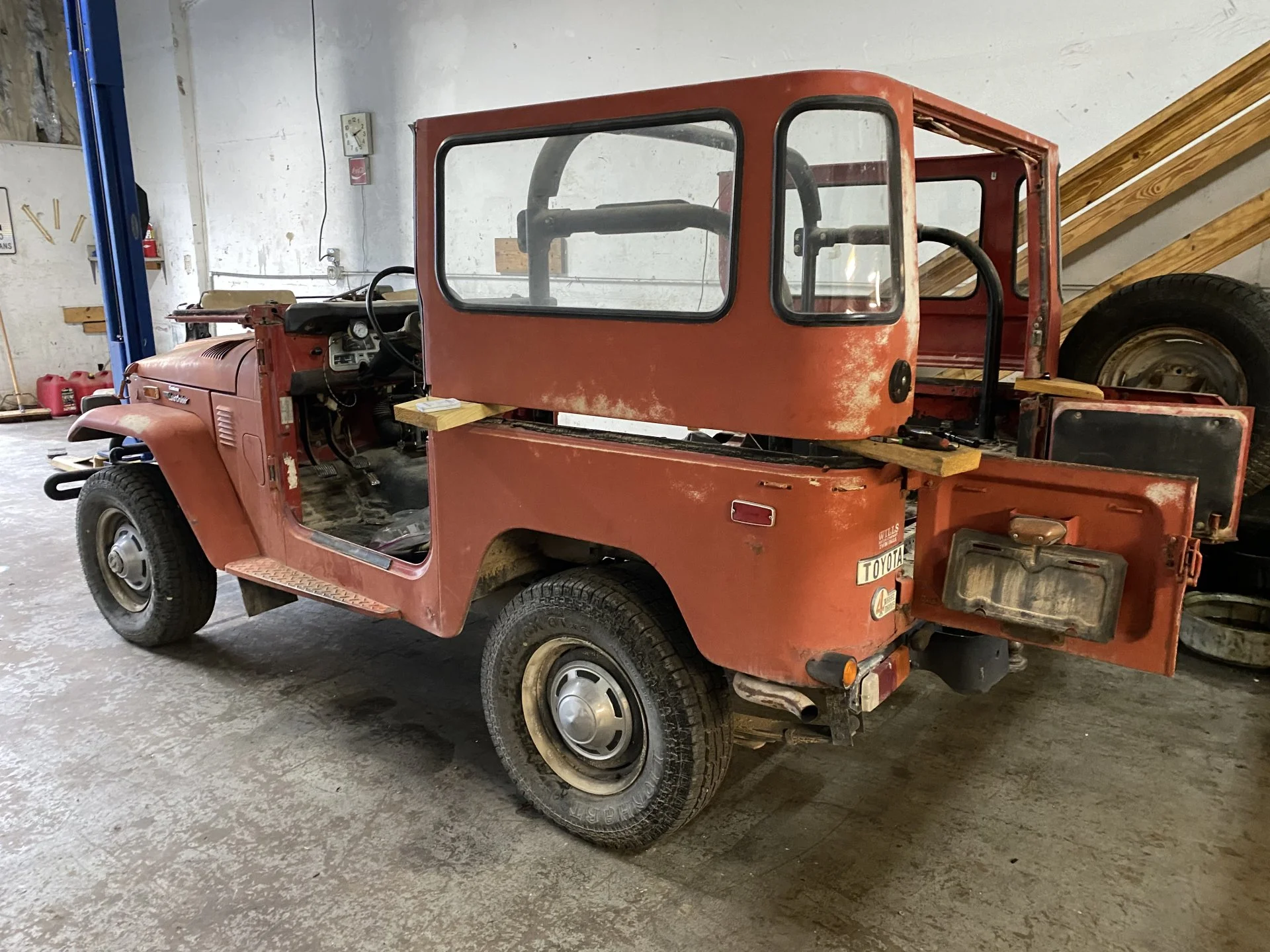

Although titled and registered as a 74 (9/73 build) the truck is equipped with a 3 speed. It has a roll bar, locking gas door, newer tail lights/ rear reflectors like a 74, just no h42. I really prefer the synchronized first of an h42, so the j30 3 speed is coming out. I grabbed everything needed from the white 75 for the swap.

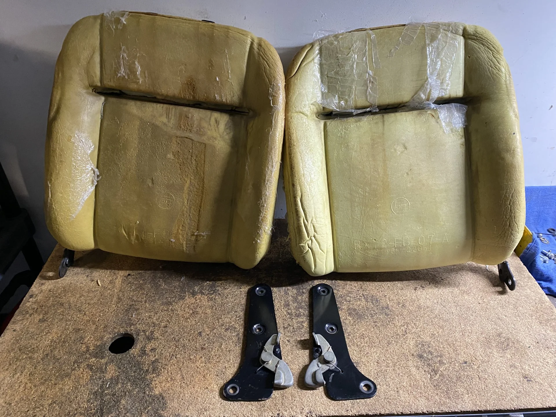

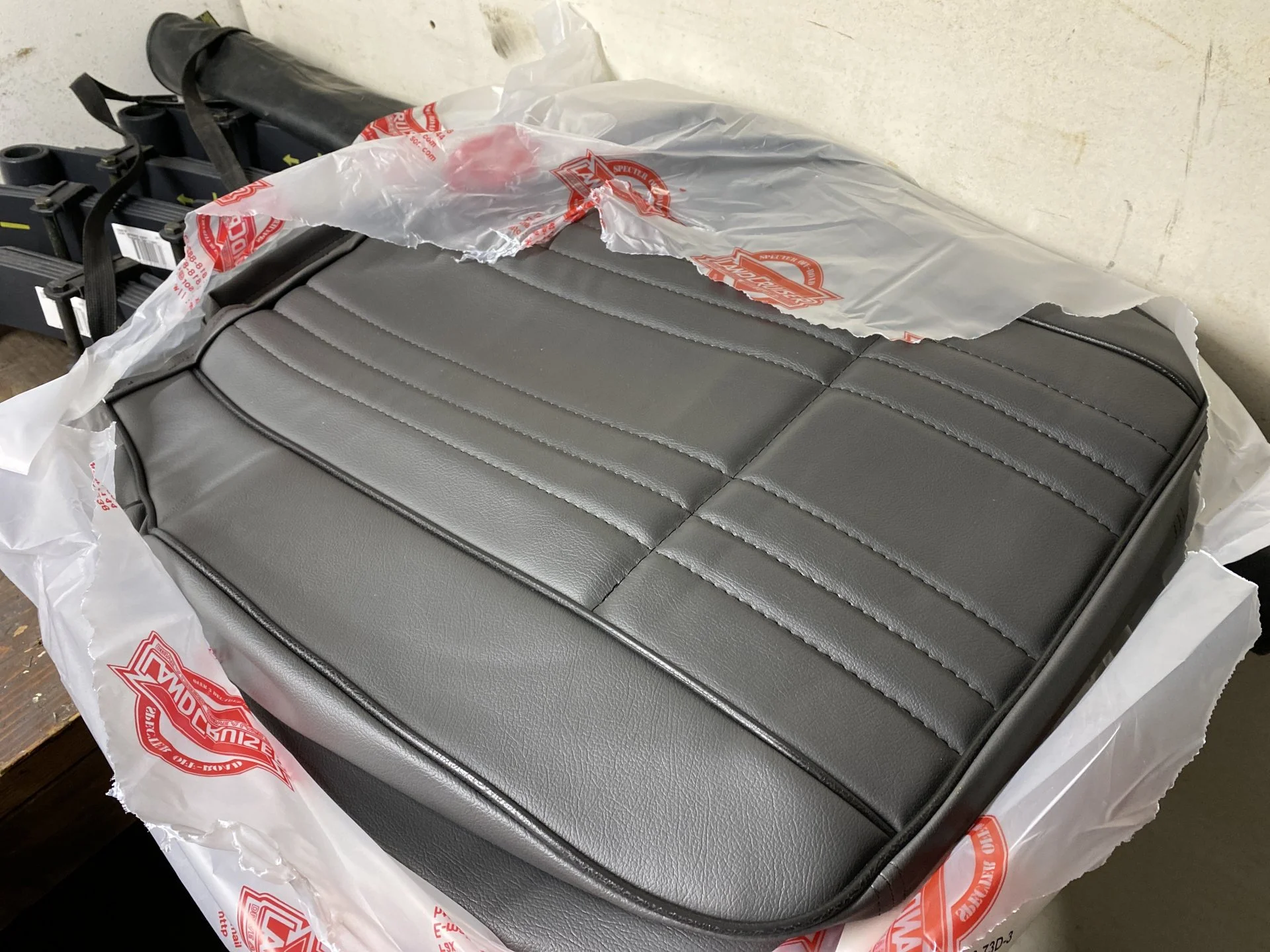

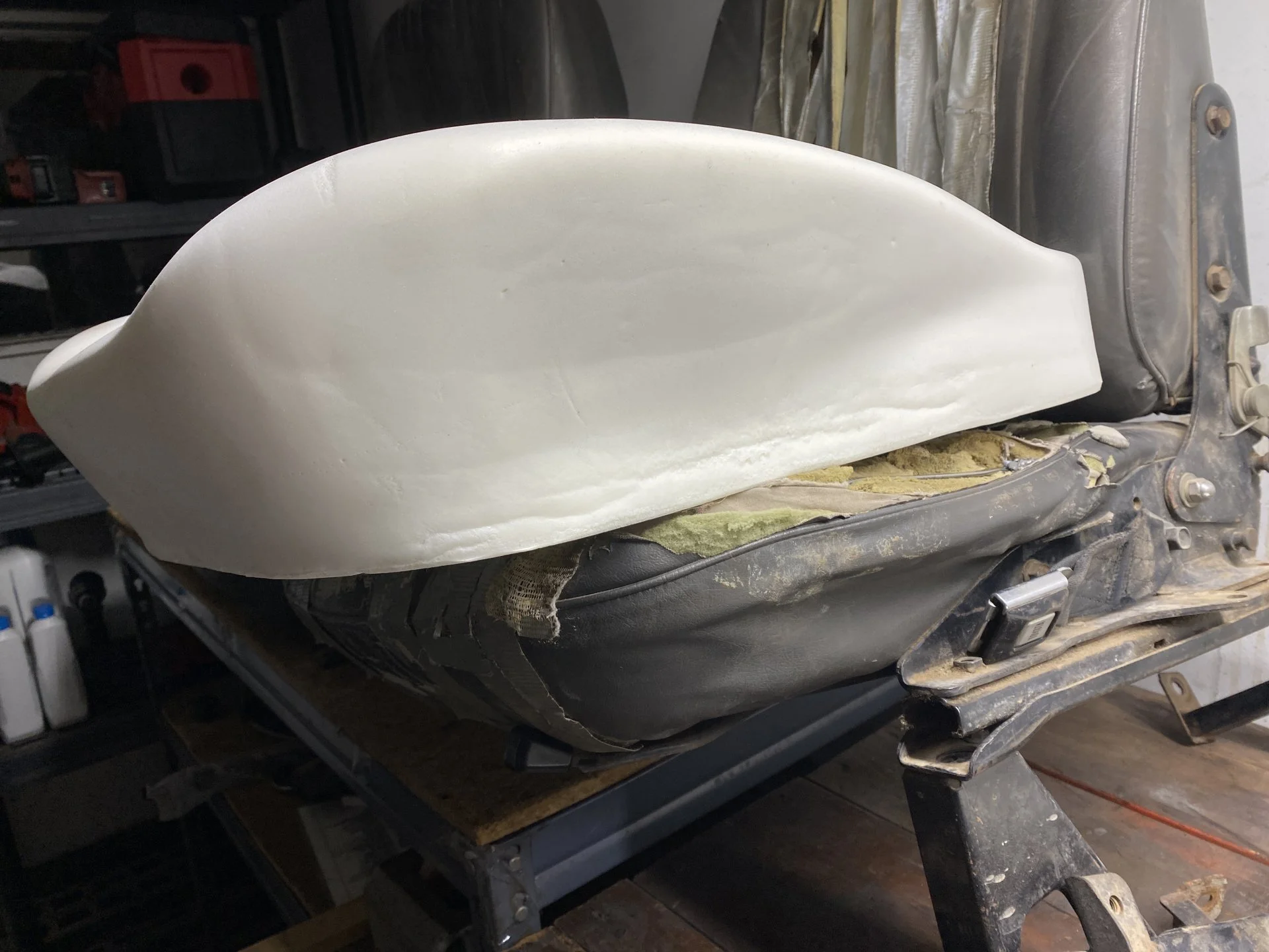

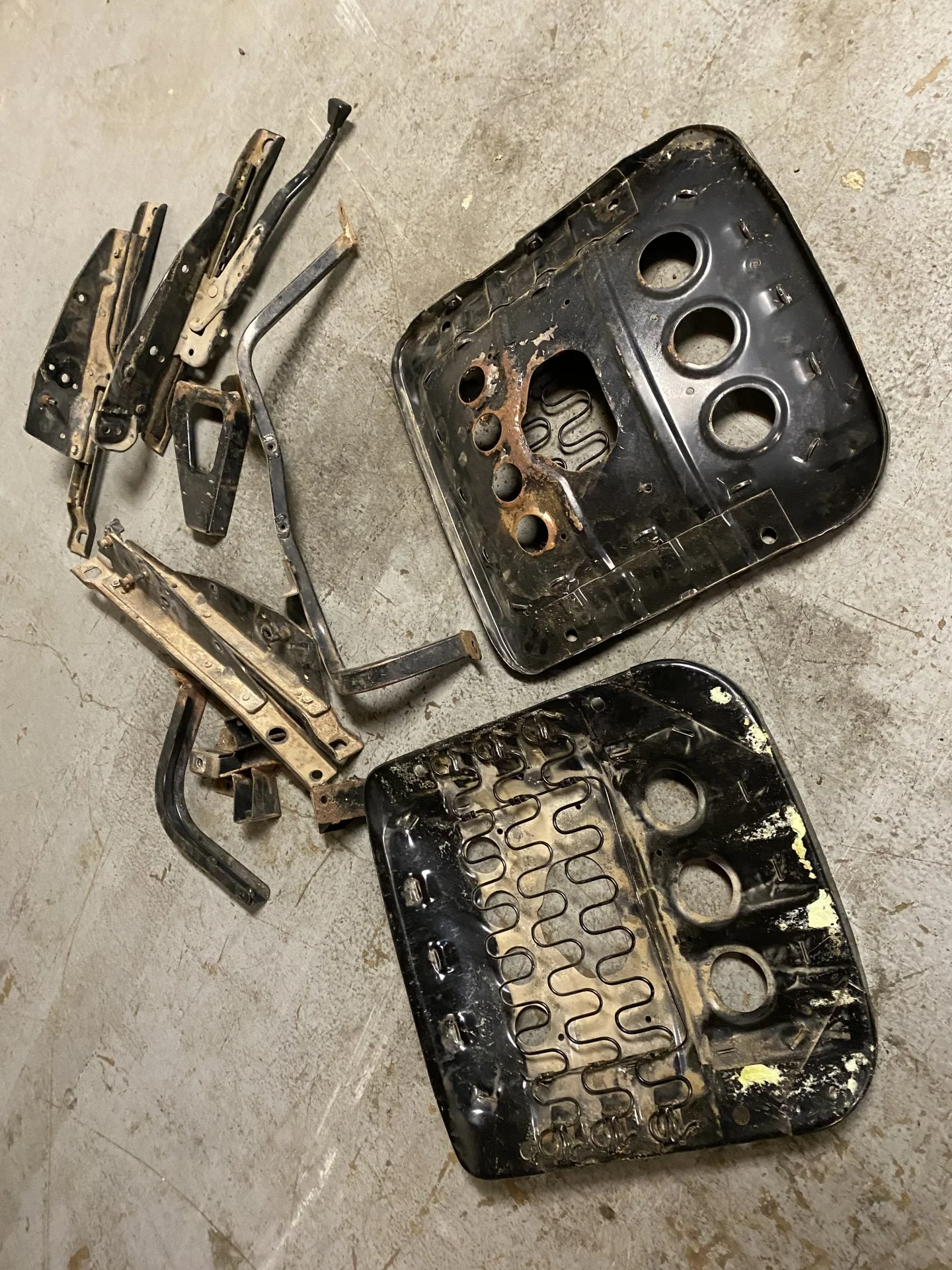

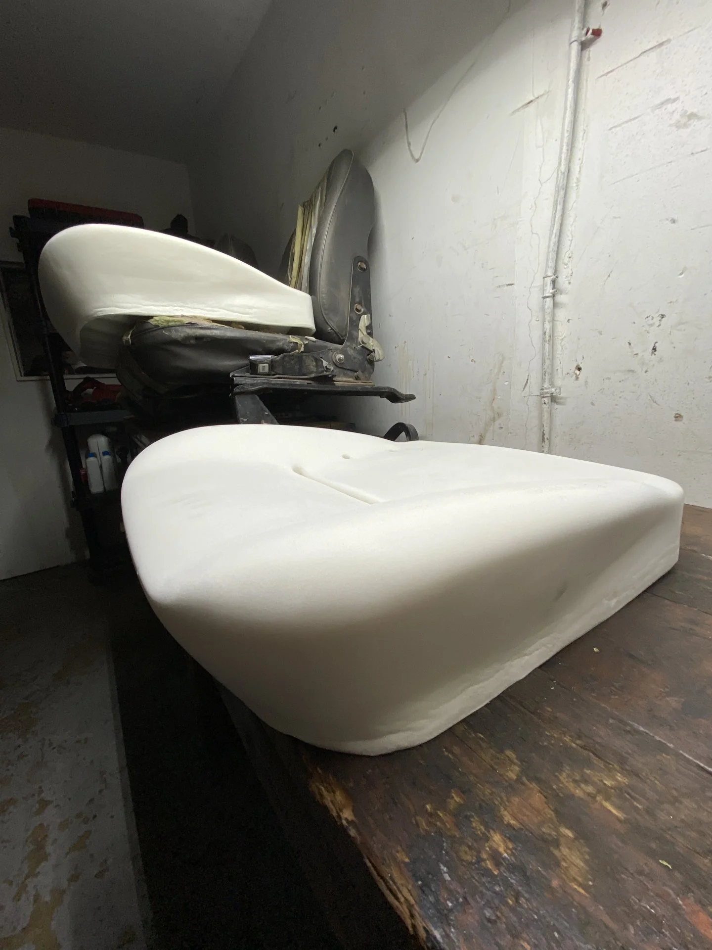

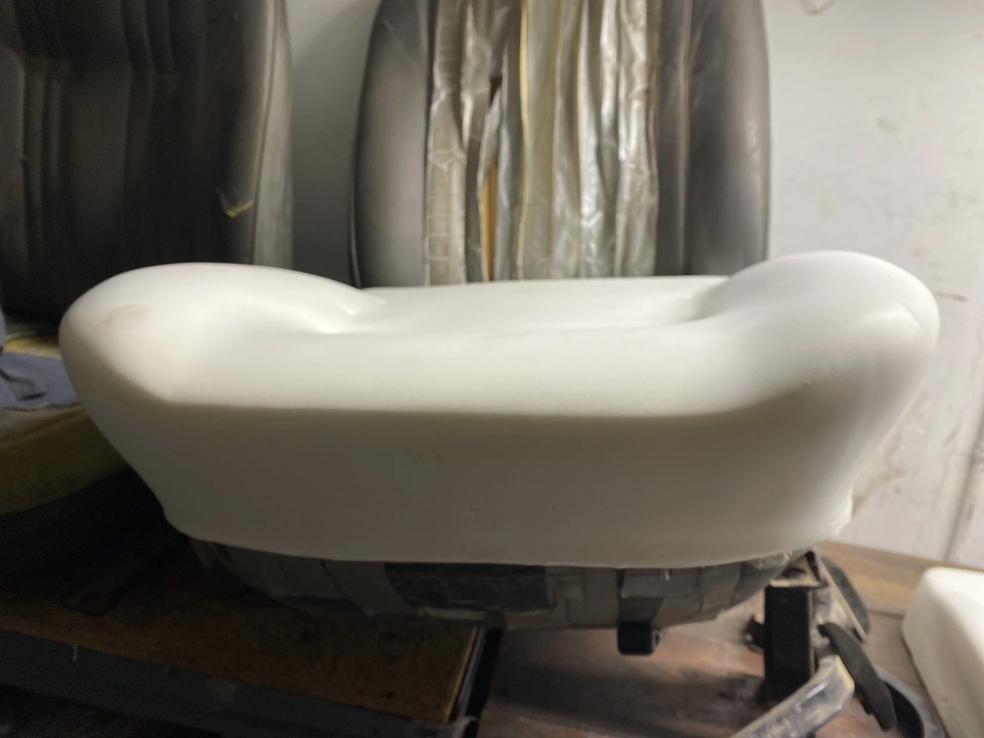

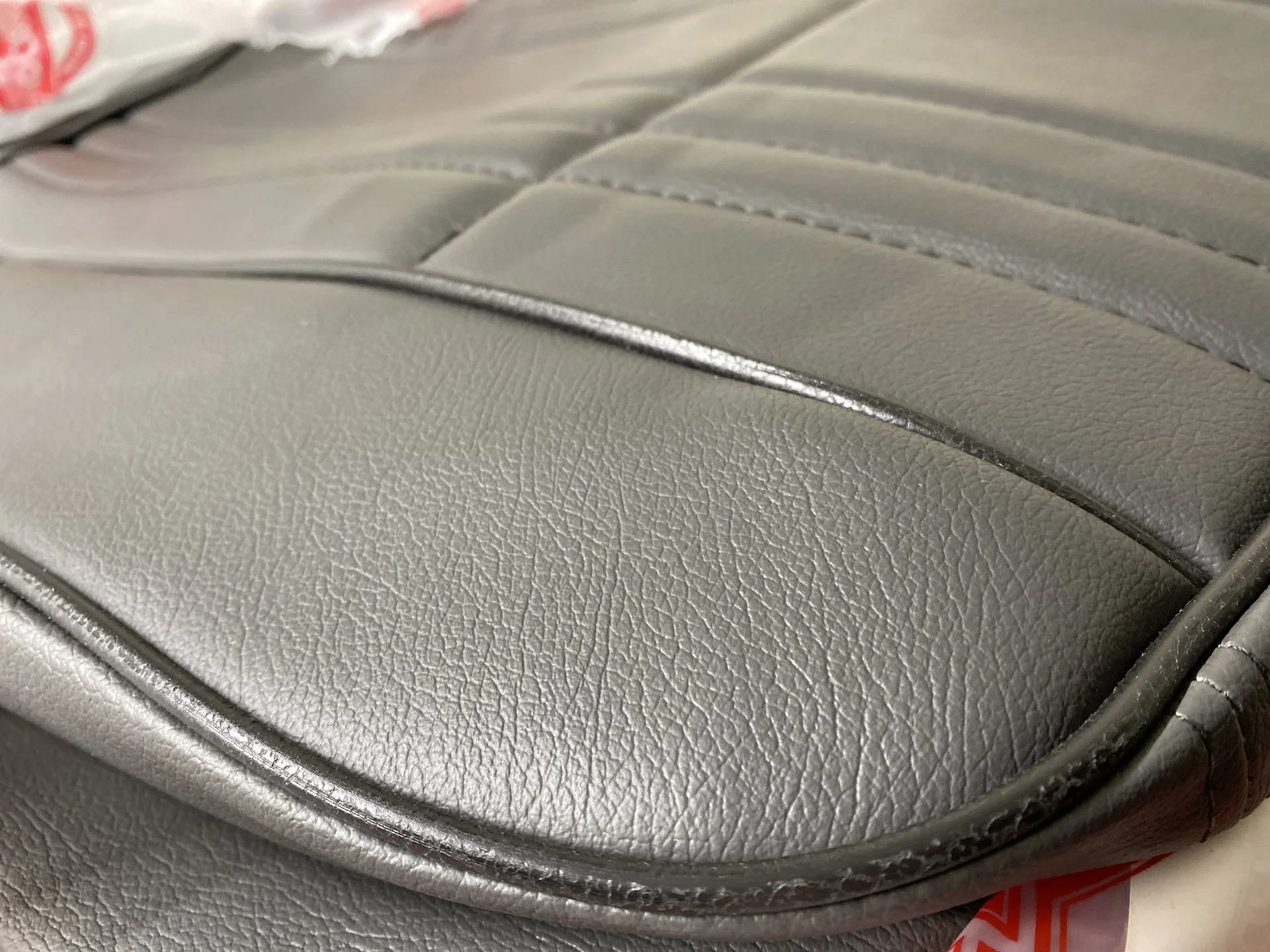

SOR Seat foam looks awesome. (It better for what they get fir ‘em). Upholstery looks good too, but would look better if the piping matched the rest of the seat material.

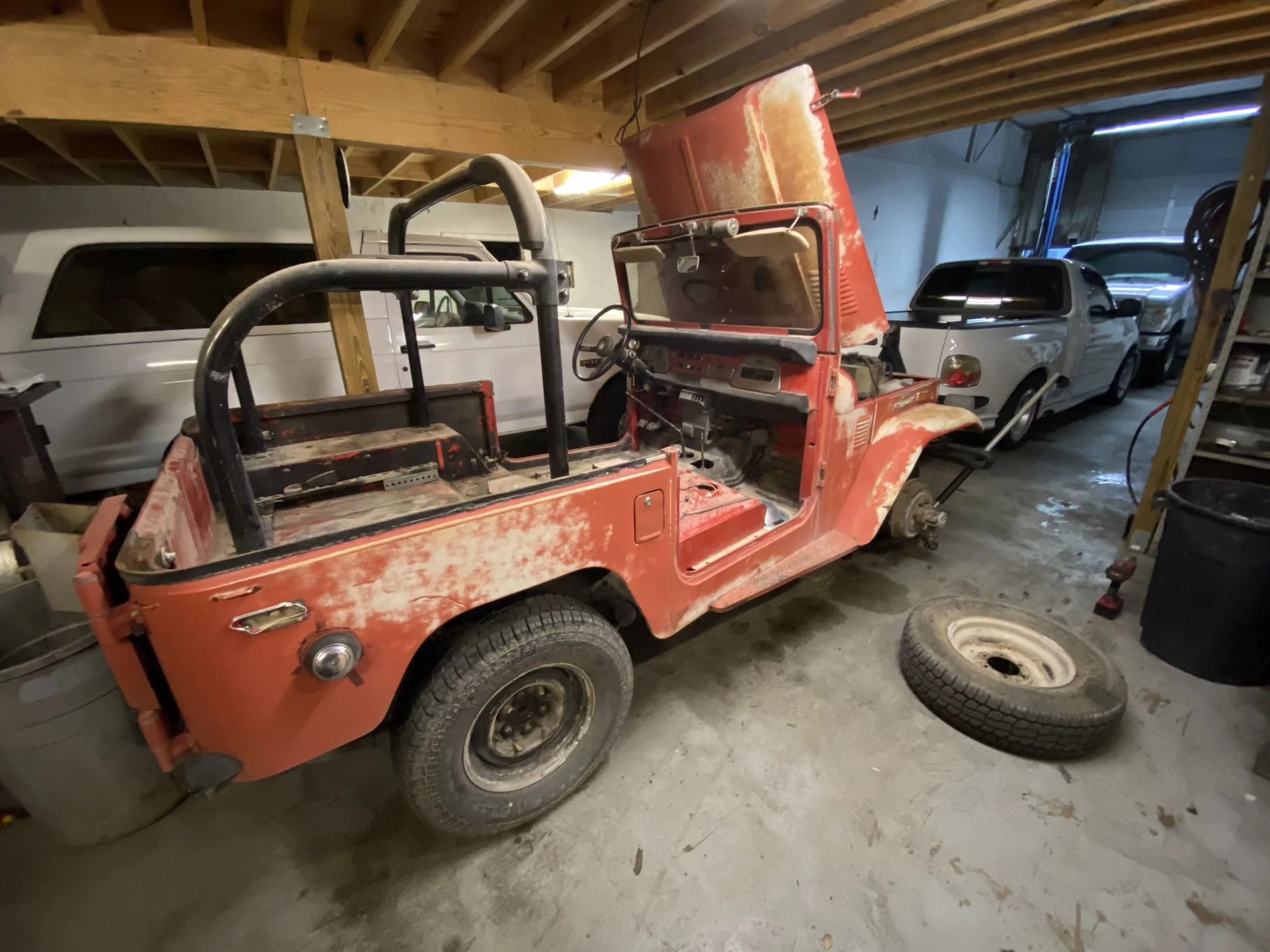

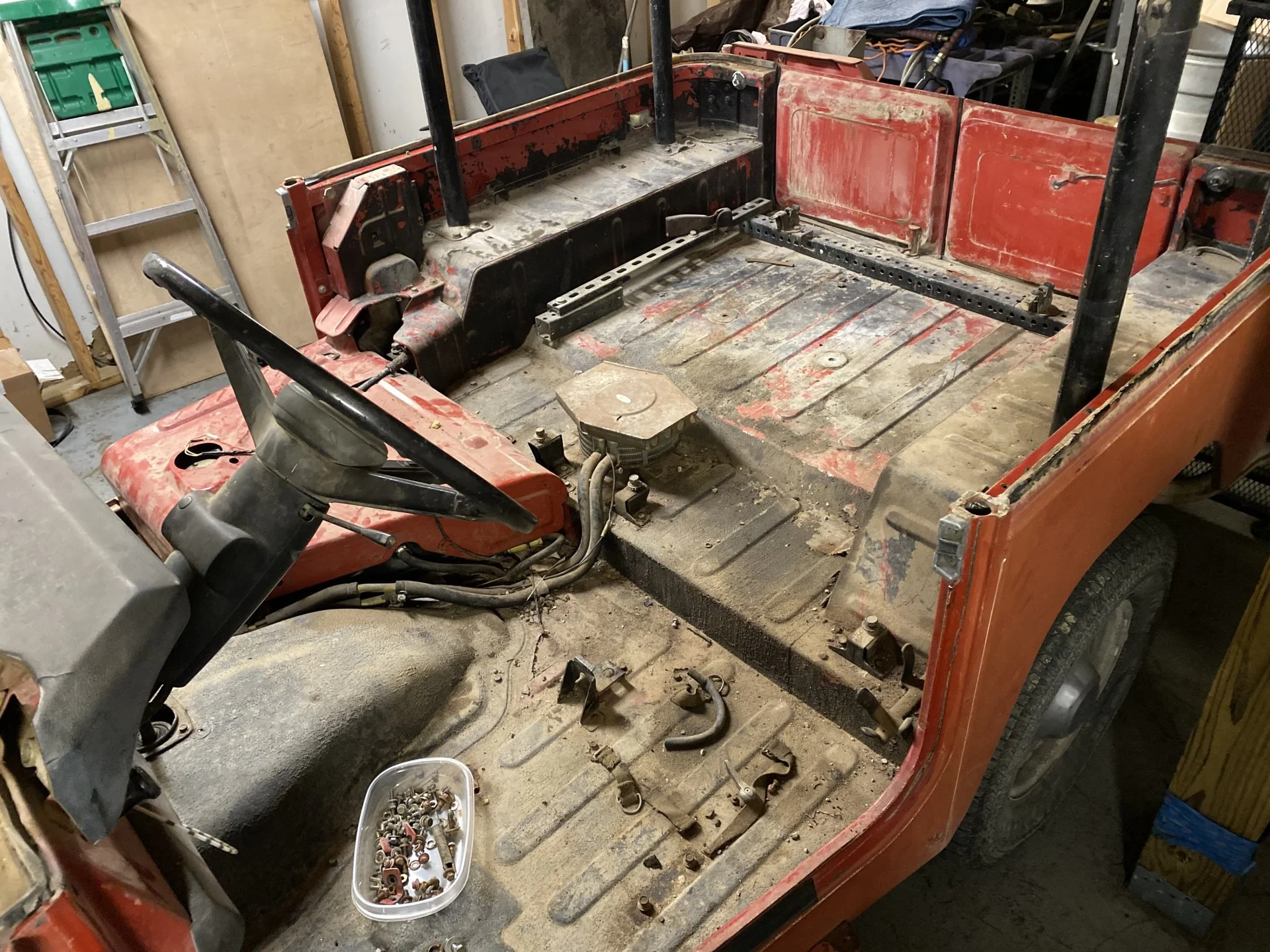

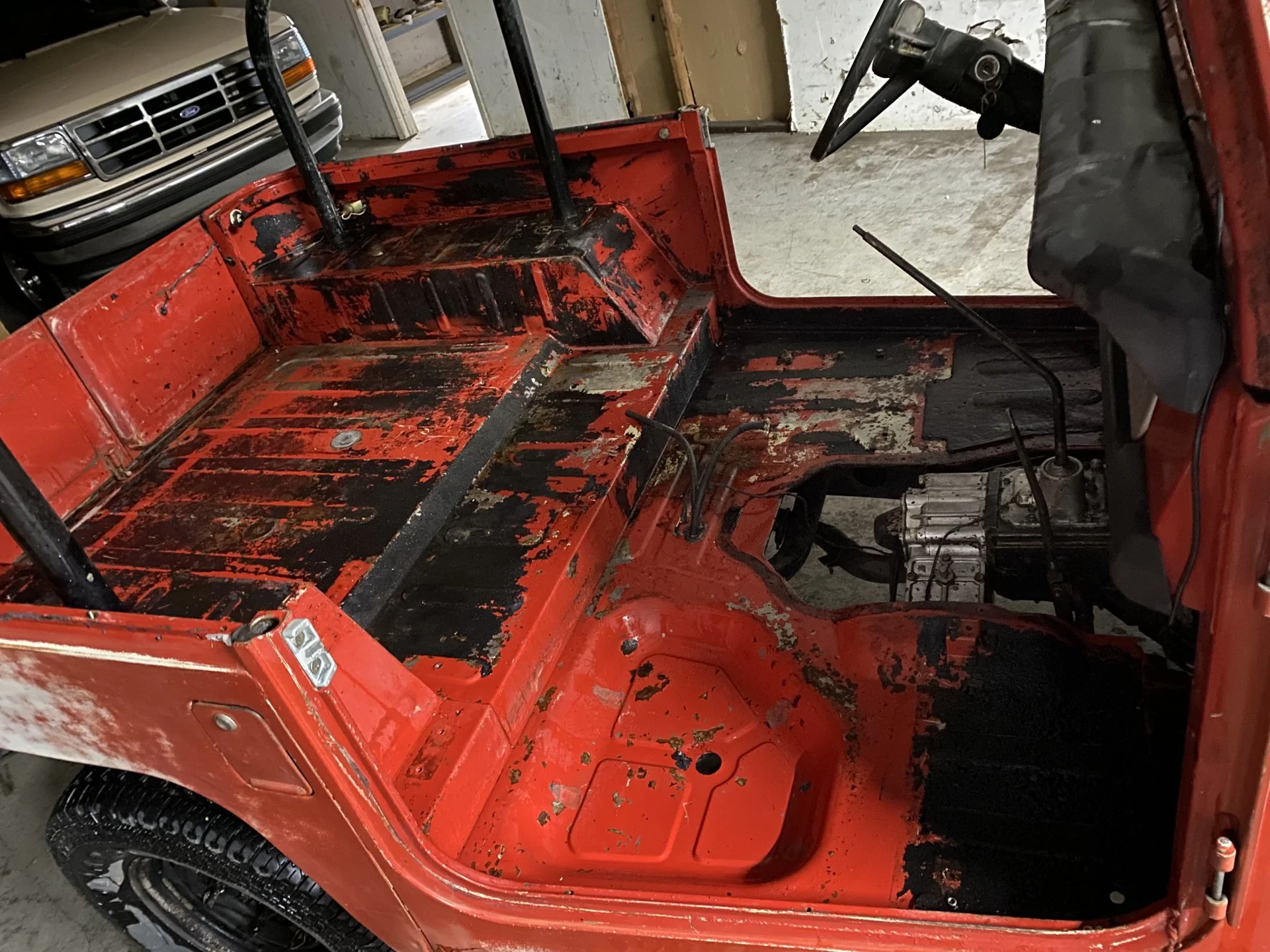

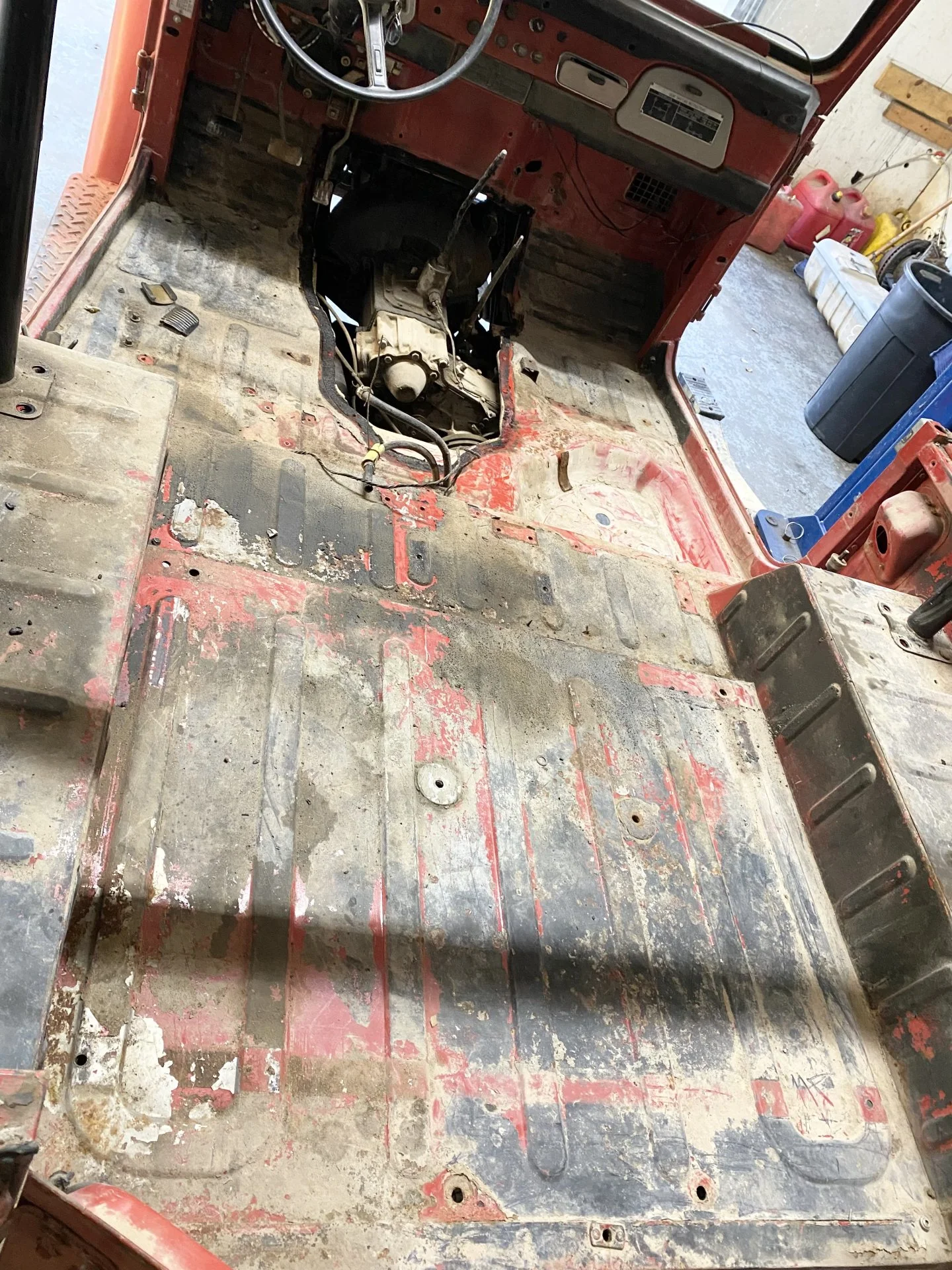

Interior floor to receive a fresh coat of freeborne paint after figuring out the best way to prep the surface. There is rubberized undercoating in places I’m wanting to remove.

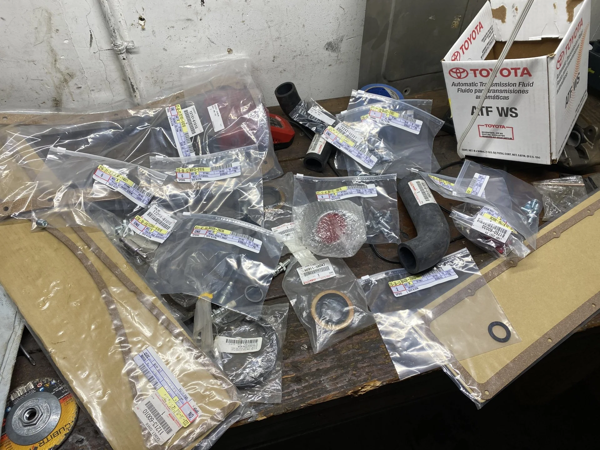

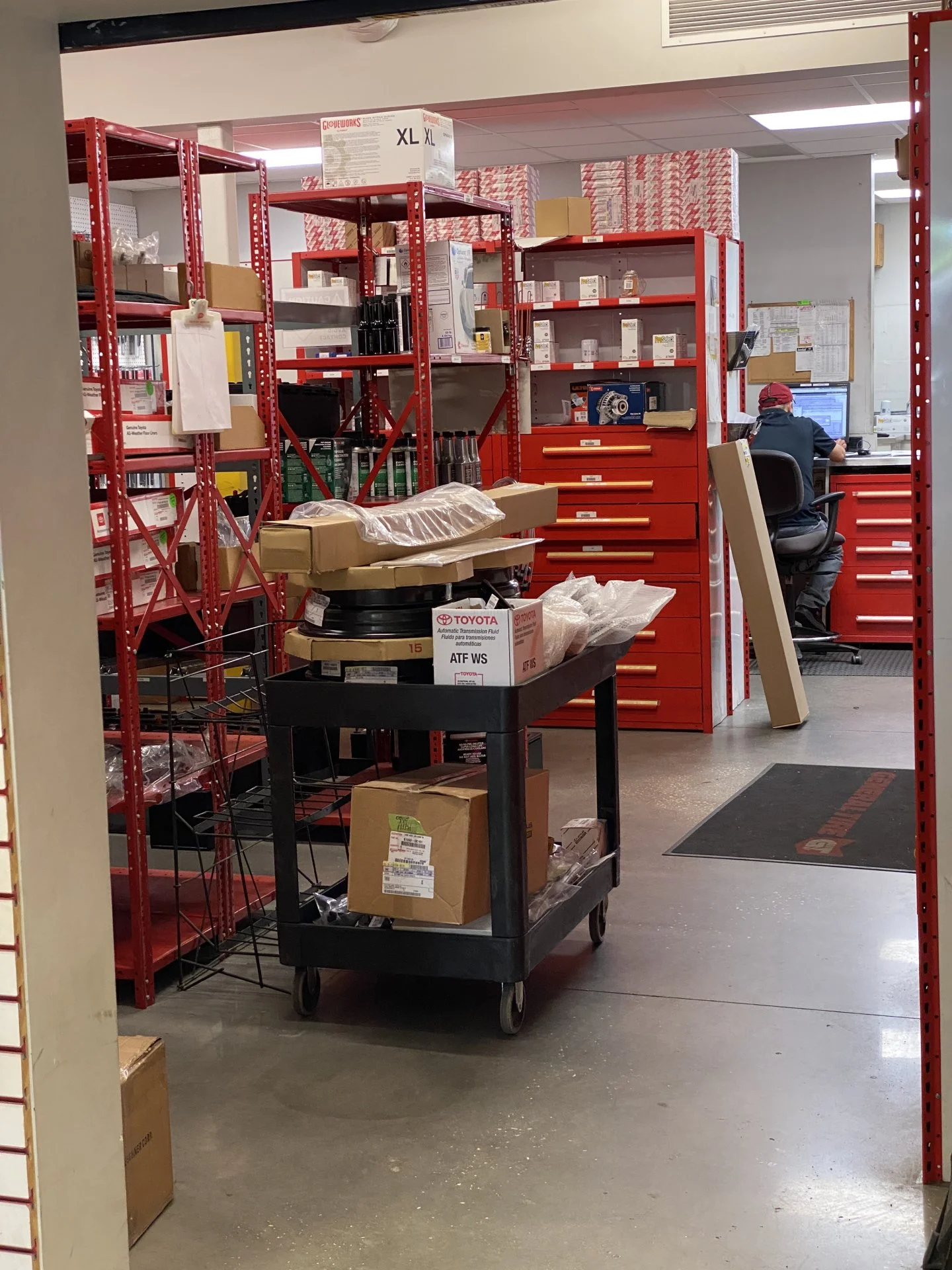

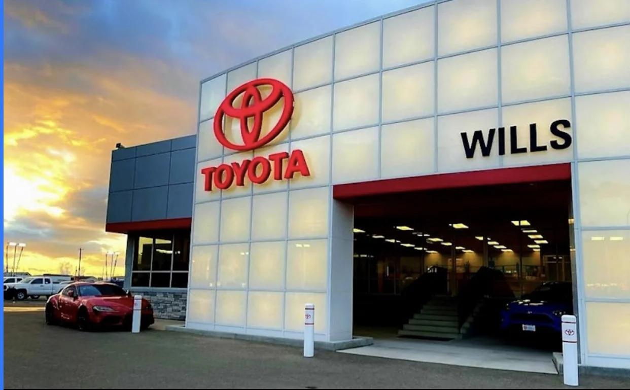

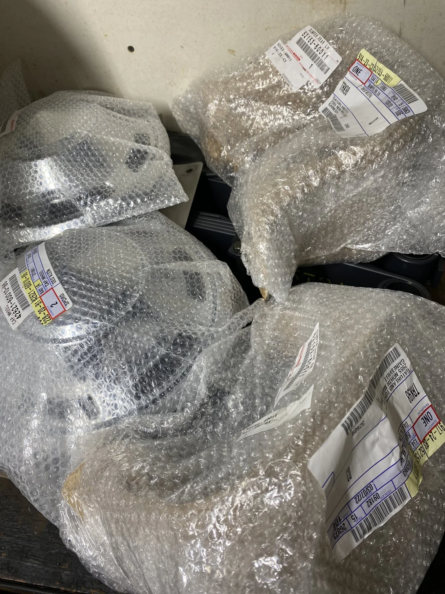

The local Toyota dealer (Gatorland) is just on the other end of my street. The Toyota parts distribution warehouse is an hour or so down the road in Jacksonville. Gatorland provides a discount on my parts and I don’t have pay shipping. Best of all, if I order by 530pm, they usually have it by 7:30 the next morning. GO GATORLAND!
