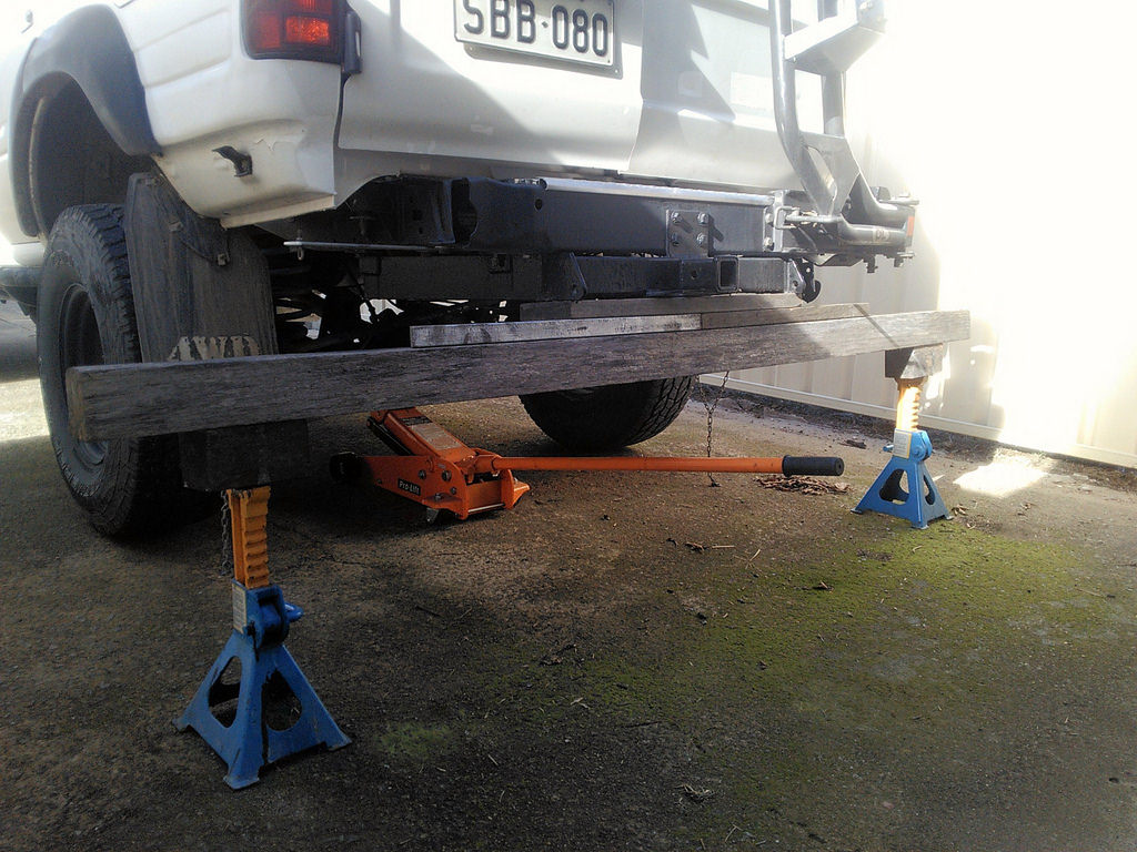

Good thing with regular trolley jacks is the cups they come with are excellent for all manner of things. A bit like good quality jack stands. I'm currently spending a few days replacing rear axle/diff assembly and freshening up brakes, etc. at the same time. Got the back of the 80 up in the air:
pic page
I've used that same piece of hardwood to do the same thing to the front of the 80 about 4 yrs ago when I rebuilt the whole front axle assembly and re-did bearings, swivel hubs, POR15 on axle balls, etc.
But some really good jack adaptors that do actually fit the size of the 80 aka LX450 chassis rails would be really handy.

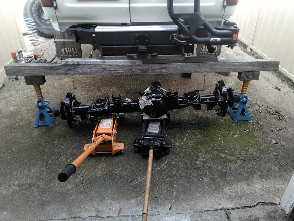

Speaking of trolley jacks, this is how to use two of them to move a complete partly-refurbed rear axle assy into place under supports to fit to back of an 80:

Whew.... thats a lot of trust in that chunk of wood! I would have put the jackstands right on the hitch horizontal.

That's a cluster fxxx just waiting to revoke your citizenship on earth!
I wouldn't send my ex missus under that.
