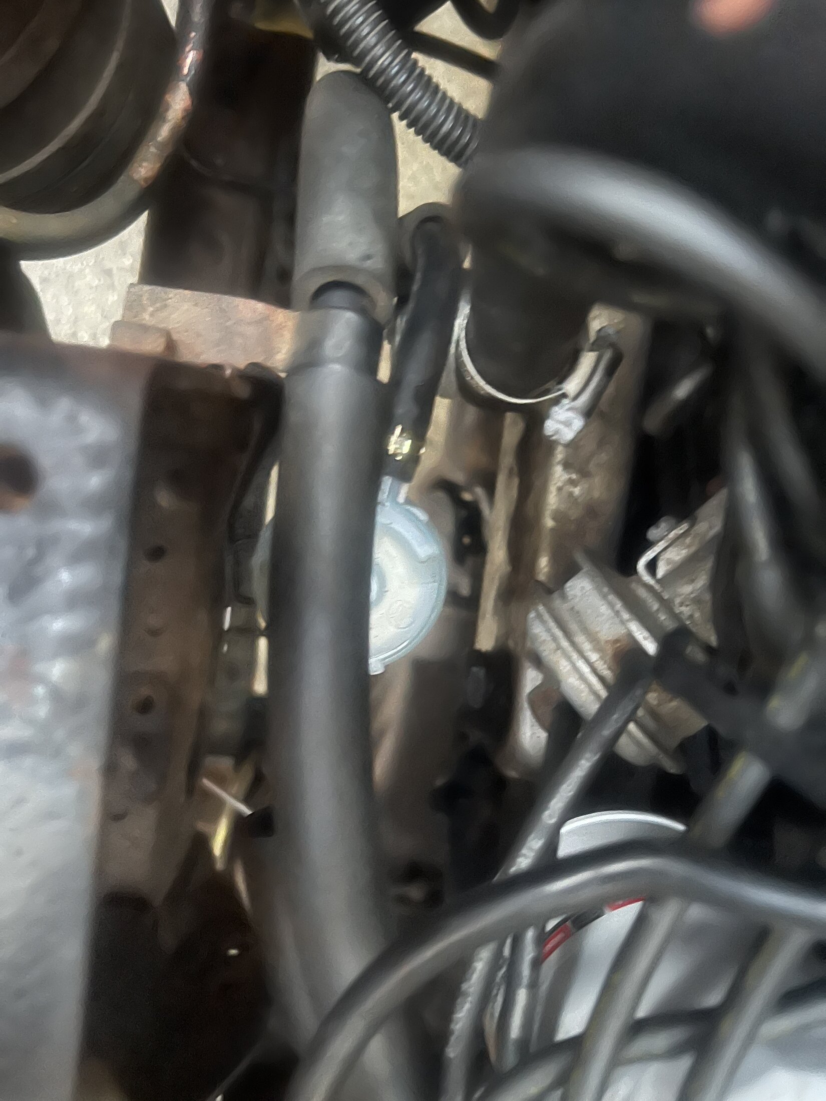

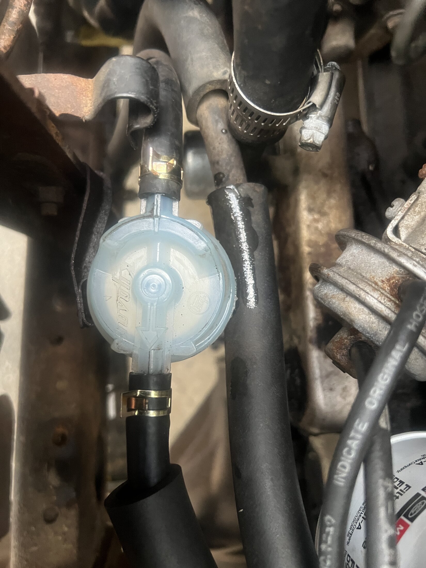

The crusty fuel lines at the fuel filter prompted me to pick up some Gates 5/16" (7.9mm) fuel line.
Replaced all of the fuel lines going to the fuel filter, fuel pump and return on the passenger engine compartment from the hard lines forward. Used a little over 4' of fuel line.
I used some zinc plated 12mm spring clamps. The stock ones were 14mm but this line is just a hair narrower than stock.

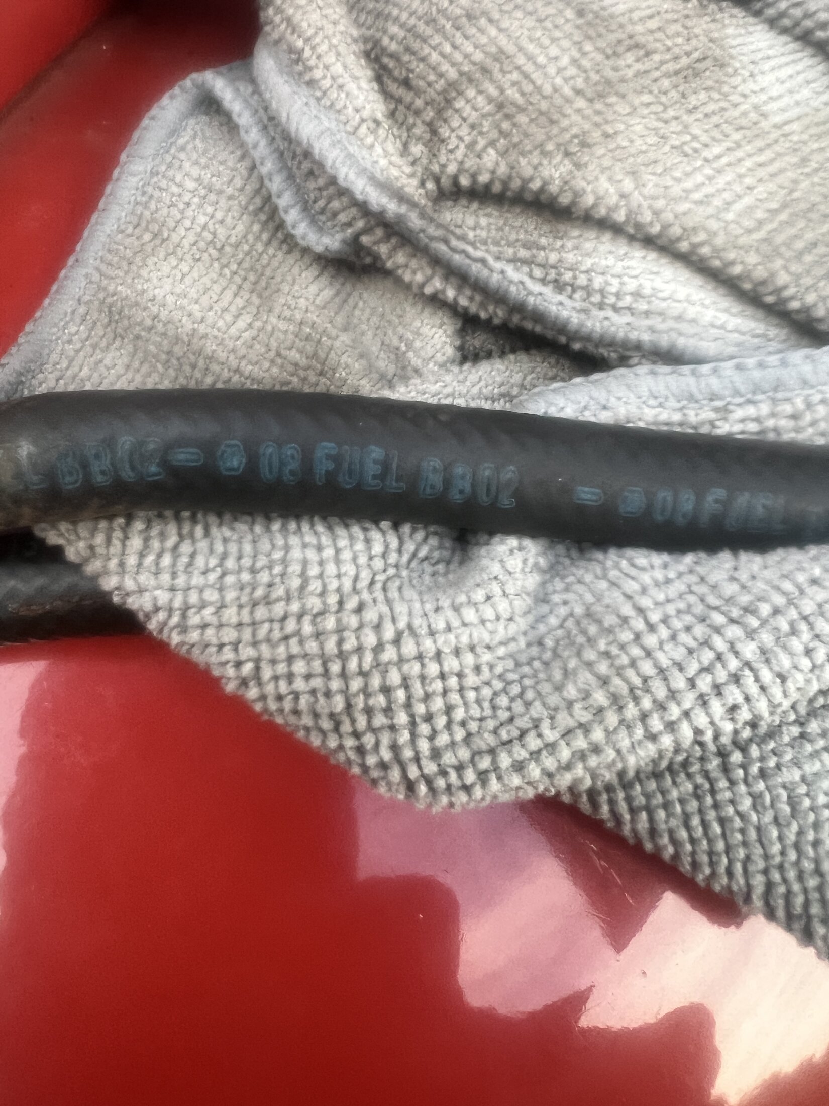

These appear to be the original fuel lines. Not a bad run, 46 years. I reused the foam fuel line covers as they were in great shape.
