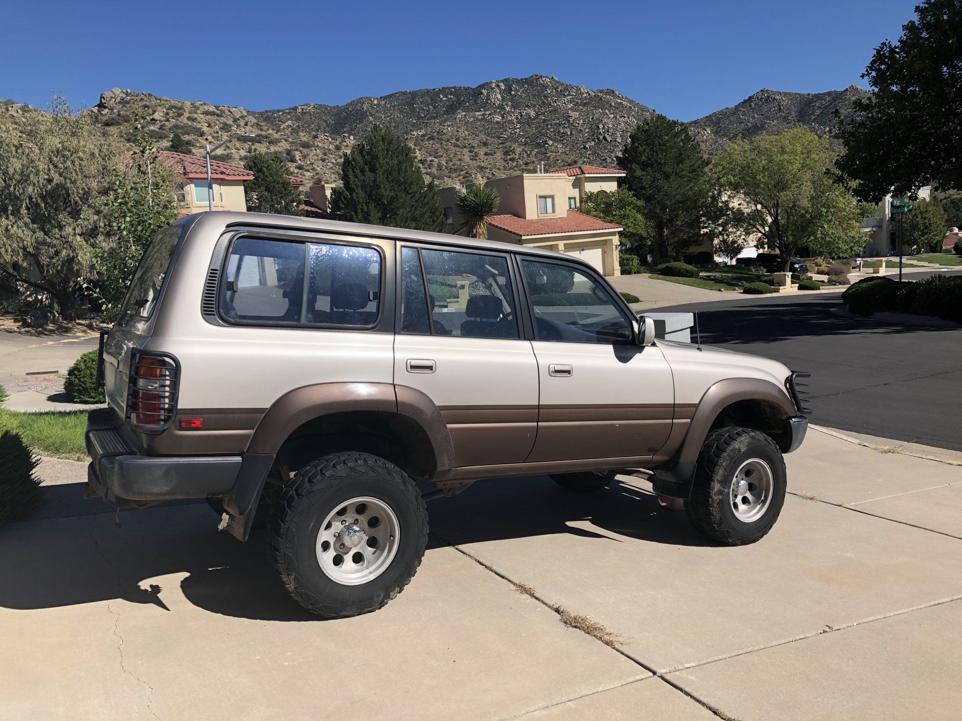

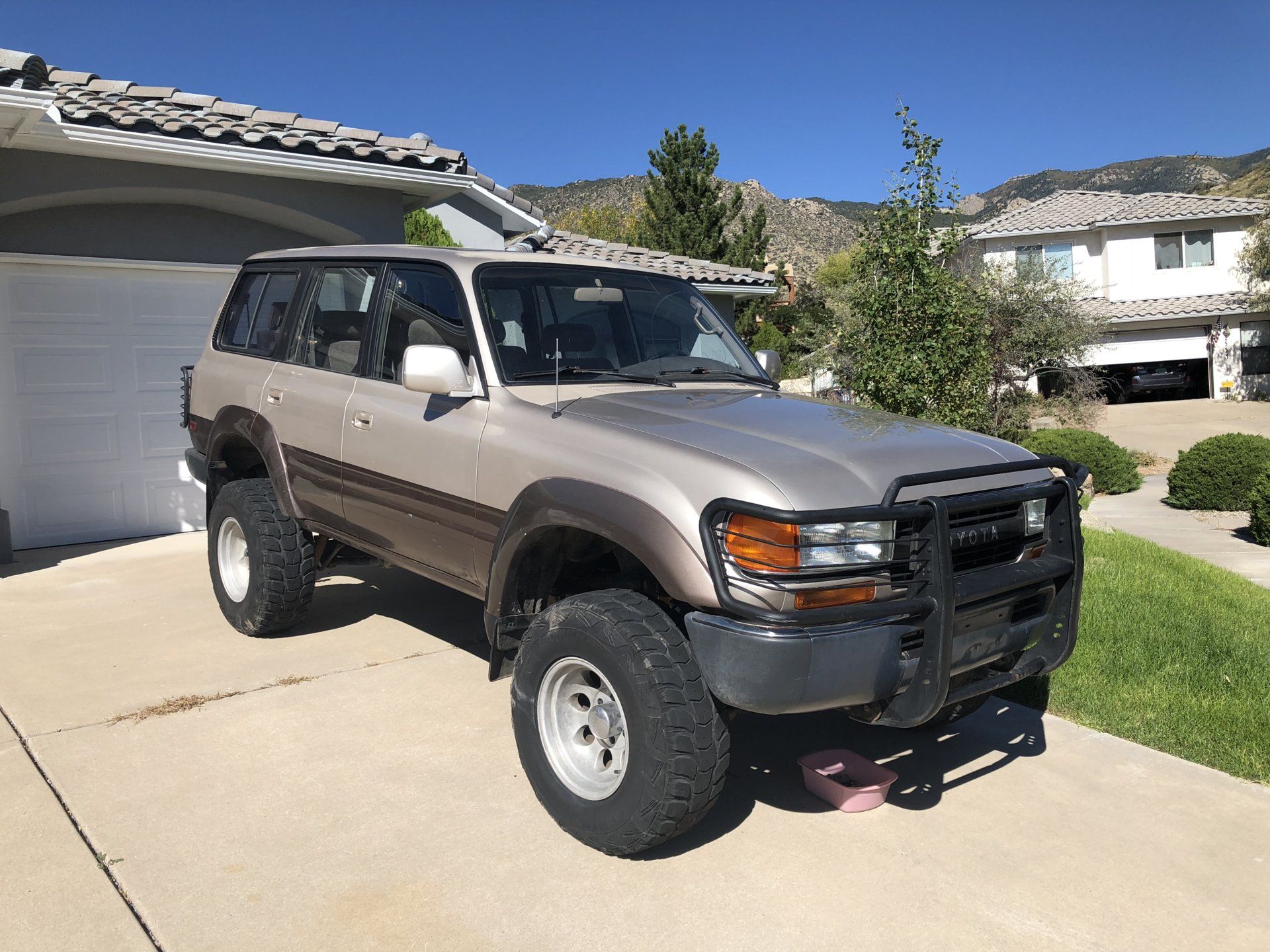

...and I have a Land Cruiser problem. Hello everyone! I'm looking to meet up with the local support group for Toyota habits. I have recently liberated a 1991 FJ80 from a friend who, thankfully, procrastinated on chopping her up. She ain't pretty, but I won't kick her out of the driveway for marking her territory. There is a lot of work to be done, and I hope I'll be able to leverage the TON of information I have already found here.

Pictures?

Pics of the FJ80 please. The 4Runner, well, ya seen one Gen5 you have seen them all. OK, just kidding. Pics of that too.

Nice looking 80!
Tell us a little more about the build. What kind of lift? Does it still have still stock gears? How many miles?
I had almost forgotten what stock bumpers look like...
Welcome to the club!
Almost 180k miles. Originally bought in Kansas. My friend bought it off of the original owner in 2016 or early 2017. I’m told it was totaled around 2007 due to hail damage, but I haven’t verified. It still has the stock gears. The only thing I know that has been updated is the alternator and radio. It’s on OME J springs with absolutely no geometry correction at all. It is a real adventure to drive at the moment. I HAVE NOT decided on how I want to tackle that just yet.

My only suggestion would be to get rid of the damage multipliers over the tail lights, and off the grill.

Welcome Brandon, looking forward to meeting you and the gal. She's cute and comes with her own bed pan :hillbilly: Ignore Marc, some of us go wheeling frequently.....w/o him :flipoff2:
I've never heard them called damage multiplier, but that sums up their effectiveness. They are as good as gone.

Welcome! I see you likely work in the medical field of some sort. those emesis basins are sometimes found at my place as well...
nice 80! I have no helpful hints, but can offer moral support. :) it's funny how the 5th gen 4runner seems to be the latest catching thing.
